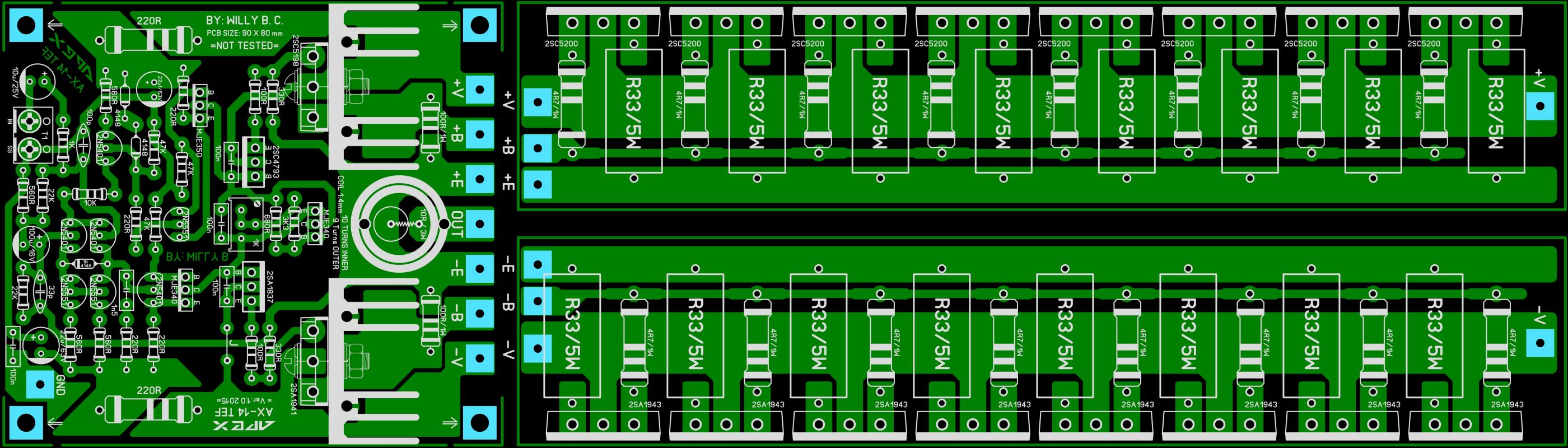

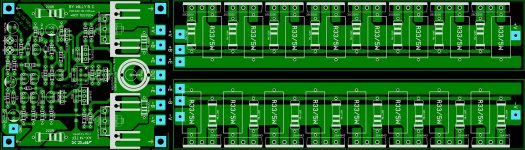

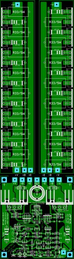

100W Ultimate Fidelity Amplifier
Reactions: priyank
But this is A33 Amp, not AX14. If you see not tested it does not means, not work. But you should be prepared for surprises. Sometimes they happen...
Regards
Thanks kandimna
I already build Ax14 with one pair.
I want high power amp about 200 to 300 watt on 8 ohm load.with good response for low frequencies.
Is it ok to use Ax14 with Extra pair, or use hv23 or b500 for extra tight bass. Please suggest.
