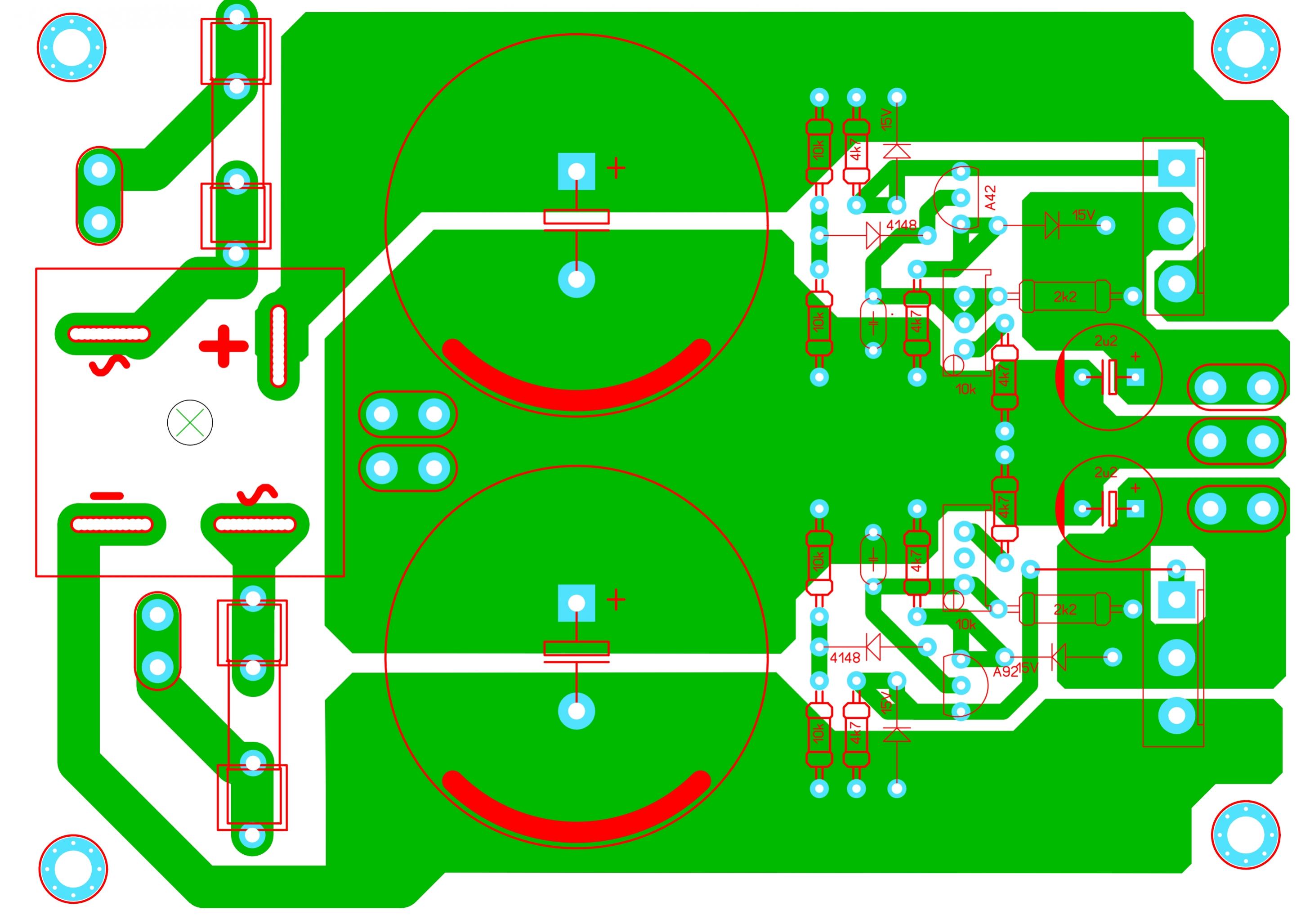

Something like this?
Im lost at the bridge and the makro :-(
OK I will try to help here. If you open the Lay6 file above and click on the second tab at the bottom it will open the layout with the slotted bridge. Click on that bridge and it will be highlighted. On the center of the right hand side of the screen you will see a Floppy drive icon. Click on that and save the bridge to the USER folder. Now you will have that makro to use in the future.

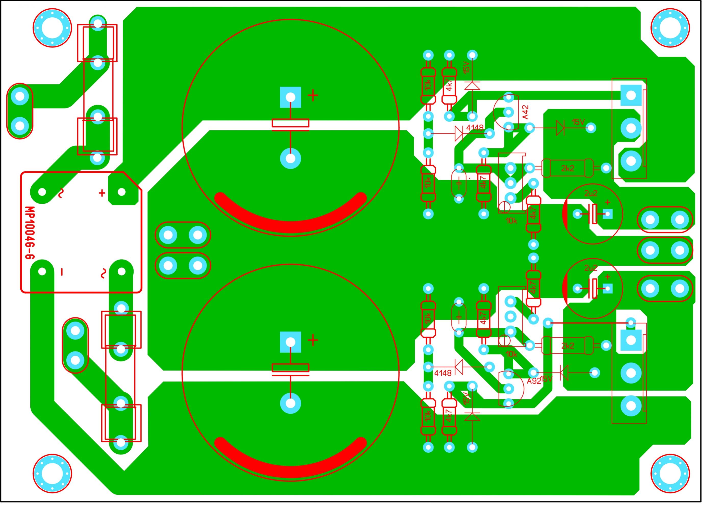

Morning all. Was late last night so couldnt play around with Sprint layout 6 anymore. But is there a way I coudl extend the board, lets say to add two more main caps?

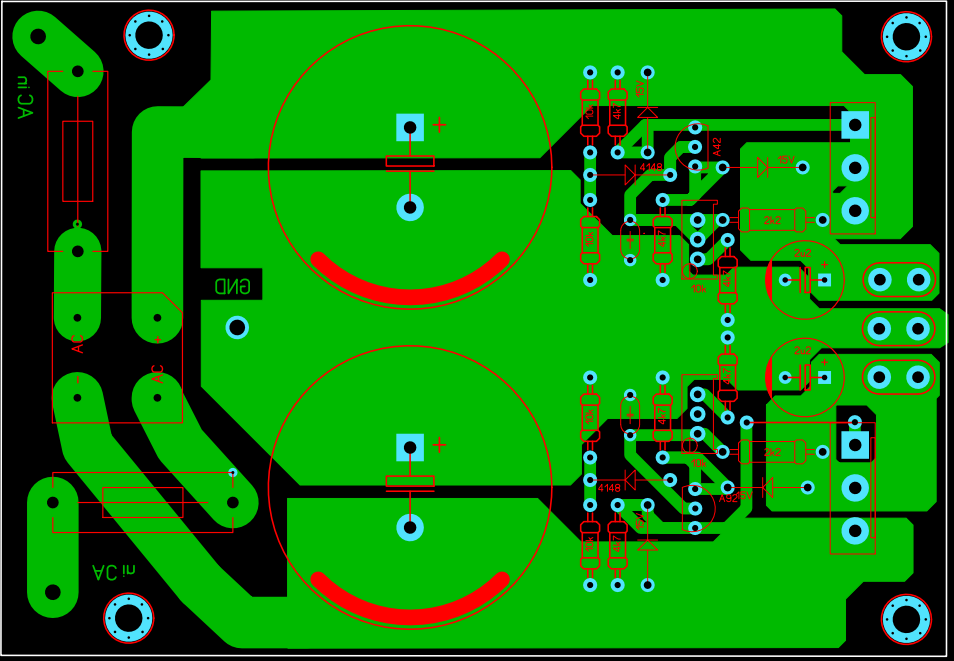

@Still4given I managed to get the pcb layout last night, its in the print screen, which I can also mirror for iorn on print
I'm not sure we should clutter up this thread with software issues. You dont have to mirror the foil print since you are looking through the board.
