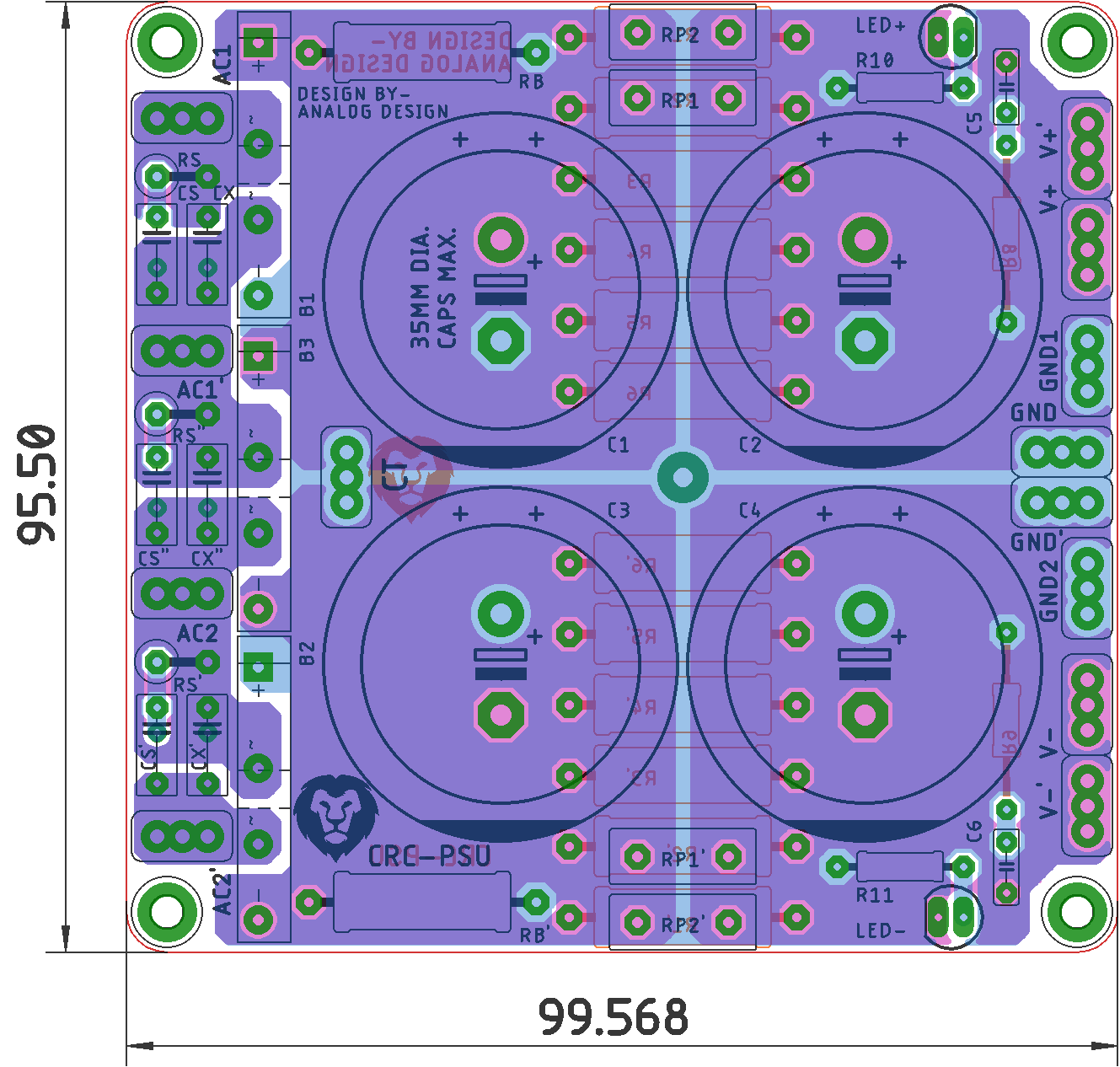

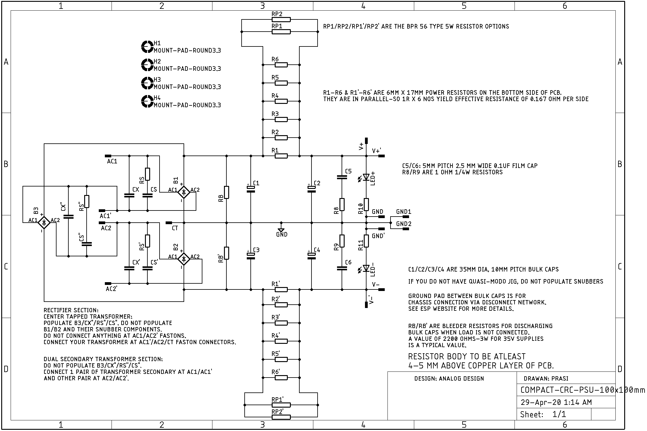

I see text on above CRC pcb mentions 30mm caps. $#%@. It should be 35mm.
here are revised files..
  • GERBERS-COMPACT-CRC-PSU-ANALOG DESIGN-100x100mm_2020-04-28.zip

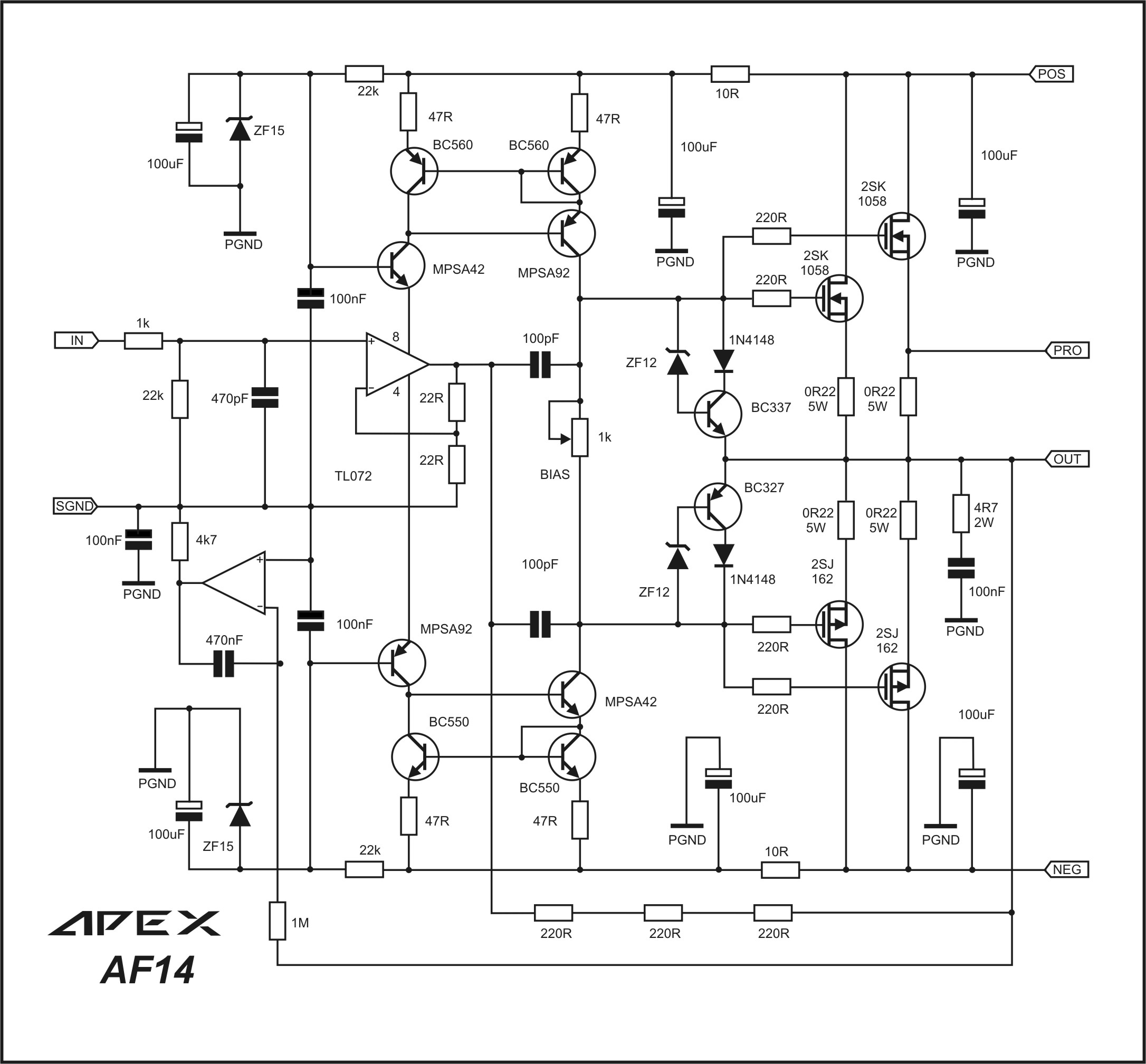

Hi all,
where are gerber files for ax-11 and ax-14 amplifier?
I didn't find them.
thanks,
Marco.
Dont know if gerbers for ax-11 are available, but here are all files for AX-14 designed by me. post no. 11462
100W Ultimate Fidelity Amplifier
the gerber files are shared on pcbway and the link is provided in the same post no. 11462. one can order pcbs with just few clicks.
regards
prasi
