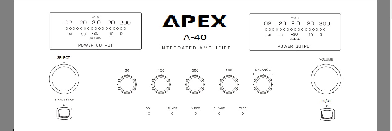

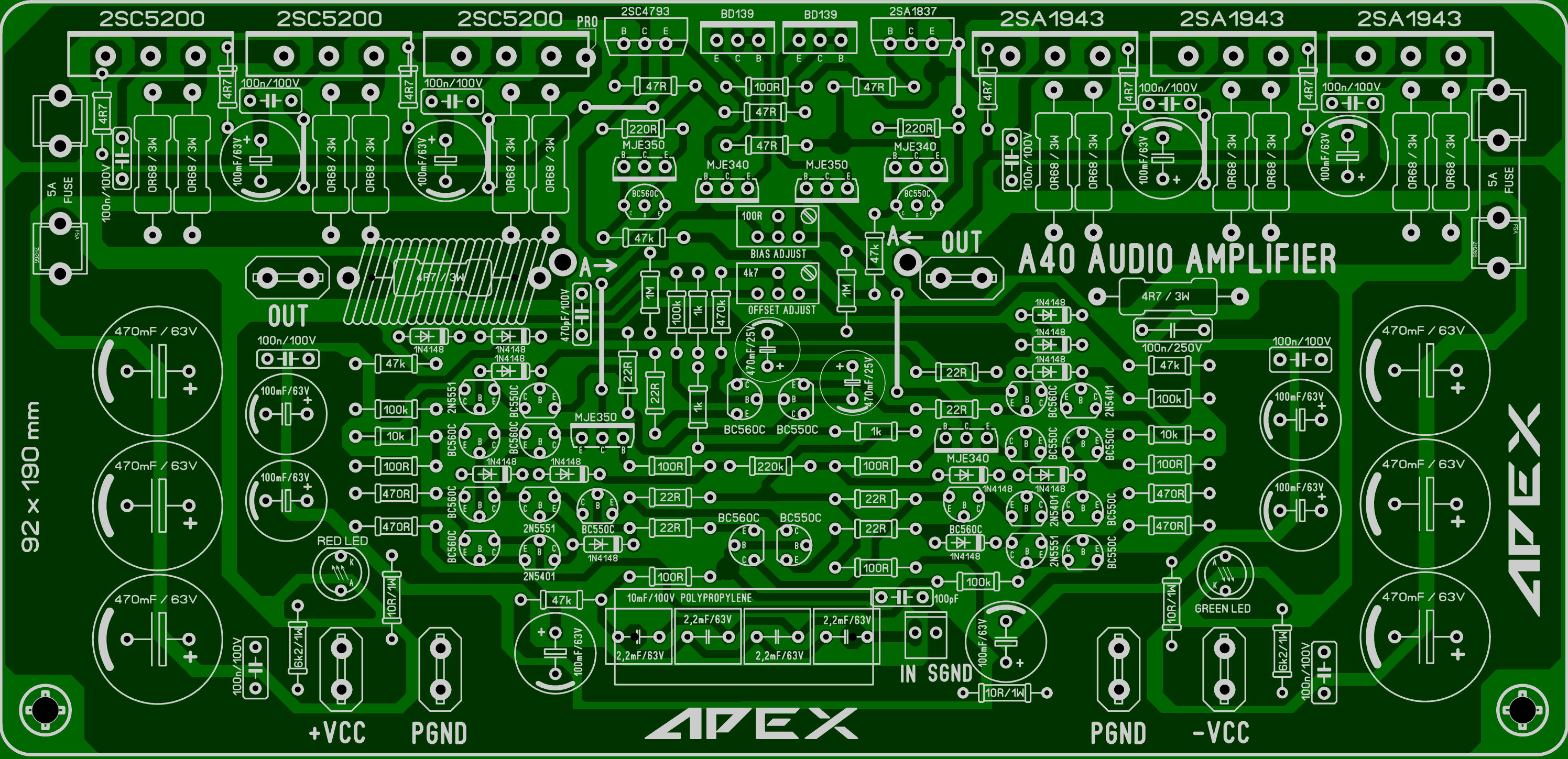

Hello everybody. Please tell me the parameters of the coil for APEX A40. I tried to find it by search, but did not find it. Thanks in advance.
I used this pcb:
20 turns on 15mm dia with 1,2mm wire.
Mile thanks a lot. And thanks for all that you do. With great respect, Evgeny.

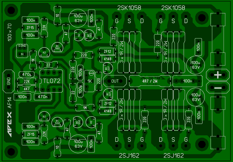

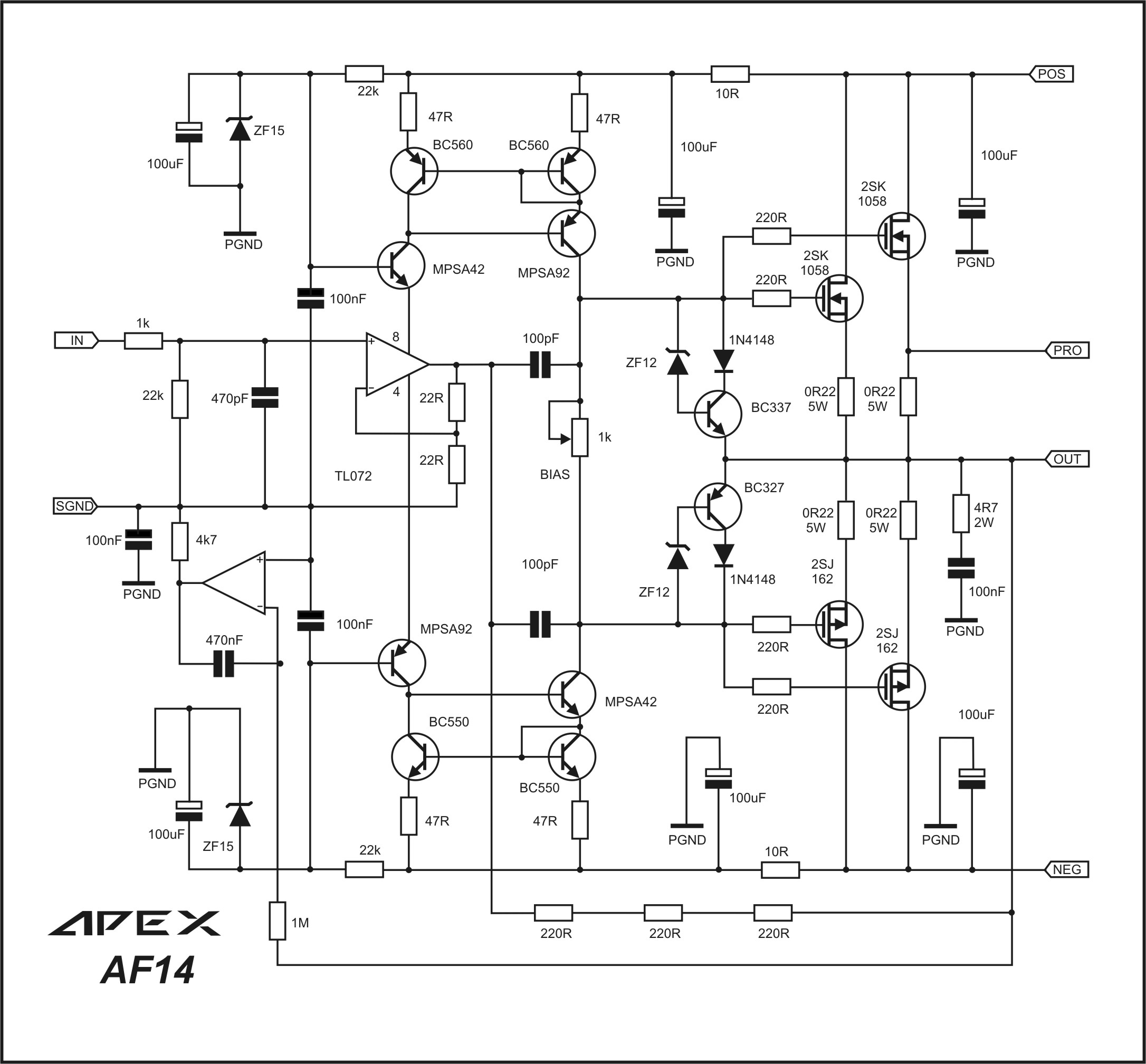

My contribution for APEX AF14
Nicely done kandimba! keep it up.
regards
prasi

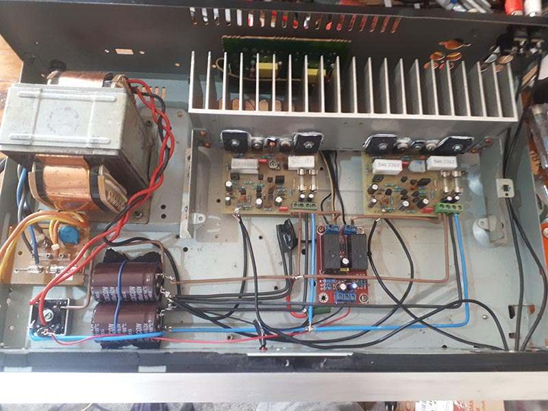

16+1 LED VU, CQ4 Equaliser, 5 input pot-relay selector...
Very nice , will look super on brushed silver alu panel.

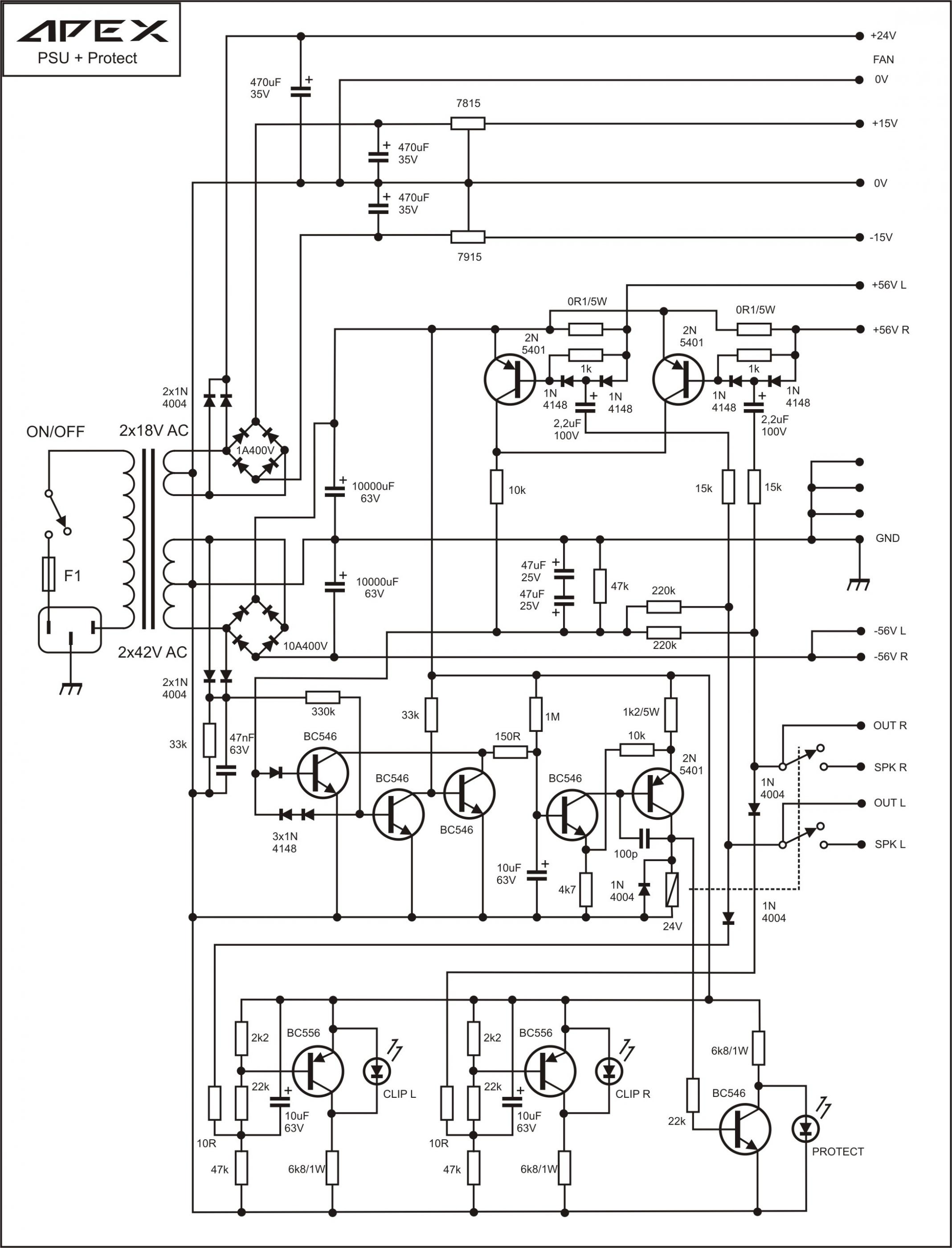

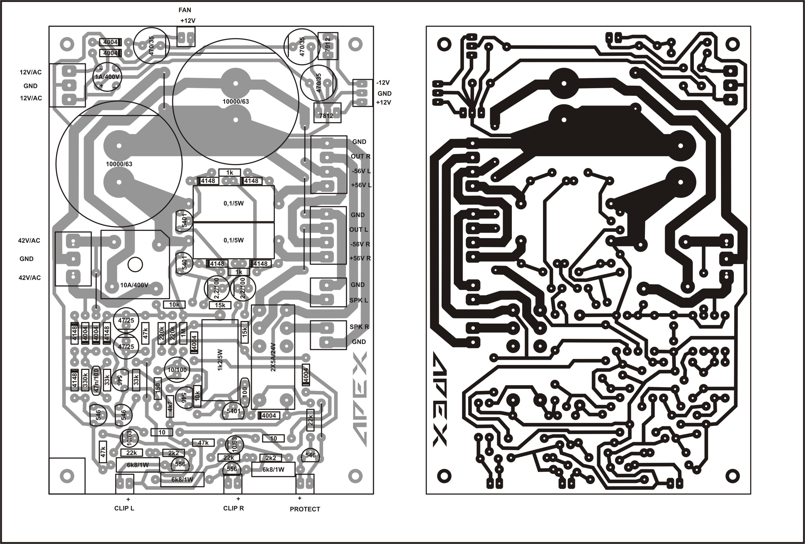

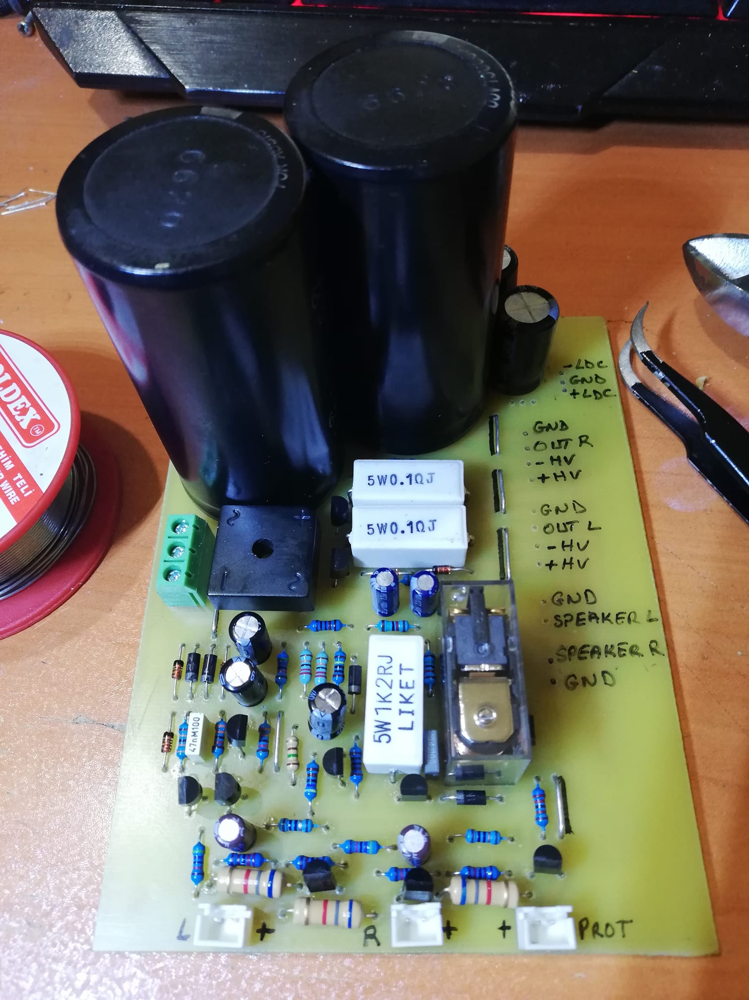

f100 fx100 psu
hi all and mr. mile
i was making f100 psu i finish the pcb but its too late i see there is another same psu just changed protec fx100. f100 not recomended for use long time? or is it not safe? i will use it with ax14.
can i use f100 psu or need to make another pcb for fx100 psu.
thank you.
hi all and mr. mile
thank you.
hi all and mr. mile
thank you.
You can use f100 psu.
ty for answer mr.mile
