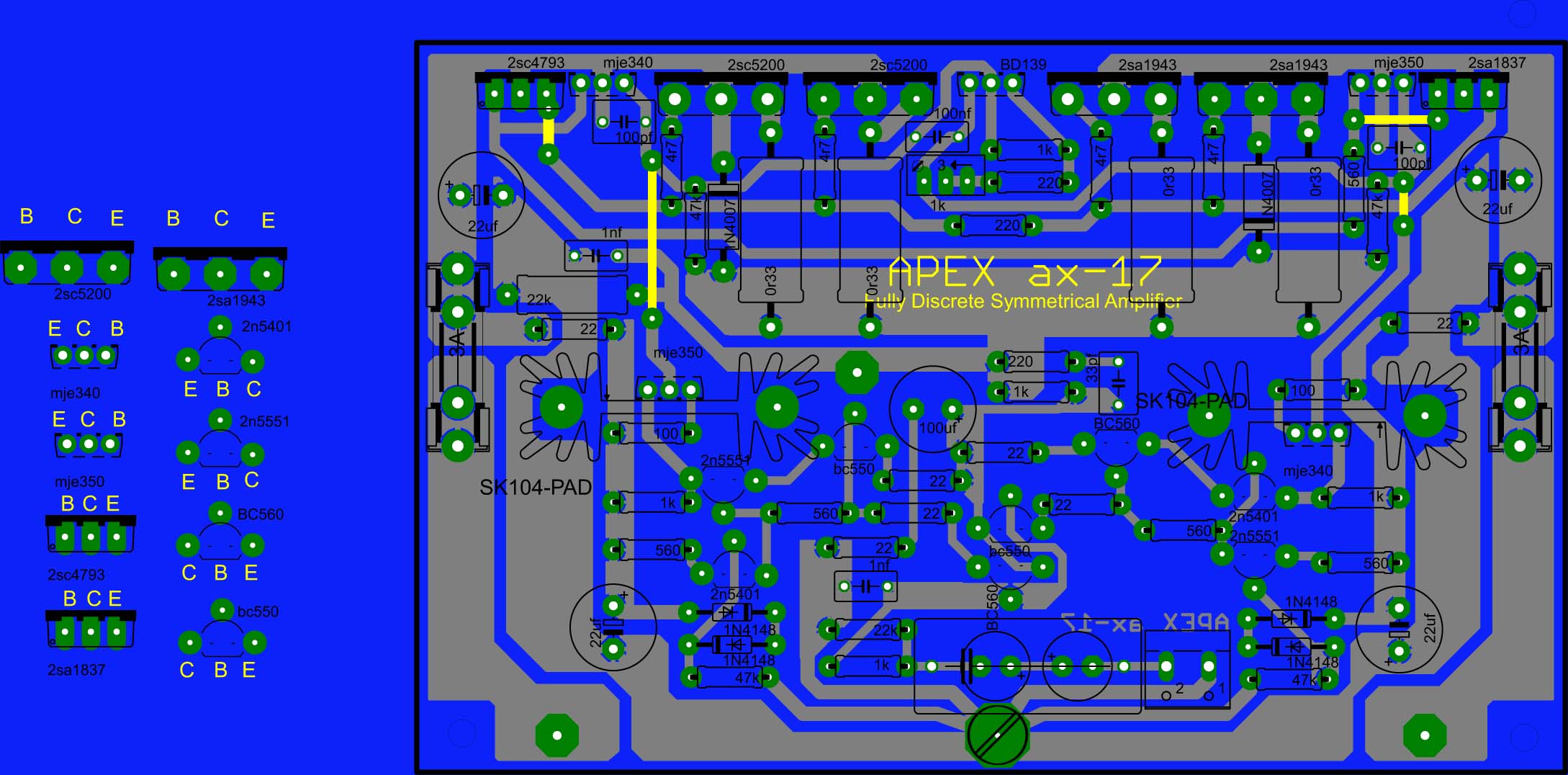

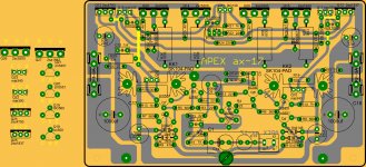

Hi Apex,
Is c10 and r29 in parallel?will there be no problem if I connected d7 and d8 in supply and output.I noticed in your schematic it is in series with resistor emitter.
regards,
joel
Just finished putting together AX17 as per post 1248. Replaced R13 with 2k pot to adjust DC offset to 0V. It works but for some reason can't adjust bias above 13ma (130mV across 10R instead of fuses) and Vbe on BD139 only 0.66V??? Checked everything twice and can't figure it out. Any ideas?
