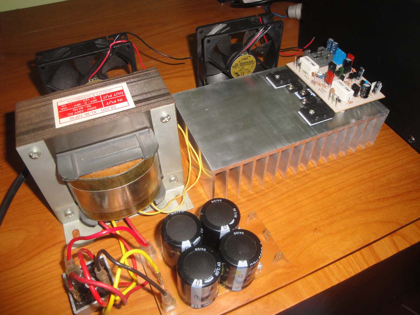

hi apex sir,
one channel ax14 finished,
supply voltage 50vdc, dc offset is 5.5mv,. no on off thumbs. thanks for the pcb.
one question, what is the ac output for clipping.?
The heat sink is for two channels.
OK, but even with this huge heatsink, do you think a fan is really necessary?

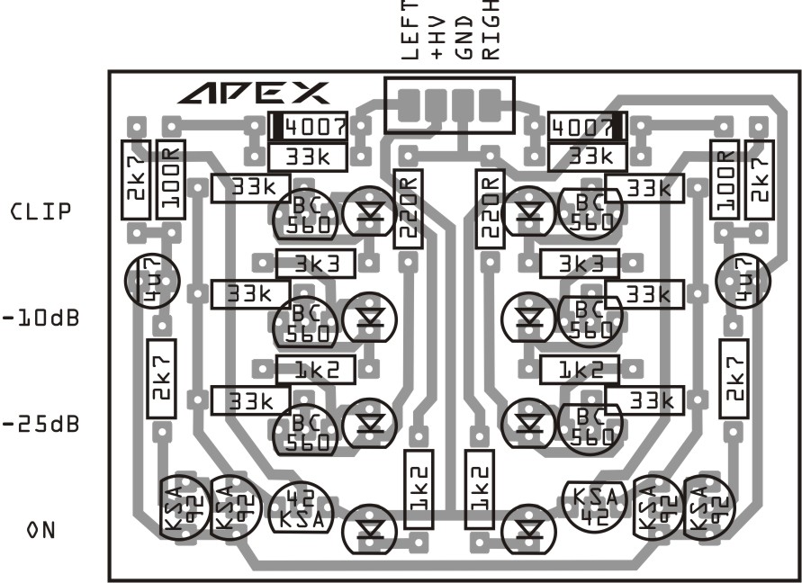

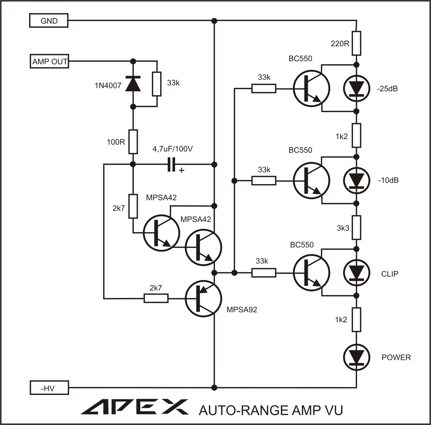

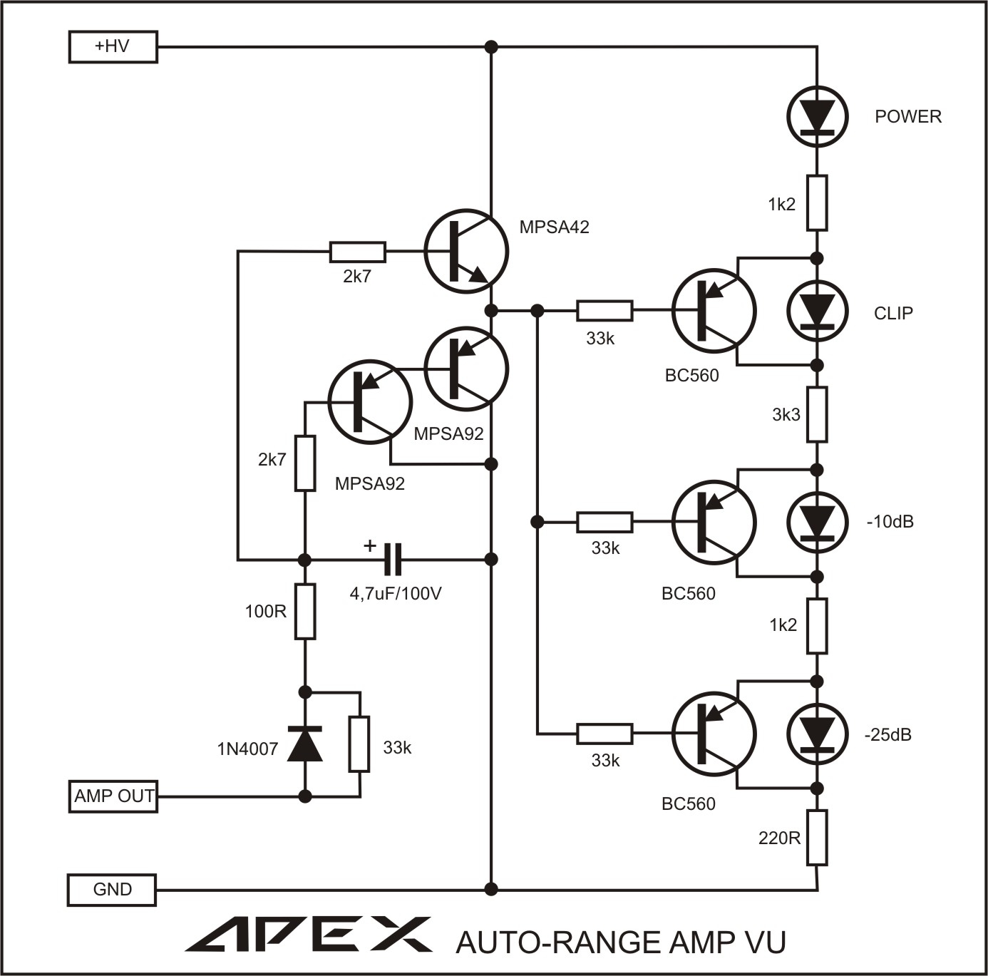

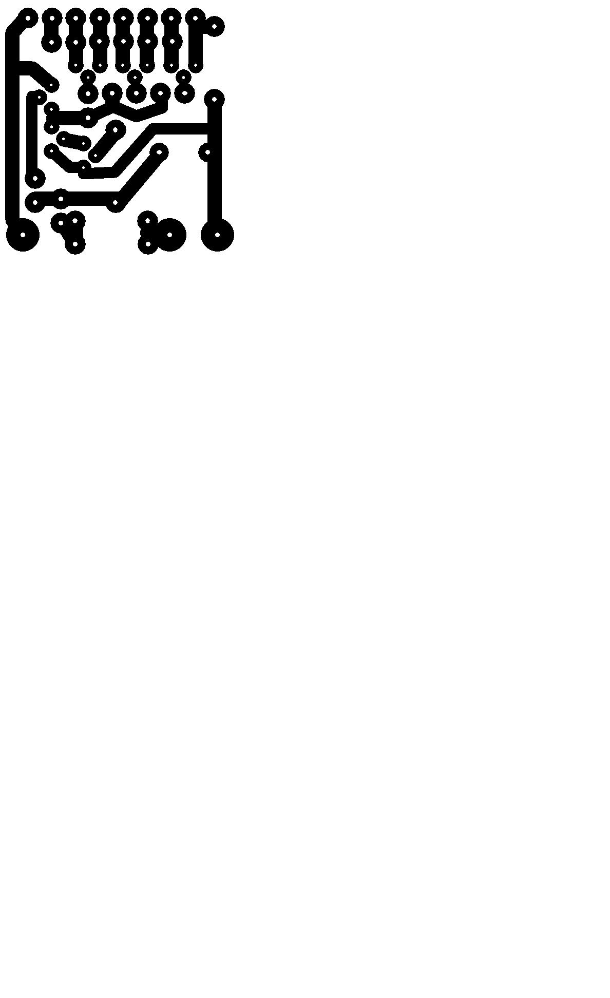

hi apex sir,
is this vu meter compatible with ax14,
in the schematic -hv typed, in other image +hv which is correct?
This is what you need:
And this...

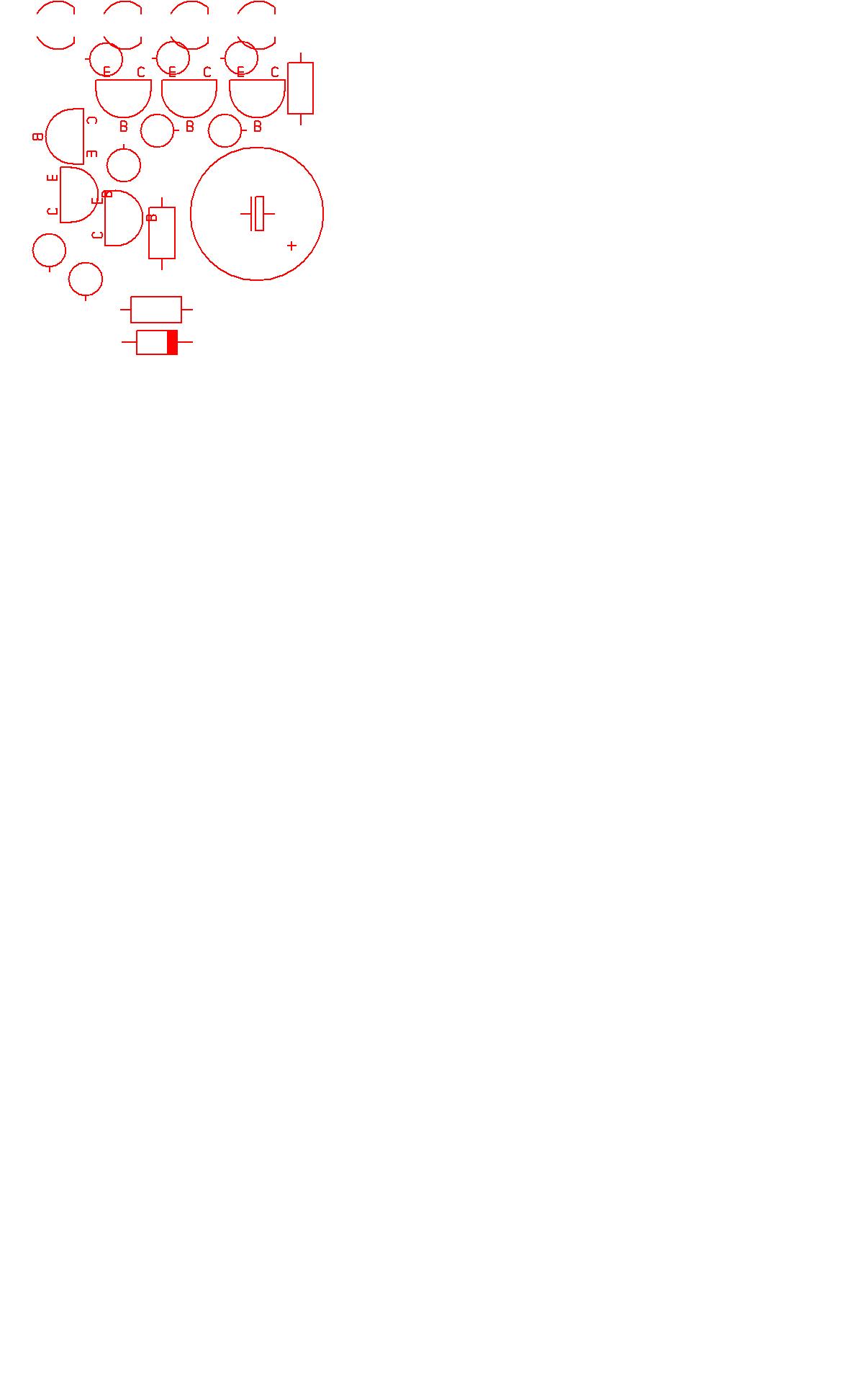

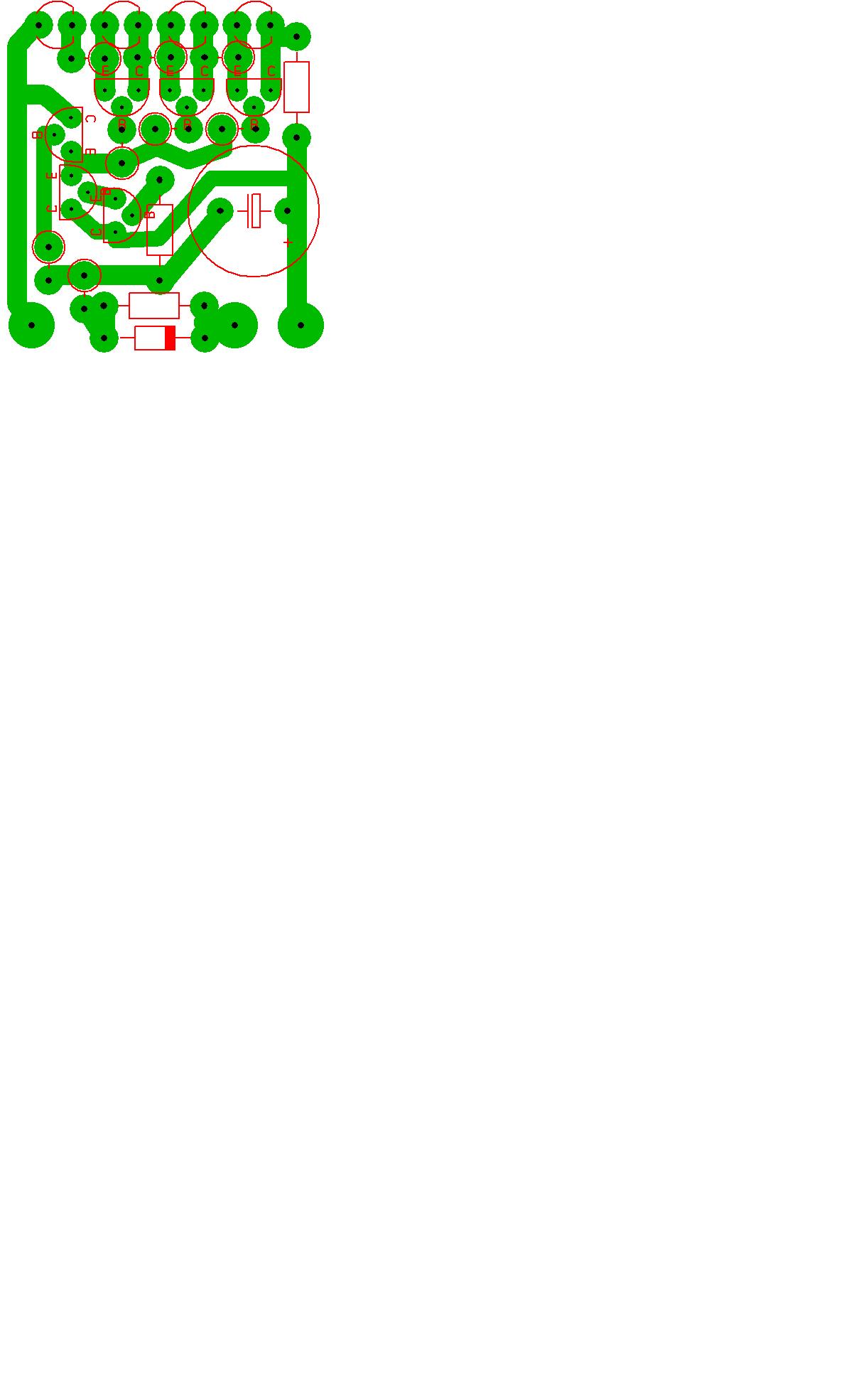

thanks for the reply 44250,
pls , if u can, share the top and bottom layout in pdf.
I would but i don´t have it,these files were downloaded from one of our forums in Serbia and the type of file is not supported by this forum here.
I have JPG. and dimensions,pcb´s are 27x25mm,and the Youtube link is this Video0035 - YouTube
thank u 44250 for the layouts.
can u give me the website. (forums in Serbia).

Nice work, with +/-50V rail voltage AC output voltage for cliping is 28V,
VU is compatible with any amp, there is two schematics with positive rail suply and negative rail suply, you can use any of them.

can you share PDF of PCB?
You can find pdf files in attachments
sorry!but topic is verry long!I cant find it!
