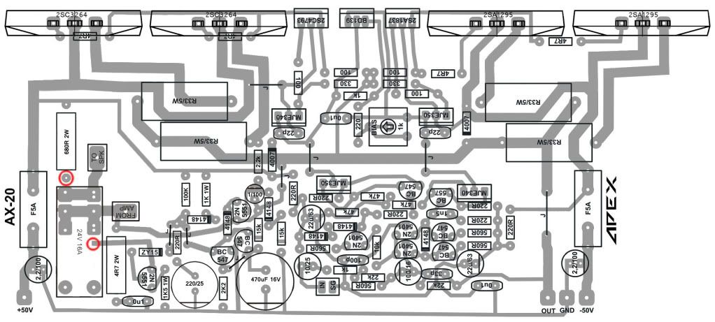

Good to know that those sanken parts should be ok. I've had a slight redesign of the PCB so that it matches the schematic for the AX-20 protection circuit. I've also noticed that there is a PA protection circuit called the H900 that may also be used. There are too many options and i lack the knowledge/experience to know which is best.
anyway this is how the pcb design looks now. (should be an exact match for the schematic now)

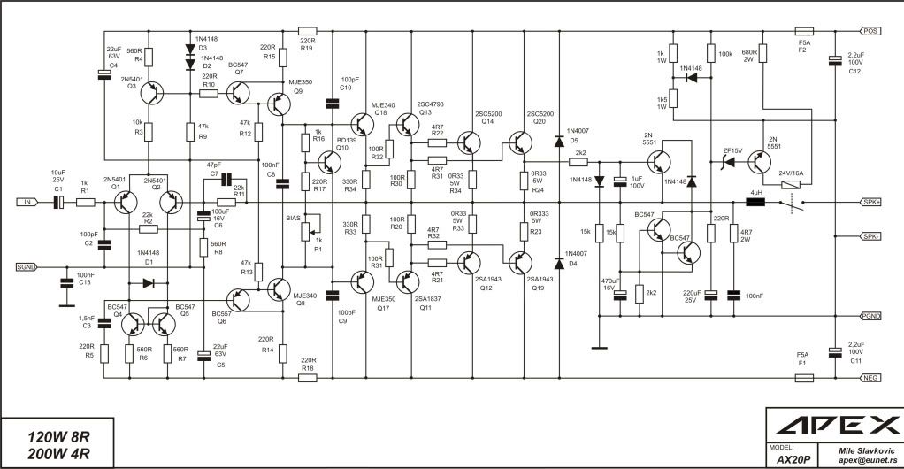

If i incorporate the changes you've made to that AX14 design into the AX20 will that negate the need for the extra protection board like the H900/PSU-7?
Been looking at suitable transformers today, what would the maximum input voltage be for the AX20? I've been looking at 50-60Vx2, 500-1000VA transformers. (or potentially running a 25-30V transformer with the outputs in series to double the voltage.) Would it be better to use the 50-60V transformer and have 2 separate rectifying/filtration boards or a single board using the series wiring of the secondary windings? (I reckon the separated supplies myself just want to be sure)
If you incorporate the changes into AX20 PSU (+/-60V) is only that you need.
OK, greatly appreciate the guidance here. This is how the schematic has come out.
I've got so far with a rough construction of the pcb but got lost at the relay. I've circled the two bits that have got me slightly lost.
Oh! That would be great!!!😛Schematic of AX20P is OK, but you have lot of work on pcb, maybie 'alex mm' can help you 🙂
Yes I think a more experienced PCB designer is needed here. I've got the AX20P schematic drawn up in Livewire and the basic version without protection drawn up in ExpressSCH if it helps.

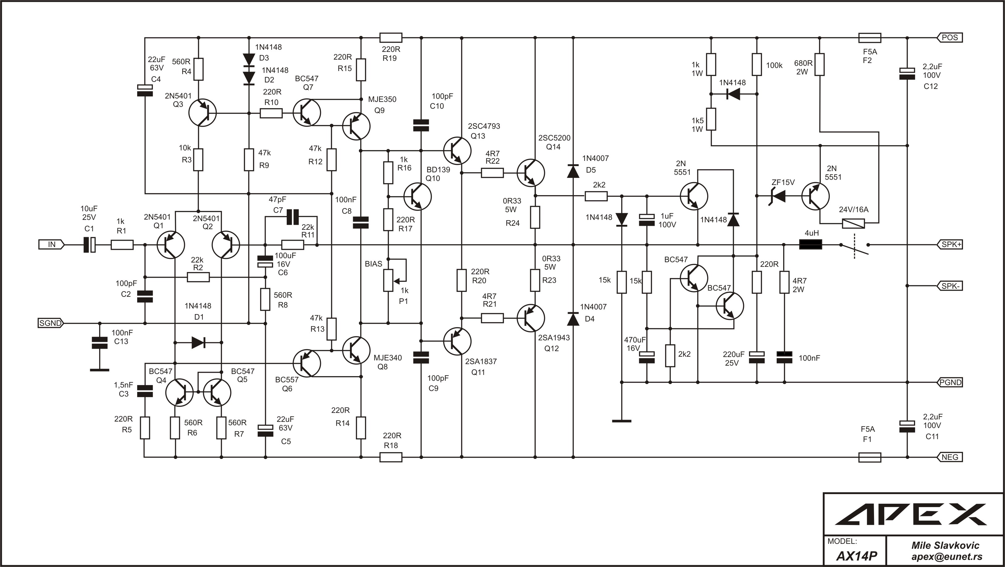

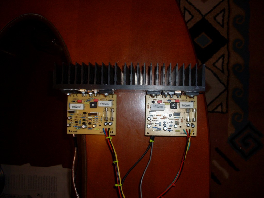

Can i use 2n3773 for the output stage(quasi-complementary) for this ax-14 amp
then voltage will be limited to how many volts for two pairs??
I suggest http://www.diyaudio.com/forums/solid-state/167394-quasi-amplifier-beginners-56.html for 2N3773

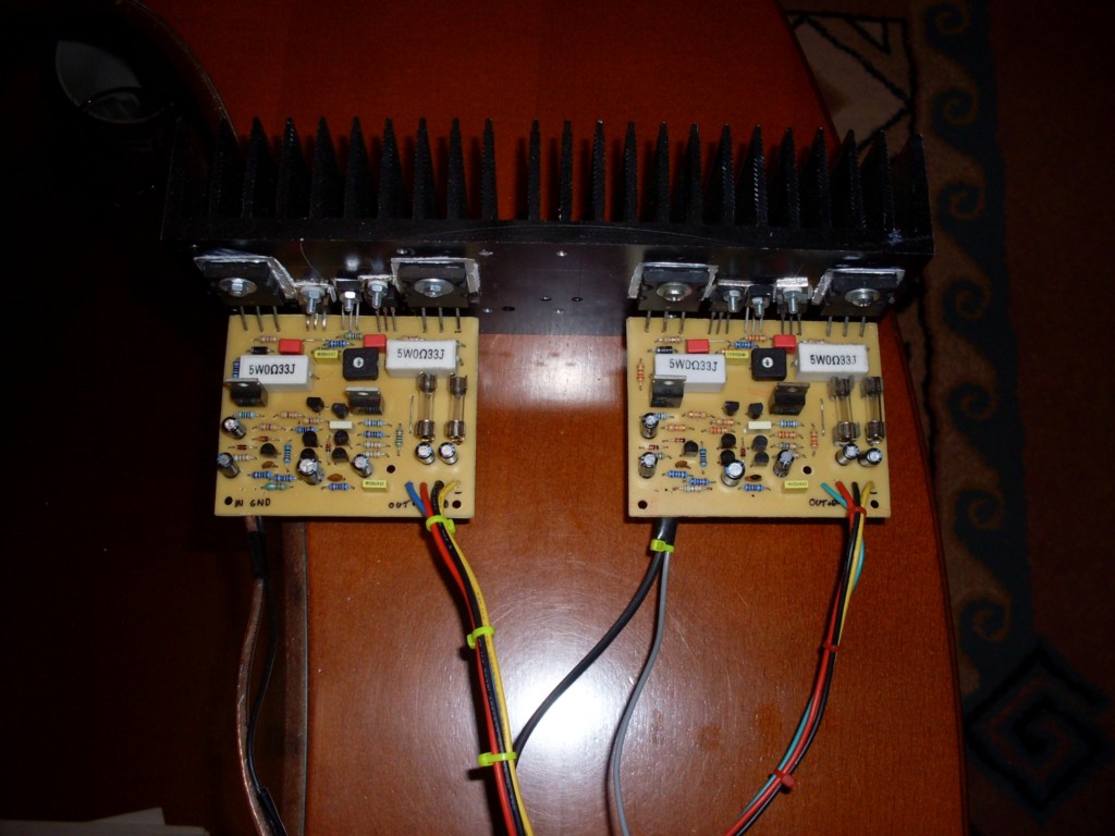

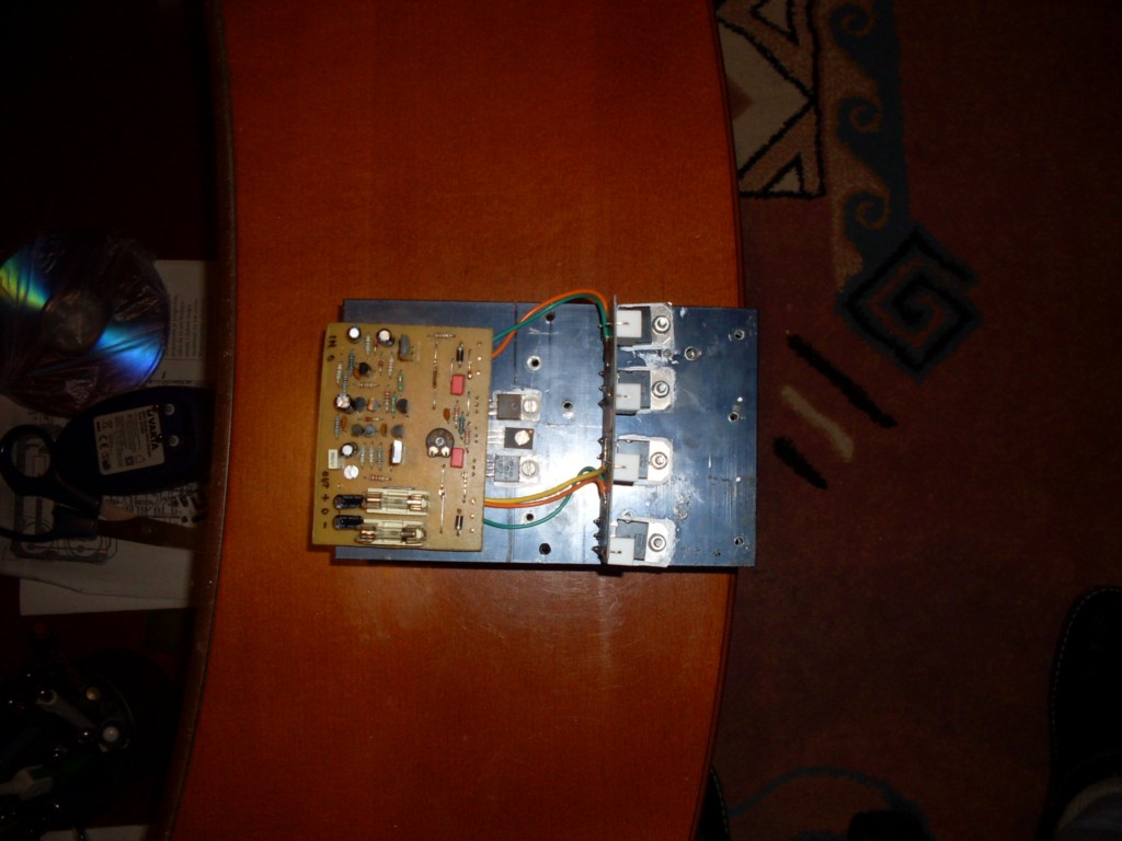

Also AX-14 with 2 pair of output transistors. Can I use this on 80w/4ohm speaker, for PA or I need to add more outputs? It is working on +/-35V DC and bias is 60mA.
AX14 working on +/-35V can be use with 4 ohm speaker with single pair of output transistors, with 2 pair can be use on 2 ohm speaker but need fan cooling.
What would be benefit of using two pair of output transistors (mjl21193/21194) and +/-50VDC supply? No doubt in sound quality,what power could be reached with 4 and 8 Ohm load?
