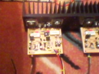

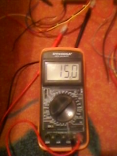

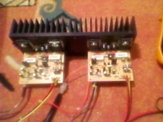

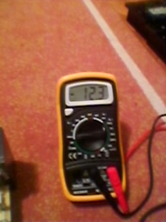

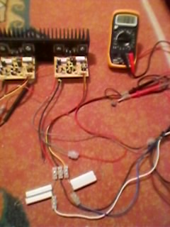

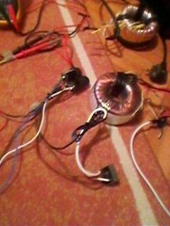

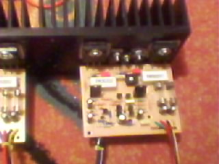

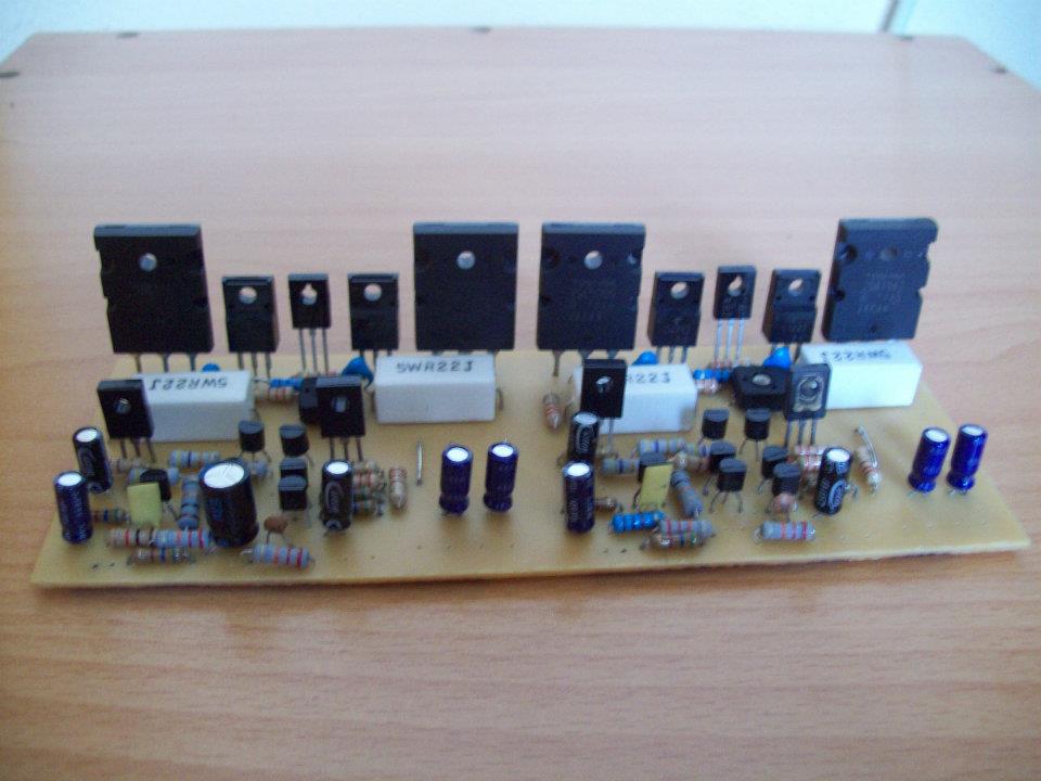

My AX-14 with 2SC2073/2SA940 (150V,1.5A, 25W) drivers, also these transistors instead of MJE340/350. Output tran. 2SC5200/2SA1943. Sorry for low quality pictures from my mobile, will post tomorrow beter with digital. +/- 47V power supply. Bias set to 15mV. DC ofset -12V and -17V. Also I didn't have 152 capacitor, so I put 1nF/100V. Zobel on output 10R/2w and 100nF/100V. Apex, Sir is it good 10R/2W I have also 10R/5W? Do I need to put some L(calem) on resistor 10R? Sound is great, clear, powerful bass, a lot of high...

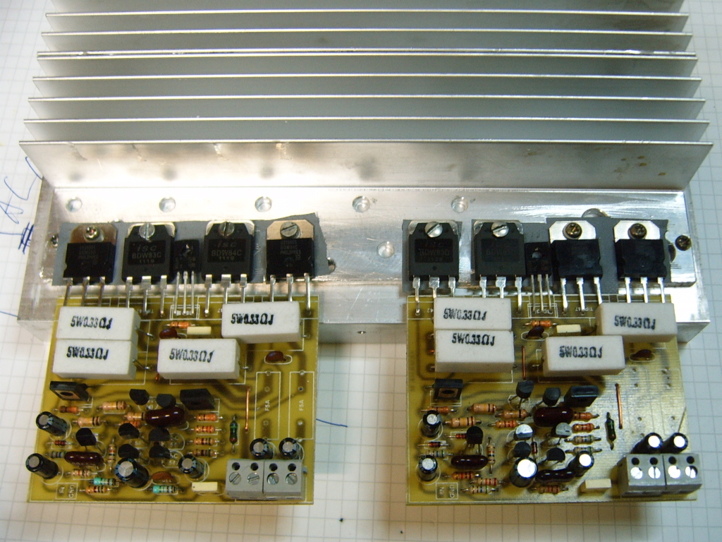

Been looking at building a power amp, quite interested in the AX-20 design. Made up a pcb drawing for sanken 2sa1295/2sc3264 from Qq12e5k1's original. Not sure if it's correct yet though. (not had time to double check it) This is by far the worlds neatest pcb but as its my first time doing this it wasn't necessarily going to look beautiful.
Labels on the Q12/14/19/20 are still 2sa1943/2sc5200. Q20 label is missing)
