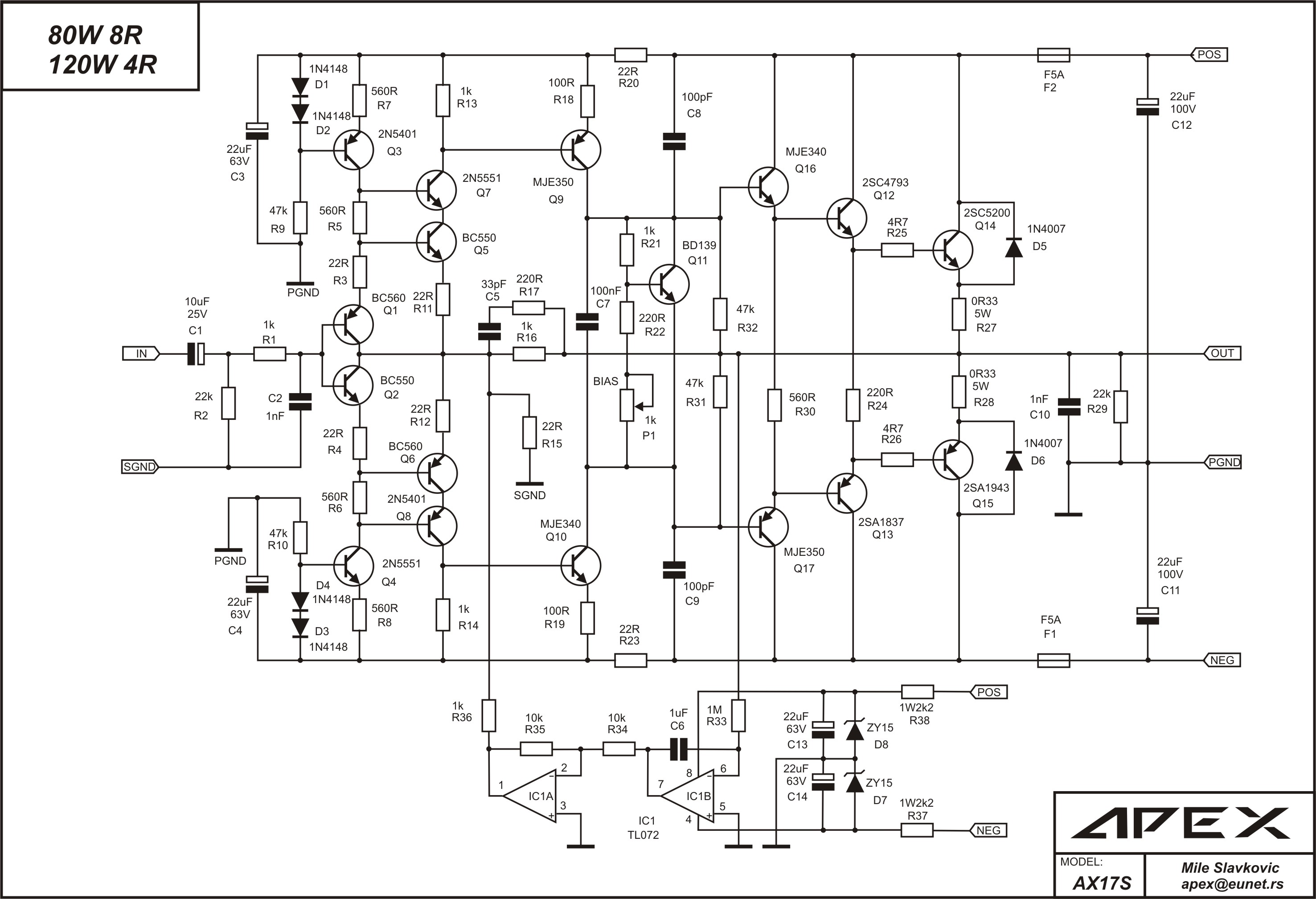

Mr. Mile,
today i test my dc servo with tl072 and yes it work!,
i've removed 220uf elco.
value for pin 1 and 2 was inverted
value for pin 1 and 7 was inverted
and dc offset between 0.9mv to max 3.9 mv.
and now waiting for better lf412.
Please change and revised your ax17s schematic so other builder will get benefit from my experience with ax17s dc servo problem.
do i have to change R36 1k to 10k as you suggested in previous post?
thanks and regards.
naf
