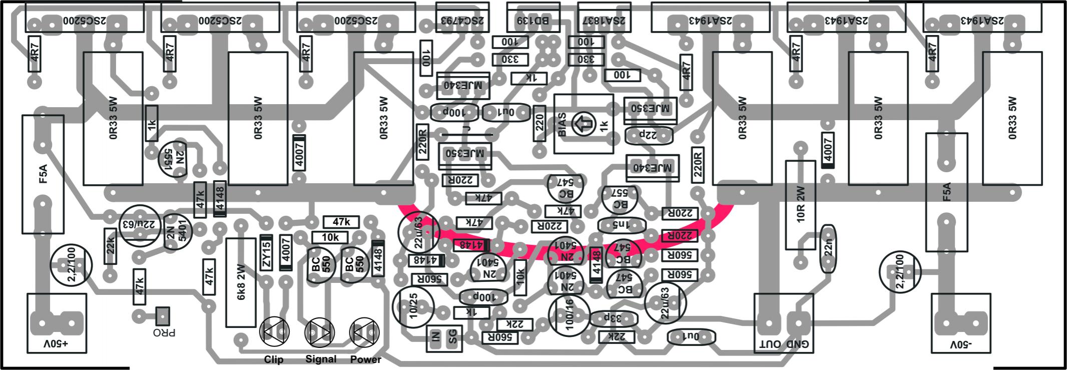

this is what i've measured on NE5532 pins
PSU GND to pin:
1. 61mV
2. 1.4mV
3. 0mV
4. -15.64V
5. 0mV
6. -0.8mV
7. -63.5mV
8. 15.68V
Input GND to pin:
1. 61.6mV
2. 1.5mV
3. 0mV
4. -15.65mV
5. 0mV
6. -0.8mV
7. -62.6 mV
8. 15.67V

1,5mV on inverted input (pin 2) and 61,6mV on inverter output (pin 1) is wrong. Output (pin 7) of second inverter is ok -62,6mV for 61,6mV input from first inverter output (pin 1).

thanks Mr. Mile. what it's should be value for pin 1 and pin 2?
Value isn't mater, but must be invert polatity on output.

thanks, i got the point.Value isn't mater, but must be invert polatity on output.
i 'm waiting for lf412 and lf353, hope my dc servo will work.
