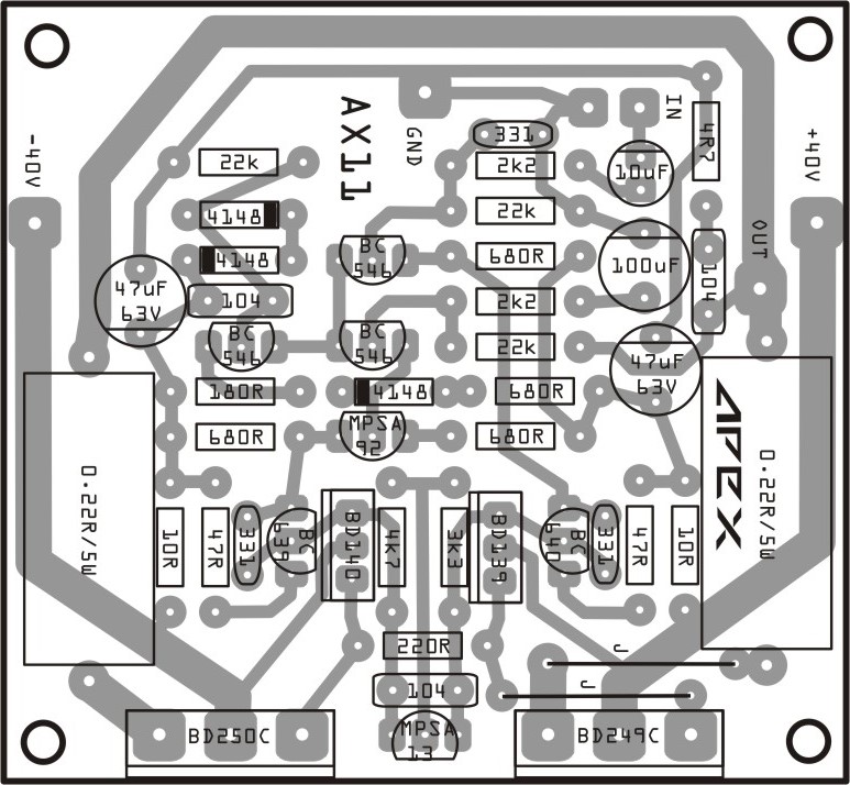

you can help me with the bias adjustment on these amplifiers 20190221-133714 — imgbb.com
20190221-133658 — imgbb.com
bias transistor should be mounted on a same heatsink with output transistors and driver transistors. mounted as it is now it will not work because bias transistor can not detect heat from heatsink. start with that...
https://i.imgur.com/q1koumg.jpg I mounted the radiator but it does not heat up anything. The only transistor that heats up is mje350
Change 1K5 resistor near BD140 to 2K2 or 2K7 then adjust bias.
in the schematic is bd139 not bd140 thanks for the help
Ohh! sorry careless mistake.
