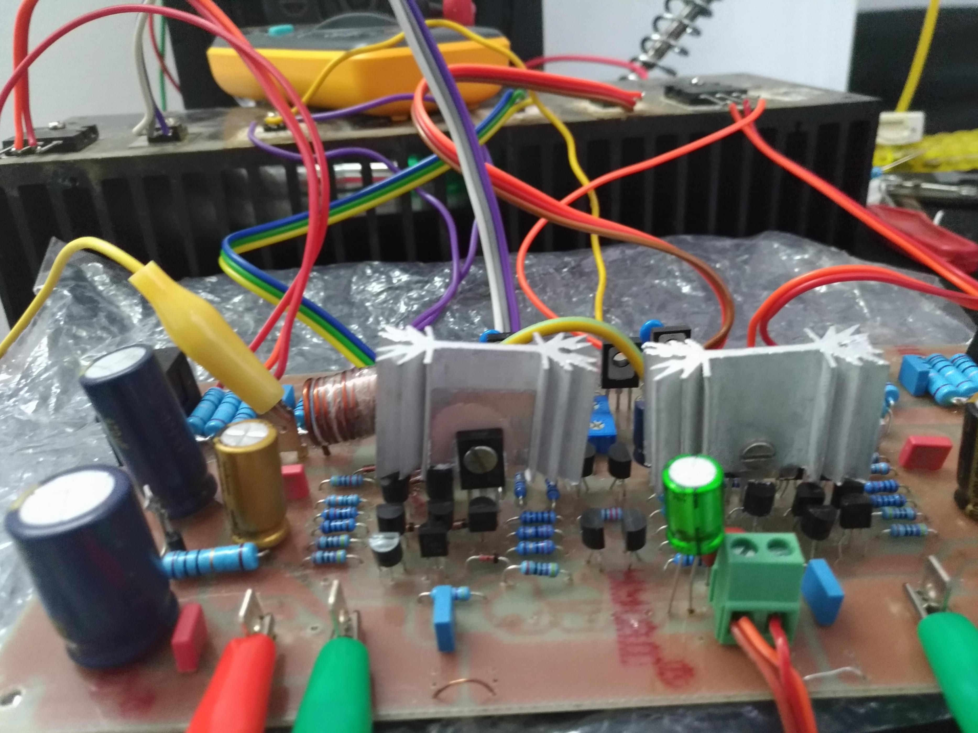

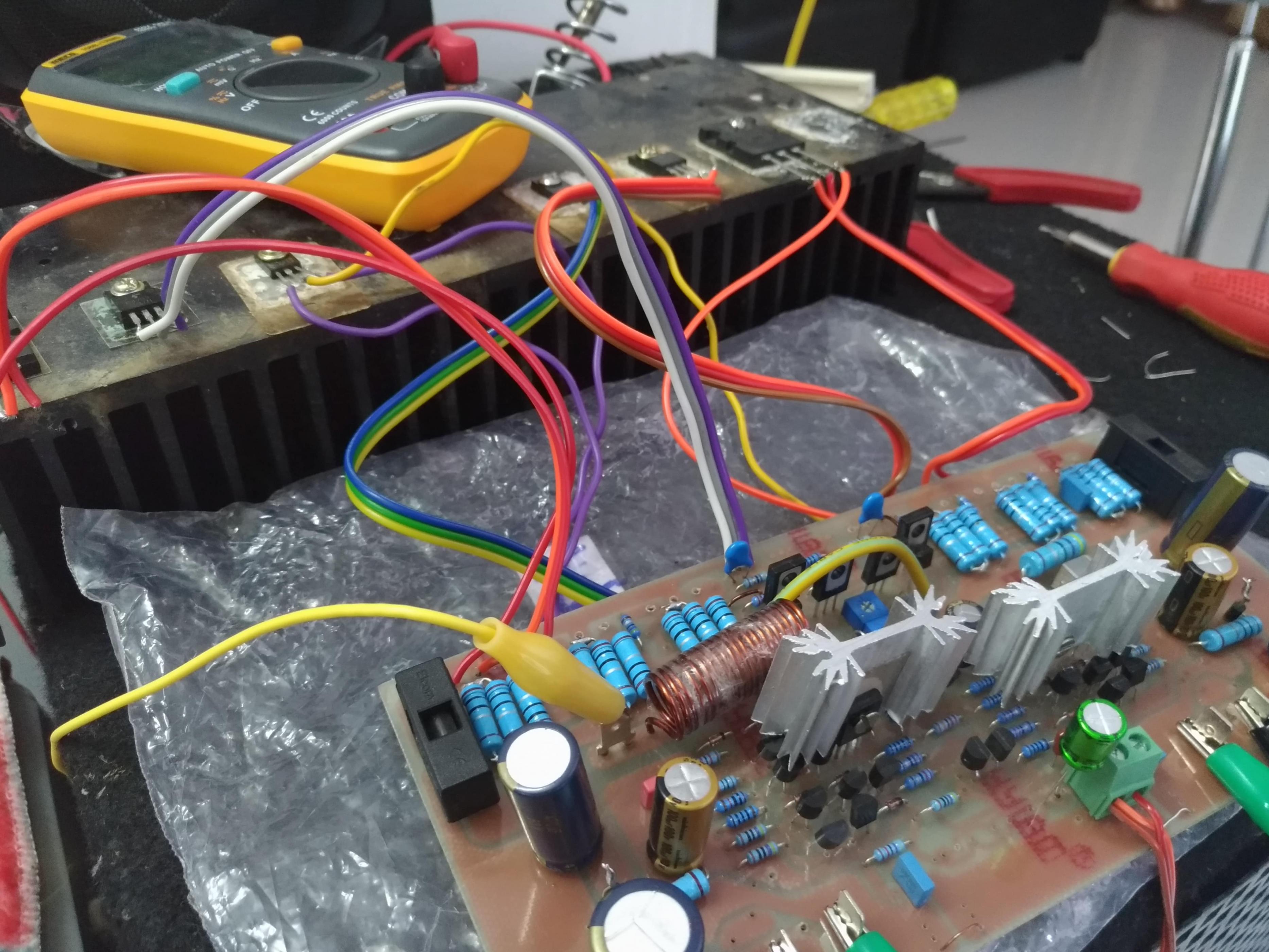

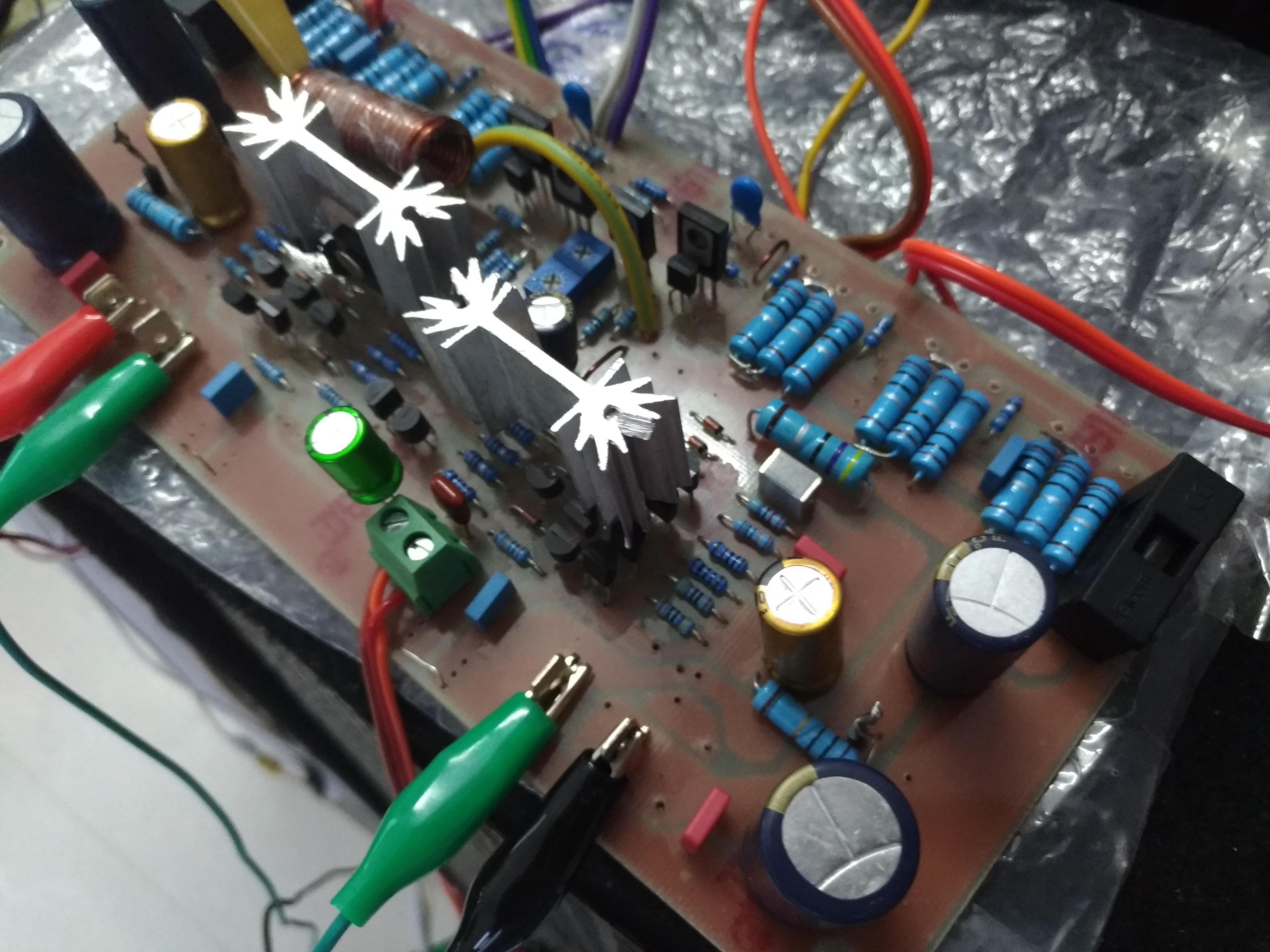

my investigation with sick chanell A40 continue.. so, i found microscopic interruption and this cond wasn´t connected.. when i mesure it and make pressure it was then wasn´t... very strange eror... so i think this is it... i have to wait for my new scope to confirm it... do you think tha could be this ?

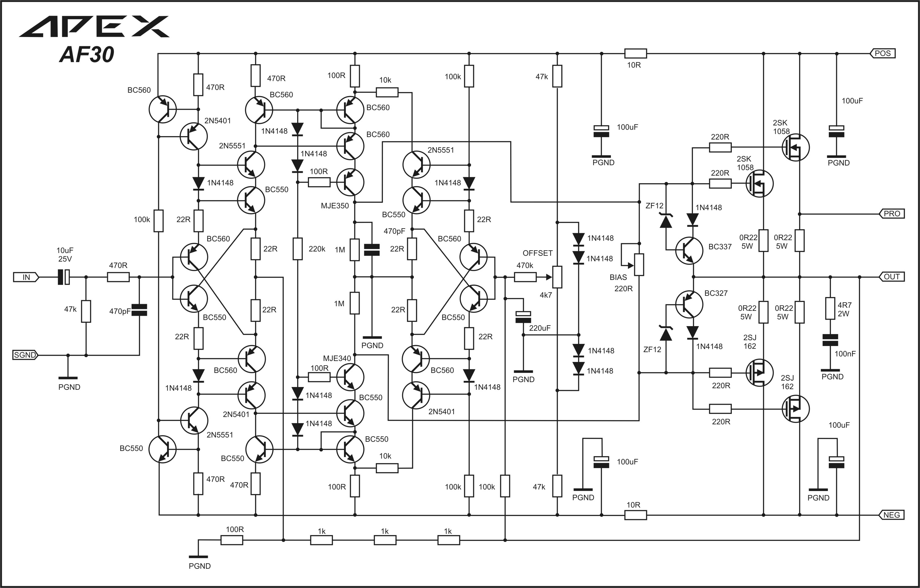

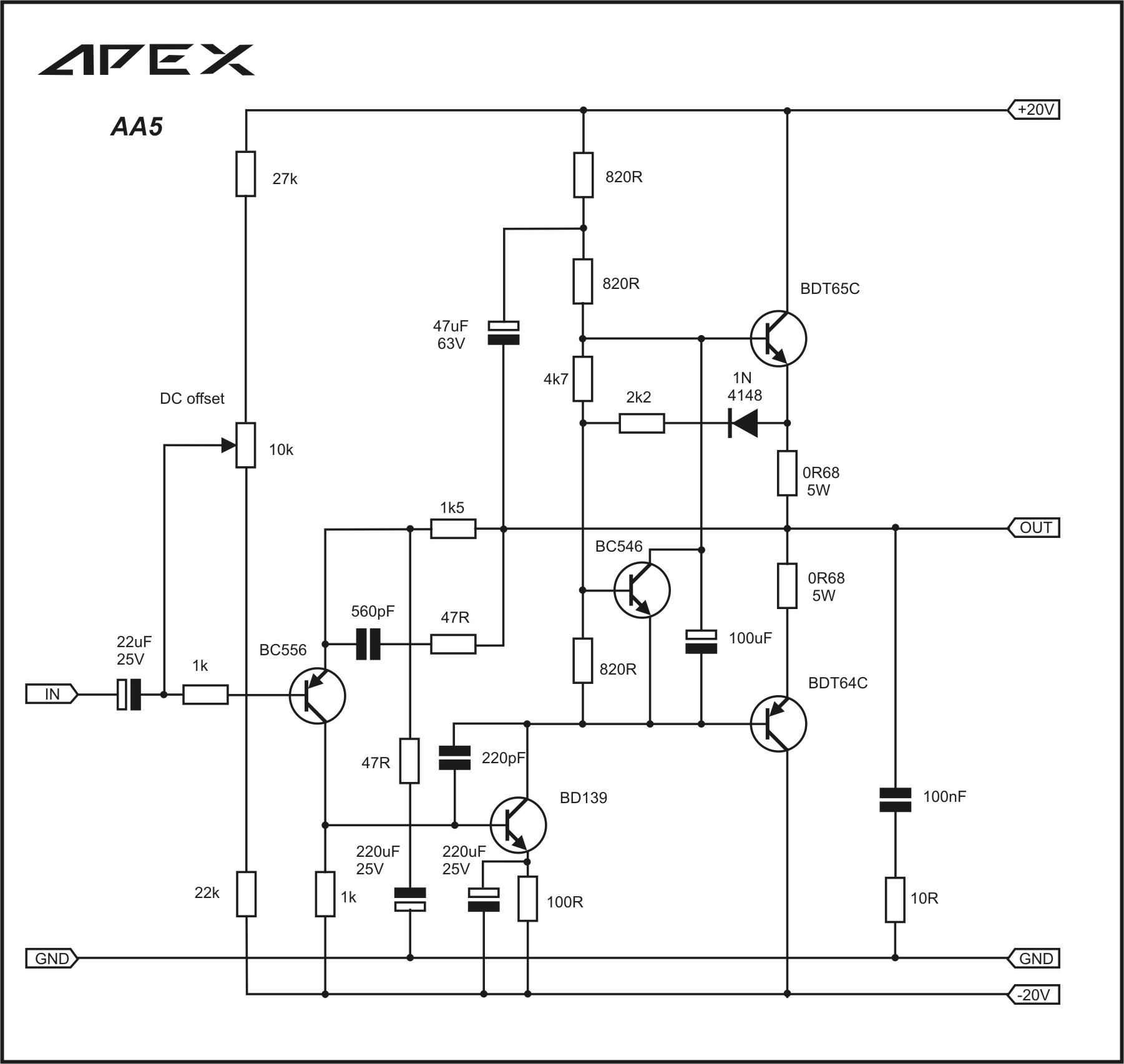

resistor above that 220uF should be 470kOhm,not 470 Ohm. also,at input should be 470 Ohm instead 100 Ohm and 470pF instead 100pF. you have put shot-wire instead of one capacitor? AlexMM had used two 470uF instead one 220uF,so one connection should be short-wired and 220uF capacitor should be mounted in such a way that his minus is connected to GND at pcb. on my pcb i used left capacitor place to make short-wire and right side capacitor to put 220uF with its minus placed to look at simetry trim-pot,and plus faced to input capacitor.

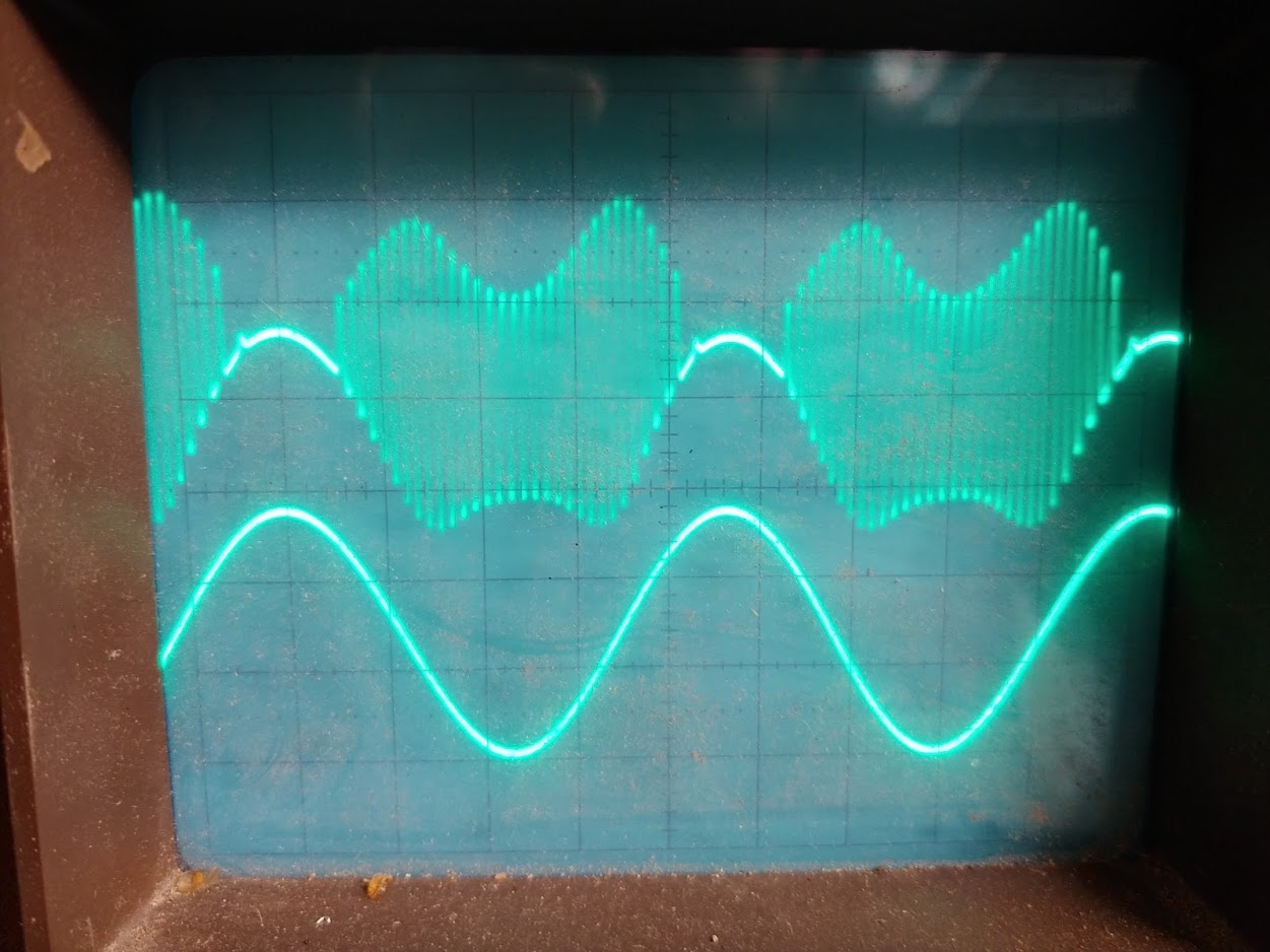

picture shows output signal?
(use this schematic: )
Yes. I have this values... Two 470u in series but one was not connected. Picture shows output before i found this eror.
Apex A40 build Success!! Thank you Mile!

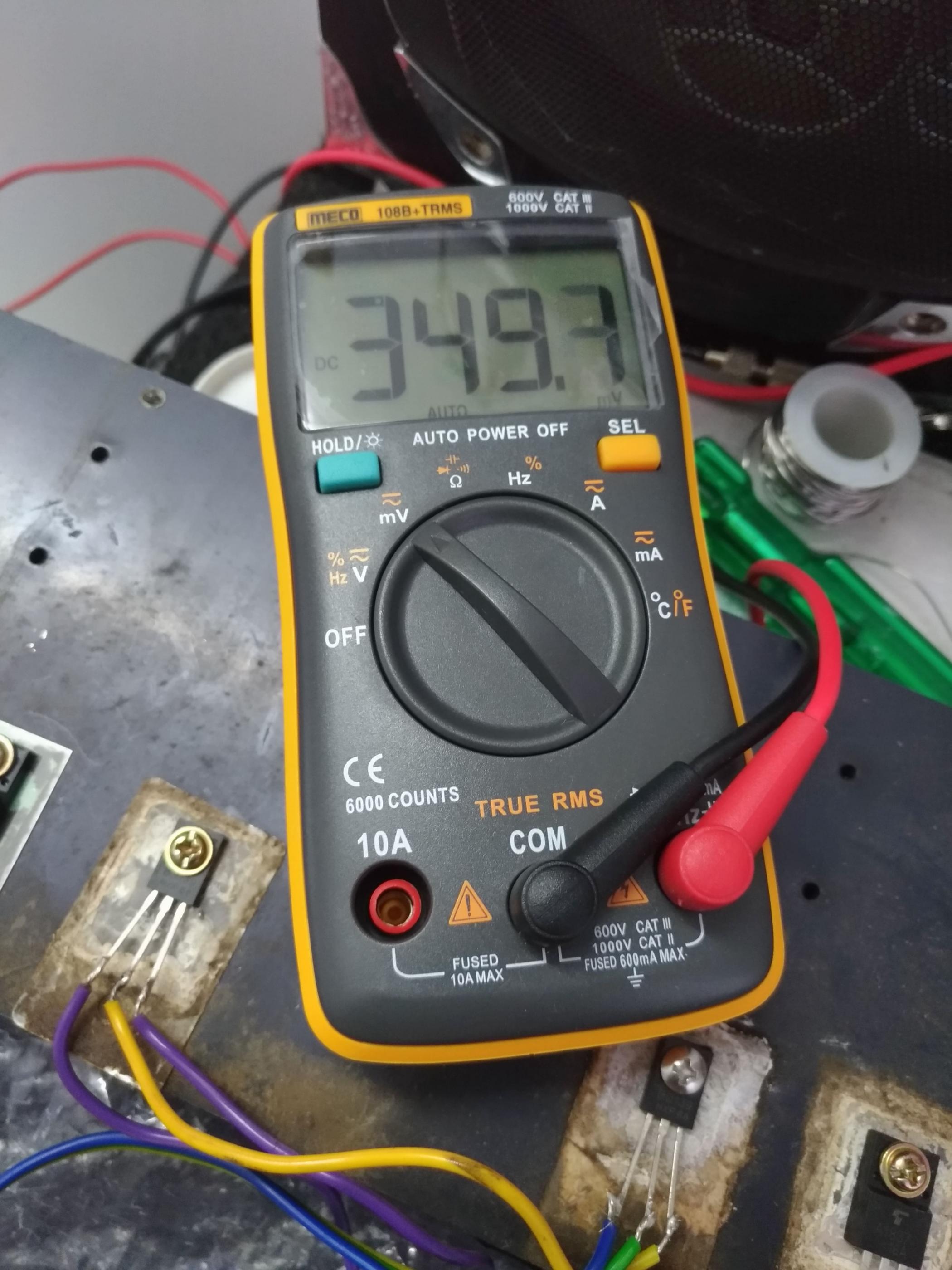

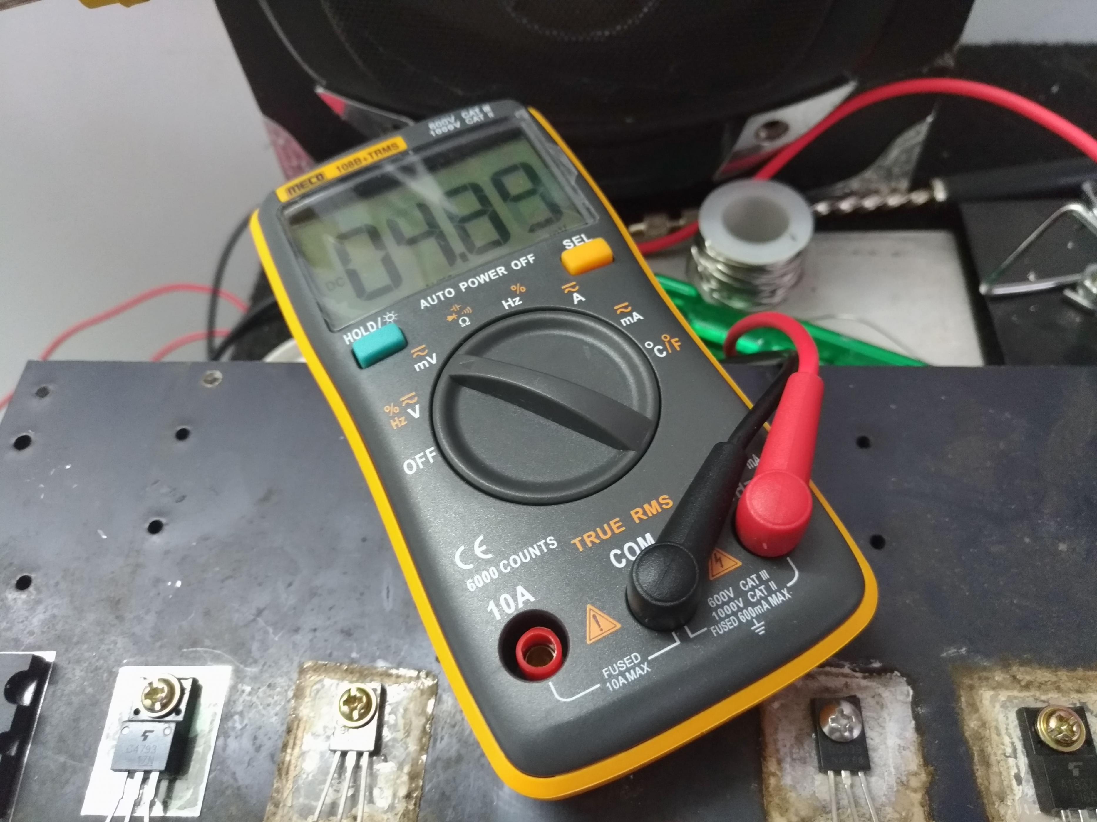

Hi friends,
I am excited to share my Apex A40 success story with you🙂. Being my very first discrete project, I am really lucky enough to get a positive result.
Thanks and Salute to Mile for his wonderful diy friendly CFA. Thanks Alex for the error free layout. Thanks Prasi and Bhushan for your inputs. Also a big thanks to Sumesh, for being a ring away and building my confidence 🙂 .
FORGIVE ME FOR THE DIRTY BUILD. I shall move the drivers and outputs to a proper heat sink soon.
As of now I have just connected a single pair of outputs with 30-0-30V AC x 2 trafo.
Below are the readings
DC Offset: <10mV
Bias: 35mA for a single pair(voltage measured across the 10 Ohm resistor connected in series with the rail shows 350mV).
One question regarding bias, what should be the ideal bias per output pair?.
Also, I have the stability cap 22pf connected across the collector-base of the drivers. Amp is working fine without those caps as well. Should I keep those caps there in, or to remove ?
I would be using 2 pairs of outputs with 39-0-30 Volt AC, 5Amps per channel. is that fine?
Audio Impression: Clean flat sound from my car speakers. Mid is very clear and open, love it. Waiting for good drivers to test it properly.
Once again Thank to everyone who have helped me directly or indirectly 🙂

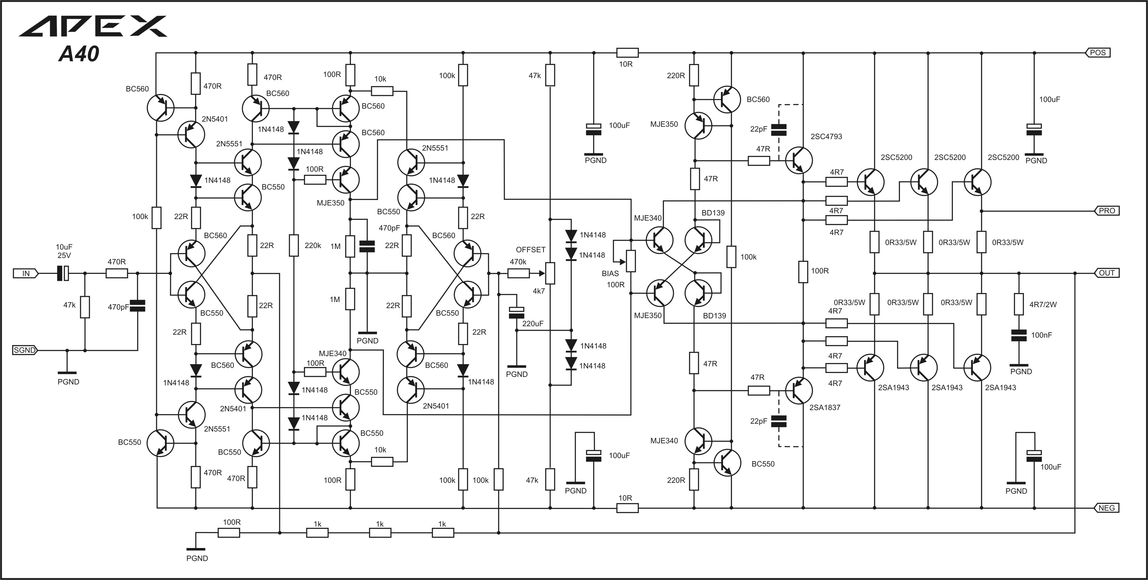

APEX A40_latest by mile_instability 22pf added_ same is with A33.JPG625.5 KB · Views: 461

Nice work, enjoy in best diy amplifier ever🙂
Regards
Thank you Mile 🙂 Excited!! Giving me the confidence to do more builds.
Could you please answer the below queries.
What should be the ideal bias per output pair?.
I would be using 2 pairs of outputs with 39-0-30 Volt AC, 5 Amps per channel. is that fine?

Bias 30-50mA for single pair is OK
Keep 22pF
2 pairs of outputs with 42-0-42 Volt AC, 5 Amps per channel. is OK
Keep 22pF

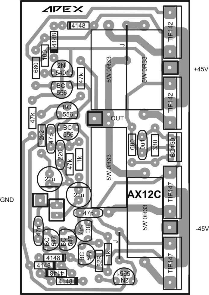

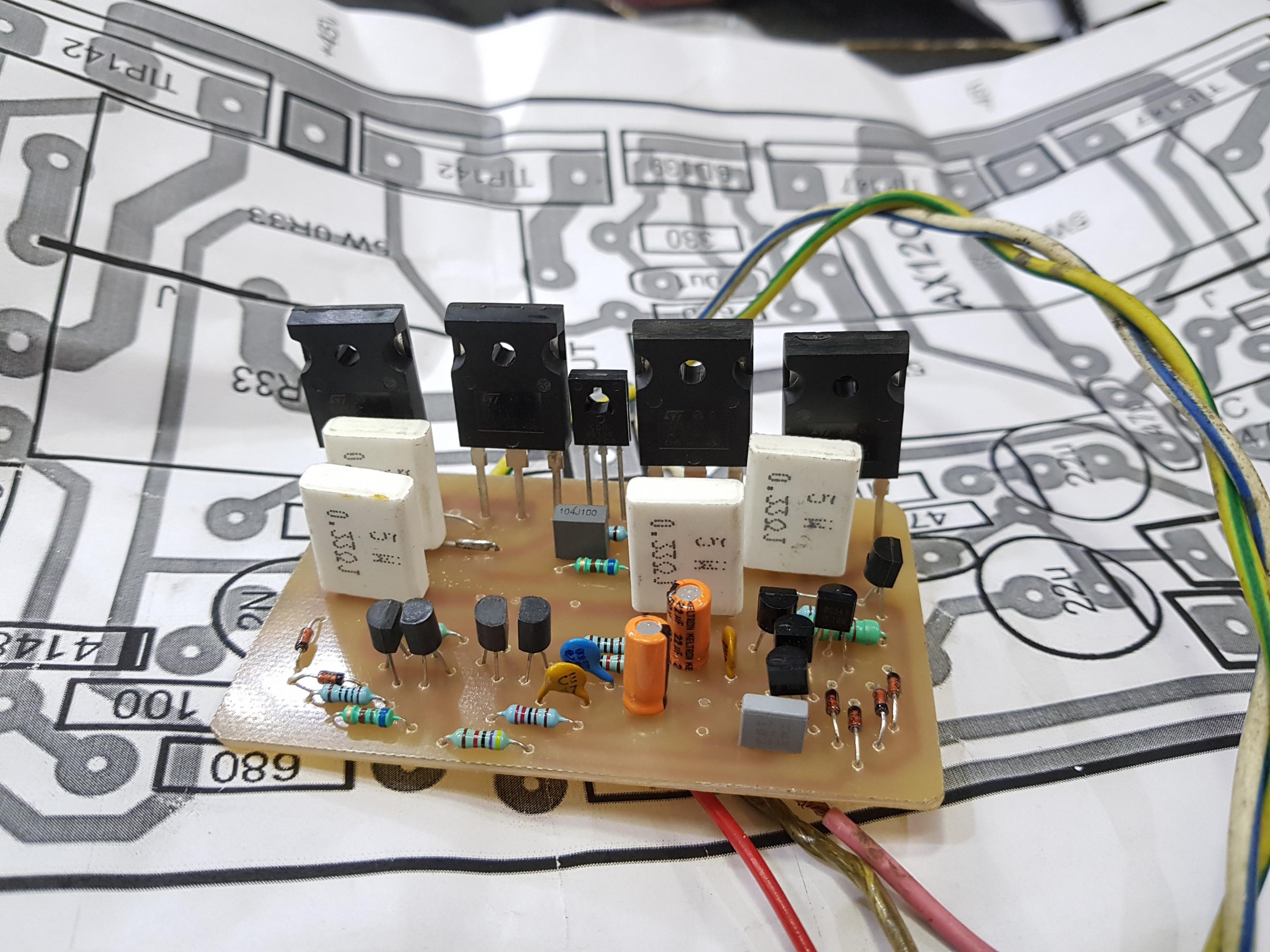

Hello Apex
greetings built AX12C but its drawing excess current how can bias be set series

Use 1k trimpot instead 100R
