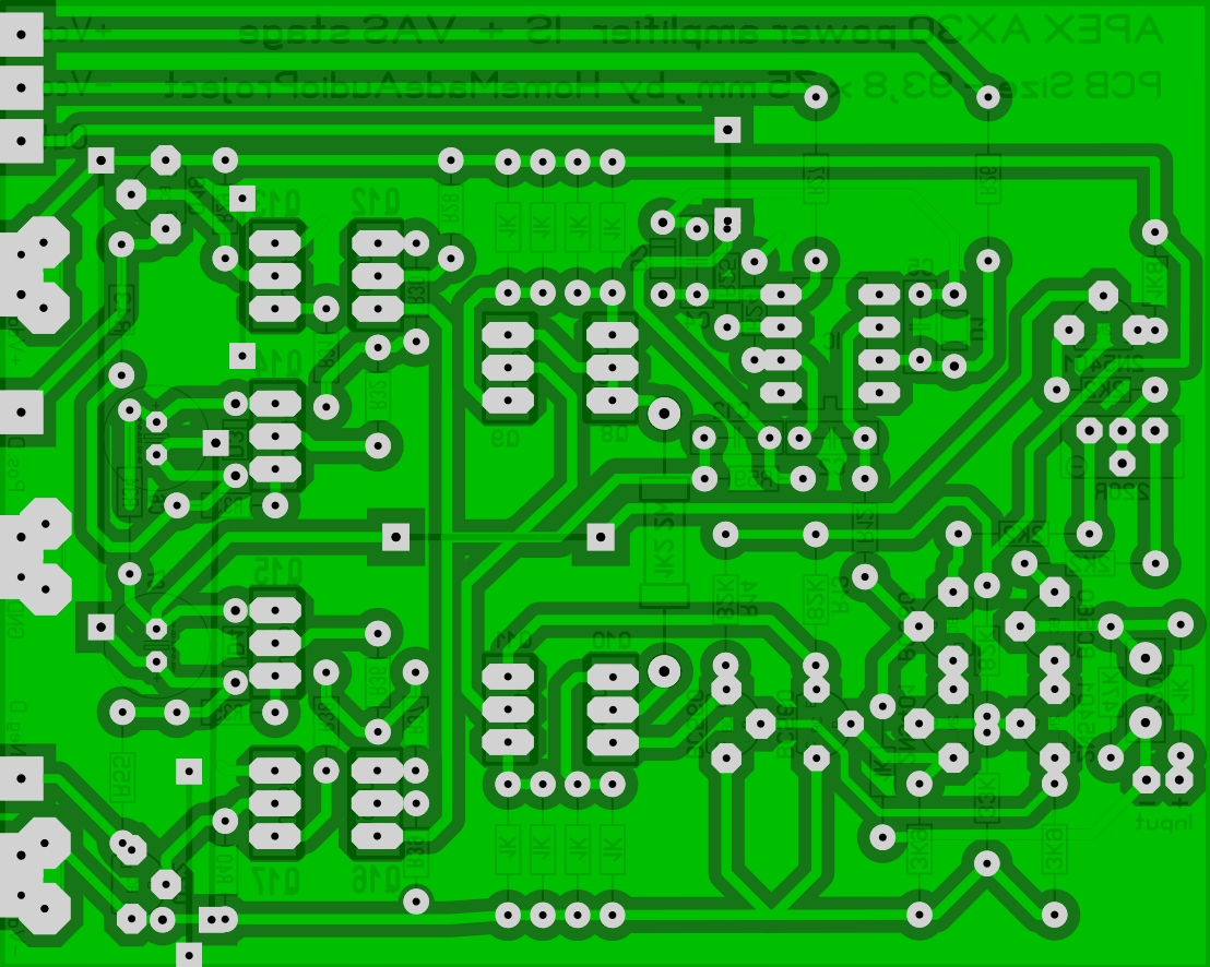

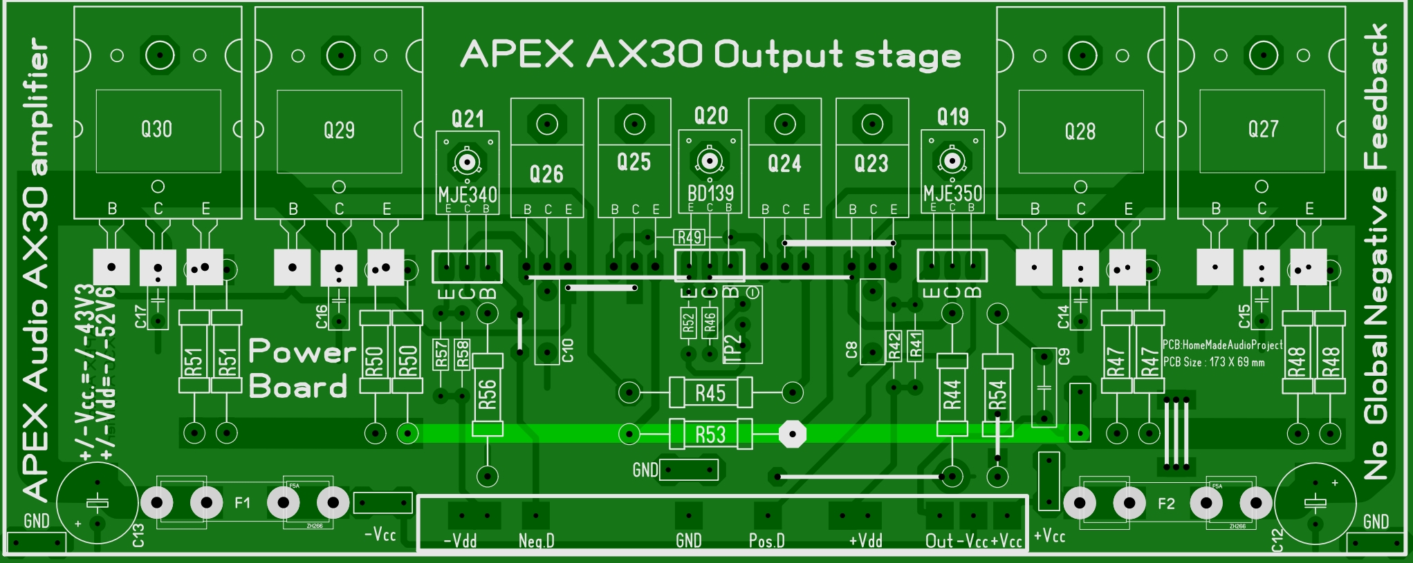

100W Ultimate Fidelity Amplifier
APEX series:

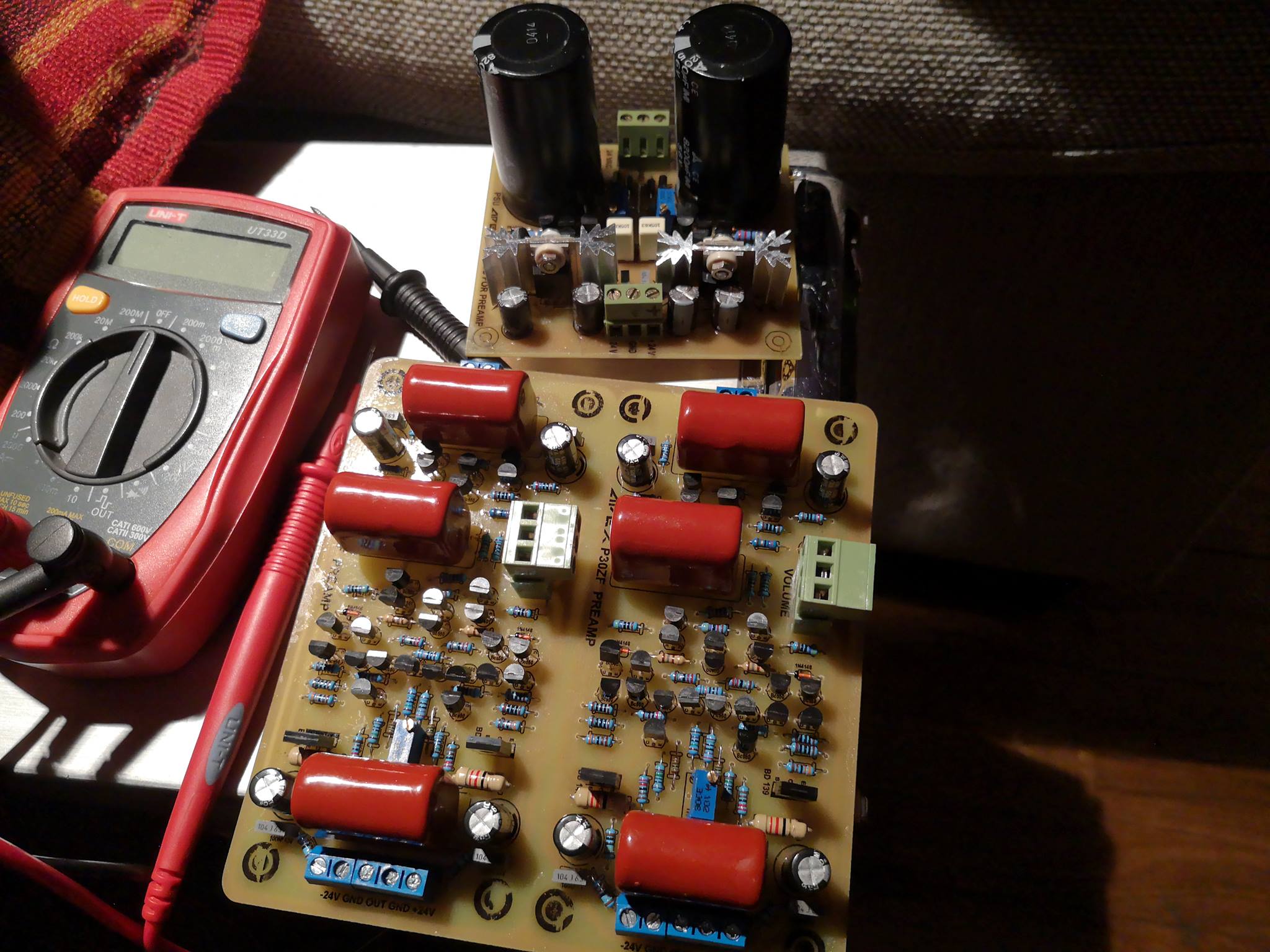

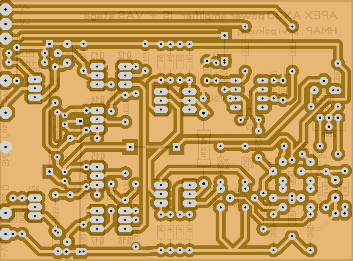

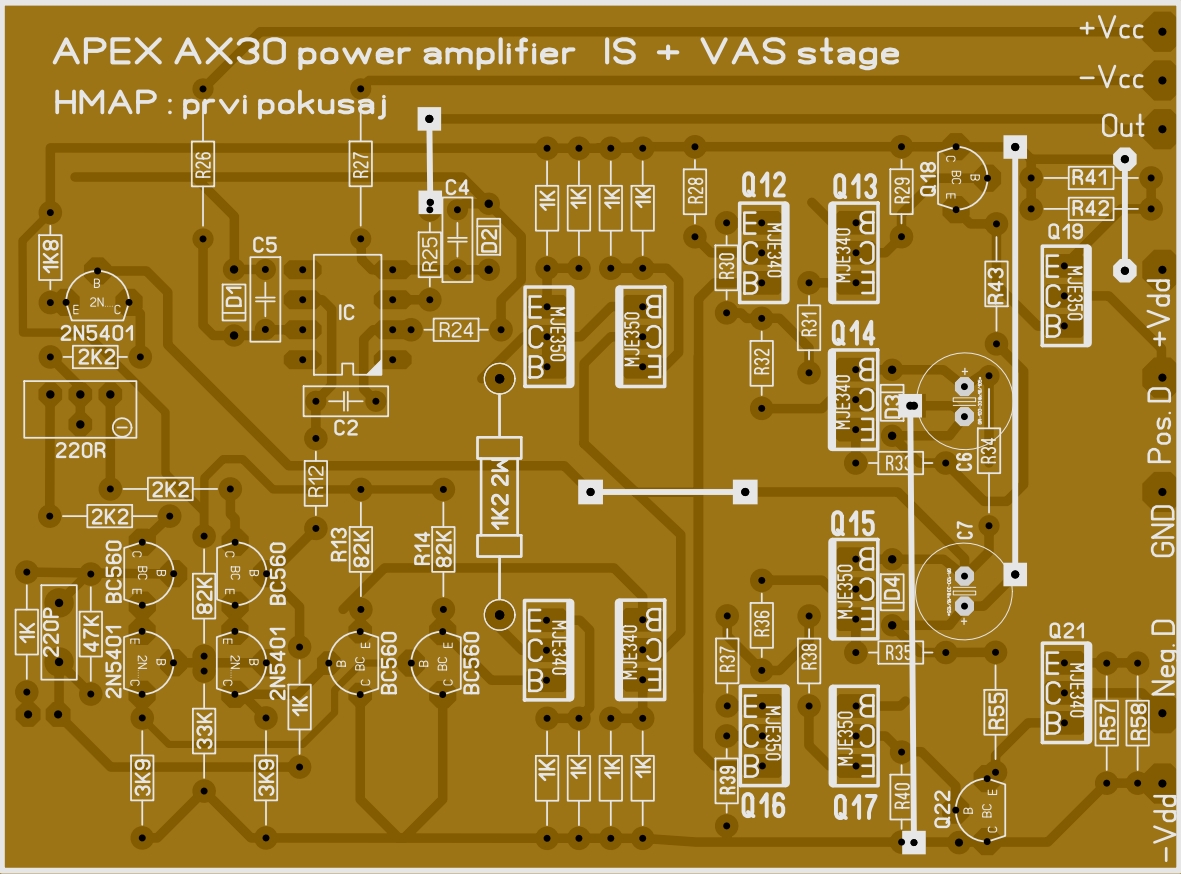

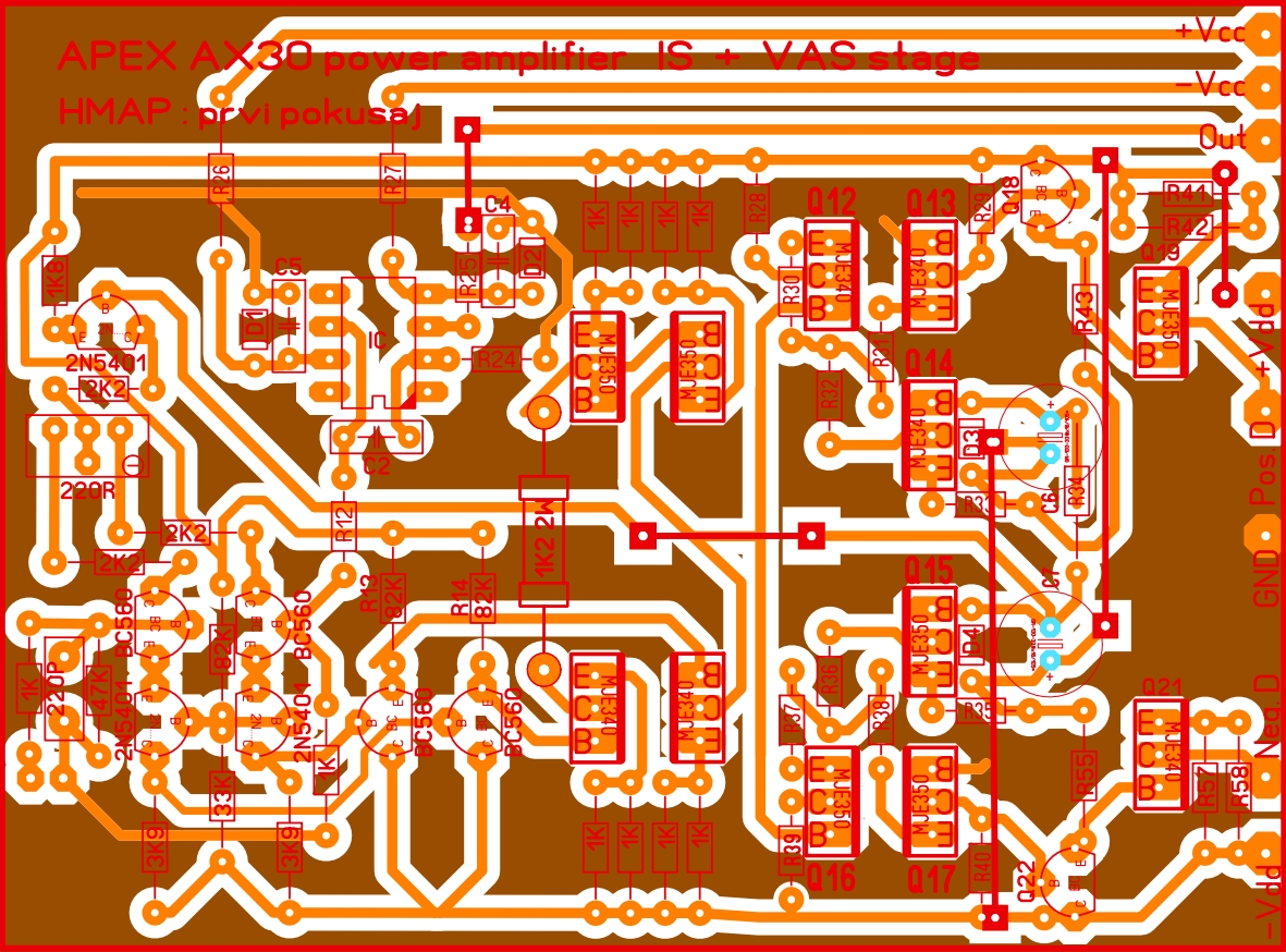

NOT TESTED YET!!!

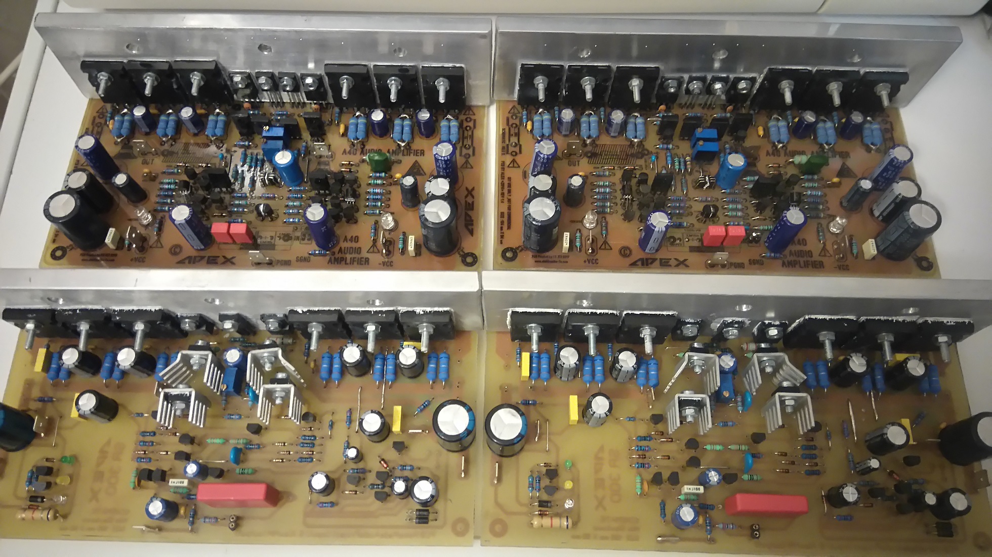

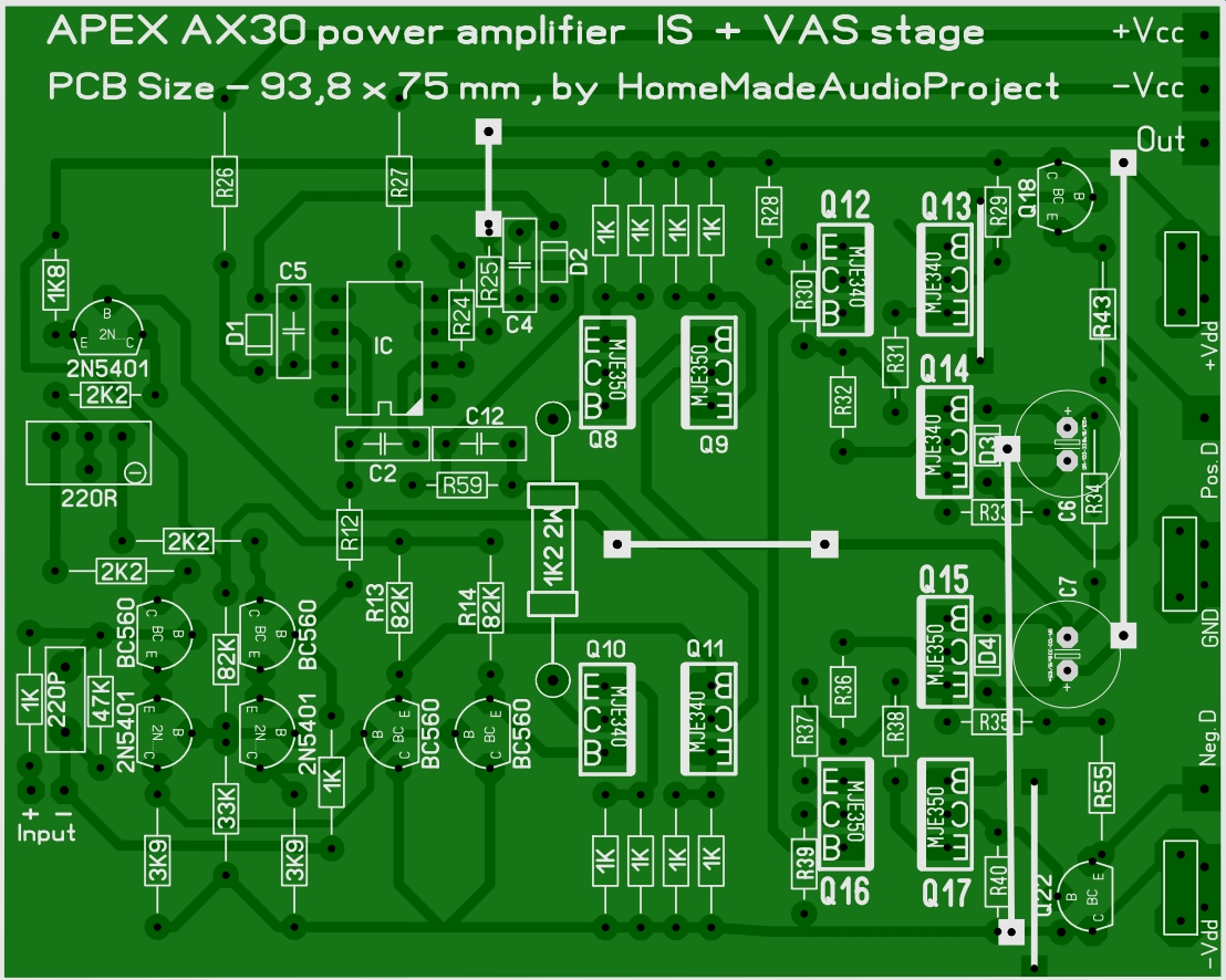

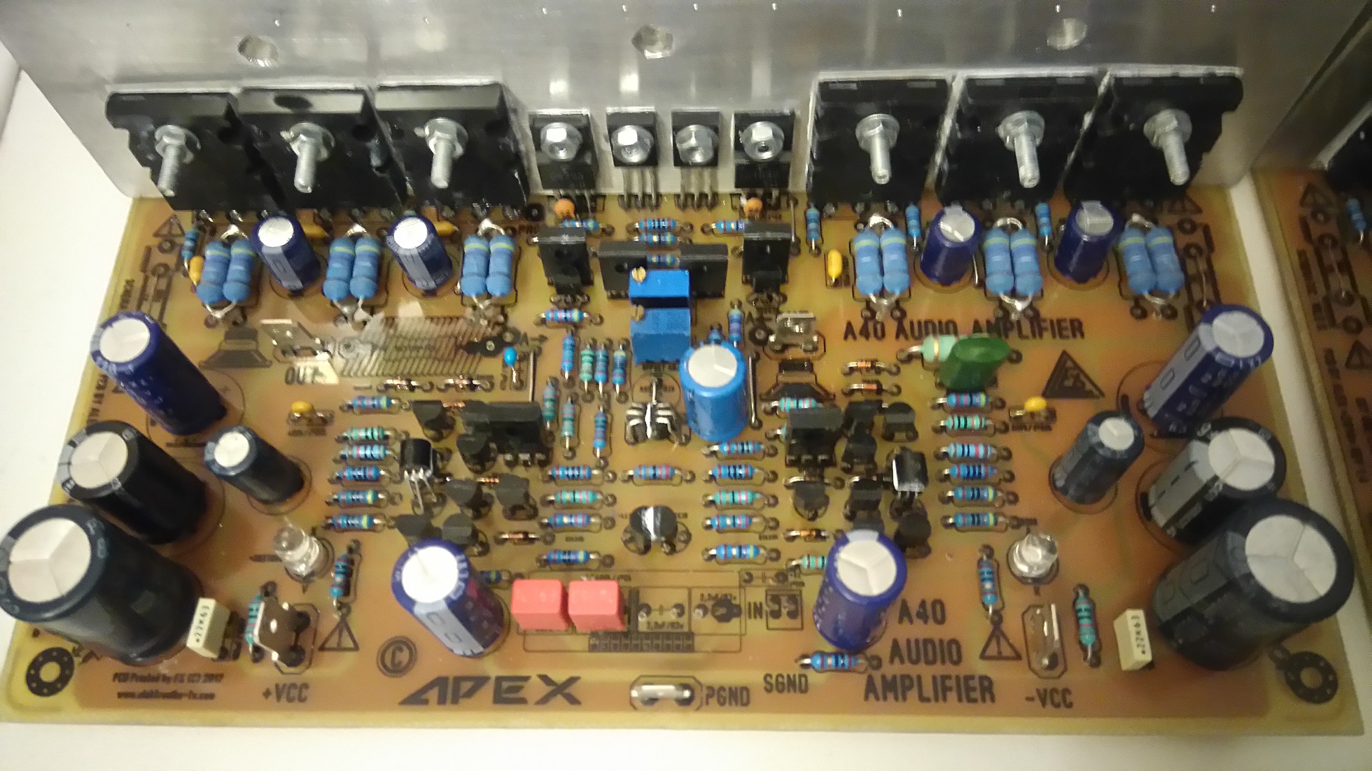

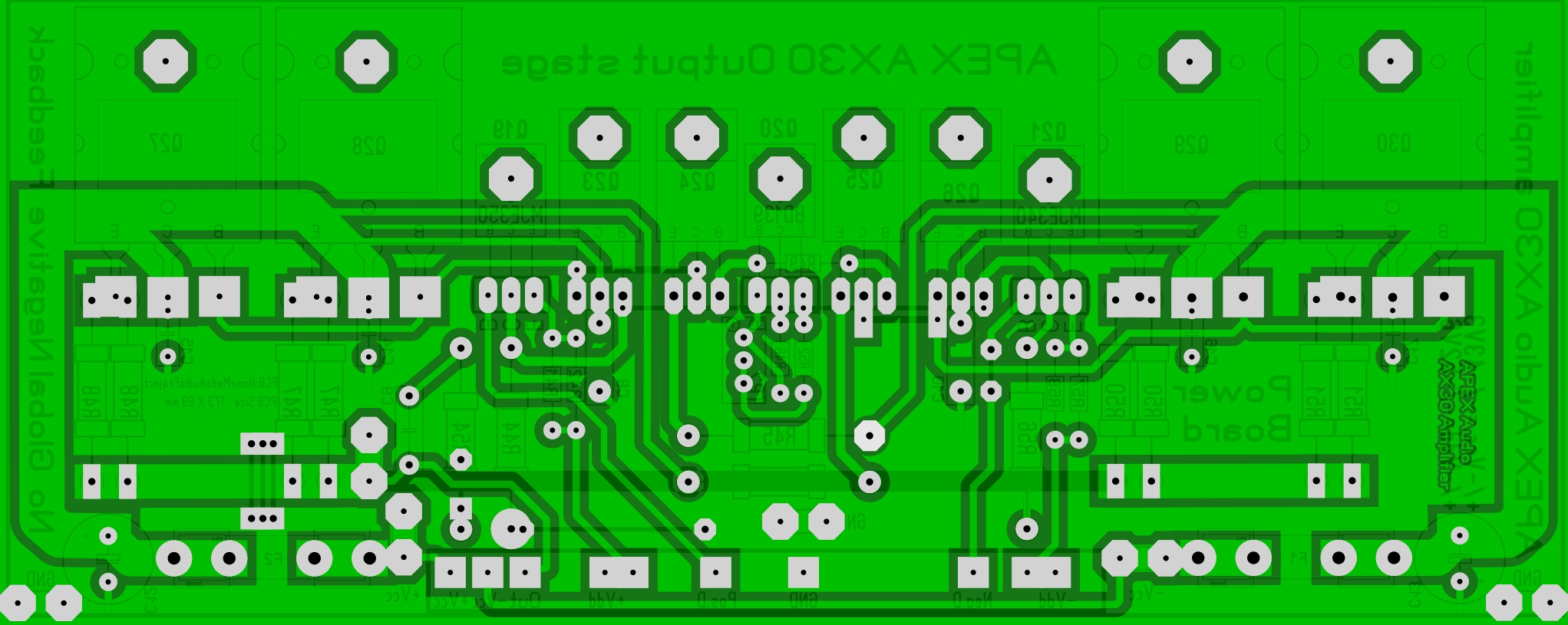

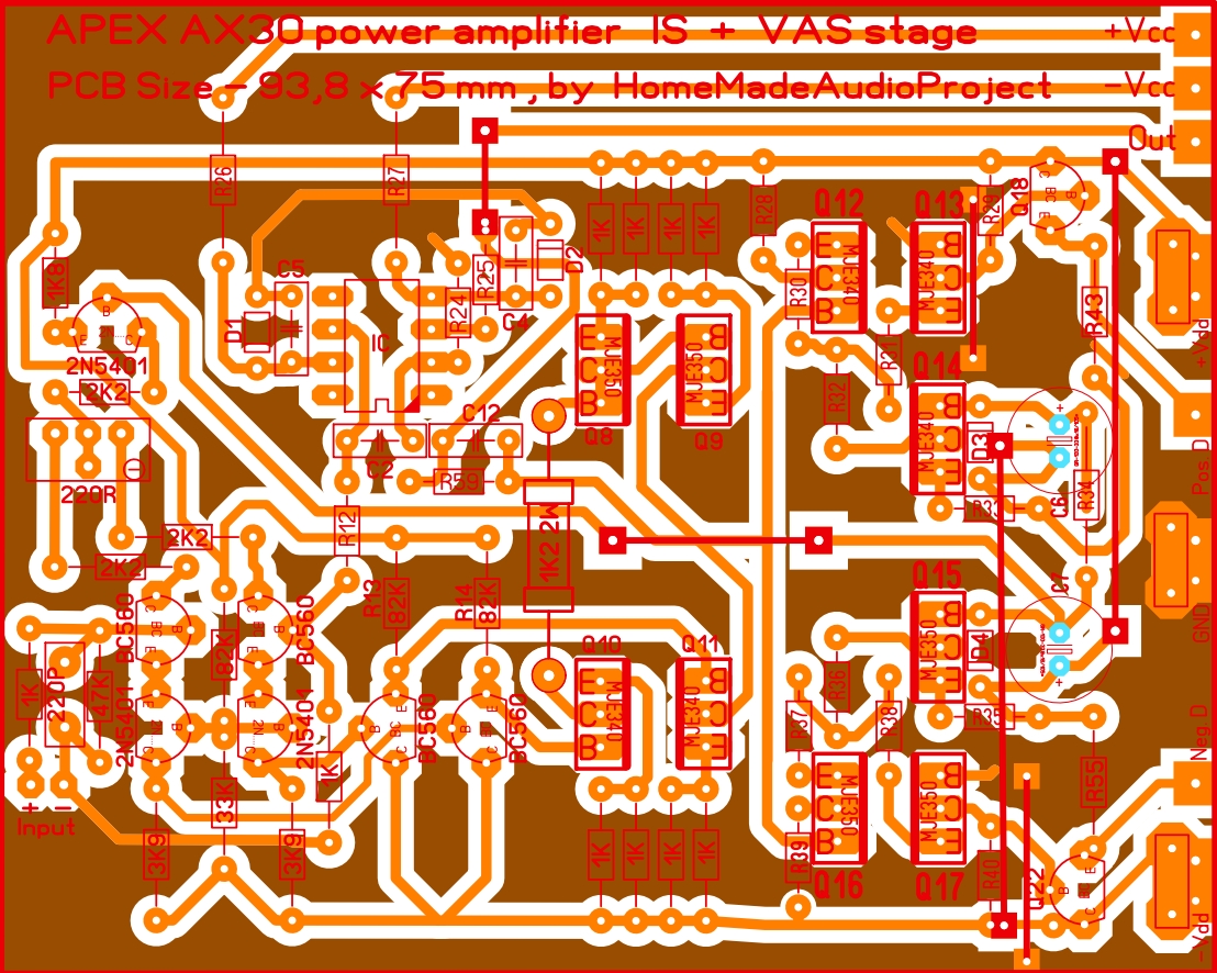

:snail: NOT TESTED!!! to achieve as short traces as i could and to thermo-couple all needed transistors,i had to separate IS and VAS board from OPS board,so now it looks like this:
