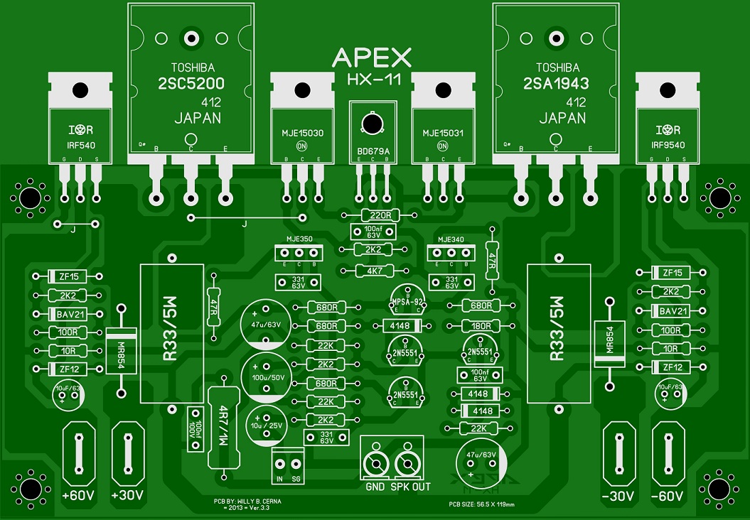

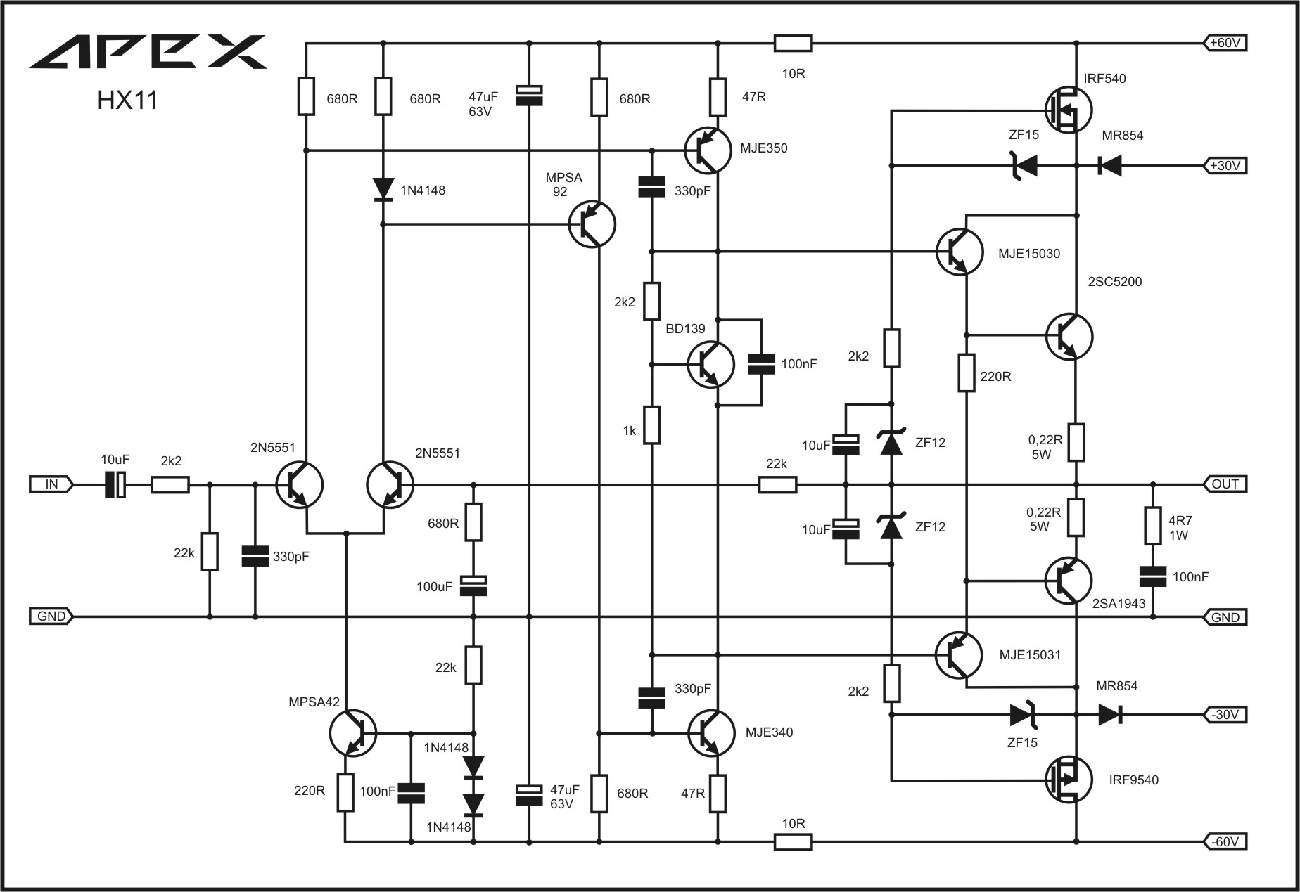

Thank you for the scheme, I think I have most of the components except the IRFs 🙂
Between could you please clarify the below.
1. Output power into 8 Ohms(my preference is 200 watts into Ohms)
2. 60-0-60, Ampere rating
3. 30-0-30, Ampere rating
Thanks again for supporting and guiding us.
