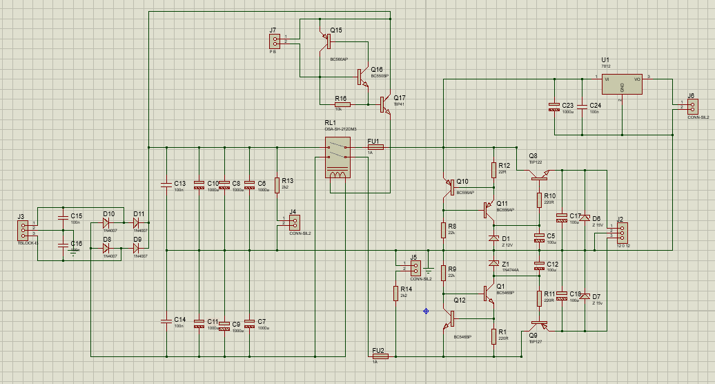

this is the schematic of supply to power up a pre amplifier the section above relay is latching circuit when preamp is switched on an led indicates the power but preamp stays at standby until a push button is pressed. the problem is that if i use a 5v adapter, mp3 module will not be controlled by this circuit. 5v regulator don't work so well.

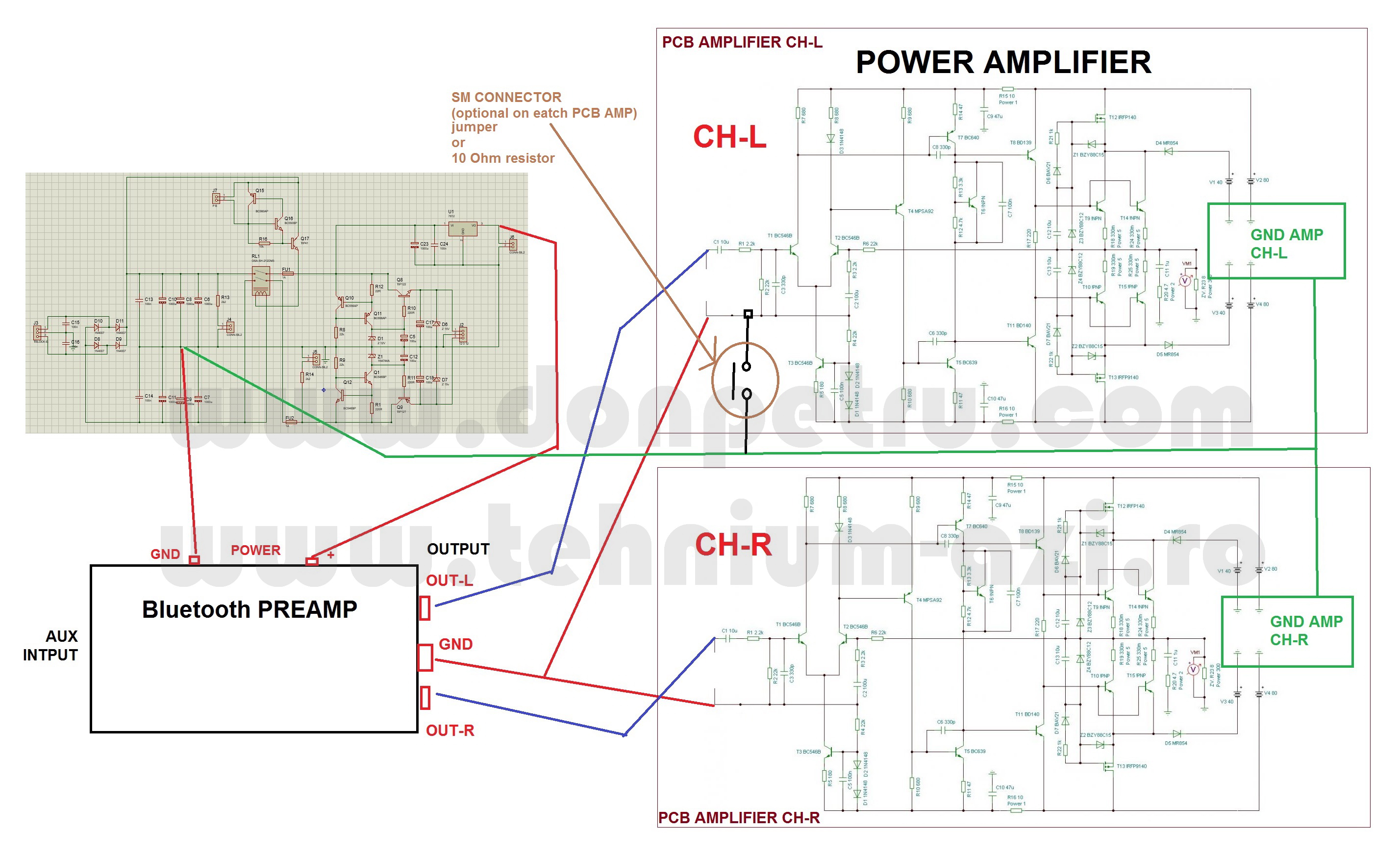

I have drawn the correct wiring method of the amplifier in the picture below. In your case, if you implement SM Connector, do not use a jumper
or don't use resistor of 10 Ohm.
i have used the same wiring but the problem is with mp3 module when it is driven with 5v regulator it gives noise even with filter. i tried to use 5v bulk converter but still the same issue. i have atteched the image of mp3 module and bulk converter i used.
