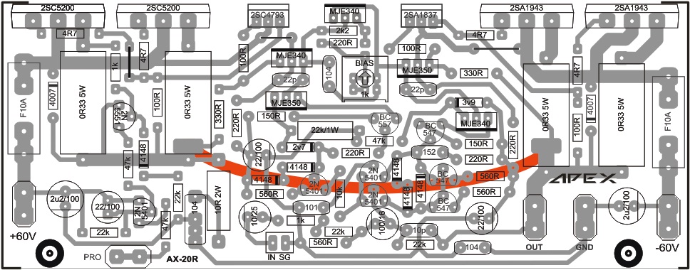

PCB layout

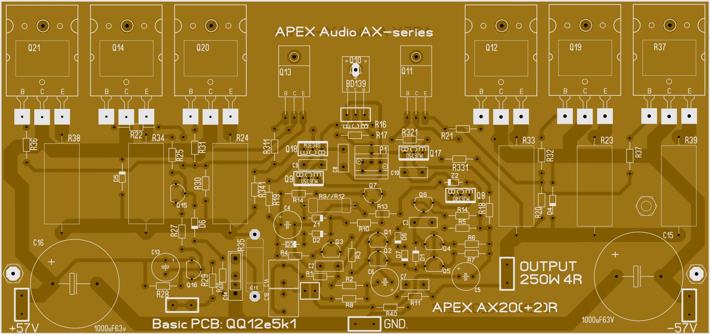

based on your pcb today i draw a version with tree output pairs. i woud say you did everything as it should,only i suppose C13 100nF should actually be 10r resistor - that would be mistake on schematics...
I think Mile always do this way to separate signal gnd and psu gnd, it use 100n same as with AX-14, B500, and other models. 10R only for test.
