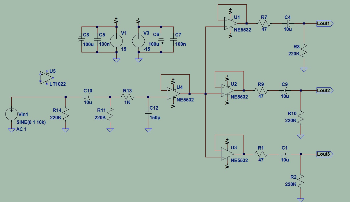

100W Ultimate Fidelity Amplifier
See if this is useful to you, not tested. Although do read comments posted by sajti/ivanlukik.
regards
Prasi

Input series resistor serves two functions.
1. RF immunity
2. Protective function. Most high performance opamps have back to back diodes at the input. If opamp is configured as unity gain buffer these diodes can conduct at turn on pulses. In that case input transistors can be destroyed or damaged. Series resistor provides protective function reducing the current. To be effective these resistors should have value between 500R and 1k.

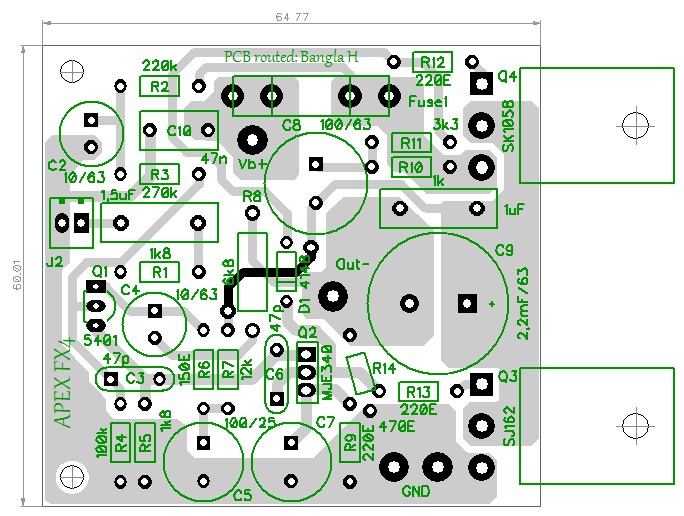

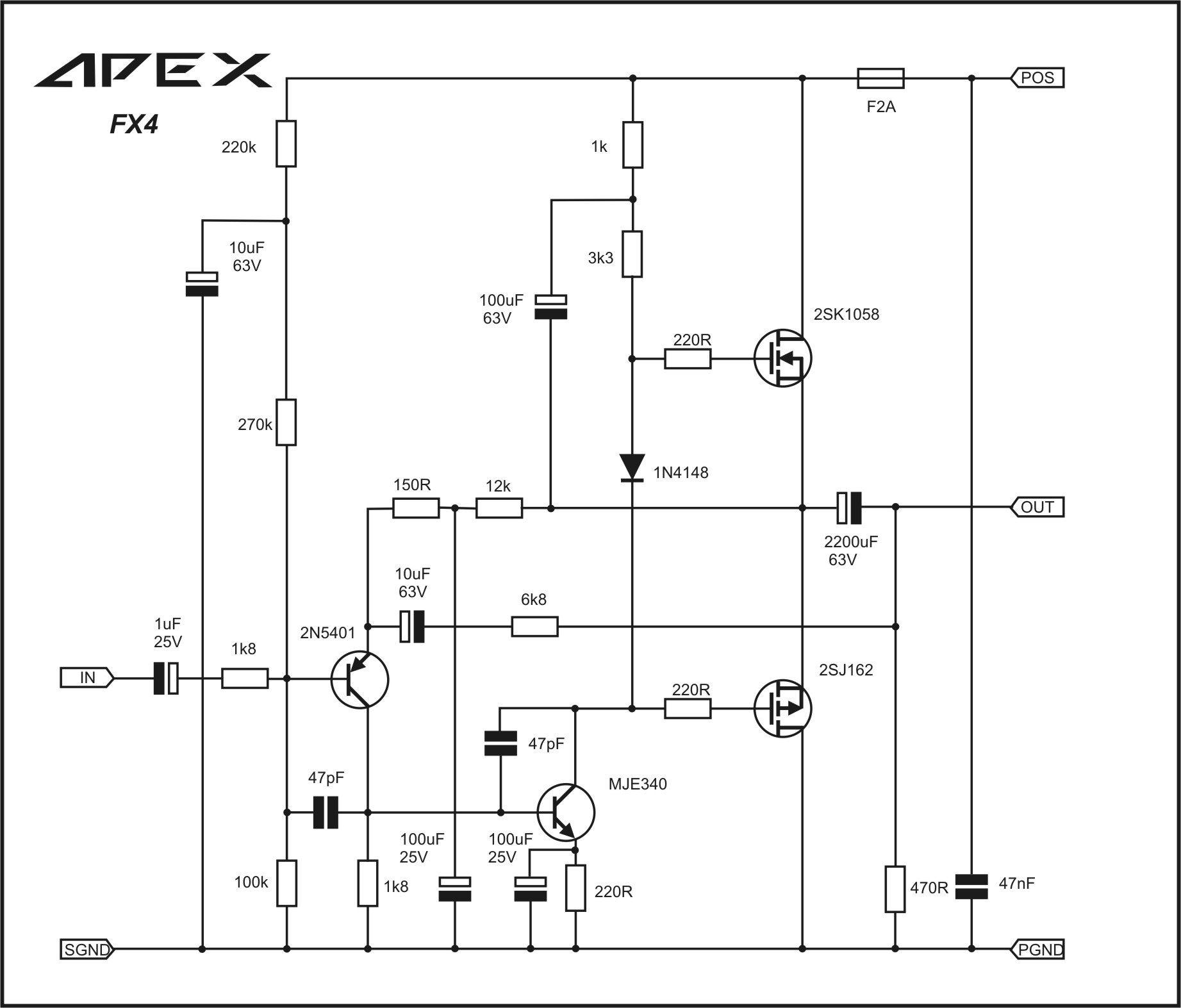

single Rail FX4
Hello Fellas
Any time back Mile presented a FX4 Retro single Rail schematic.
For fun i have done a board and share it here.
Please takes a look over- is it ok?
If there is interesting i will create gerbers and share here too.
Regards
