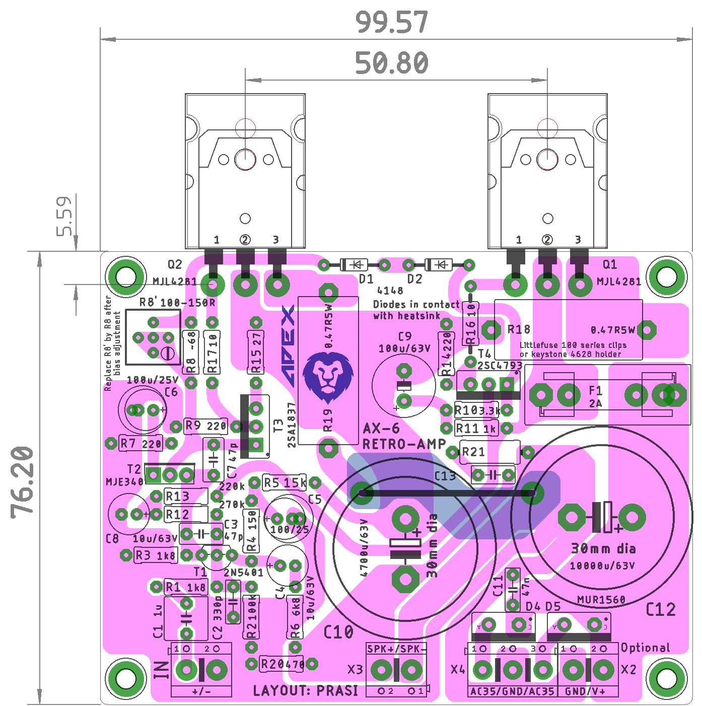

Any time back Mile presented a FX4 Retro single Rail schematic.
For fun i have done a board and share it here.
Please takes a look over- is it ok?
If there is interesting i will create gerbers and share here too.
Regards
nice one Bangla...🙂 Congratulations
are you planning to build it any time? or just for fun?
regards
Prasi
Thank you Prasi, for attention.
I've forget i can optimize some extra pads on 47p and input cap size, no worry.
Only fun to share and if anyone who like to order pcb's and build, could send generously one set. 🙂 😀

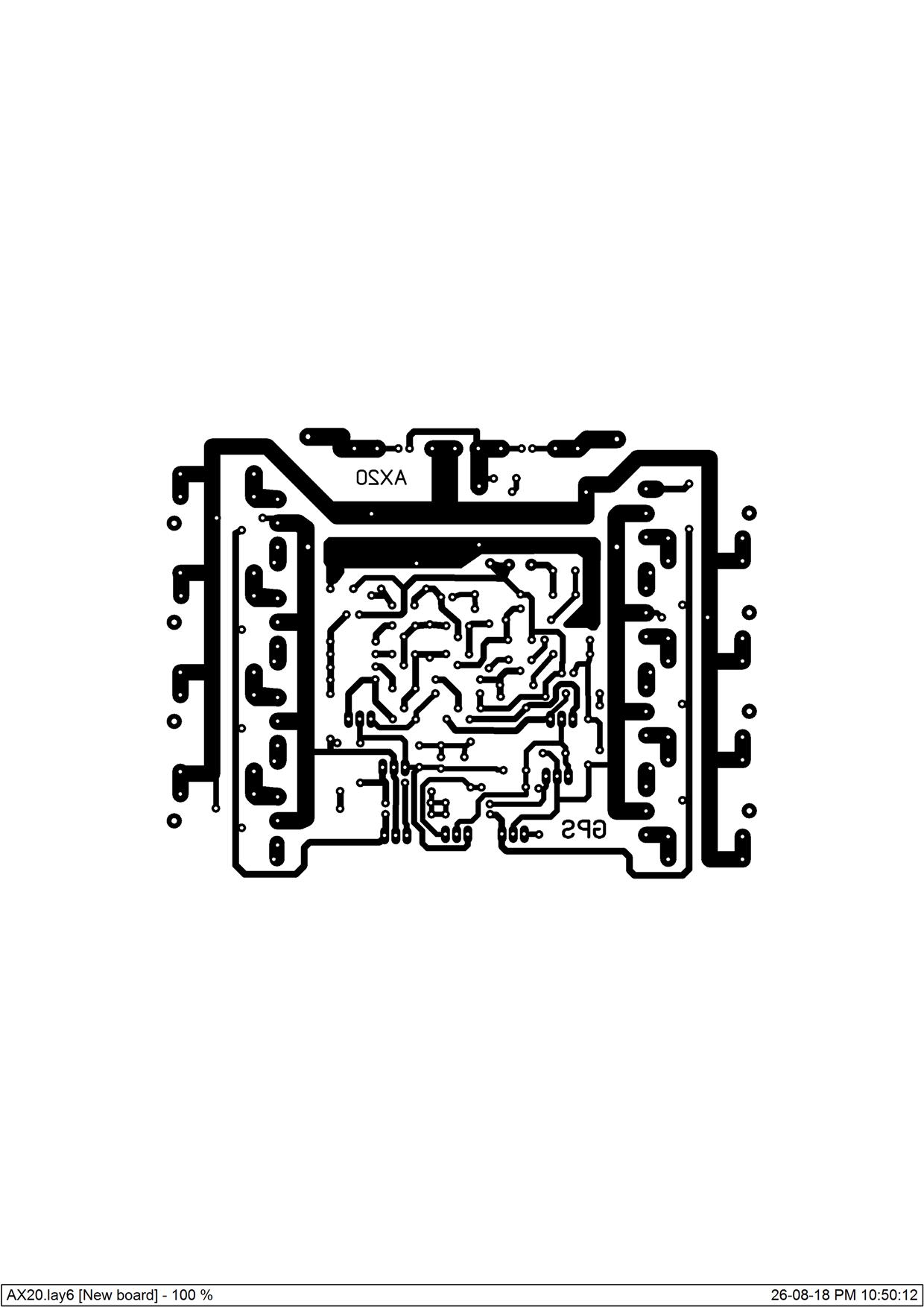

meanwhile here is AX 6 (FX4 in bjt amp). i have many pcb, let me know if you want a set, *free for you*
regards
Prasi
edit: i attached something else. now its correct. got to sleep

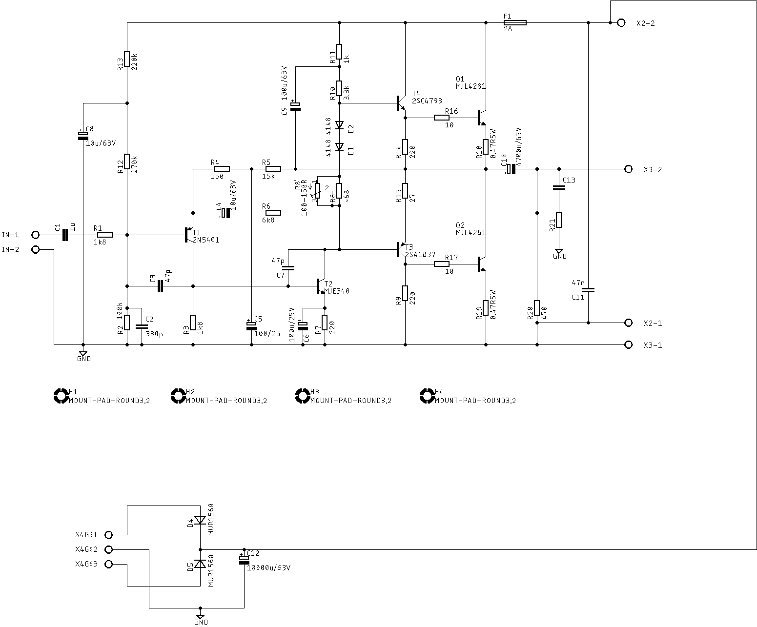

Updated schematic.

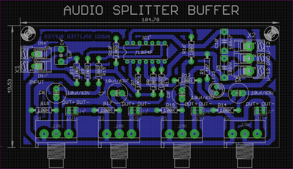

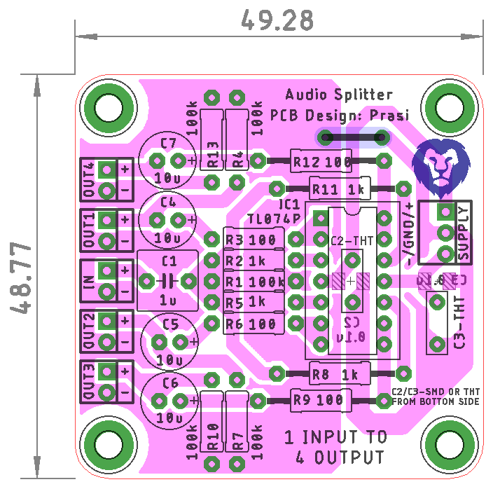

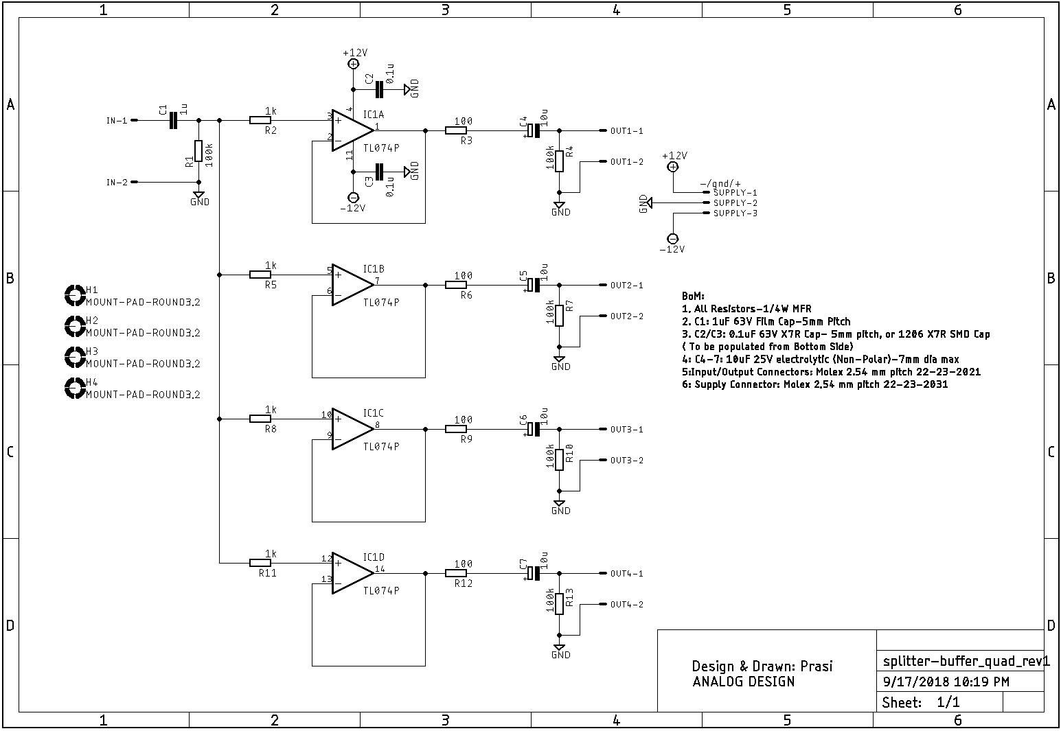

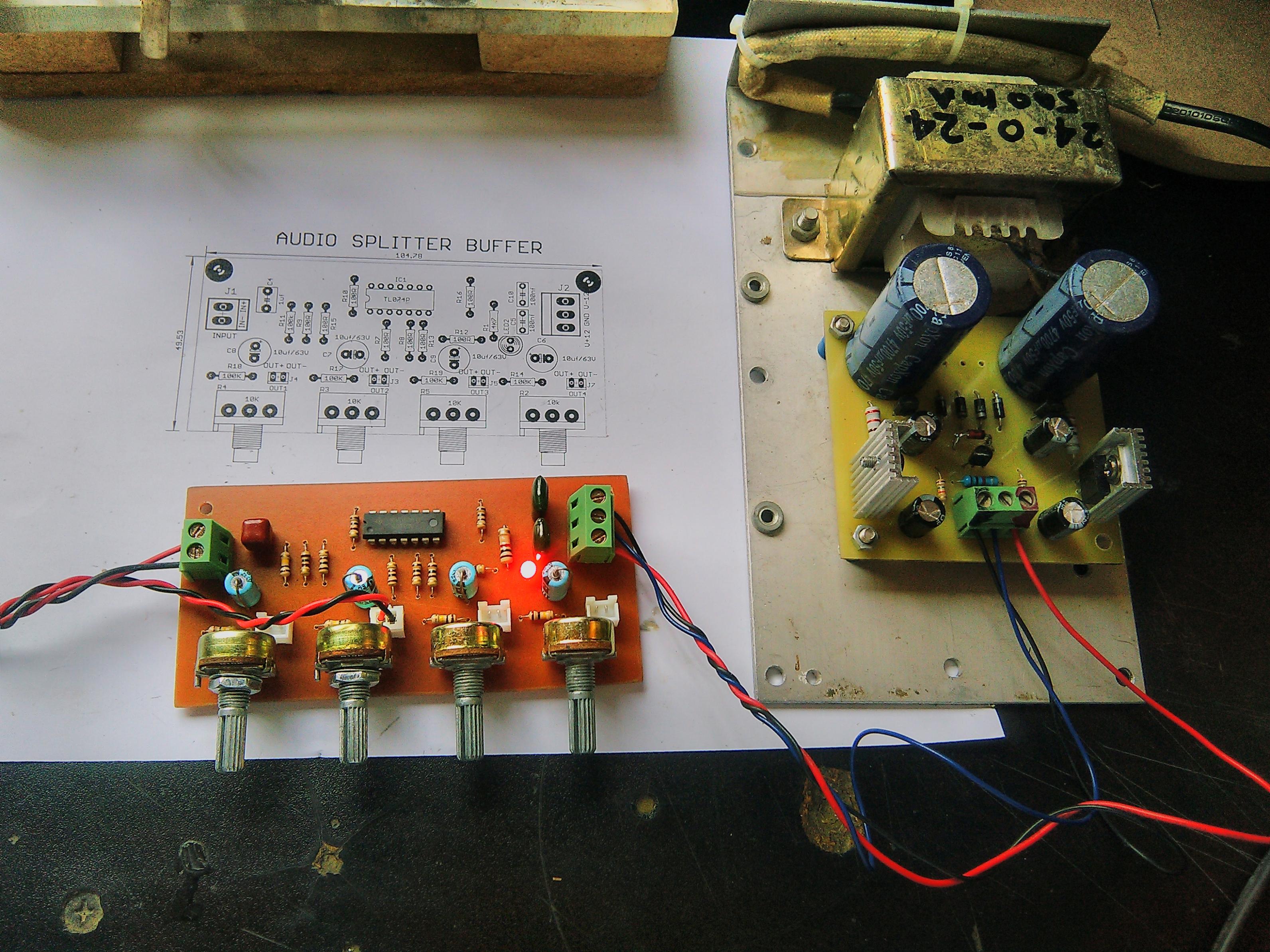

Hello redarc12,
Here are the gerbers and sch for audio splitter as requested by PM.
regards
Prasi
