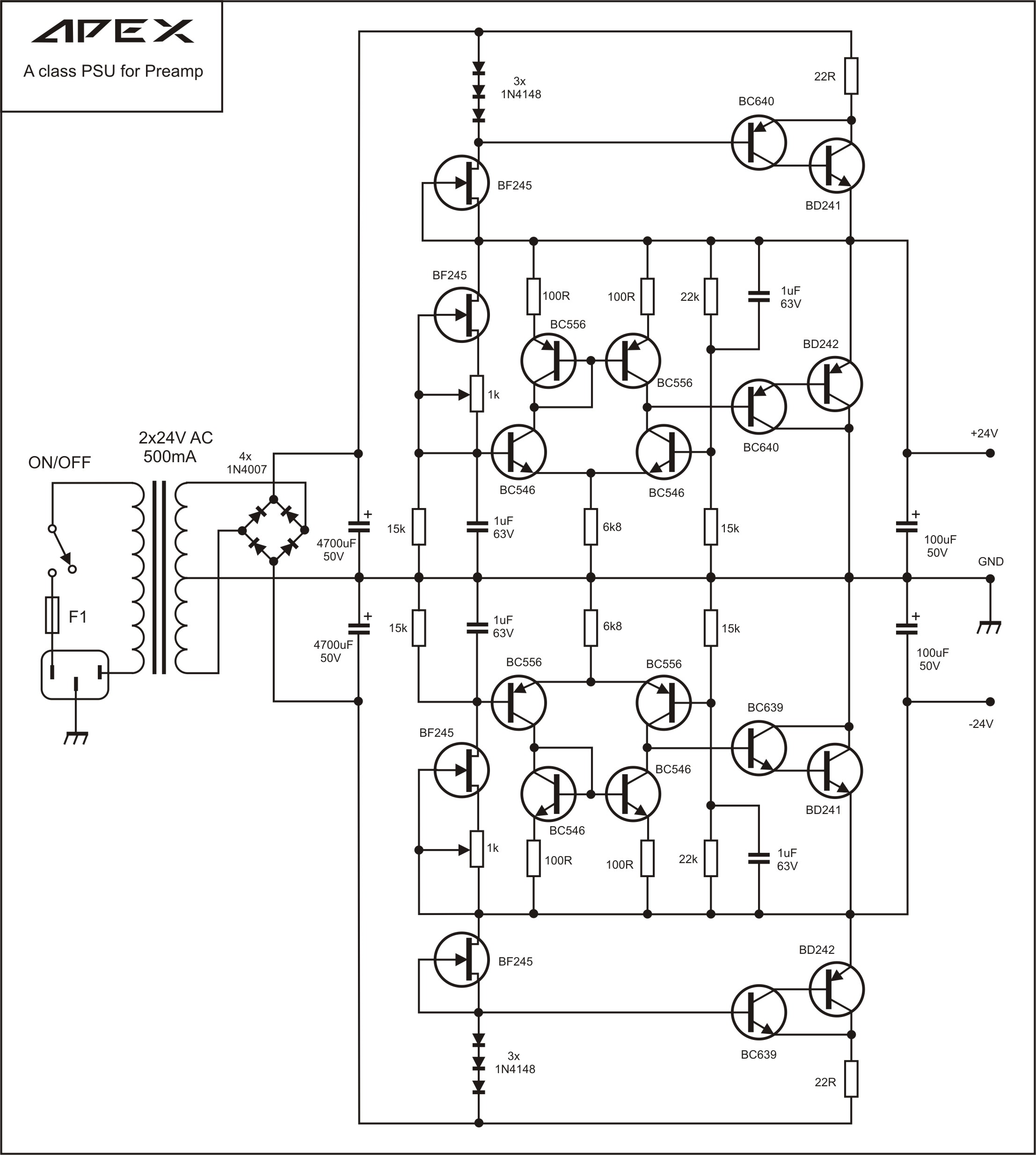

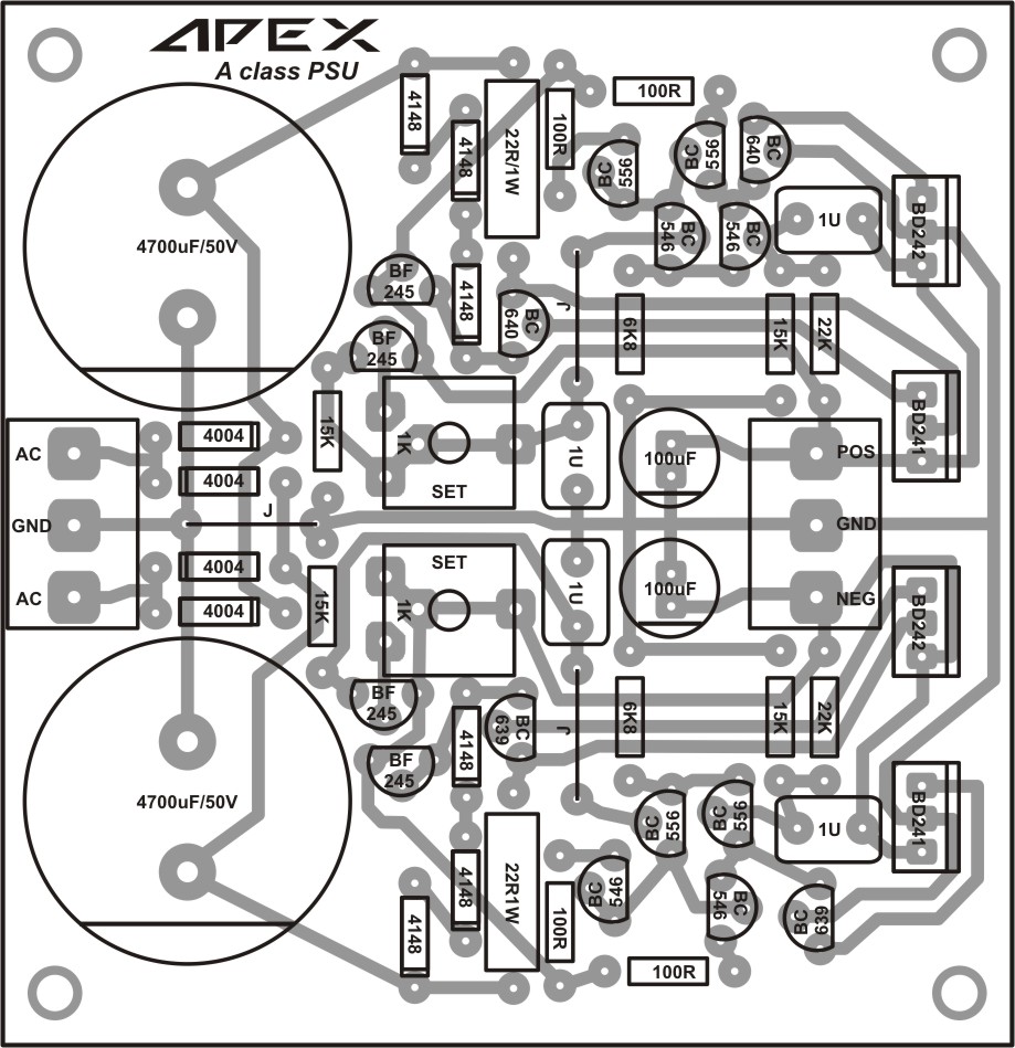

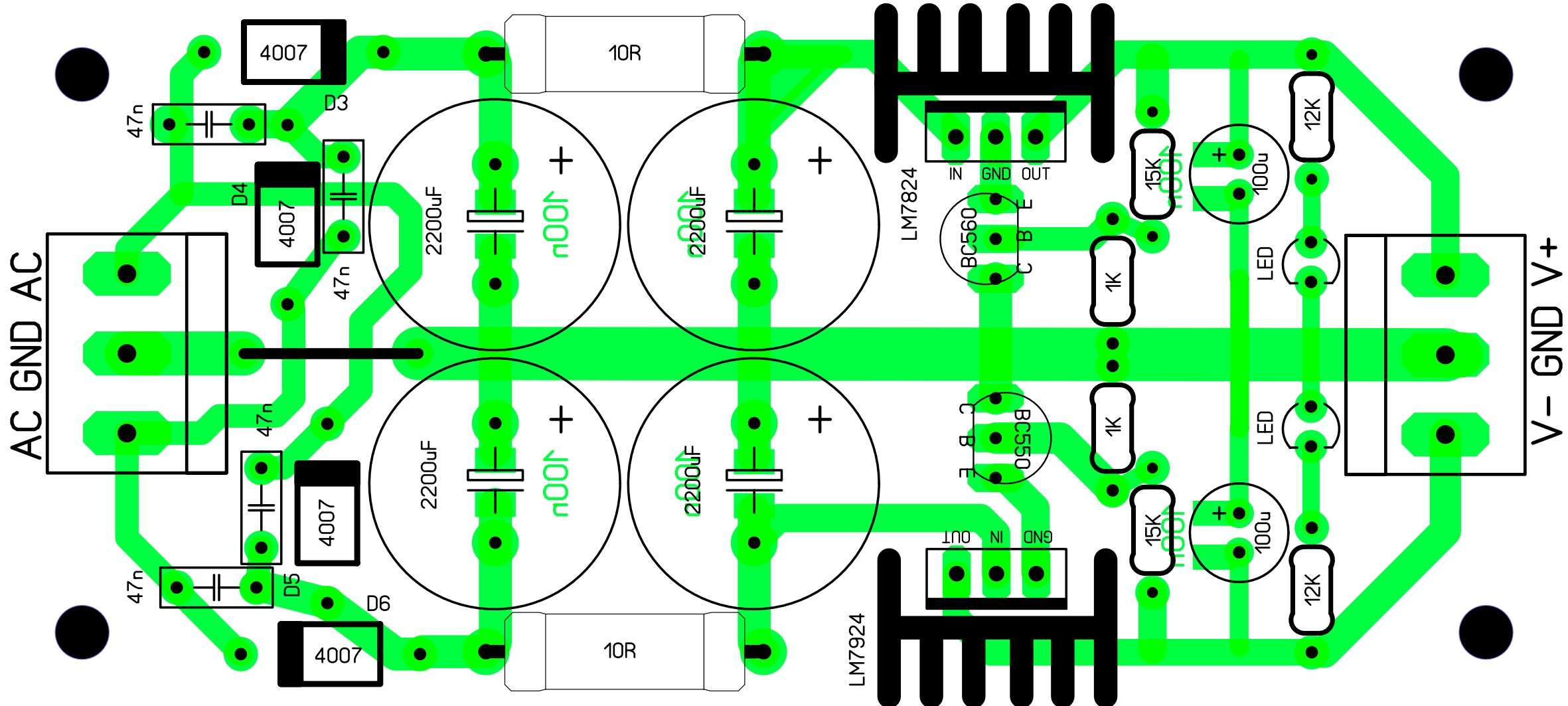

Juan my mistake, i don have specially for P30 but i have "APEX 2x24V Aclass PSU"
You can find in this thread > http://www.diyaudio.com/forums/power-supplies/164365-class-preamp-psu.html
Schematic > http://www.diyaudio.com/forums/power-supplies/164365-class-preamp-psu.html#post2140391
PCB > http://www.diyaudio.com/forums/power-supplies/164365-class-preamp-psu-2.html#post2365228
thank youJuan my mistake, i don have specially for P30 but i have "APEX 2x24V Aclass PSU"

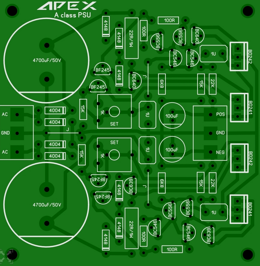

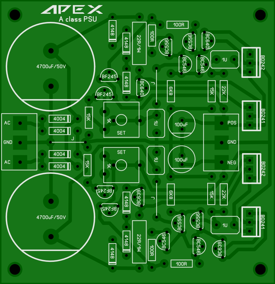

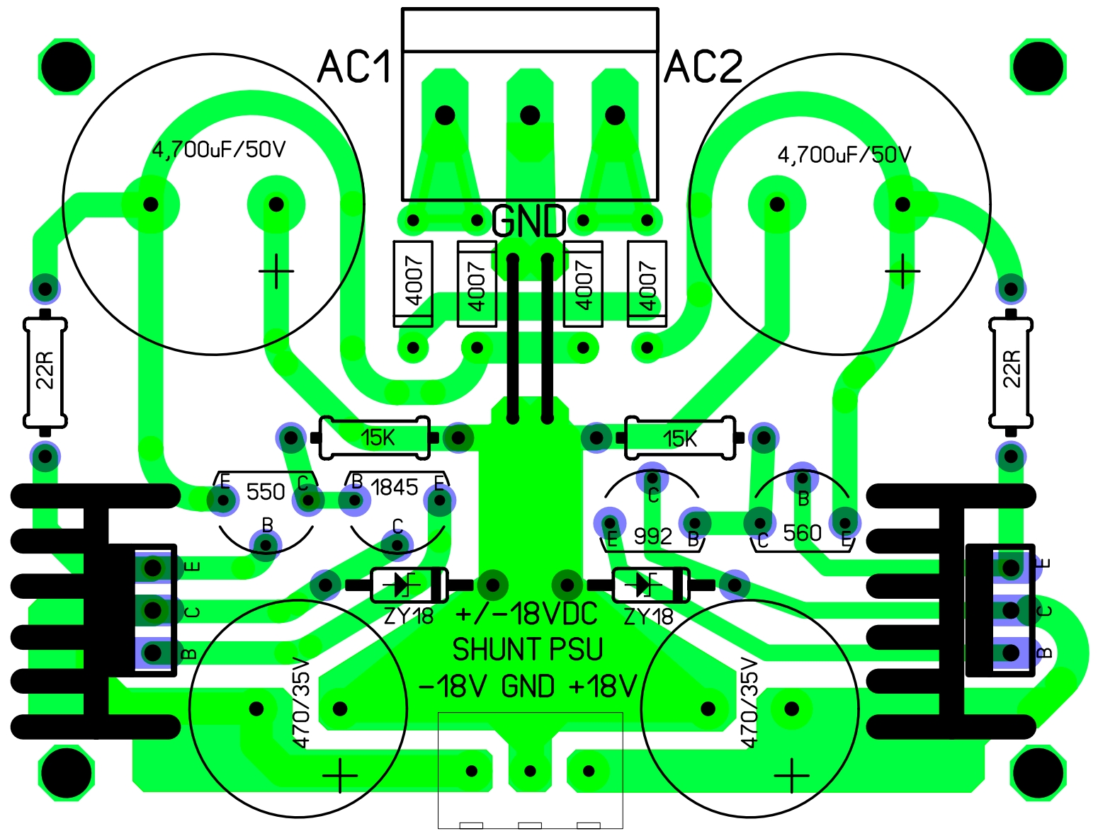

I think I should made a clone layout of this layout from mister Mile
Best Regards
Juan
Previev post i missed one negative track from resistor 22K.
Now is correctly..
And i copy silkscreen...
Now is correctly..

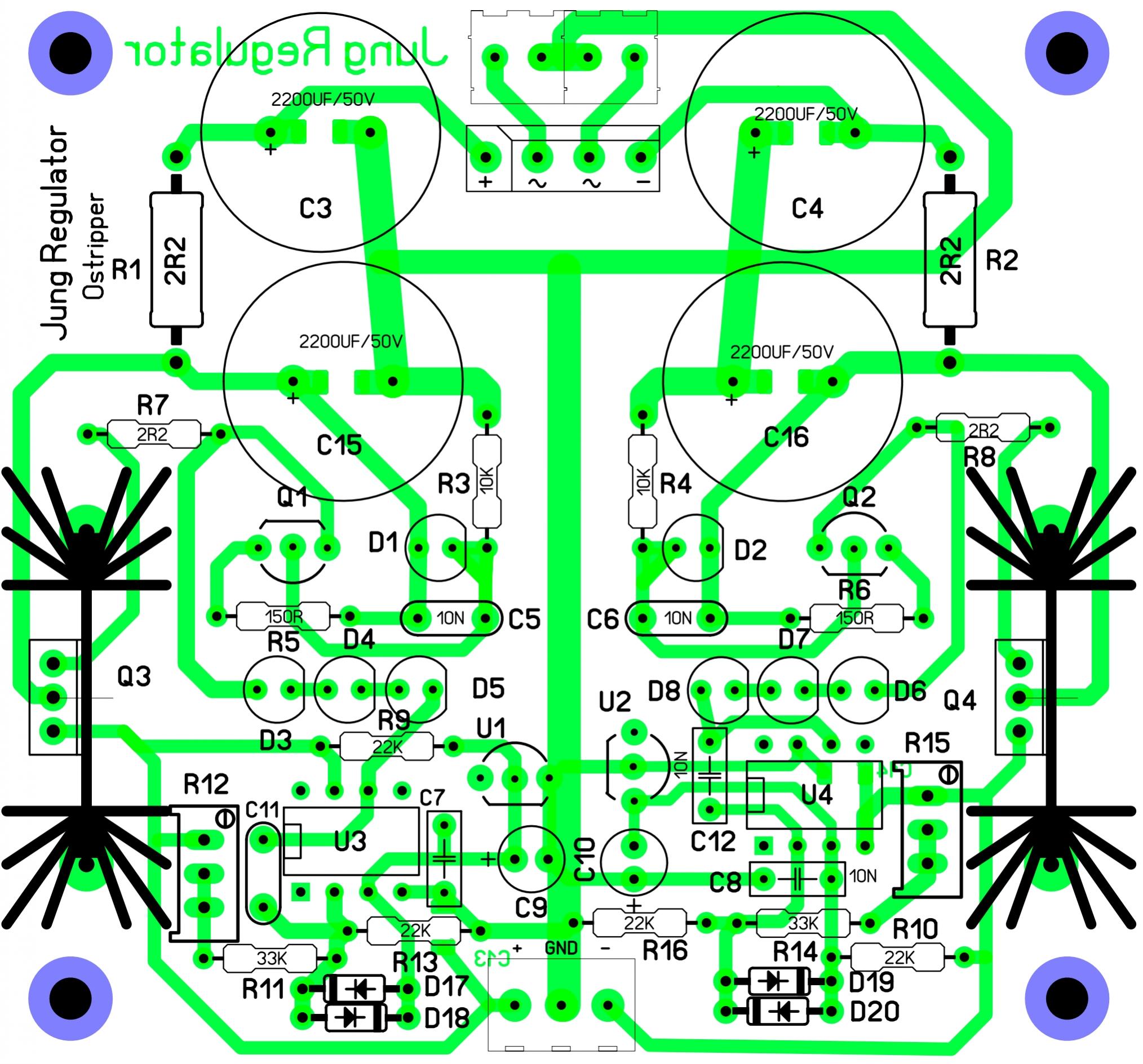

I have built the A Class PSU and it is very clean. Maybe even cleaner is the Jung Regulator that OS and Jeff designed. A lot more parts though.
Did you ever look at ripple on scope? I have heard the Salas shunt is one of the cleanest supplies. Uses 3 stages of regulation I think.

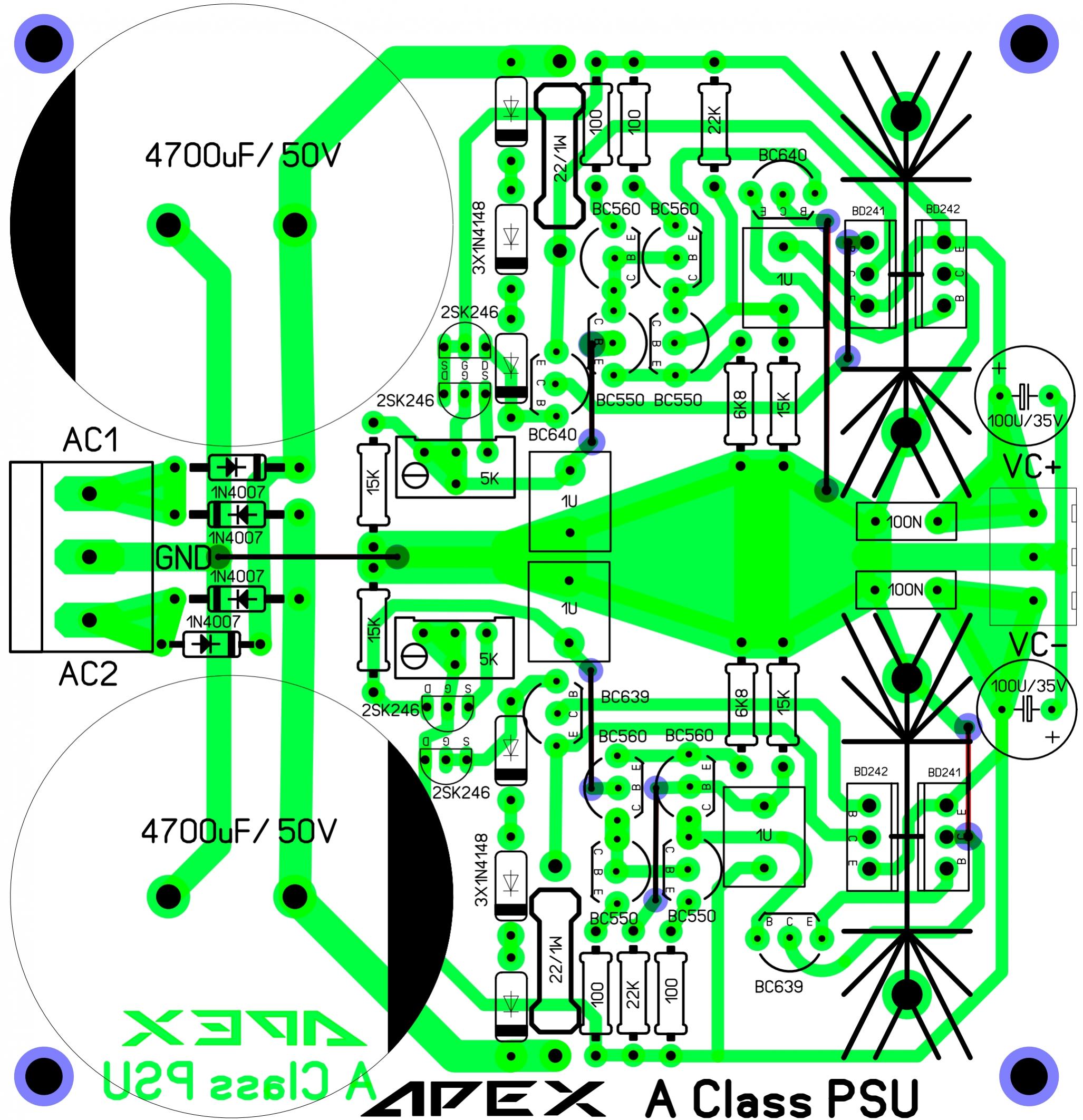

All are fed from a 26-0-26VAC transformer. Measured without a load. Each are set to approximately +-24VDC.
The first three all measured about the same. Very low ripple. Surprisingly though, The PSU I built for my Self Preamp shows less noise and ripple than the first three. It shouldn't but it does. Not sure why.
Good luck finding some authentic BF245 JFETs.
I changed mine to use BF246. Just had to change the pinout. Works great.
