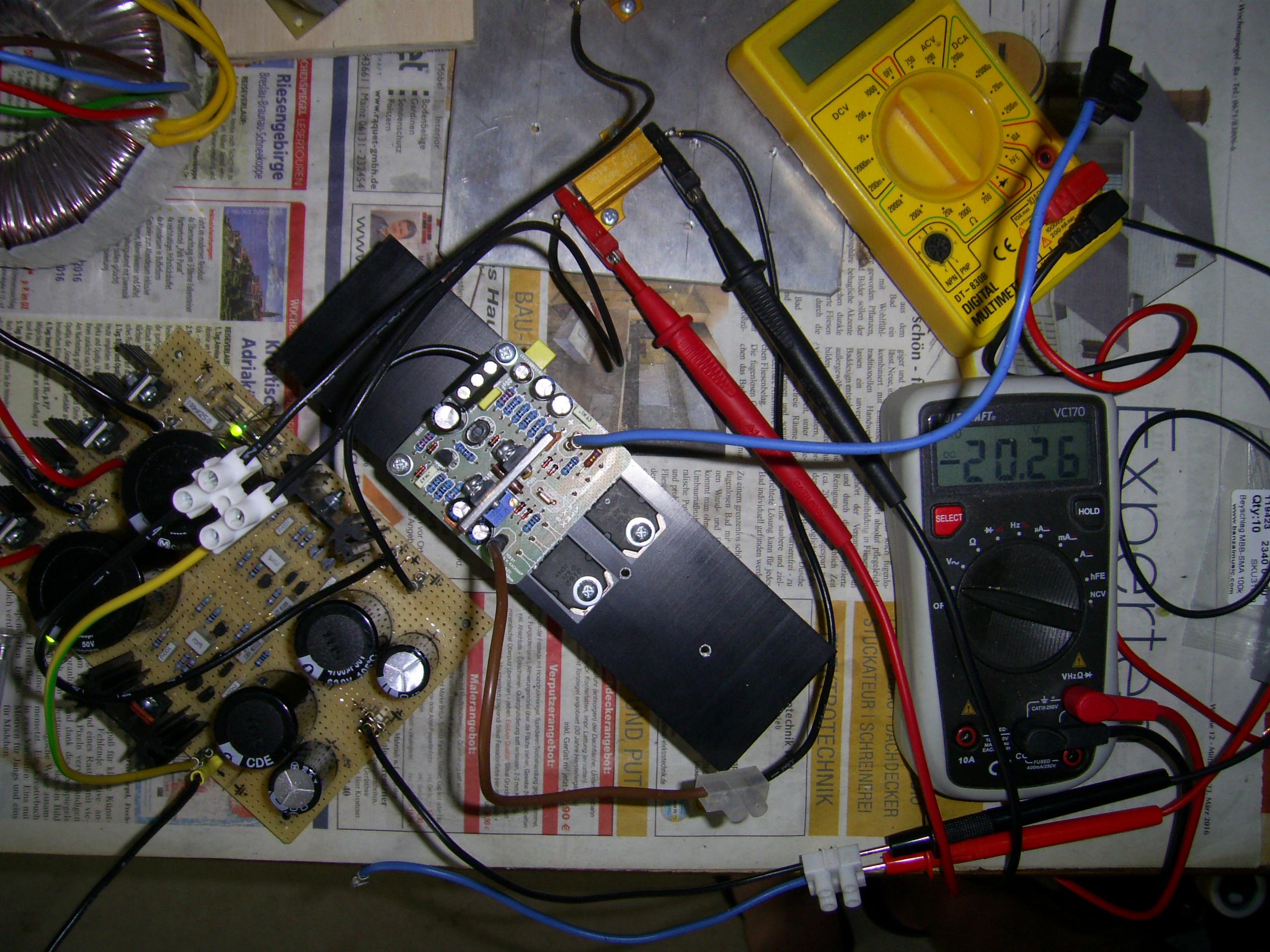

NEED HELP please.
Hallo Friends.
Now i have assembled the very nice sonal FX8 Boards
xrk gives me the tip for FH9 and i end up with this.
I started setup with 10R 10W current limiting Resistor in + - Rail, like DX Amp.
After 10 seconds the Resistor are cooking, like RickG.
Because that i have read back from page 617 #6175... to find any needed helping Information that i not blowing up the LatFet.
Prasi has used 4,7R 3-5W Resistor in each rail.
It seems nobody has any problems to get running the Amp in right bias.
At that point i think i am a dummie- where is the fault that i couldn't find?:headbash:
If i start the Amp- now with 8,2R 25W the DMM shows 20V across resistor.
That means there are running ~ 2A over LatFet 😱 After 10sek i must quick switch off- they are running hot same like resistors.
Also the offset shows ~ 3,6V.
For input i have used MPSA18 hfe ~800, 2N5401/5551 and SB649/SD669
hfe ~150, years back bought from Jack Tech DIY.
Please i need advice what is wrong here.
Cheers Bangla.
BanglaH,
Sorry to hear you are having trouble. I never had a problem like that on FX8. Usually when it hits the rail like that check that all your resistors are correct. Like you don't have a 220R when should be 22k. Next check your small signal transistors. Since you have substituted everything hard to say of it may because of that. I know pin of 2n555x is flipped vs BC546. Why use MPSA on input? Don't you have BD139/140's those are the most common drivers ?
Take a better high resolution photo of main PCB in correct vertical orientation so we can study.

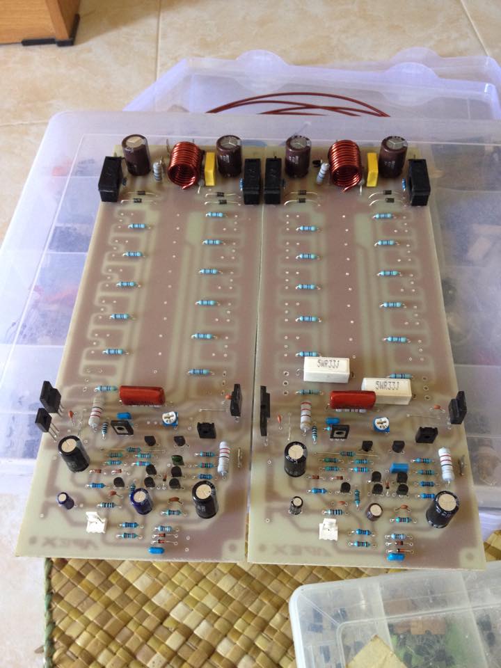

There is mistake I made with tracks connecting trimpot. You can rotate trimpot 180° or turn fully clockwise then turn anticlockwise to adjust bias.
BanglaH,
apart from the above valid point, I also suggest BanglH to check the heat sink plate used if its touching any leads of the resistors/diodes below thus shorting the connection.

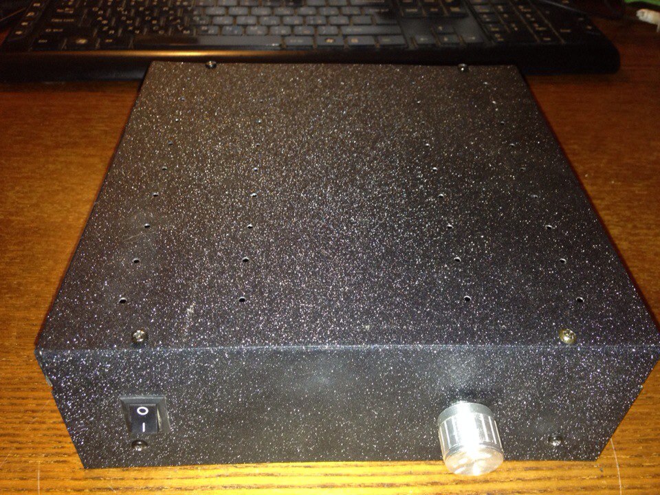

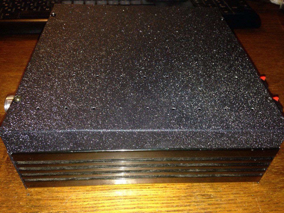

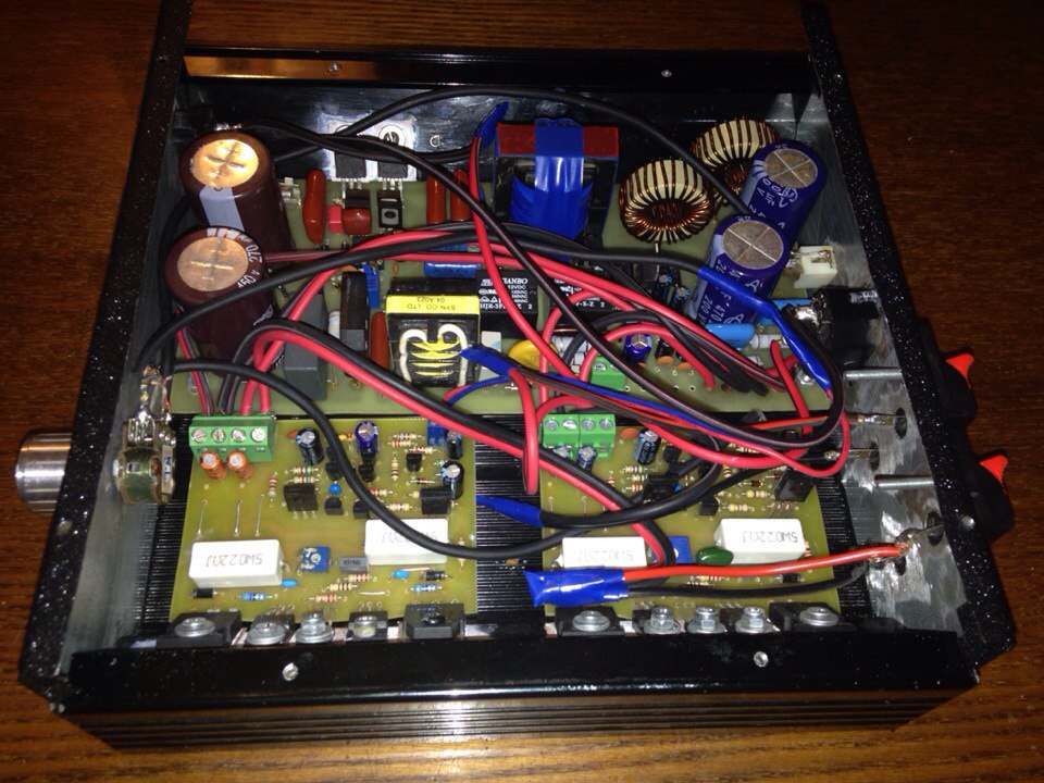

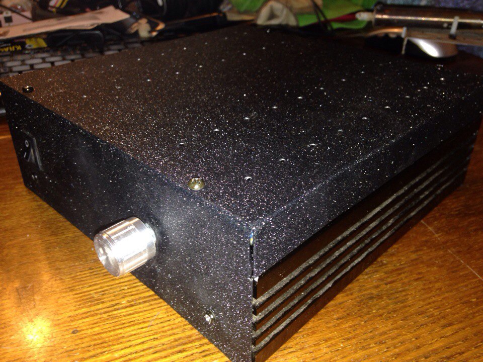

I finished casing for its AX-14, the body of 1mm metal, covered with self-adhesive, the cover has small holes for ventilation. It sounds a loud, high-quality, connected 10 ohm speaker system
