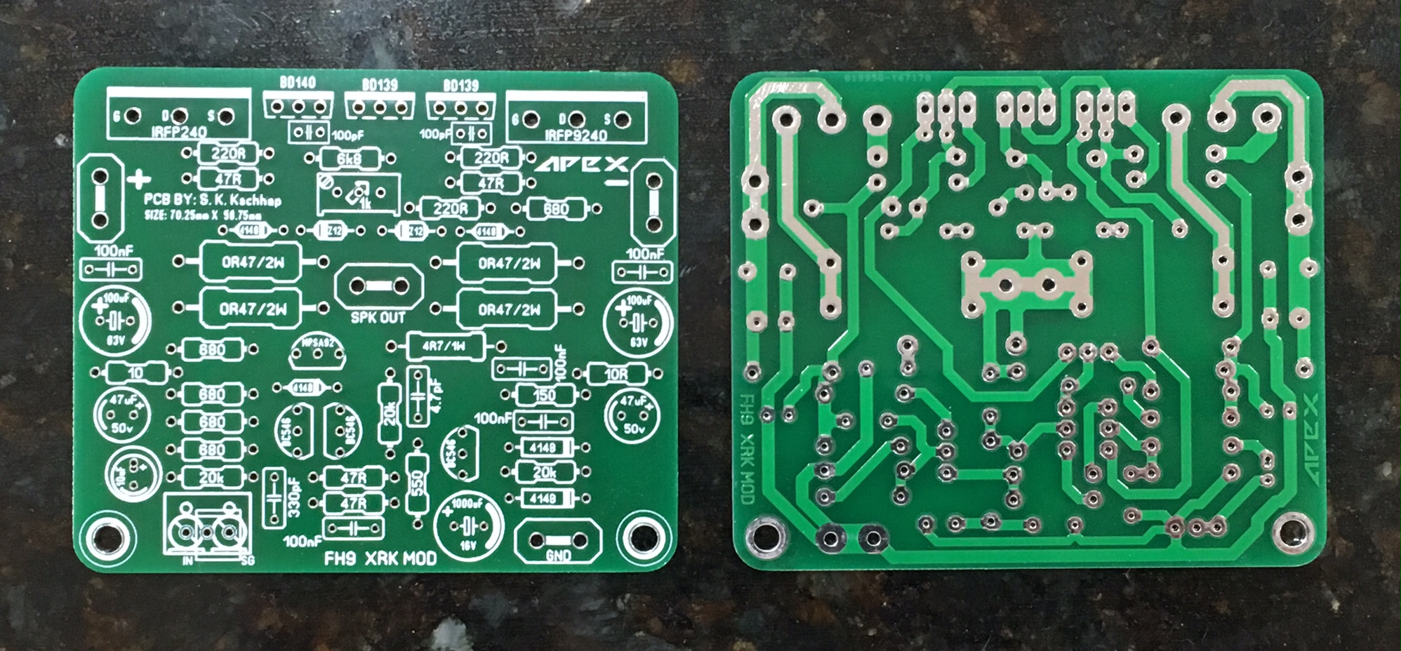

FH9 First Sound

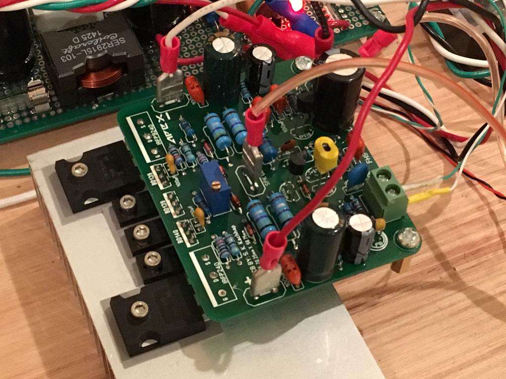

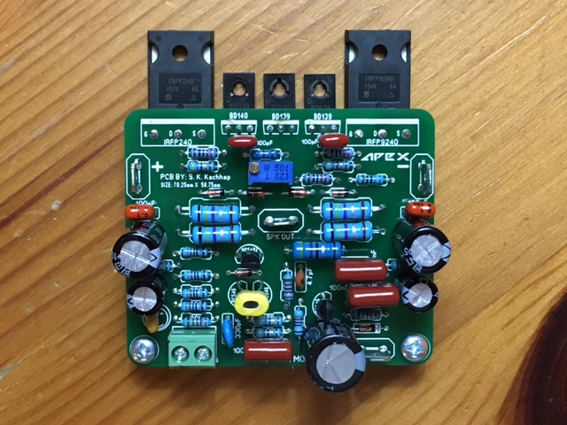

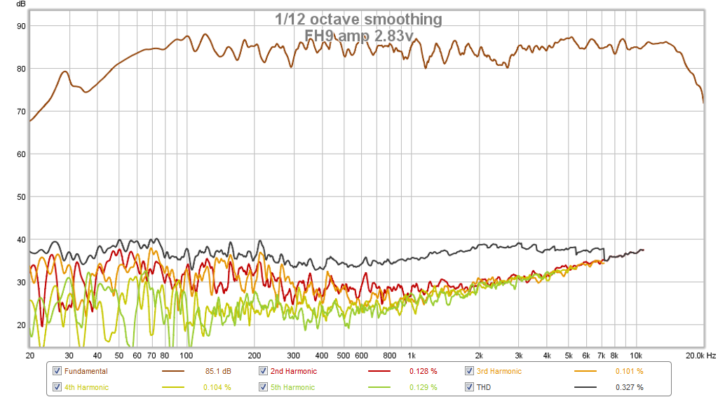

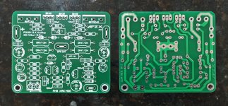

This amp is super easy to build, basically same as FX8 but with one more transistor and four drain resistors on the output. It fired up the first time no issues. With matched BC546 input LTP's I am getting 3mV DC offset. I set it for 110mA bias current and it sounds real nice. I have it powering my usual Scan Speak 10F/8424 and Dayton RS225-8 transient perfect FAST speaker. Deep clean tight bass, clear mids and highs. Harmonic distortion spectrum of the speaker is just as good as my Vhex amp - so we know that the amp is not the source of the distortion spectrum. However, when I first turned it on and listening to it cold - it sounded terrible. It needs to warm up and likes to run hot (not too hot as I can touch heat sink indefinitely). This amp is completely built from Aliexpress parts including the IRFP240/9240 hexFETs. This was my test case for hexFETs from China - seems to work well.
Here is the amp fed by a 35v rail 250VA power supply:
Here is the measured HD spectrum at 2.83v and 0.5m - very similar result to my Vhex reference amp.

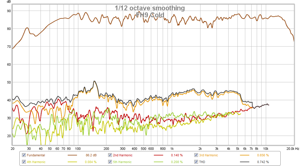

Here is what the HD spectrum looked like when it was still cold - look at all that H3! Good thing I continued to let it warm up.

Congrats on another successful build. We need to find out why the sound is distorted in cold condition. Is it due to some cap burning in, or due to bias instability? In case of cap it should not repeat.

Thanks Prasi. I suspect it may be a cap burning in because I can't get it to repeat. From cold start this morning I got the same result as the low HD result.
This is the first time I am using the monolithic multilayer 100pF 50v cap at the base of the BD139 and BD140 drivers (those little beige colored caps). I wonder if those needed burn in?
Next one I will use either film caps there or mica discs.
Well at least the problem is gone. 🙂
Want to thank Sonal Kunal for the nice Gerbers.

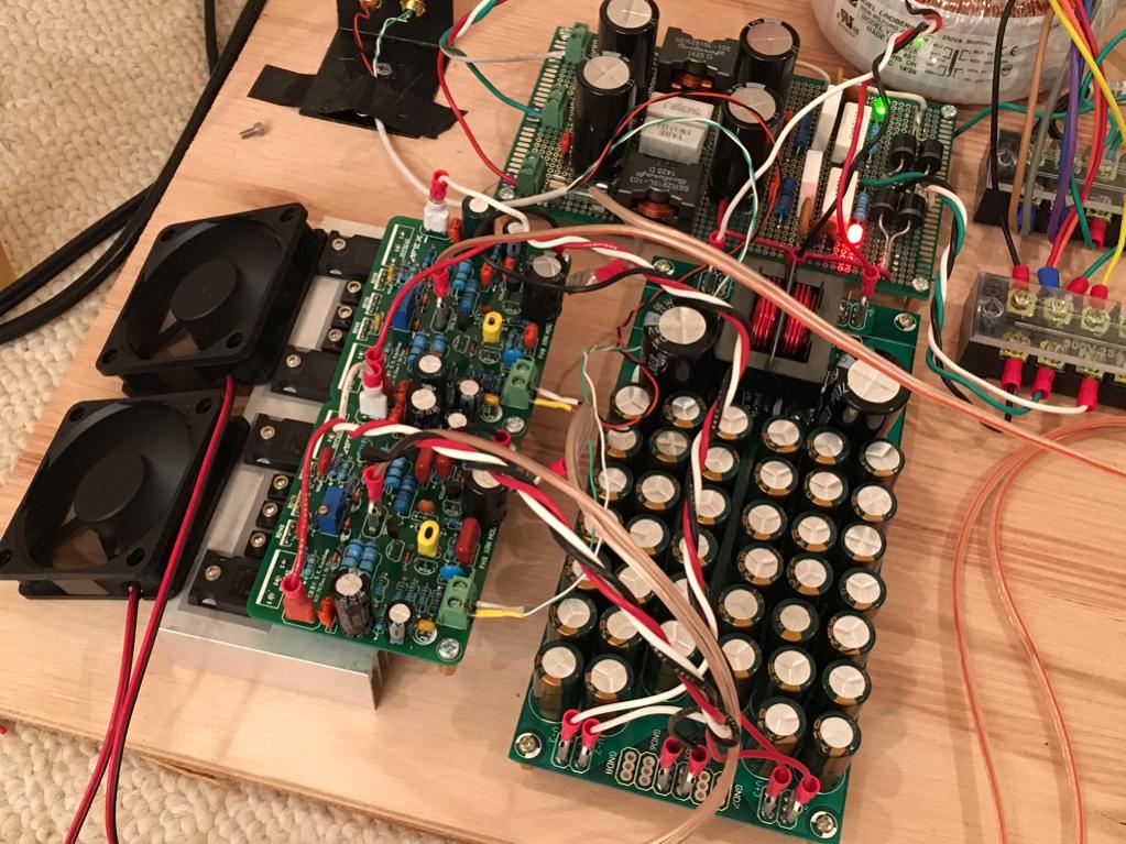

Second channel just built. Need to mount on heatsink. I am doubling up on 1 heatsink and fab cooling.

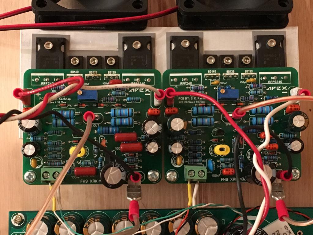

FH9 in Stereo
Both channels singing gloriously together. I have to say, this amp sounds fantastic! It's one of my new favorites - the bass is really authoritative, tight and deep. Mids and highs are clears and enthralling. No sibillance, no harshness - just smooth. Very nice. 😀
Highly recommended build given the low cost of the hexFET and simplicity of the design. I can give you guys the link for the budget, yet great sounding IRFP240/9240's from Aliexpress if anyone is interested. They appear to be genuine articles given that they sound great, and the finish on the metal heatsink tab and legs is clean and satin - not stamp cut chrome looking.
I made the second one with film caps for 100pF, and used some polyethylene 100nF 400v for the bypass caps as I ran out of the usual orange drop 0.1uF 100v film ones.
Here it is powered from a 35v rail 250va linear supply with a big low ESR (2milliohm) cap bank:
Still running at 110mA bias. Will try the 400mA bias next per Jay's recommendation. However, I don't detect any distortion here.
