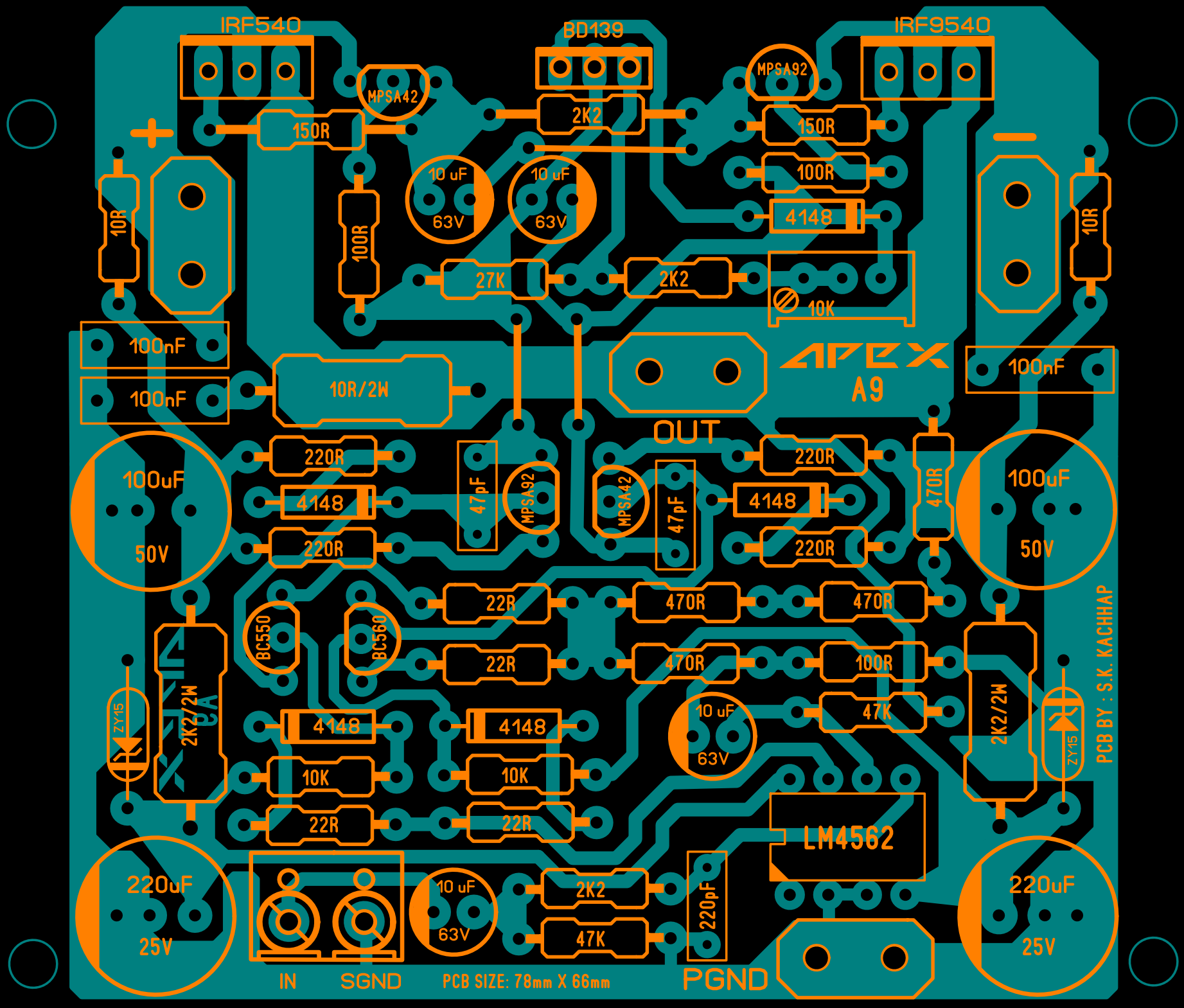

Any simple rf540 irf9540output used amp files pls share becose i have 10pair of mosfets .
Thanks in advance
Looking at the specs - for the FH9, I think you can simply substitute the IRF540 whenever I used IRFP240 and IRF9540 wherever I used IRFP9420. The current handling on the smaller TO220 package actually appears to be higher and dissipation is he same. The Vds is only 100v but that's plenty. I believe it will work just fine. You may need to spread the pin spacing on the TO220 package a bit to fit the spacing on TO264 format holes.
Go for it! Maybe others with experience interachanging these can chime in.

Greetings sir
I will try to build a5.1 home theatre .i have small pcb size and low cost pls help me sir
Order some FH9 PCBs from your favorite online store. Shouldn't cost more than $25 for 10. I use Seeedstudio.com
The FH9 HV can be built (not including heatsink and psu) for about $5 to $6ea with parts from Aliexpress. I use Dell GX260 SFF PC Pentium CPU heatsinks ($4 on eBay). Use with a 12vdc fan. The PSU's will cost real money. No way getting around that unless you make your own SMPS or happen to be able to get the $25 Abletec 53v dual rail 450w SMPS with free shipping. For a 5.1 system you need three of these power supplies.
But you would have a 6 channel x 120w/ch system that really can sound good. At these powers you might want speaker protection as it can send 35vdc to your driver.
However, if 60w amp is enough for you then base FH9 can be used with 35v power supplies. You can get 35v SMPS or 250va 27vac trafo can make 35v supplies.

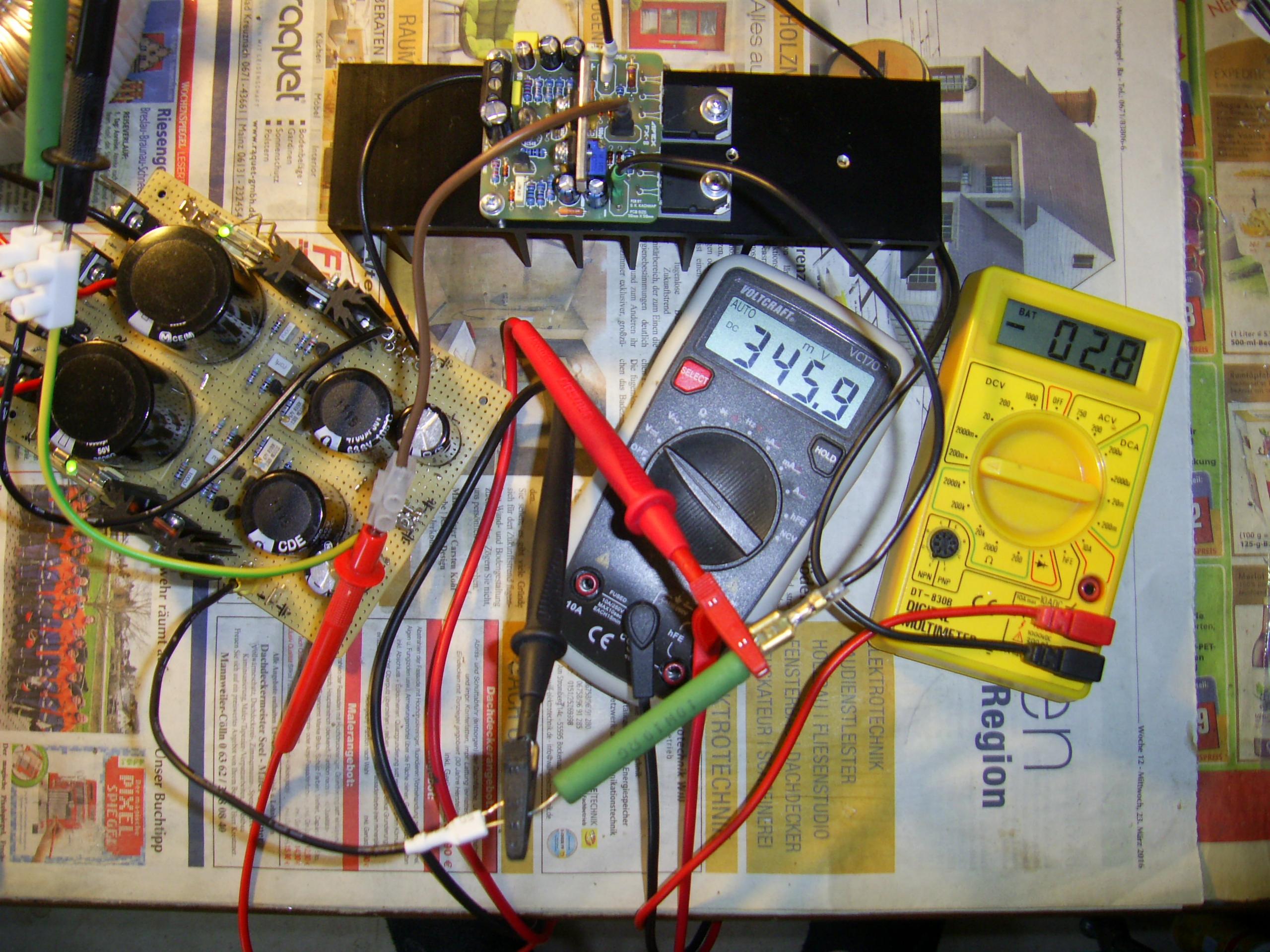

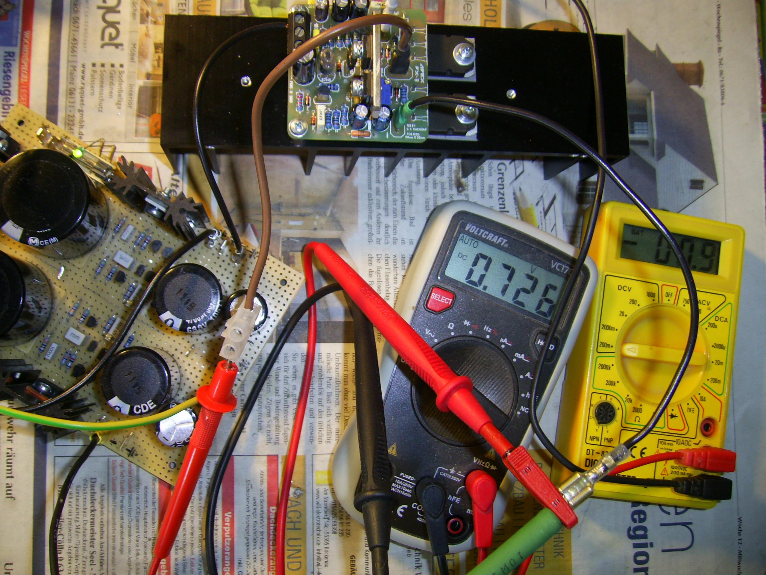

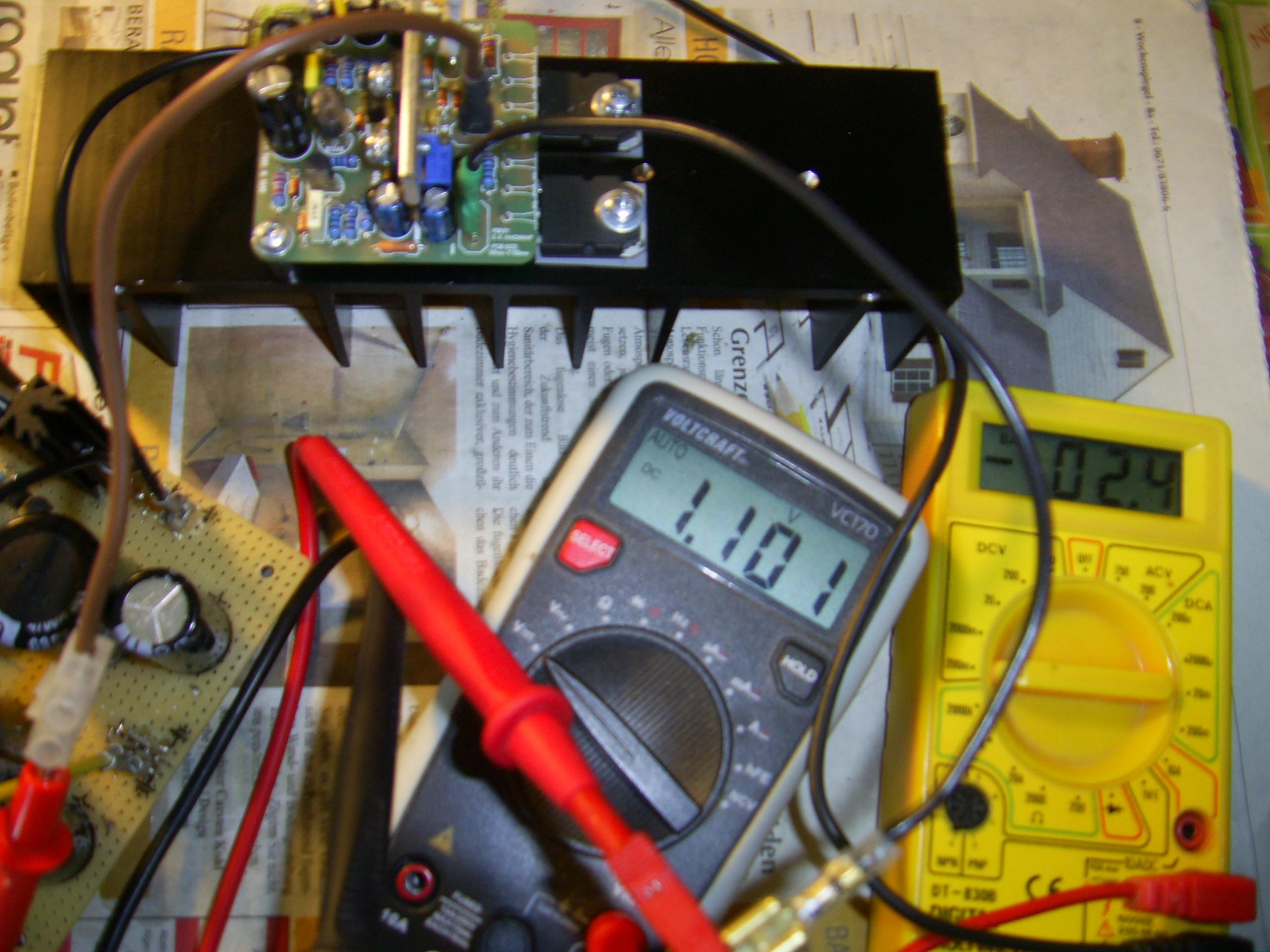

Hallo Friends.
El Stupido has corrected his failure with success.
I have looked again Datasheet BC546B- very good parts- so desoldering MPSA
and go to BC in LTP and CCS.
Both channels are biased now to 100mA 35VDC and the heat sink for drivers is bigger- because the bias was wanking by blowing air or touching by fingers.
I now can listen the potential of LatFet in this simple Amplifier.
The sound is very clear and transparent- light to follow, non fatigue.
It has a good jumping dynamic and bass if given from source.

sownel see my pics: FX8 100-110mA on 50mm high heat sink works with
comfortable heat- so you can build a compact case 5.1 Amp.

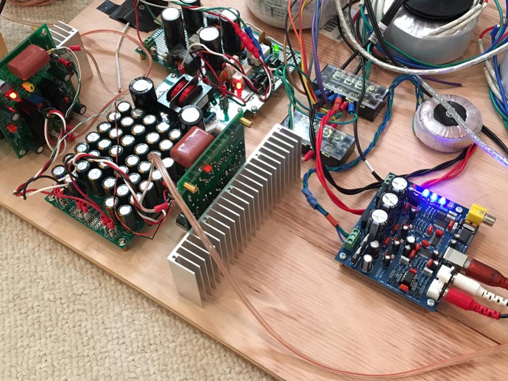

Nice work BanglaH. Glad you found the problem - I also had problems when trying to use 2n5551 in place of bc546b. Switched back and works fine.
Those are excellent heatsinks - you can probably bias at 175mA which is where I like to run mine.
The sound is indeed excellent. I just put together a great CS4398 DAC from Ali for $23. Sounds very nice compared to built in DAC in laptop. Has socket for output opamp, currently fitted with NE5532, maybe will try Burr Brown OPA2604 next...
Here is is working with the FX8 Bimo very nicely.
Nice cleen setup.Nice work BanglaH. Glad you found the problem - I also had problems when trying to use 2n5551 in place of bc546b. Switched back and works fine.
