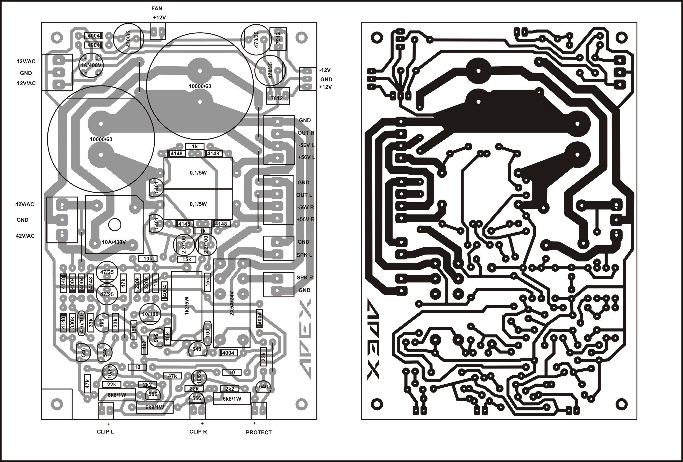

PSU pcb for F100 size: 130x90mm

Thanks Mr MILE previously.
I have a little problem about the transformer, with specification 5 Amp 30 Volt CT.
I've made ​​PCB Power Supply type F100.
the question whether there are components thatmust to be replaced if I use 30V voltage CT ?
if I replace the 0.1 ohm to 0.5 ohm 5 W what happened?
and 1K2 to 1K5 5 W what also happens?
Please help Mr. Mile

5Aac and 30Vac centre tapped is 150VA.
What amplifier and speaker are you expecting to drive?
Andrew thank you greetings. My question in addressed to Mr. Miles, because I'm building the power supply made ​​by APEX-type F100. original circuit uses transformer 42VAC secondary. The problem is I do not have a transformer with a 42VAC secondary.
I have a 5 Ampere Transformer 30VAC
The question is whether there are components thatmust to be replaced for this circuit works maximal

Replace 0.1R/5W with 0.22R/5W and 1k2/5W with 680R/5W for 5A 30V CT transformer.

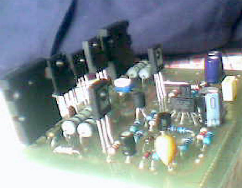

Hello sir mile
thank you, finally I finished with my AX14, sounds quite satisfactory results. and I have a plan to replace my TDA7294 with AX14.
if I want to make the AX14 as a sub amp is there anything that needs to be changed at the input section , in addition to the existing sub filter?
