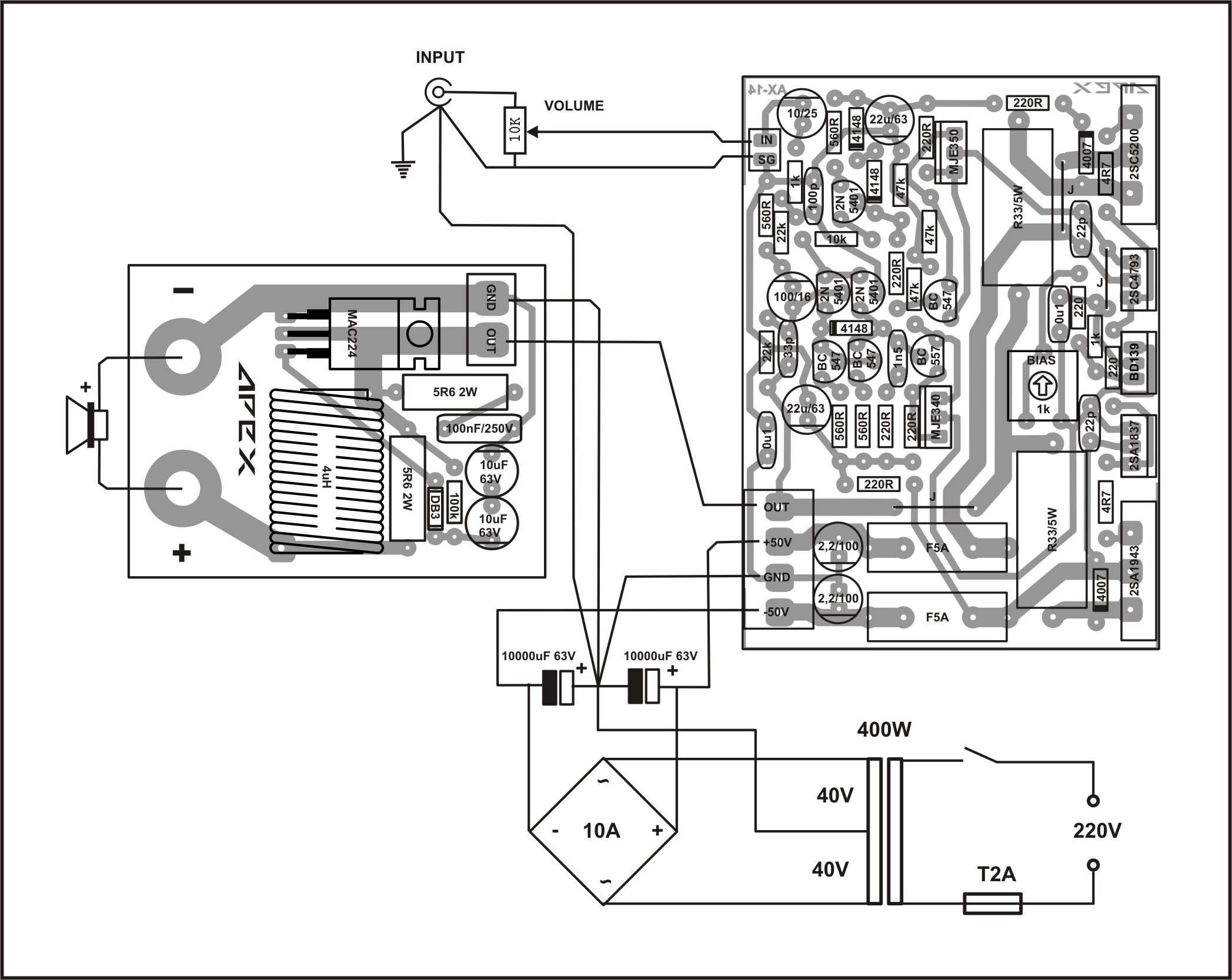

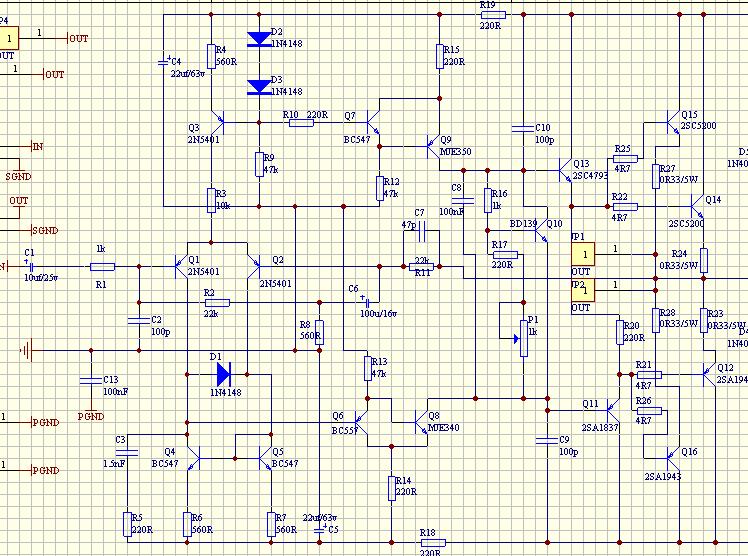

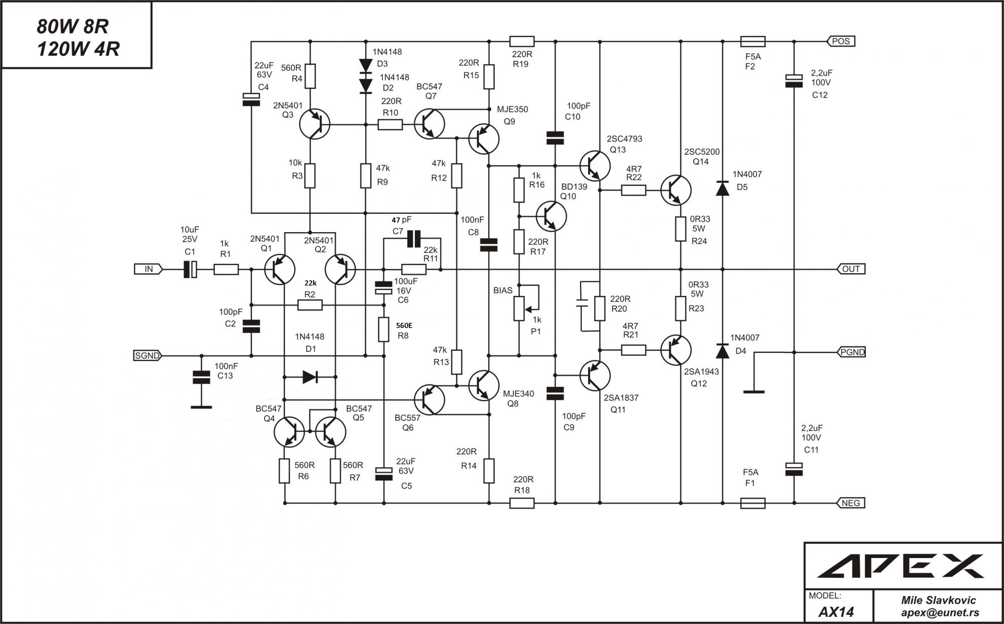

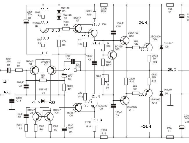

will this 3 EF work with ax14?

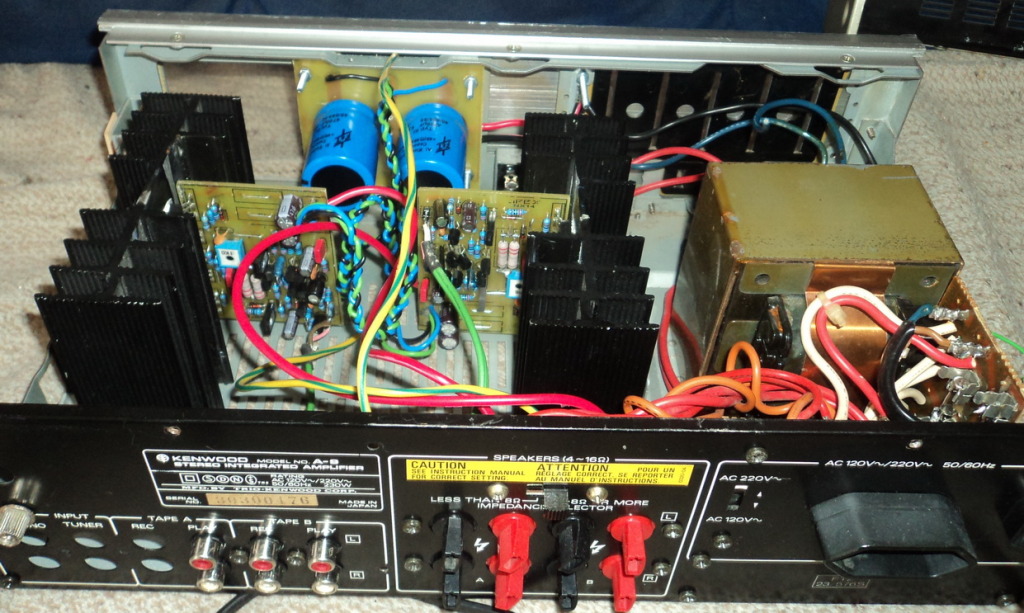

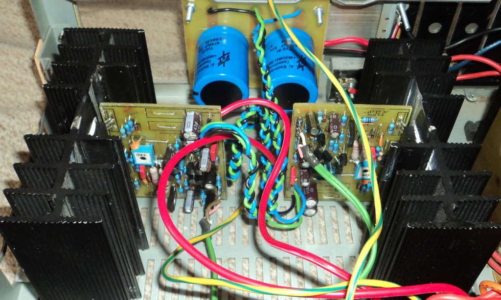

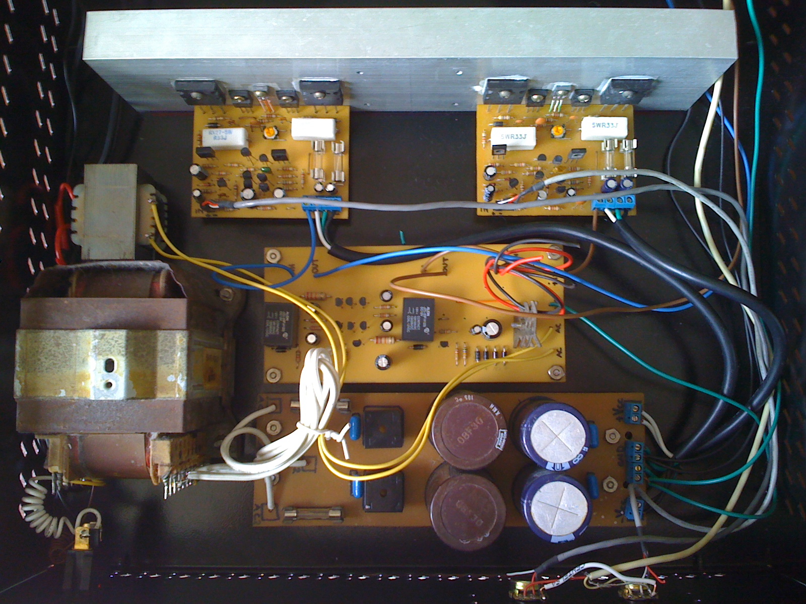

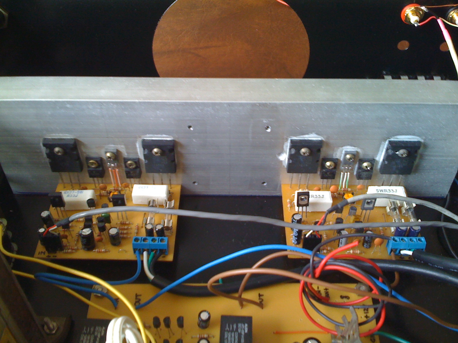

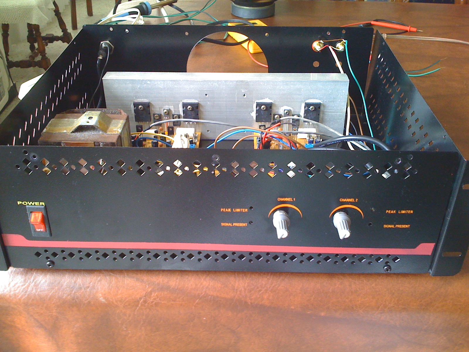

Advice taken, bd139 moved to the heatsink between the power transistors, second module built, case from local electronic supplier, DC detect and delay module added, space for 12 cms fan.
PSU: 200VA trafo with 2 x 39 Vac, 2 x KBPC806 bridge rectifier, 16800uF per side
DC detect and delay from Silicon Chips magazine.
First stereo test: I like it!! :D Very clear, no noise without music, good voices and bass, highs ok (on piezo tweeter).
I'm attaching some pictures, I'll add some more pictures with better resolution when I get my camera back.
Mile, I saw my first amp picture on facebook, thanks for putting it there, and thanks again for sharing your design. :cool:

Nice work, is this diy case or you use some from brand amp?
