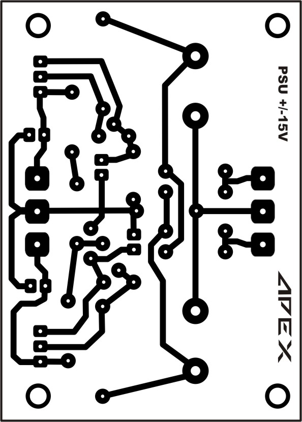

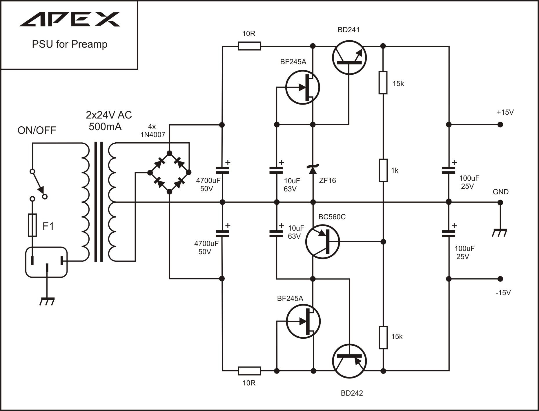

This circuit have +/-15V stabilized output voltage from +/-55V amp rail voltage on input, can be use for preamp PS.
hi sir apex do u have the psb layout for this?
No, but circuit is simple, you can design your own pcb.
Use this PCB for +/-15V regulator.
Hi Mr Mile. I agree if you want to share a PCB with a PDF file, I do not measure the dimensions of the PCB again.
unless the schematic and layout of premises component JPG files. Thank you Mr Mile.
I hope that friends and other friends.
+/-15V pcb

Before that, I thank my many+/-15V pcb
I question why PCB layout is not made Mirror layer?
I think it's easier to move the path to the PCB. thanks
PSU +/-15V mirror pcb layer.
thanks mile, I hope soon I will show the project in the forumPSU +/-15V mirror pcb layer.
Project will be +/-15V PSU?
