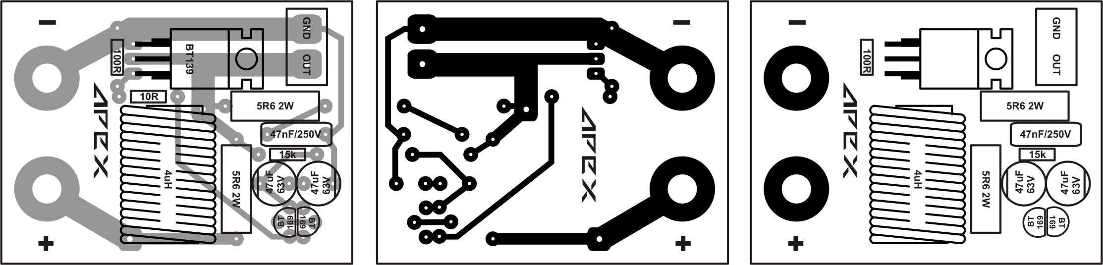

HELLO APEX SIR ANY CHANGES IN PCB LAYOUT.
CAN U SHARE THE PCB LAYOUT IN PDF.

HELLO APEX SIR
CAN U SHARE THE BOTTOM LAYER IN PDF.

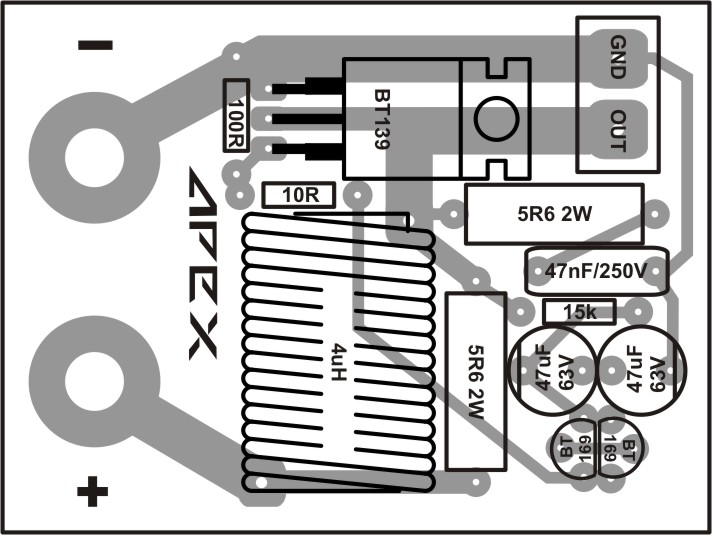

SO I CAN USE IT FOR AX-14 AND B500 WITHOUT ANY PROBLEM AM I CORRECT?
I KNOW THIS IS A SPEAKER PROTECTION CIRCUIT.
CAN U EXPLAIN THIS CURCUIT.

This DC ptotect can be use if rail voltage is over +/-40V DC, and if there is fuses in rails or amplifier output. If on amp out exist over +35V or -35V DC, triac conduct and short circuit speaker output.

Thanks, is this red line jumper from 'J' to 'J'?
yes red line for jumper 'J' to 'J'
