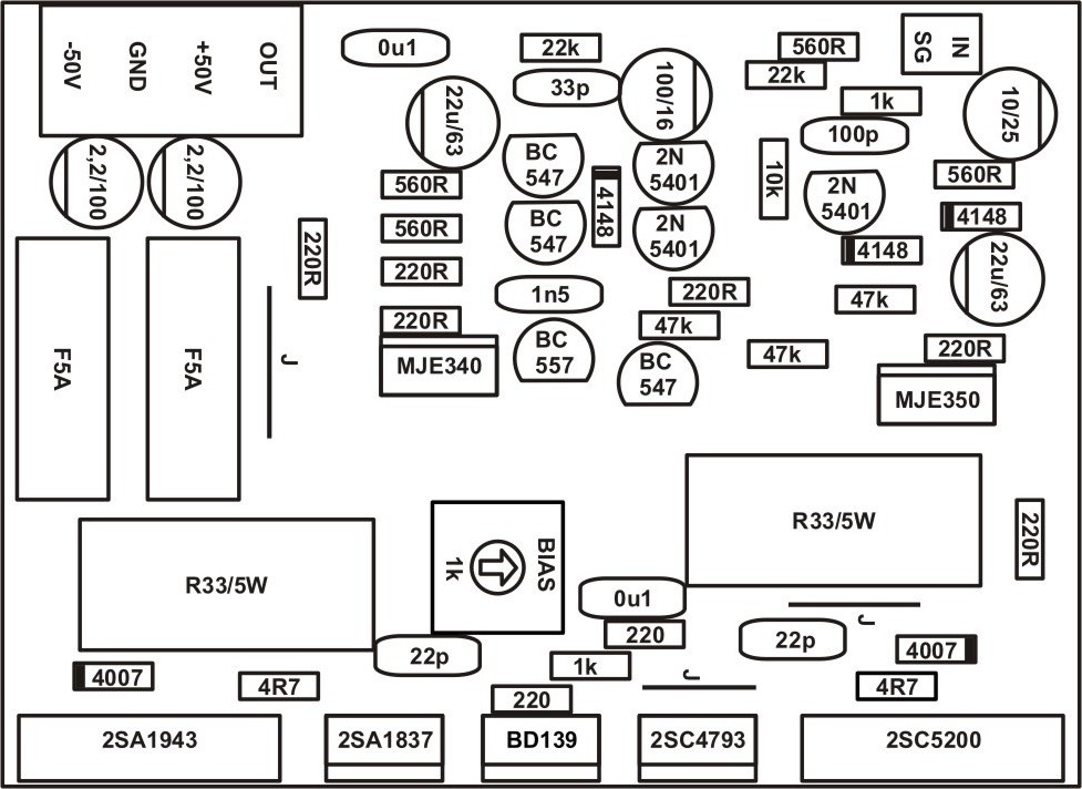

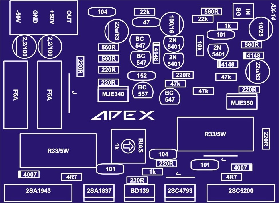

In first 104, 152
in second 0u1,1n5

> 104 is equal to 0u1, that is, 100 nF
> 152 is equal to 1n5, that is, 1500 pF
