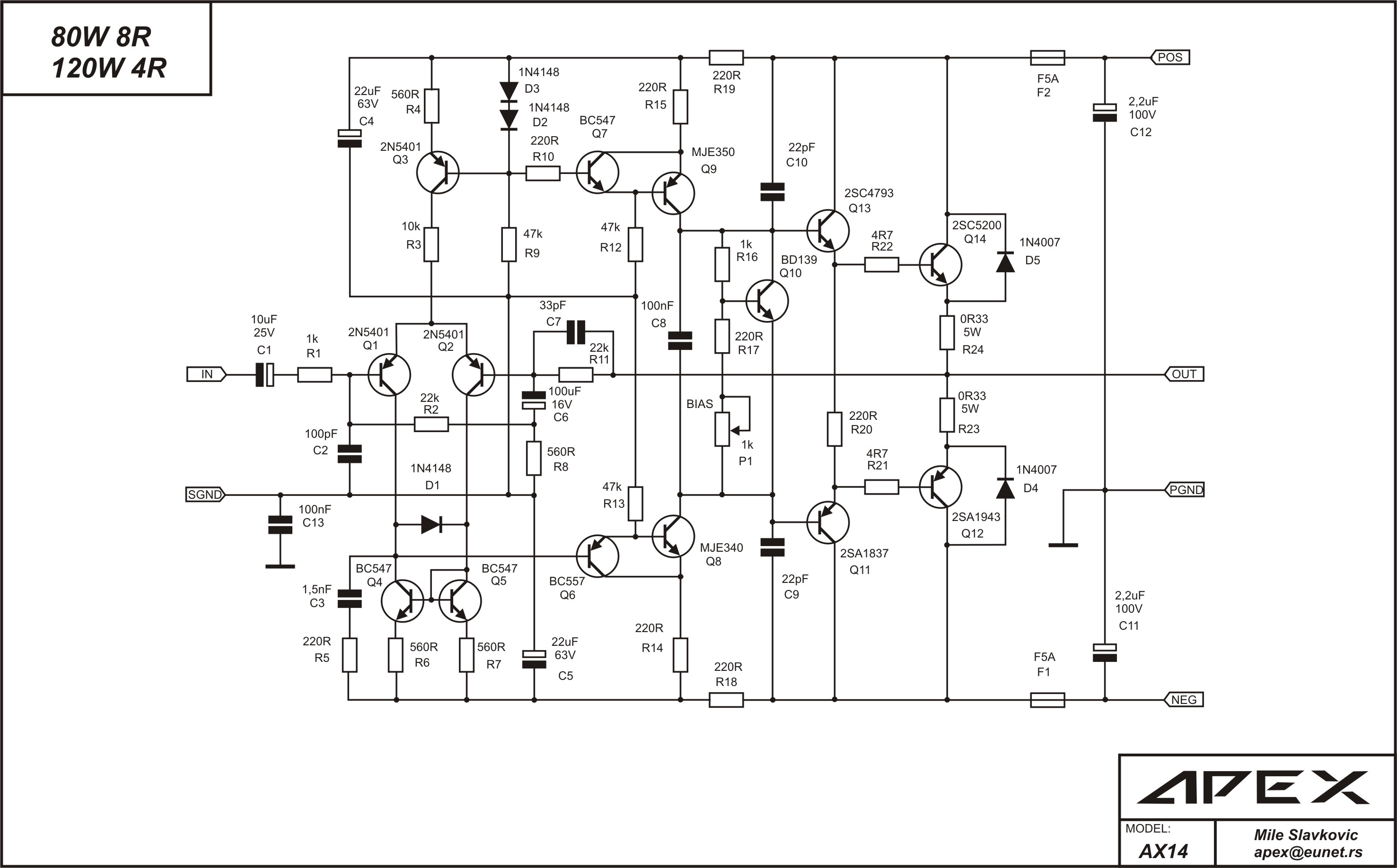

AX14 Schematic
thanks..
thanks sir apex i also found the pcb lay-out here in these thread surely i can make this one. post #44. APEX KELVIN BJT

AX14 Schematic

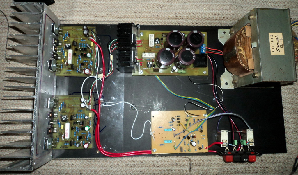

The problem is that i've 2 PSUs . i've read to connect protection card to OV from each channel using a 100R in serie (for each channel). What do you think about it ?
It's OK
Is it possible to use GND from loudpeakers connectors ? easier for wirring.
For other poeple that want to build ax14, very easy. Be very carrefull when setting the bias with a one turn pot !!
Yes, wire will be short.

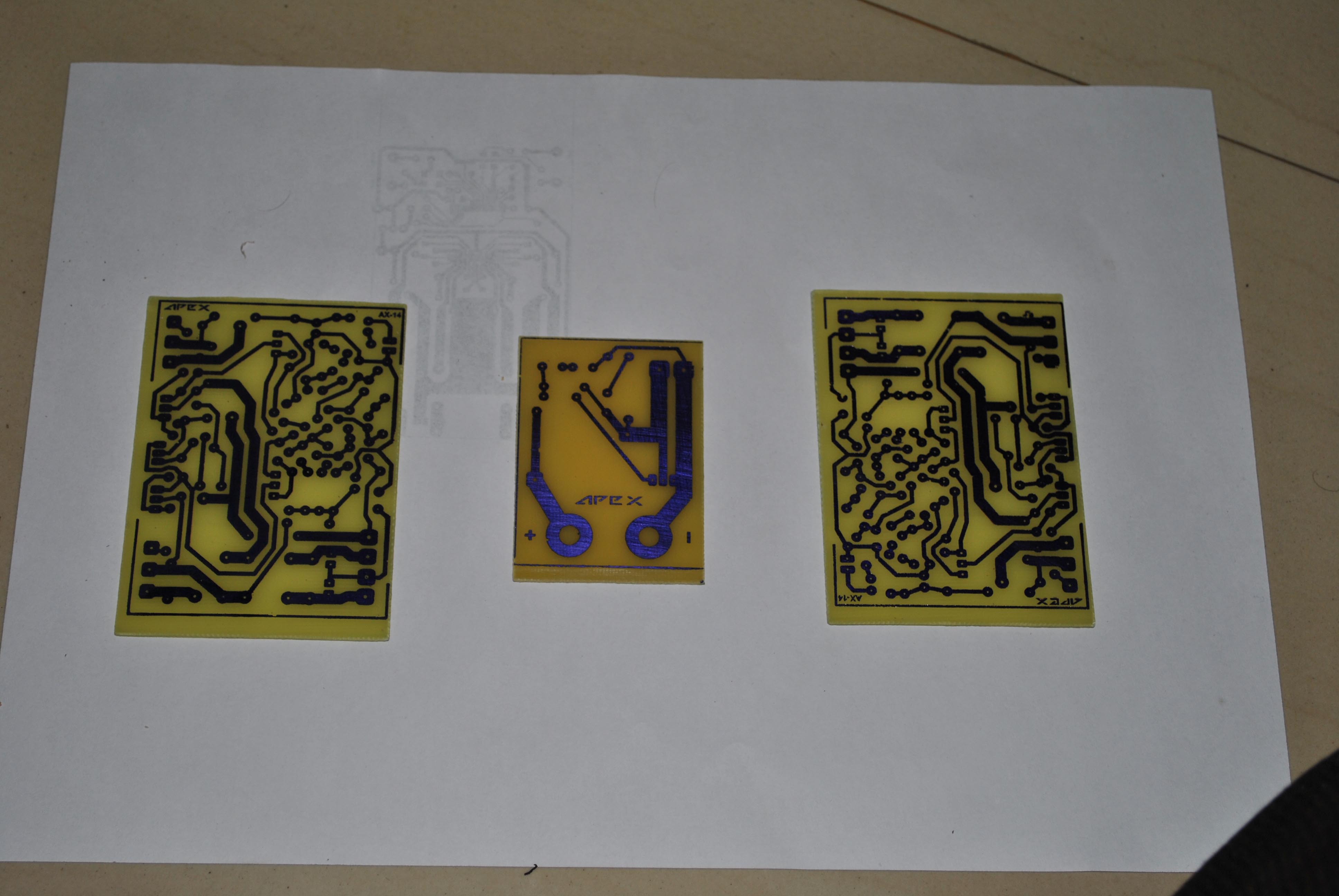

AX- 14 pcb etched
Hi
i have etched boards for AX-14.

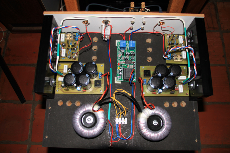

and please give a block diagram showing how to make connections between AX-14, psu with protect and speaker terminal pcb.
psu of f100 shows protect , clip where to connect them on AX-14
I have made 4 pcbs of AX-14 . I want to bridge them, need guidance for bridging and psu for 4 pcb.
And my etched pcb photo

What rating of transformer for AX-14 for i channel and bridged
Use 2X35V ac, 400VA for stereo.
