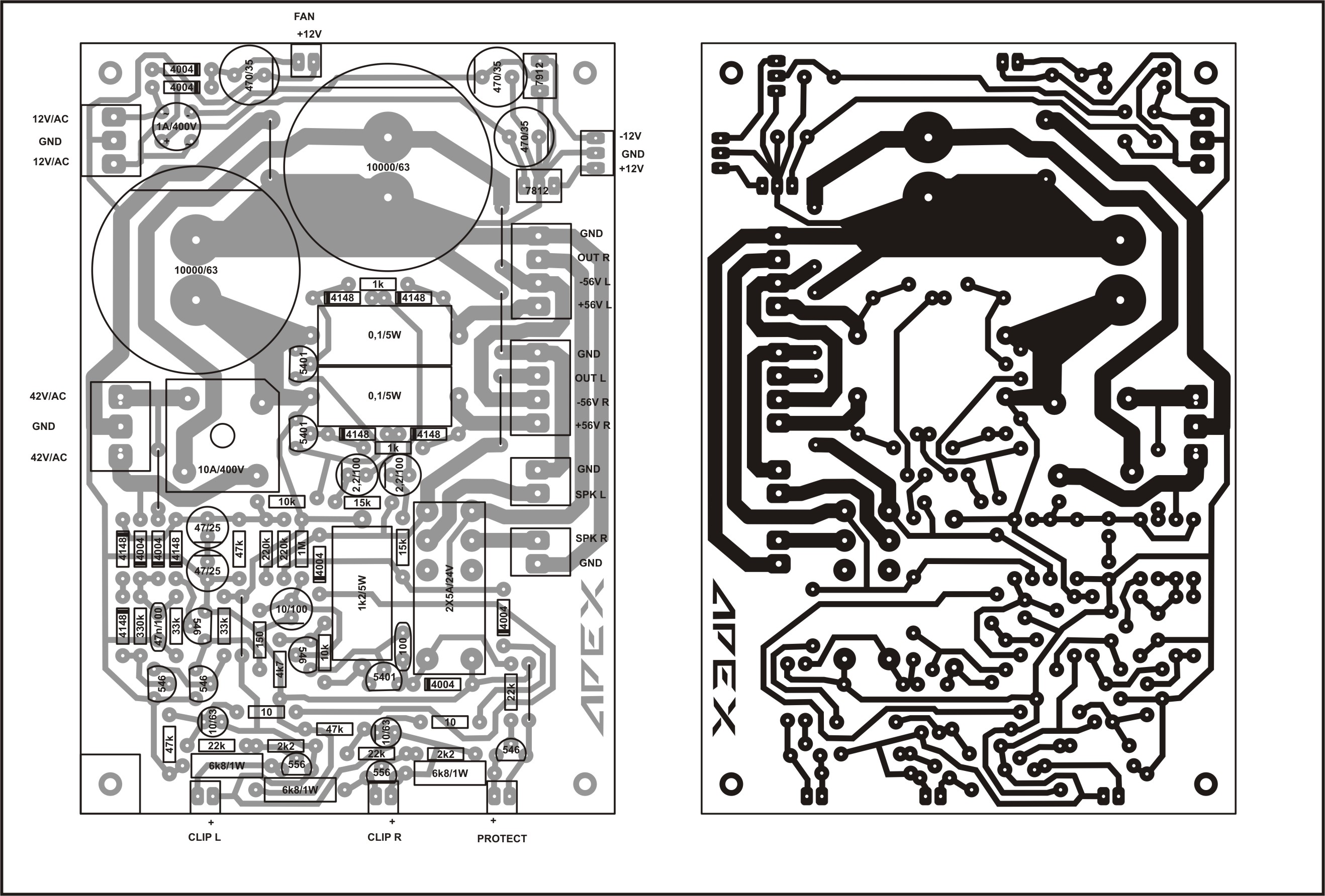

My amp doesn't work... 0V across fuses/10ohm resistors, 36V between + & - fuse clips, no smoke, no transistor heatups when adjusting bias pot, variable dc offset when no output load, but the speaker pops when connecting to output terminal... what could be the problem? does the driver transistors sensistive to heat? I think I overheated them when I soldered it to the pcb...

Can you post pictures, do you connect input GND to PSU GND?
yup, i connected the input and output gnd to psu to gnd ground[/QUOTE]
Picture not clear, but your soldering don't look good.

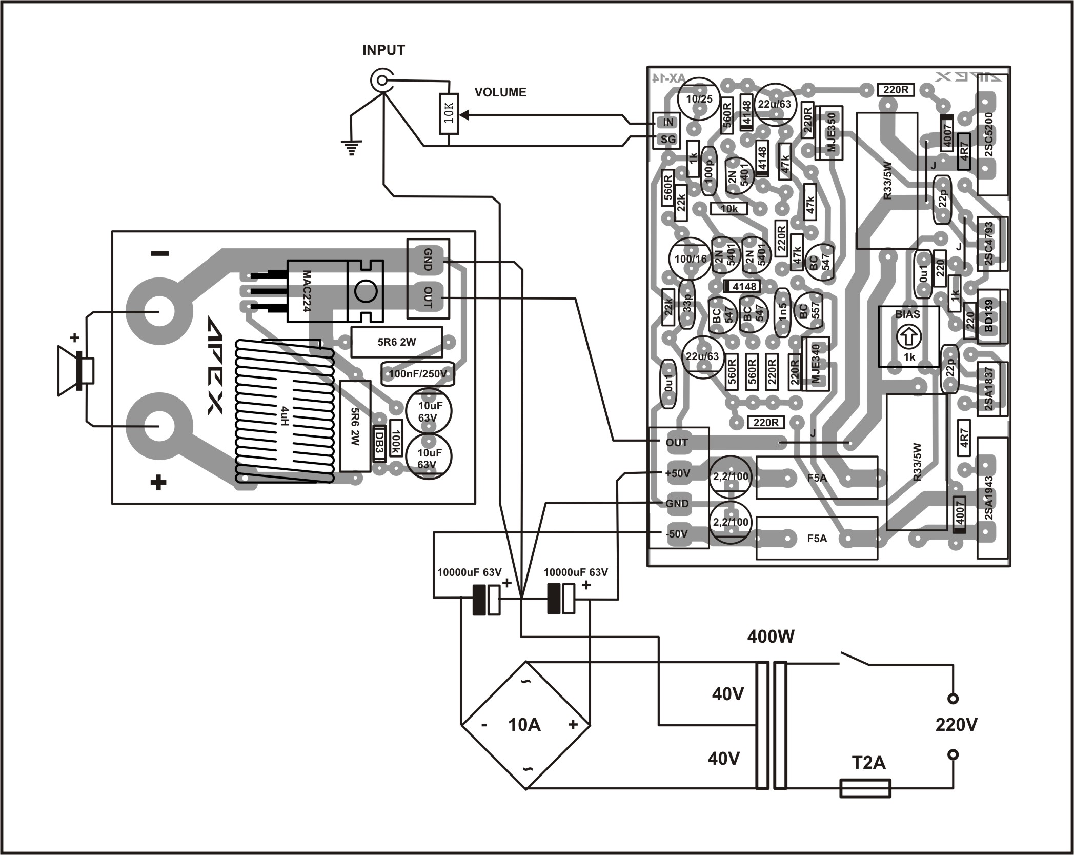

How to connect this pcb to ax-14 amp, does this have voltage regulation
First is PSU with protect, second is regulated PSU.
Can both be used
Yes both can be used, and some other PSUs.

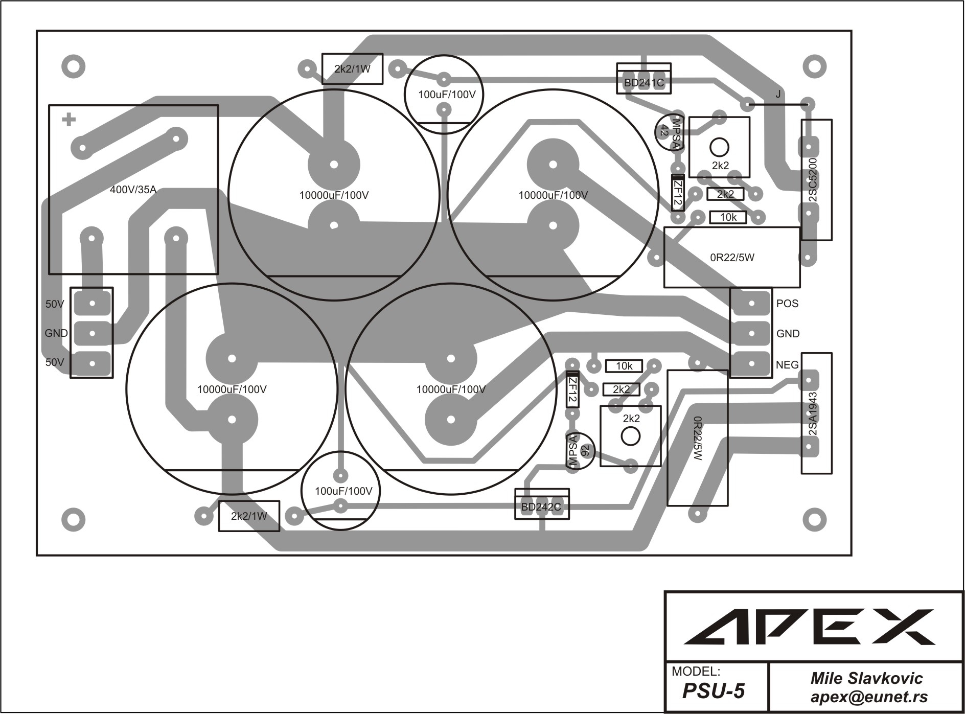

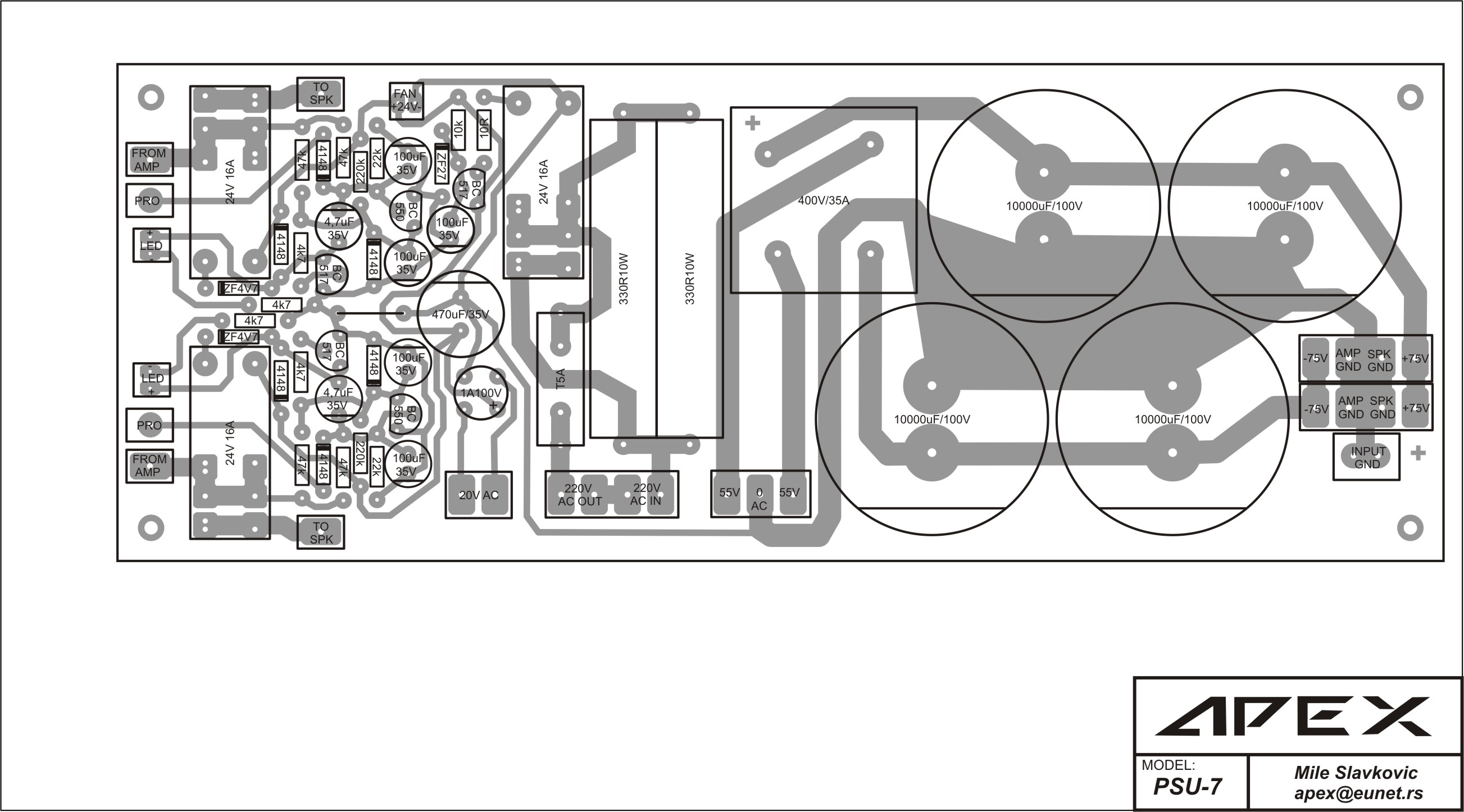

Does this psu provide regulated supply. Also give pcb diag for etching
No, this PSU is with soft start for main transformer and separate protections for each channel.
