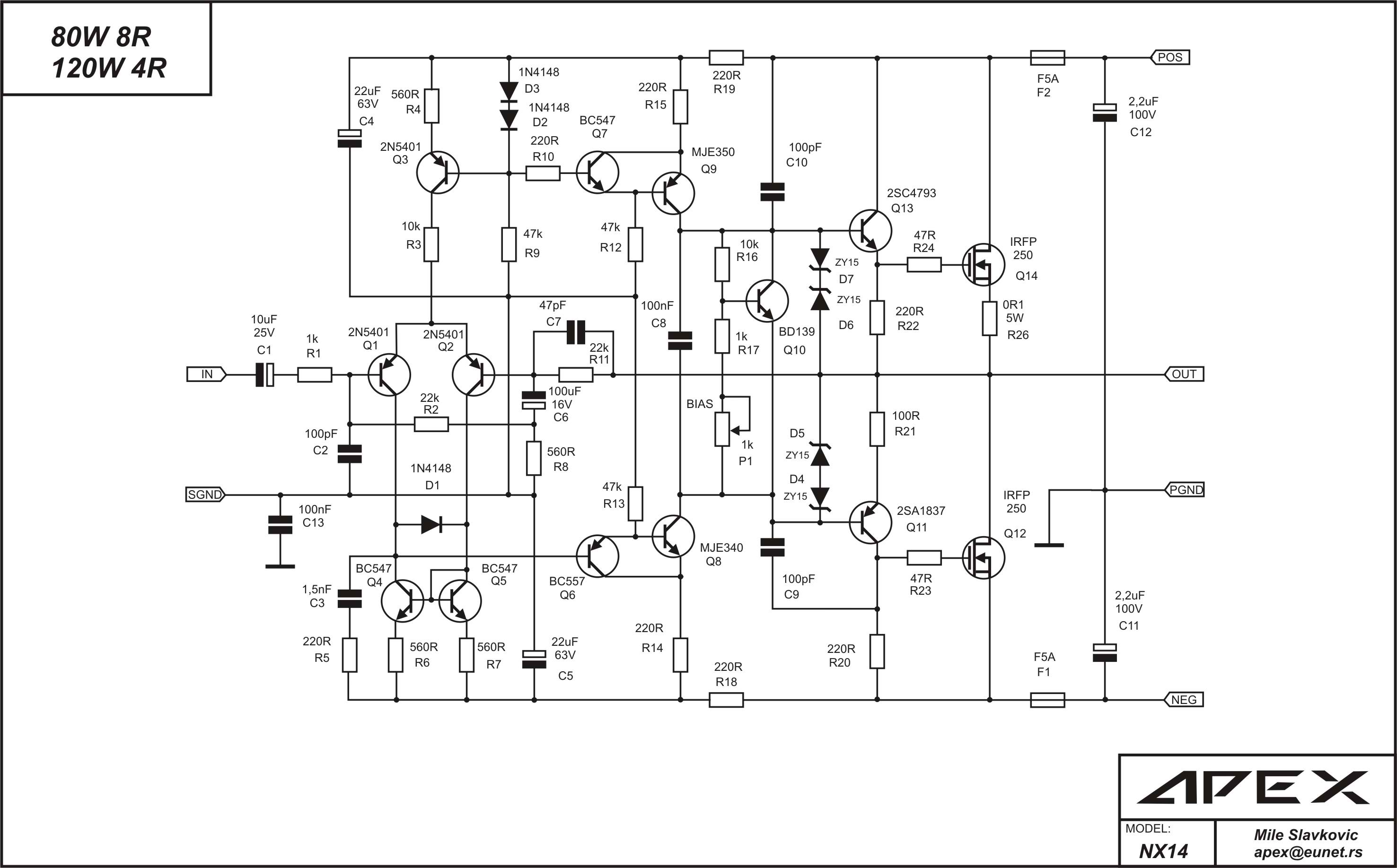

sir apex how to bridge this circuit pls..............

Why do you want to bridge Hi-Fi amp? Load can be only 8R in bridge mode.
so that sound be come louder in bridge mode. yes i put in 8R

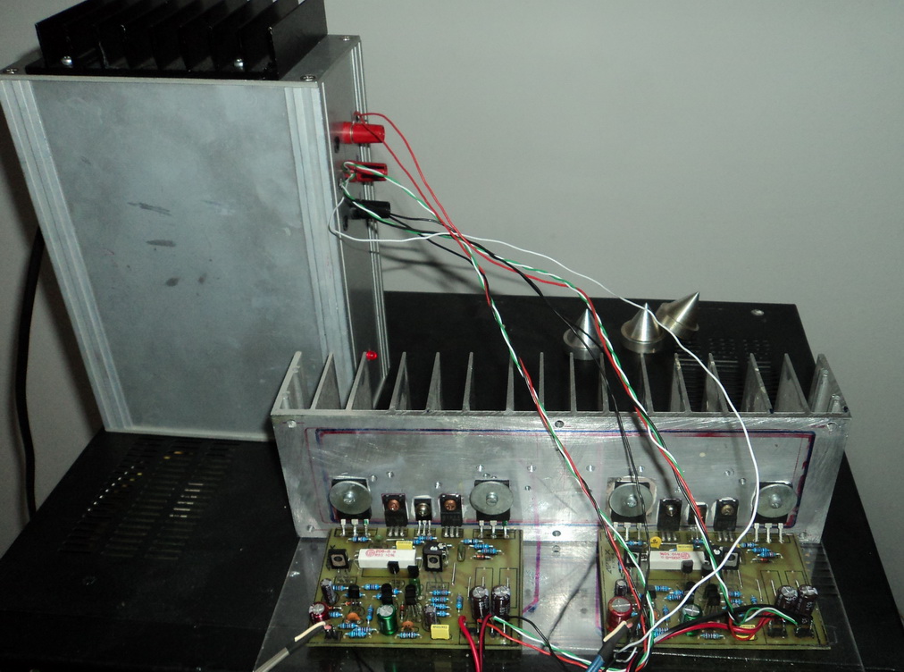

Here i'm again...

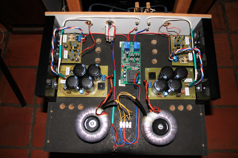

The two channels are working fine. Bias at 1,3V (best for my taste). Box is not finished but in good way.
Regulated psu 40V 4X10000uF for each channel.
2X120VA Transfo.
Good Bass.
Offsets: 3mv and 5mv. Need absolutly the wiring from Apex.

Nice work, thanks for the pictures. I suggest to use metal case. What is rail voltage?
Regards
which speaker protection you use .pls post the pcb layout.

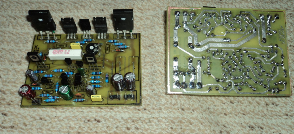

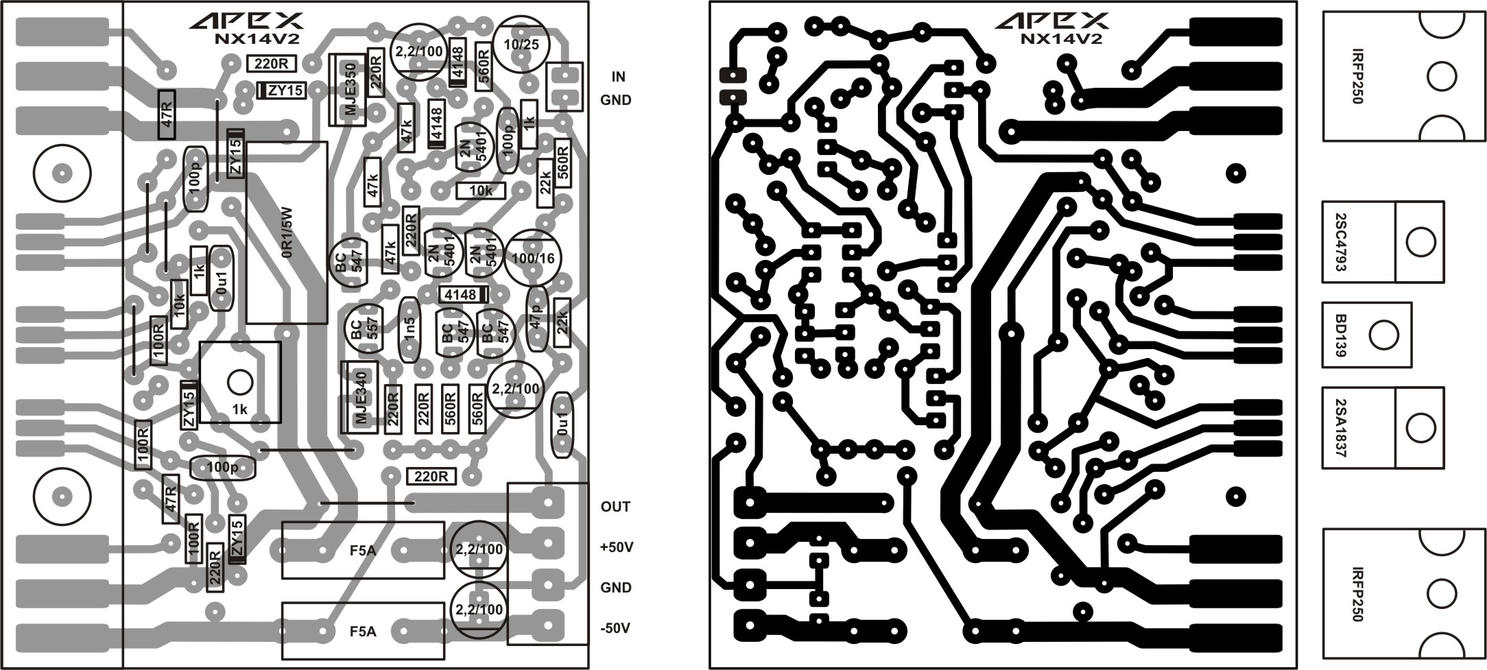

Hi Apex Again!
This is my pcb, but im not sure for true montage of tranzistors? Can you help me ?
Sorry for my bad english.
Hi Apex Again!
You made miror reverted pcb, you must revert transistors pins, drivers and outputs you can montage on botom side of pcb.
Regards

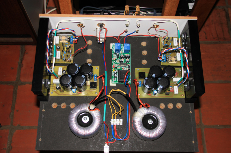

Transfo 2X30 AC (2X33V with 240V) , 45 DC regulated to 40V .
Too much projects for metal case, but i'll use a métal cover.
Heatsinks are warm but it's ok.
AX14 is giving very low bass. (my woofers can give 30HZ and i "feel" the bass in my body.

You have only 120VA transformers but PSU with 4X10000uF regulated on +/-40V there is no any rail voltage drop, and You have very low (good) bass.
Tnx for reply! And i revert my electrolit capacitors ?
No, polarity of electrolit capacitors and diodes are OK.
NX-14 made by 'nikko'

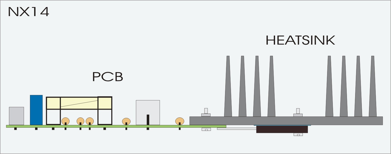

I must suggest to use NX14V2 pcb. This pcb is fixed on heatsink, and you soldering outputs on coper side of pcb. Montage outputs is much easy this way, and connection pcb on heatsink is much stronger, not just transistors pins.
