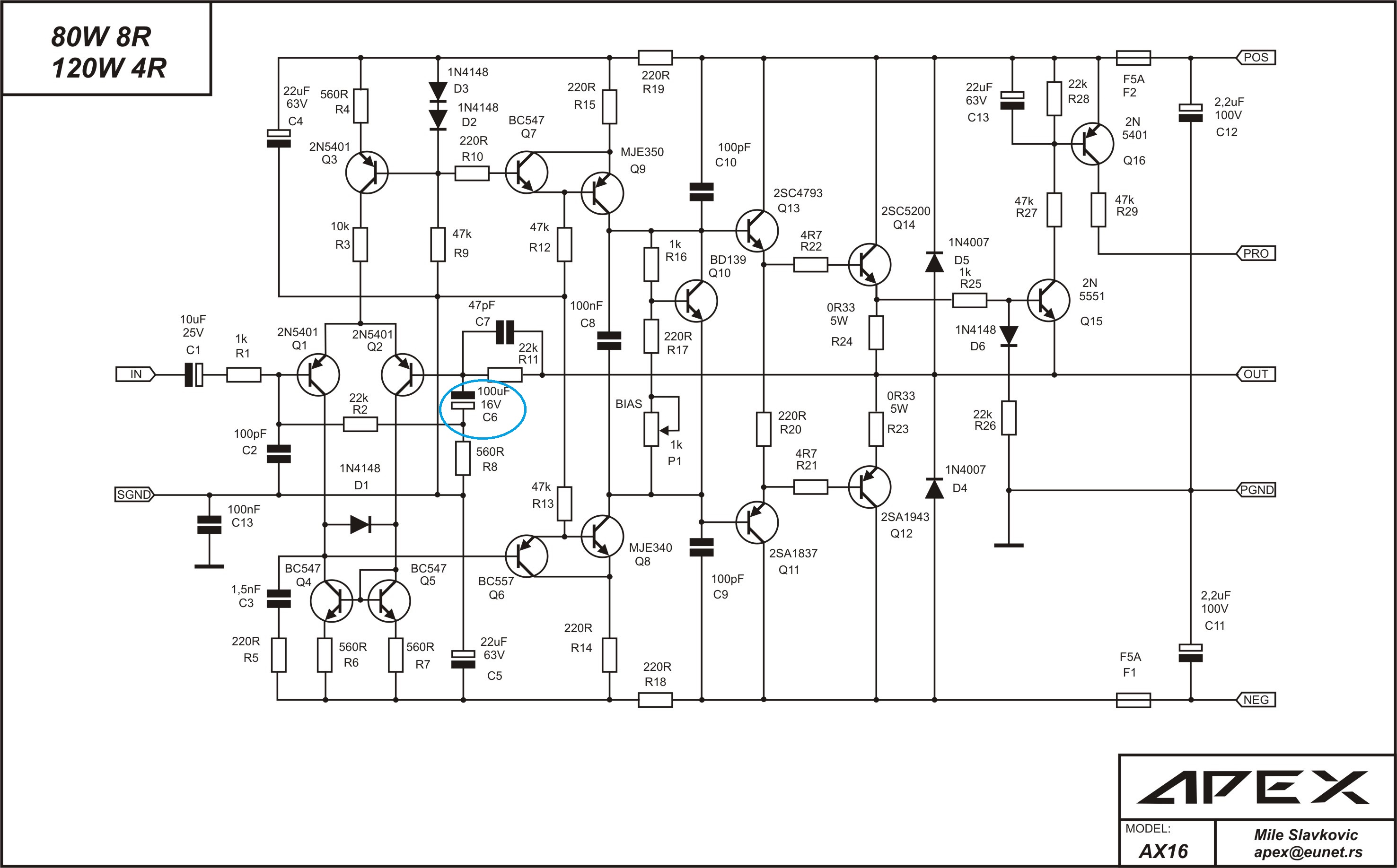

c6 seems contradicting on pcb layout of A14 and A16
C6 for bootstrap the input, the result impedance input is high.
My modification did not use bootstrap the input. Impedance input about 22K ohm is enough for me.

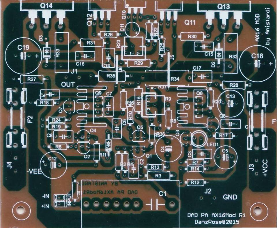

My PCB layout (AX16Mod) edited and produced by friend of mine.
Nice PCB

Can someone share the circuit for these amplifier. The one posted next to BIMO's post does not match the components (parts) location(s).
Ready to make the PC boards based on these layout.

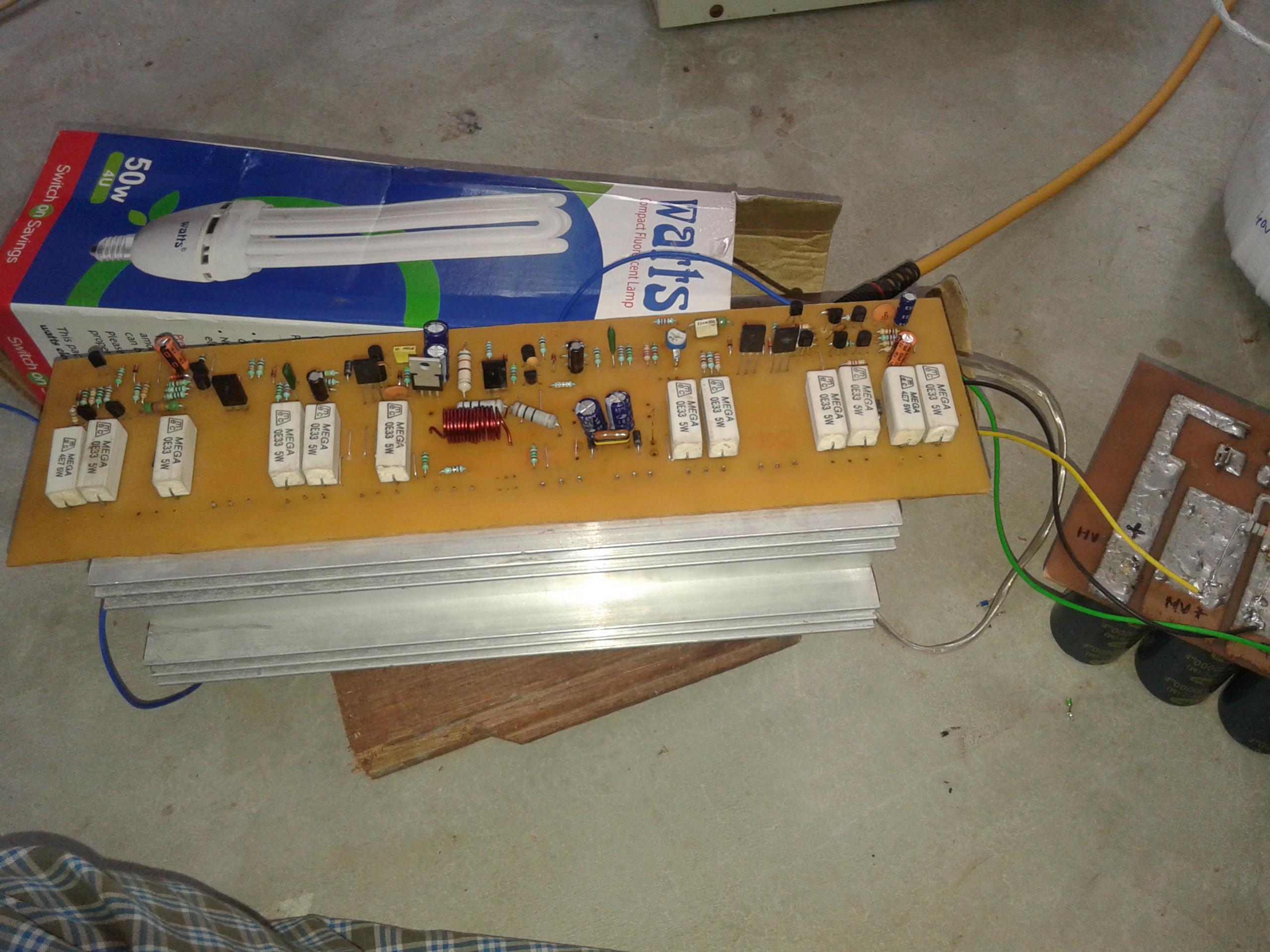

Terry you didn't posted listening impression after a couple days burn in.. (I would like to build one amp from Apex..)
If you burn in your amp at least 30 hours or so please share with us
Greetings
It sounds just like the original AX14. You can't go wrong with any Mile's amps.

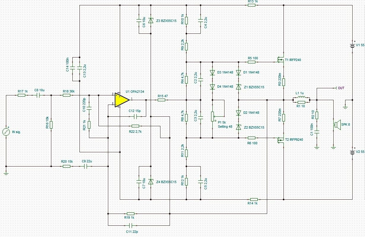

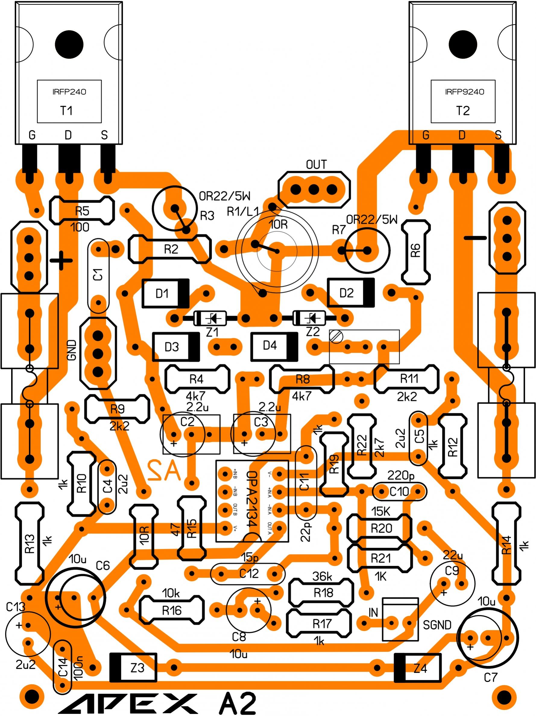

I tried to do a layout for the FET A2. If one or more of you kind folk would look it over and let me know if you see any errors I would appreciate it.
Blessings, Terry
D3 and D4 should be in contact with heatsink.
