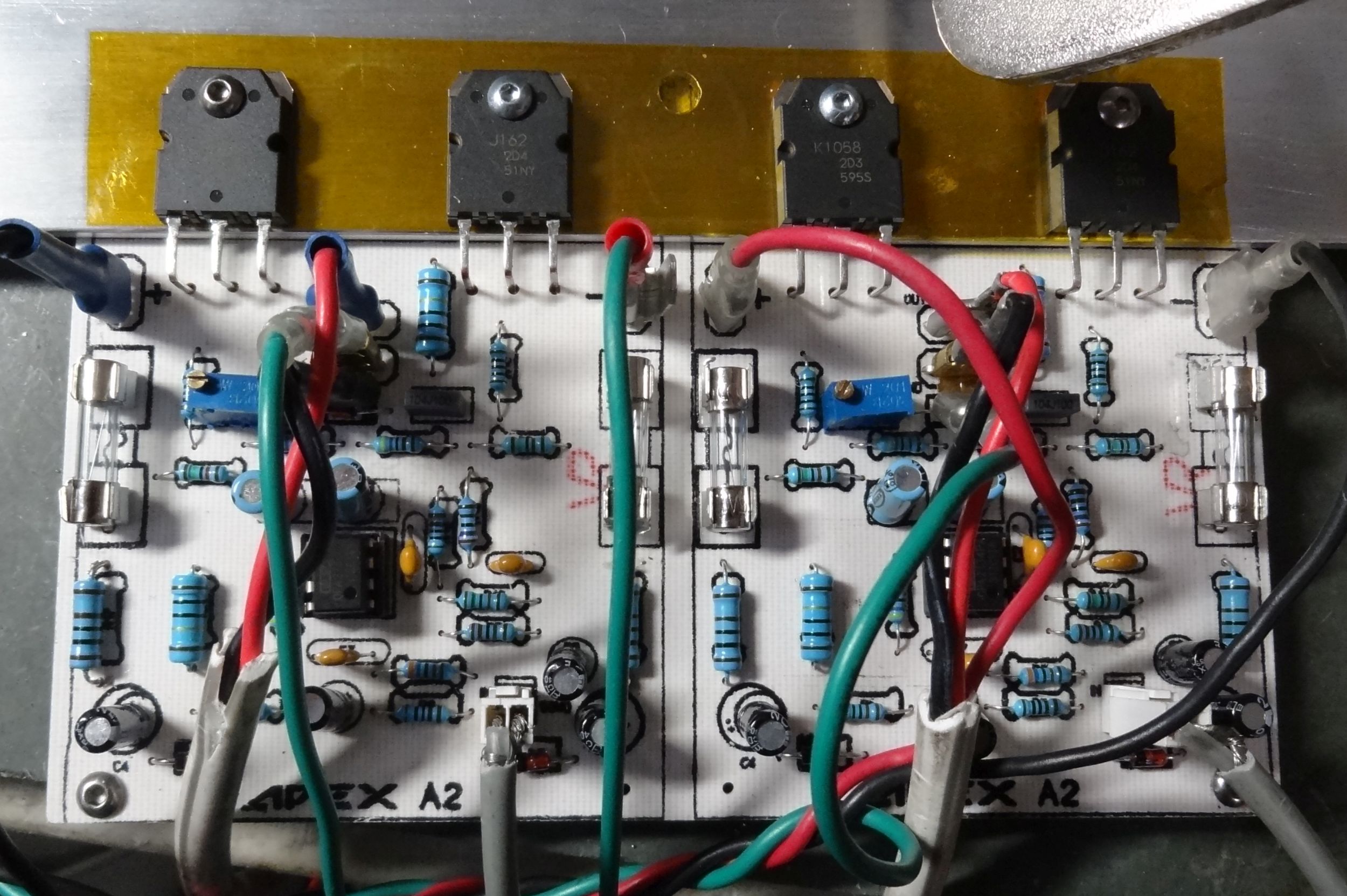

I was hoping I had an error in my layout. The problem is that I have +25v offset. This dumps into the center of the zeners. Now, instead of +-15v at the IC I have something like +25, -4. Seems the zeners need to reference ground rather than the output. Does this make sense?

I wanted to stay with laterals if possible so it wouldn't need thermal compensation.I had this sort of working with the TL071 but not well. I made the new layout so I could try dual opamps because I have a variety of those. It won't help if I can't get it working.
OK I connected a load an that brought the offset down some but I have .800mA draw on the + rail and 13mA on the - rail so something is still not right. I am using a lightbulb so I can't get the rails up high enough for the zeners to fully turn on but I have +8V on the output of the IC so the SK1058 is on hard. Both channels are doing the same thing so it must be my layout and I'm just missing something.
I found it issue. I had installed 2R2 instead of 2k2 in R15. Now with the correct value the offset is gone. The amp works but will need some changes in the compensation somewhere because the 10khz square waves are almost pointed. I'll post up some pictures soon and maybe Mile can make some recommendations. One other thing of note is that the amp draws a lot of current once a signal is introduced. I have the bias set at 70mA per rail and for only 7vac output the current raises to 450mA.

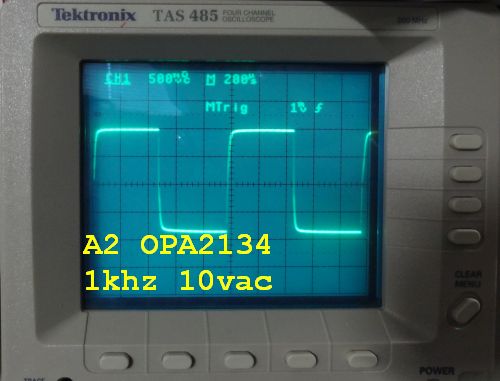

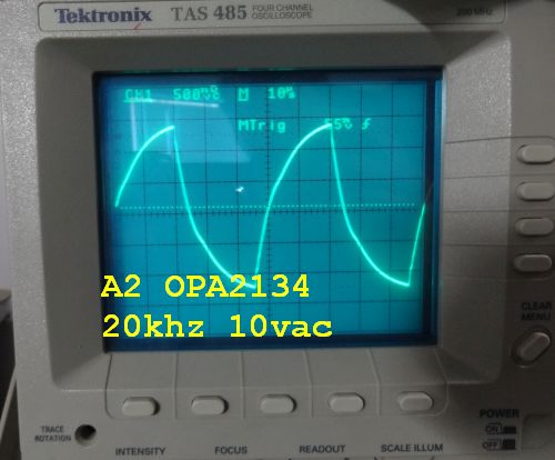

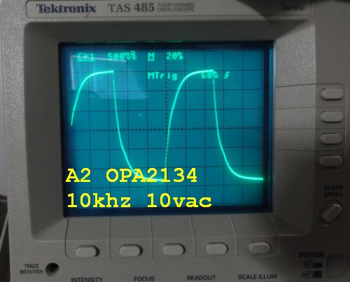

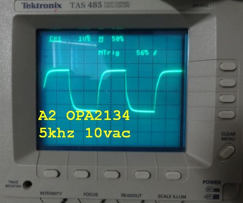

I have been listening to it for about a half hour. Sounds fine. Gain is a little low but would be fine with a preamp. Here are some scope shots.

Is it an input filter causing this HF roll-off?
I don't know. I have the values installed that are in the schematic I posted with my layout above.
