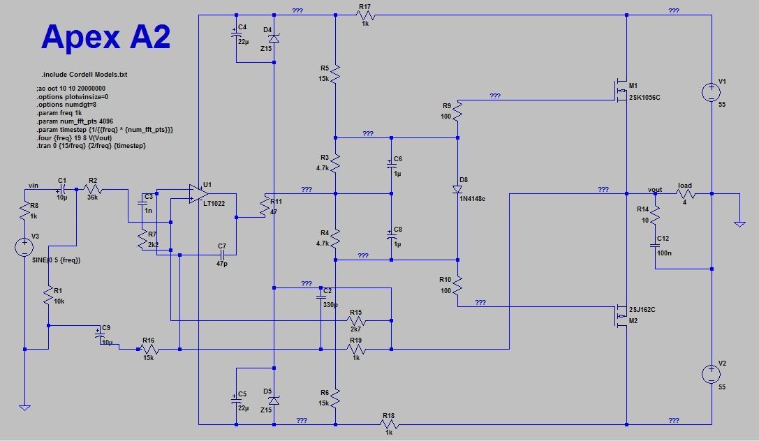

Hi bimo can you simulate AX30?
Regards
Sonal Kunal
I suggest to play with A2 simulation.
I will play with A2 but I am working on AX30 layout that why I asked bimo to simulate AX30.
That looks promising, the only backwards is to find sutable modell for the opamp..
Sajti
OK, I revised it.

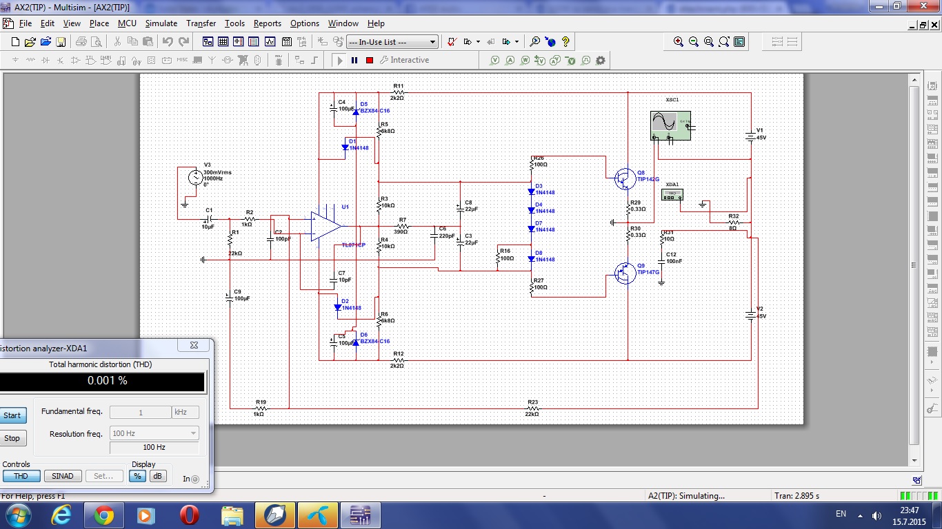

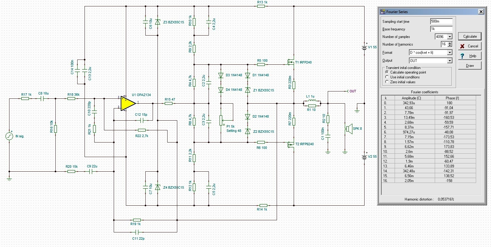

I'd like to ask, what is the purpose of BAV21 (D1) across the mirrors? Is the circuit a Blameless topology using Twin Pole compensation?
BAV21 for clamping, so there is no 'sticky' clipping. Please see Still4given measurement. In simulation, 1N4148 give slightly lower THD, but BAV21 have better harmonic profile.
This amplifier use Transitional Miller Compensation (TMC). You can read this compensation somewhere in this forum.
Q1 and Q5 should thermally couple, Q2 and Q4 too.
Q8 and Q9 is safe without heatsink, but add a small heatsink is cool
The bias current is about 110mA.
Part type recommendation:
C2, C6 and C7 is ceramic NP0/COG or silver mica.
C1 and C8 is MKP.
The 1/4watt and 1/2watt resistor is metal film, but choose high quality for R13 and R15.
R32 and R33 is low inductance type.
The reason I asked Is because I have simulated a Blameless type circuit and I also added a BAV21 diode but placed it across the buffer and VAS trannie which was supposed to also prevent "rail sticking" at near clipping level. Your implementation looks interesting, I may have to sim it in my work

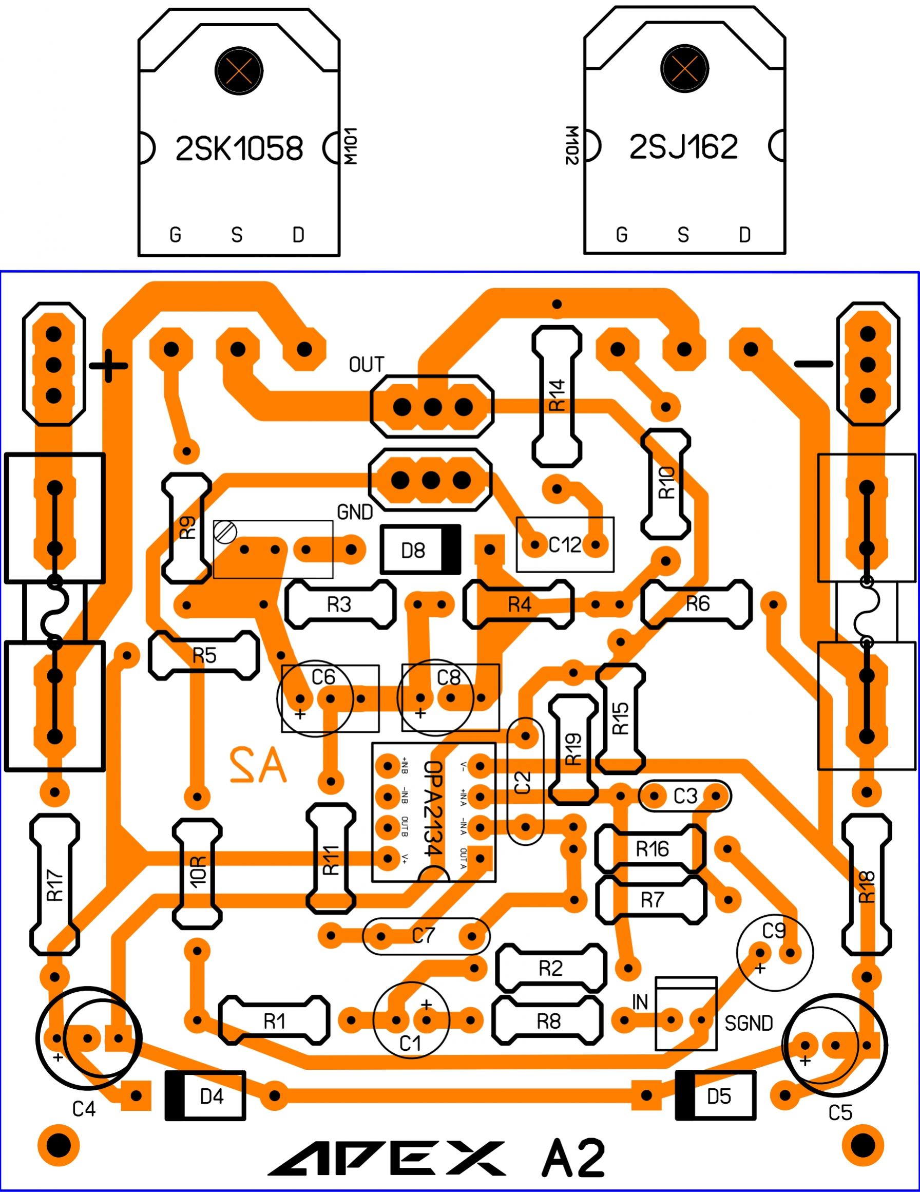

Hi guys,
I etched a new pair of boards today for the A2 using the OPS2134 for the IC and Laterals for the outputs. I'm having issues with a huge offset so I'm thinking I did something wrong with the layout but I have been pouring over it all day but just can't find it. Hopefully one of you eagle eyes can look it over and see where the error is.
Thanks, Terry
Thanks, Terry
Hi guys,
Thanks, Terry
Hello Terry,
which schematic are u using? I was looking at one given by apex in #5721, which I hope is "New and Improved".
reg

AX2 use grounded output topology not A2.

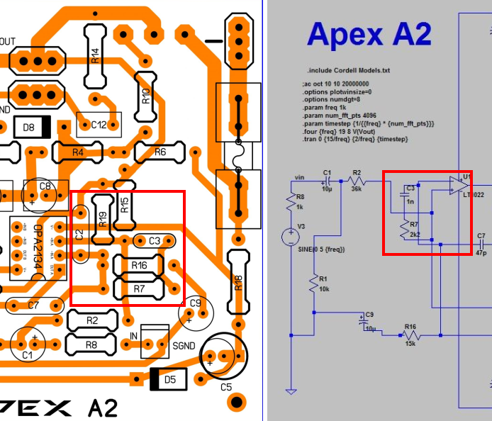

Hello still4given!
I have not watched any but C3 should not be connected with R2.
Regard's!
It is not wrong, C3 and R2 is in series connection order is not mater.
