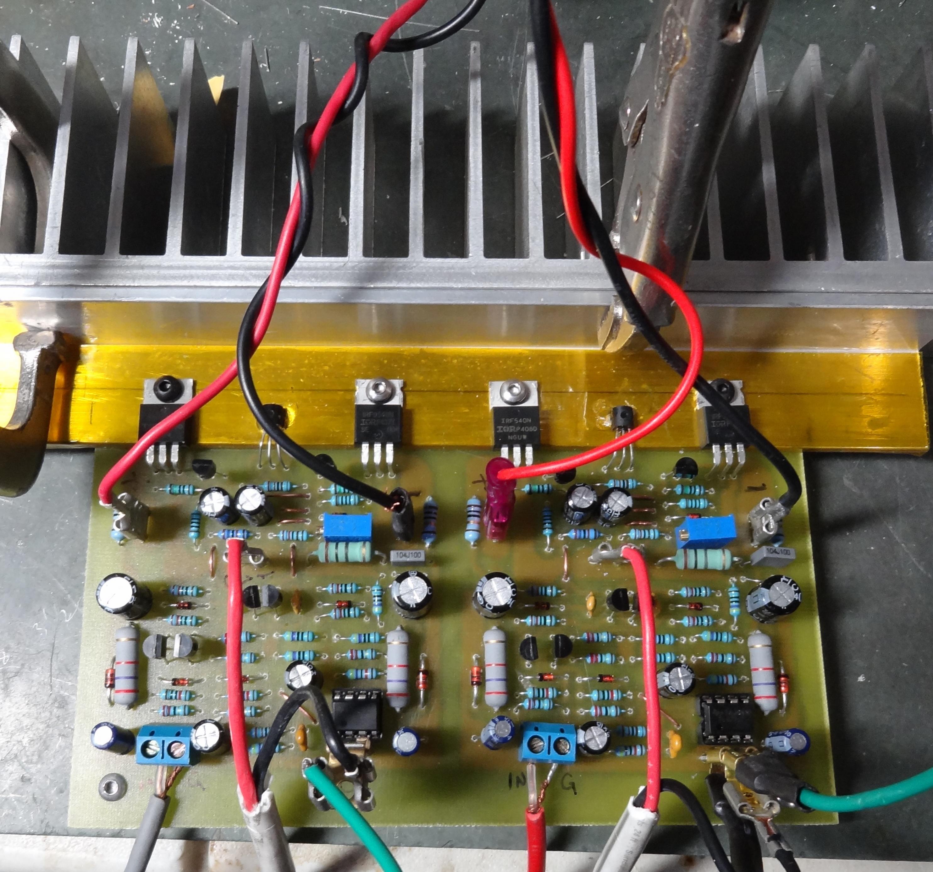

Thanks for comments , new and better pic's of A23 and A33 amplifiers .....
Regards ,Alex
just when a man thinks that it could not be much better - you show up and post some new pictures!
great job!

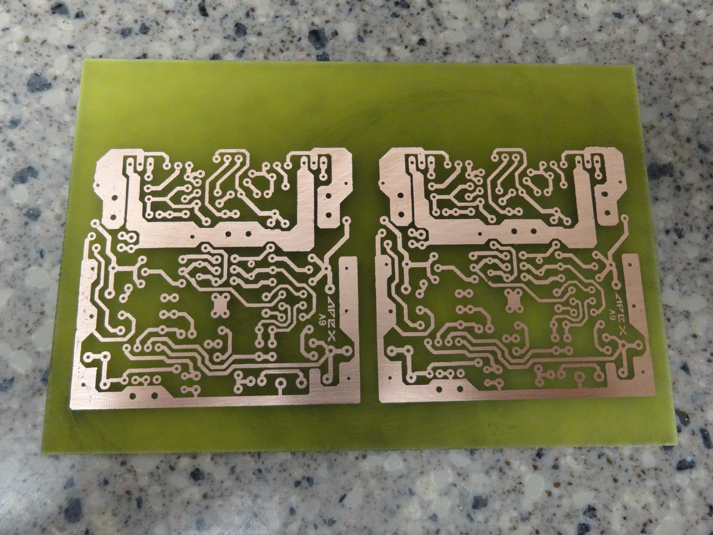

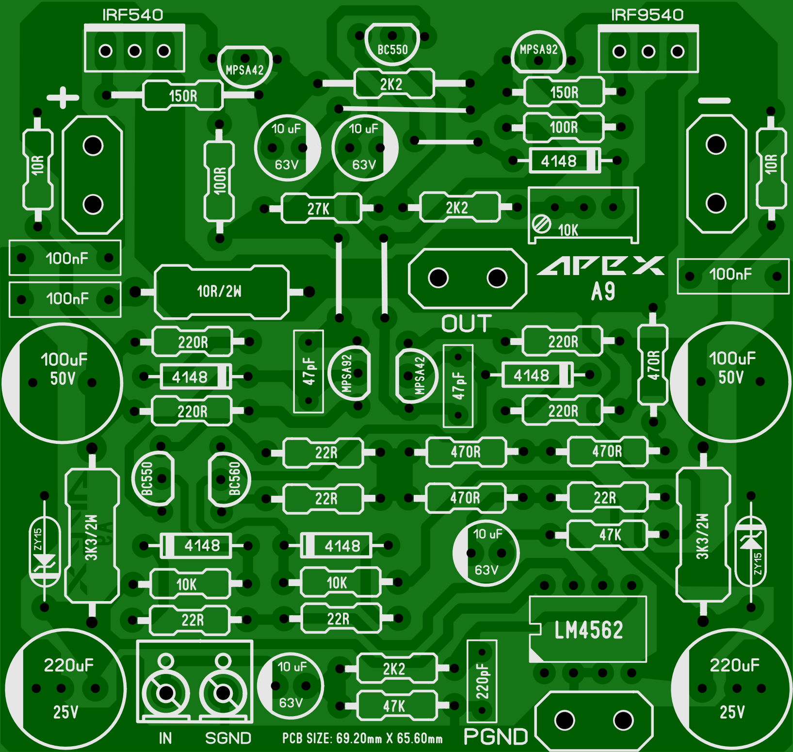

I just etched some new A9 boards from this post. I realize there was a newer layout made but no foil was posted so I used this one. I'm cool without the 100n caps on the rails. I built the other A9 boards but I'm not crazy about the shape of them. I had them working but I shorted a couple pins and never could get the one channel working again so I am going to build them again on these boards. The one channel that is playing sounds good so I am looking forward to having a working pair.

Sorry i forgot to post PDF files of layout after i posted Sprint Layout file.

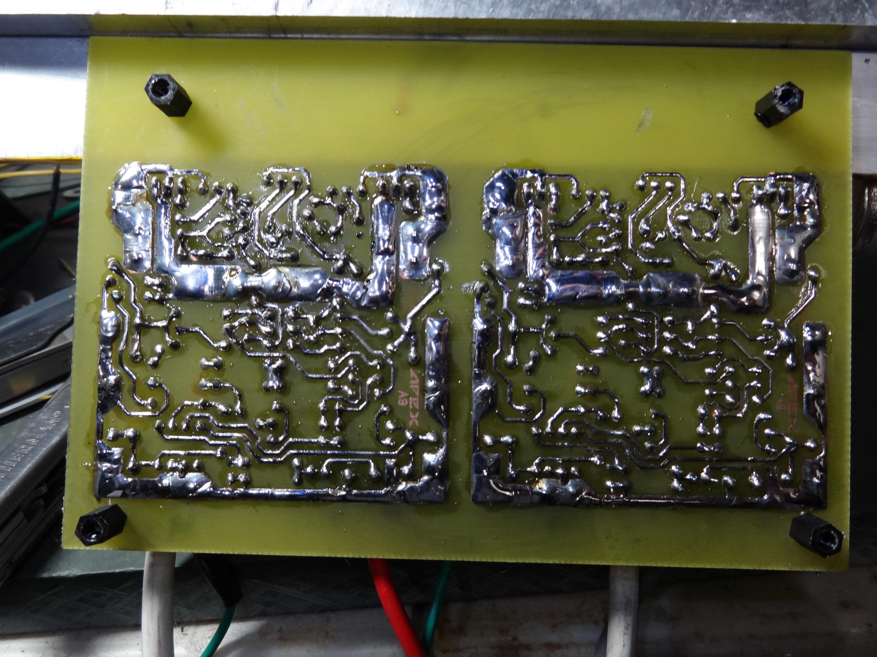

I notice the copper tracks are all loaded with plenty of lead. I've seen this before on some older commercial equipment.
Eventually there was a discussion on the effectiveness of using lead to thicken copper traces. The conclusion was that it wasn't worth it. Lead has only 7% the conductivity of copper. So with reasonably wide traces there would be no need to cover them with lead.
But if one feels comfortable about it , it shouldn't matter I guess.
If one really wants to have higher conductivity for high current tracks, a better method might be to solder a thick copper wire to the full length of the track ! I have seen that on some boards.
some people do it to prevent surface corrosion of copper and that sometimes even looks very nice. stillforgiven does it a bit more than it should,but that is the way he likes it so...

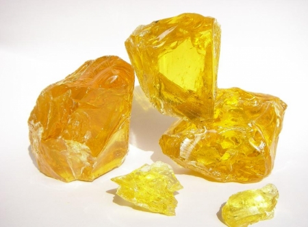

Rosin
Its called Rosin. Has many uses....Also used by violinists/Cellists, gymnasts, weightlifters.....

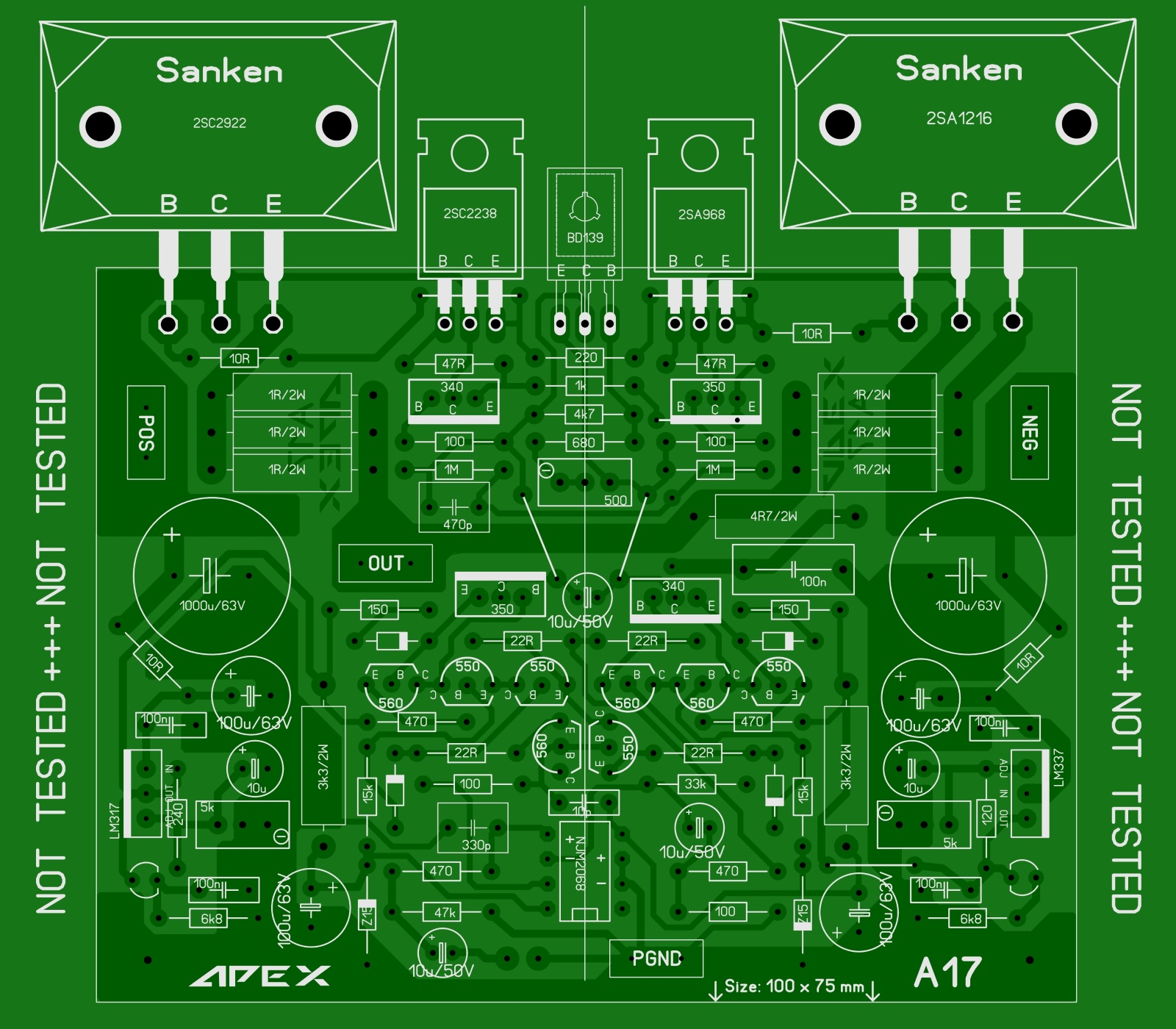

A17++

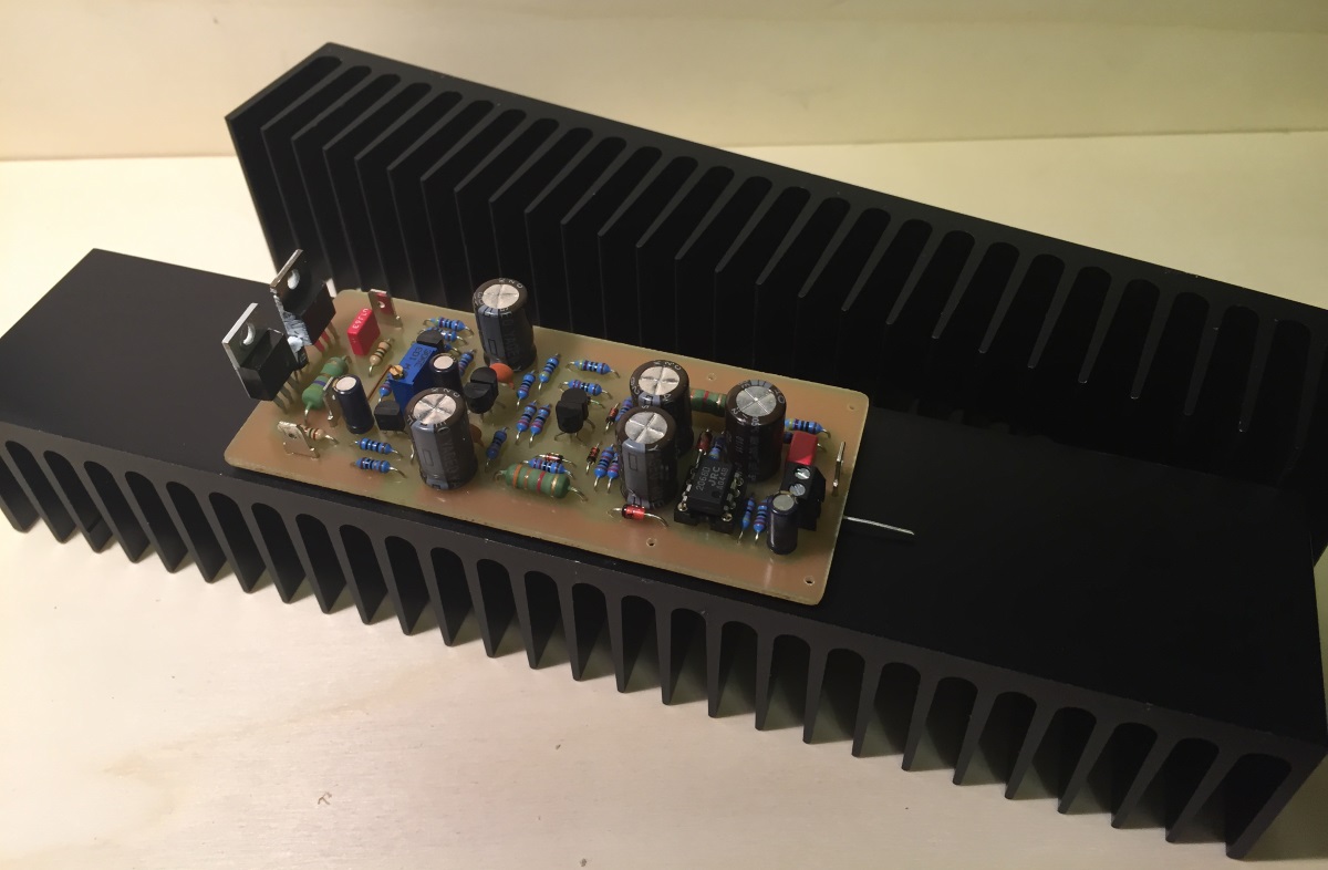

I listened a bit longer to the A17. It entered into the background here at the many new amplifiers. Meanwhile, I am of the opinion that it plays a bit lighter and more easier as the A33. Therefore, I made a PCB for the "big transistors" because I have a few pairs.
Because there was room on the PCB, I have added voltage regulators for the input and VAS. I do not know if I really integrate it so. Does anyone have a idea whether the circuit brings something?
regards Olaf
regards Olaf
I listened a bit longer to the A17. It entered into the background here at the many new amplifiers. Meanwhile, I am of the opinion that it plays a bit lighter and more easier as the A33. Therefore, I made a PCB for the "big transistors" because I have a few couples.
regards Olaf

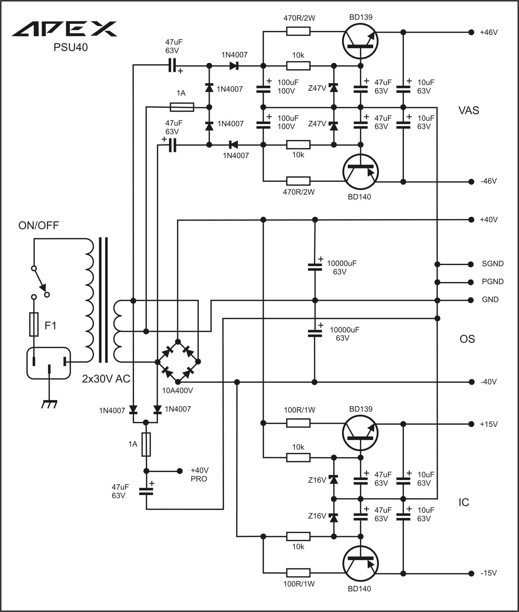

Use this PSU.
Regards

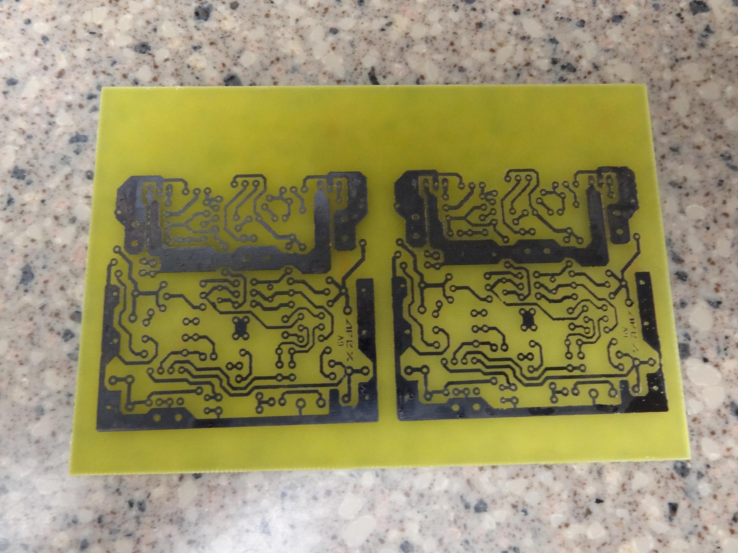

I was taught to tin all the traces when i built my first amp, an Elliot P101. I've been doing it ever since. It doesn't look as nice but I believe it helps insure connectivity and current carrying ability. The solder is not as thick as it appears in the picture. The yellow tape is Kapton tape. Recommended to me by Elliot when I built the P101. I bought a roll and have used it on every amp I've built. It is very thin and very tough.

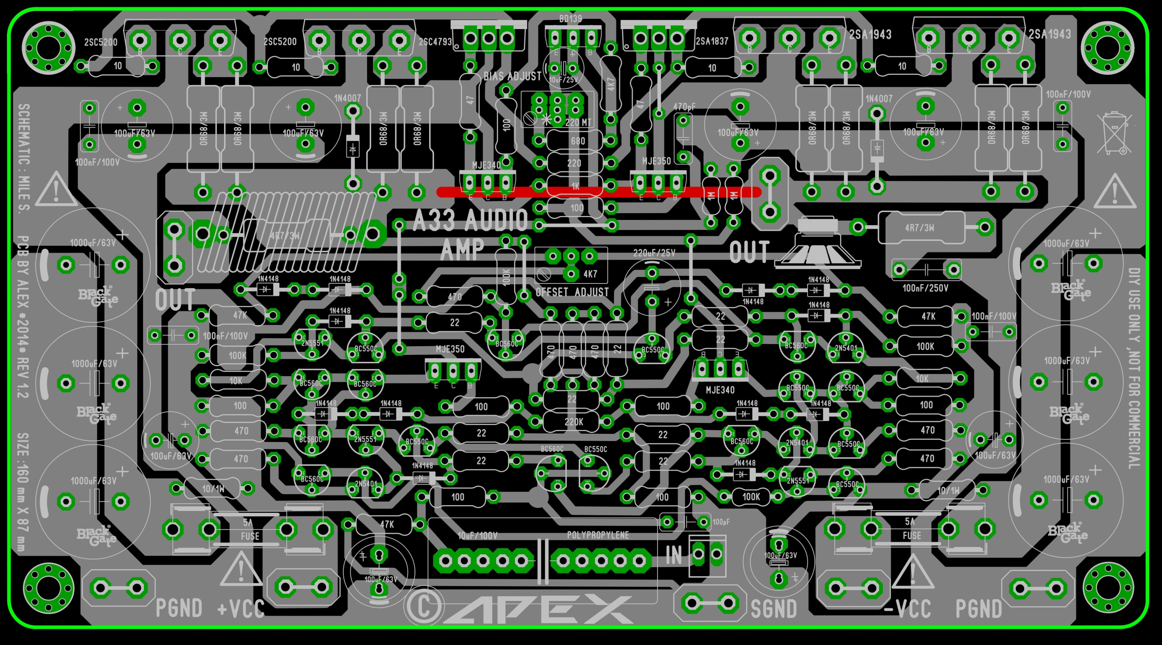

A33 pcb tested OK
A33 it's playing now .....
https://www.youtube.com/watch?v=SY3G4ZfwabA
I't was , one error which was corrected (forgot 100K resistor ) . Real tested PCB
attached below
,more comments tomorrow .
Regards ,Alex
attached below
Regards ,Alex
