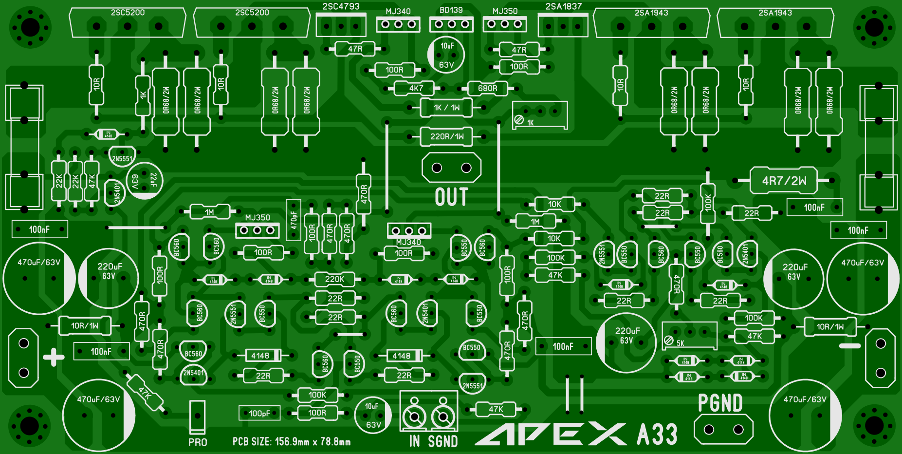

Zenner resistors changed to 1K1/2W ,also IC from LME49713 to TL071 and resistor from bias pot from 680 ohm to 750 ohm .With this values , offset it's only 0.5 mV , current through OT set to 65 mA /device and magic sound can be hear from my speaker . For testing purpose rail voltage +/-36V . I think I will build also A33 amplifier . 😀
Regards,Alex

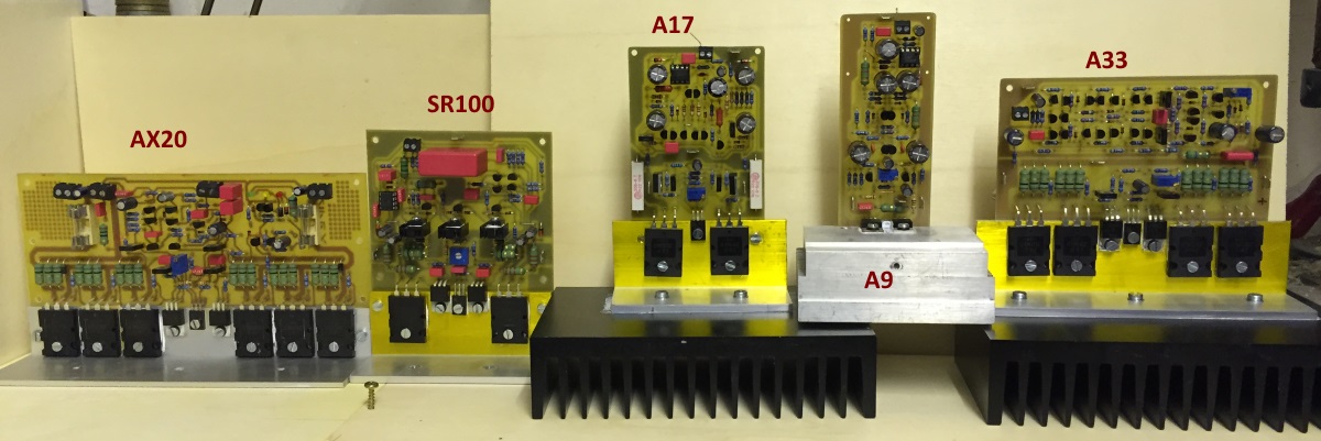

Apex gallery 2014
Just for fun - update of the actual gallery for 2014 (AX20 built in 2013) 🙂
regards Olaf

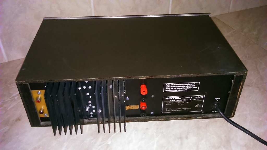

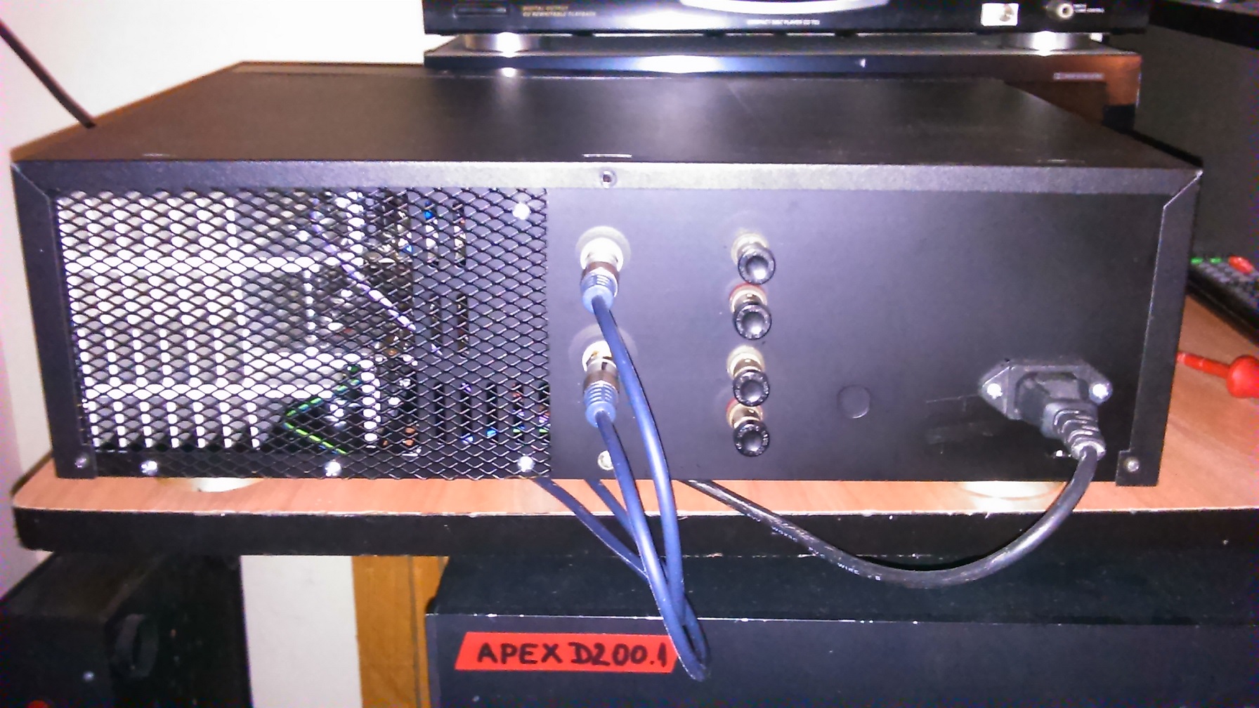

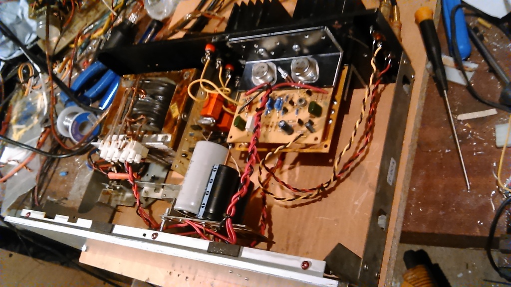

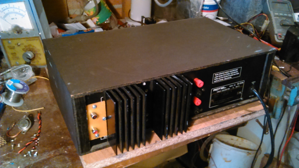

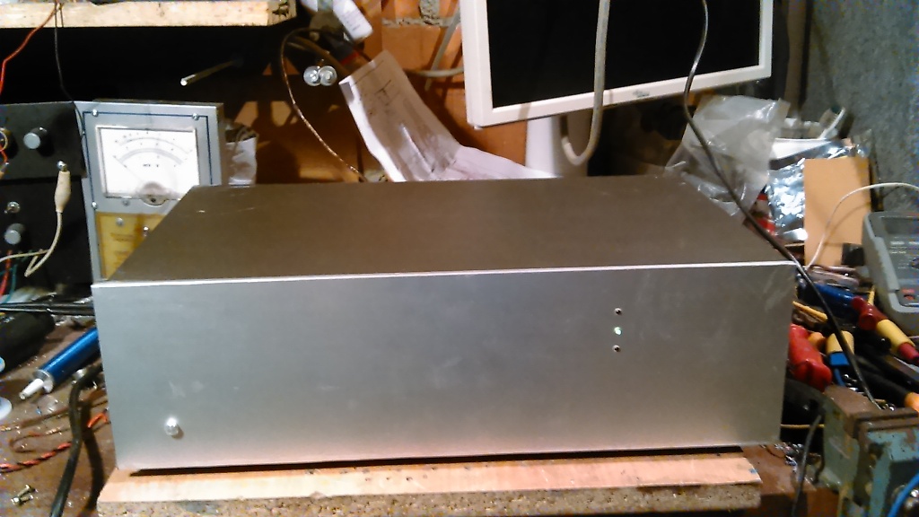

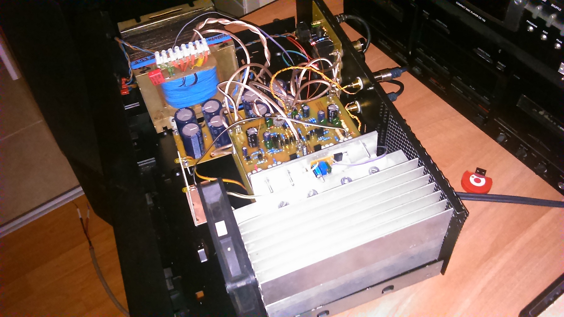

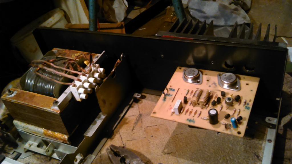

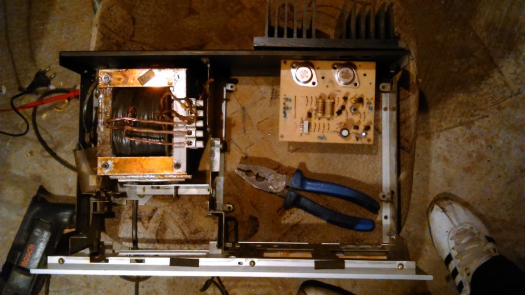

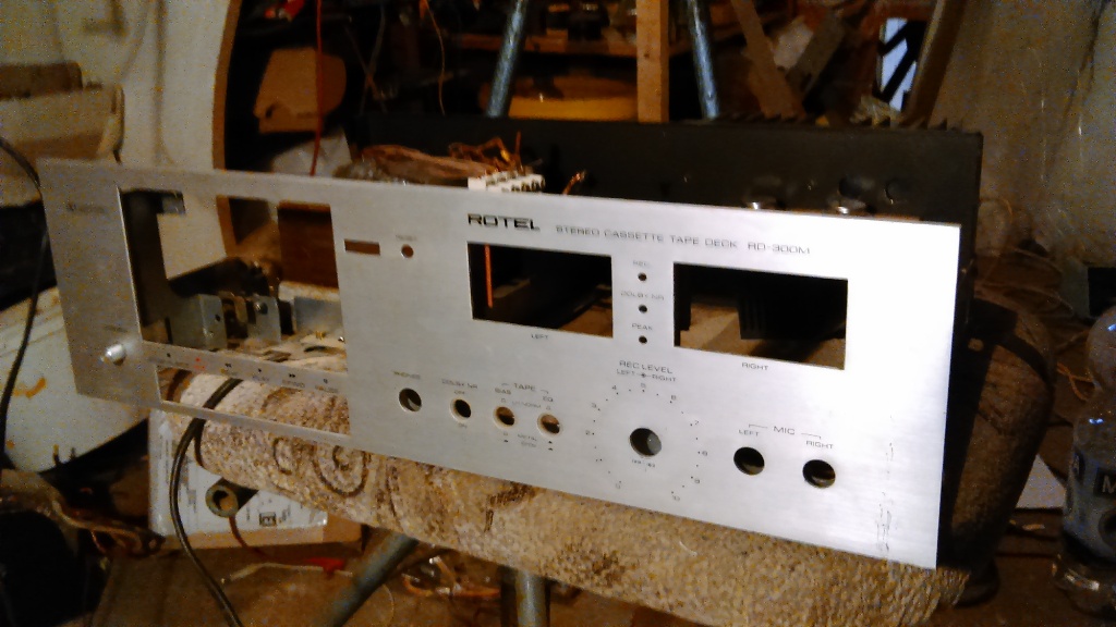

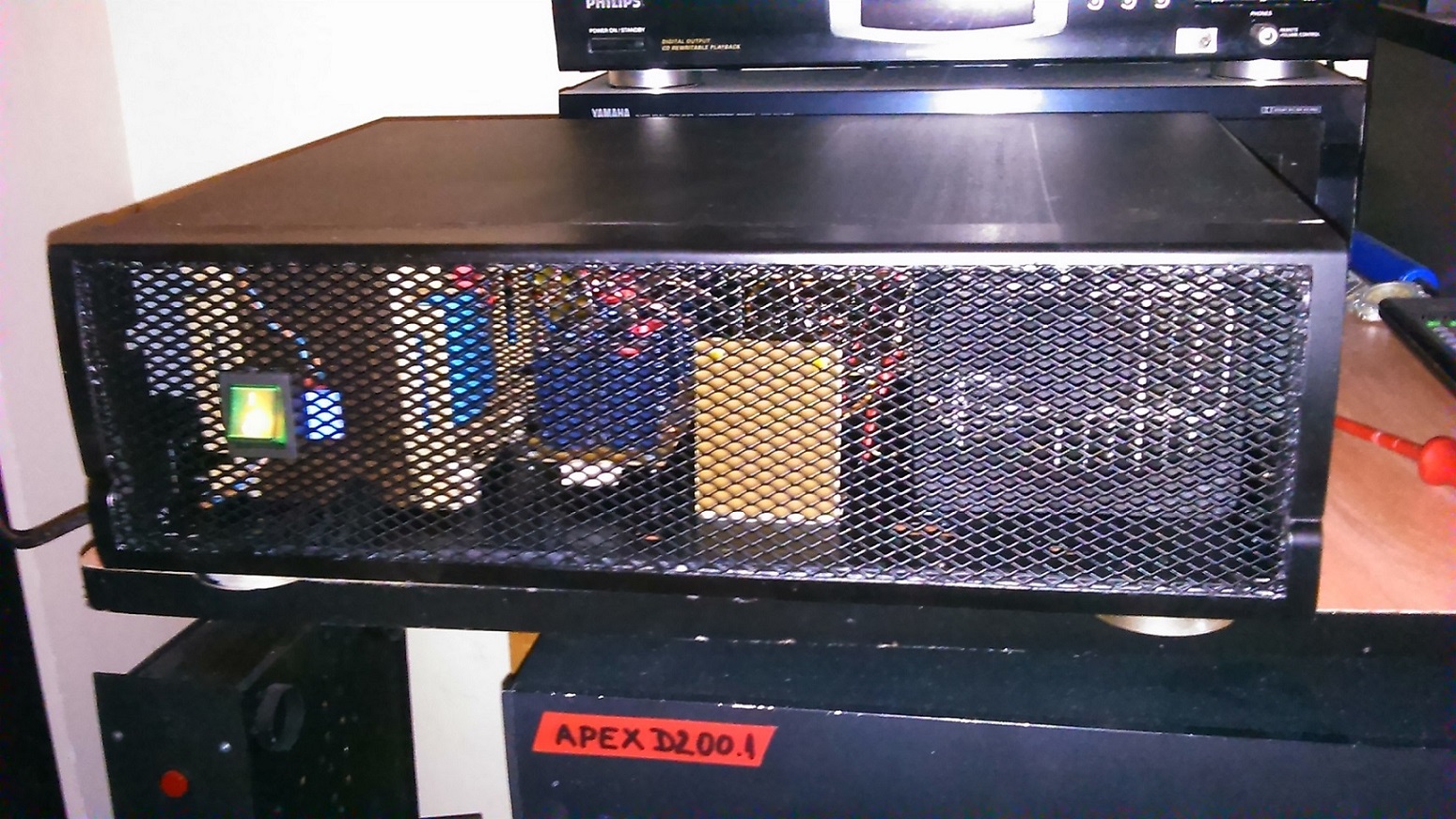

i mostly use old and cheap cassete-deck inclosures,that way i get almost the whole box - i only need to do front and rear side wich is a lot easier than to do it all:

"best buy" are the one made in mid 80´s and early 90´s,cheap but still well made,strong and heavy enough to carry larg transformer and heatsinks... that is how i made APEX A23 to...
they will not win AMP-Olympics,but they look good enough for me - and the best of all i know what is inside 🙂

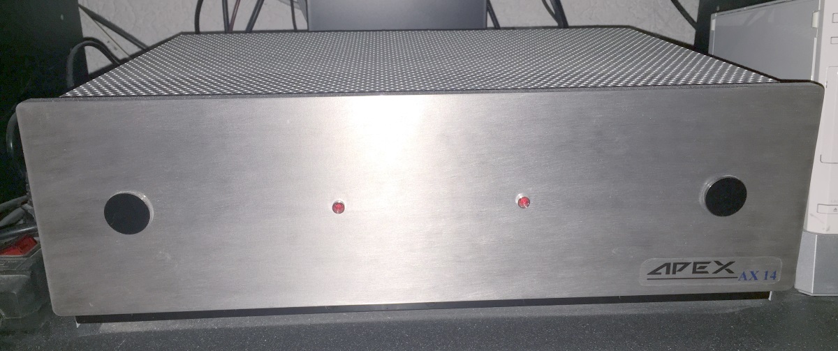

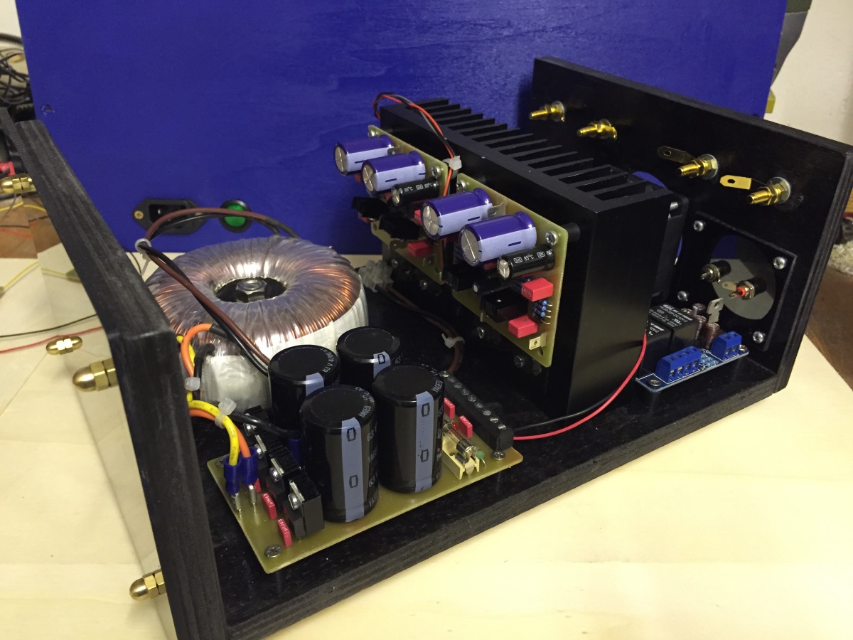

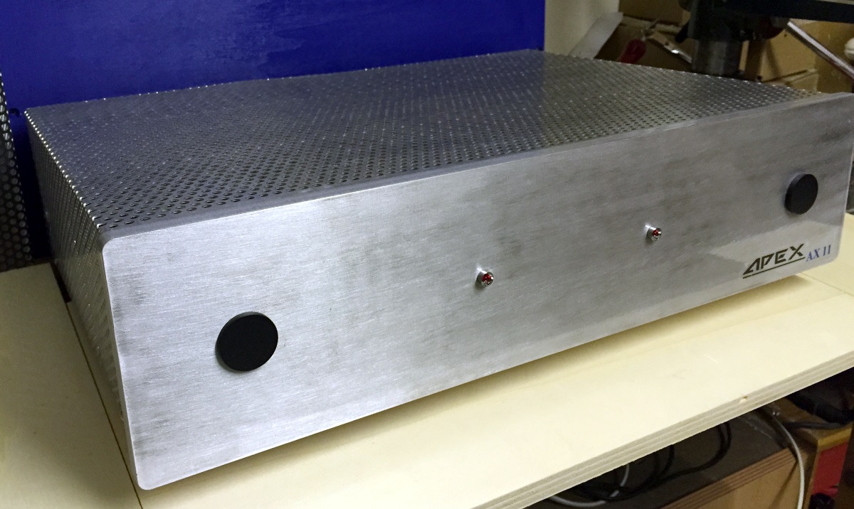

This looks very good. At least you have housing, not as I do 🙂.
But a few I've also built. I use plywood and perforated sheet of aluminum. If I have, then, a right front panel made of aluminum or last trial of Plexiglas.
Because I need a long time for that, I have a lot more amps than housing 😀
regards Olaf

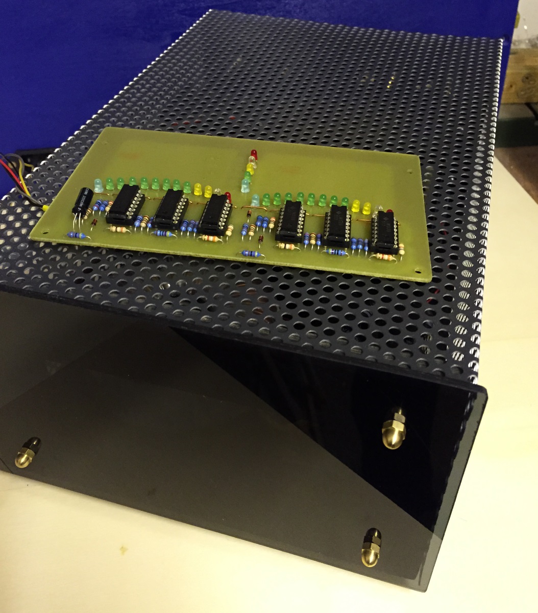

edit: VU should mounted behind the Plexi. It is Apex-VU from 1000W-Thread.

it will be all right when you do a few enclosures "in a roll",you wil see that you´re doing them fine and than you will get even maybe to like that part od DIY - that is how it was with me. i believe that you will find your way/path to do it easy,fast enough and to be satified how it looks.
i like the way you did AX14,specially top of the inclosure - perforated Al all arround means a lot of air to cool things inside 🙂
the thing with VU meter behind darkened plexy also promises,it is almost erotical - in it´s own way : you can see it,but not quite all of it... 🙂
i can´t see anything but a lot of pleasure for you in a near next future... see it and take it as a fun - and than you will have a fun! 🙂
