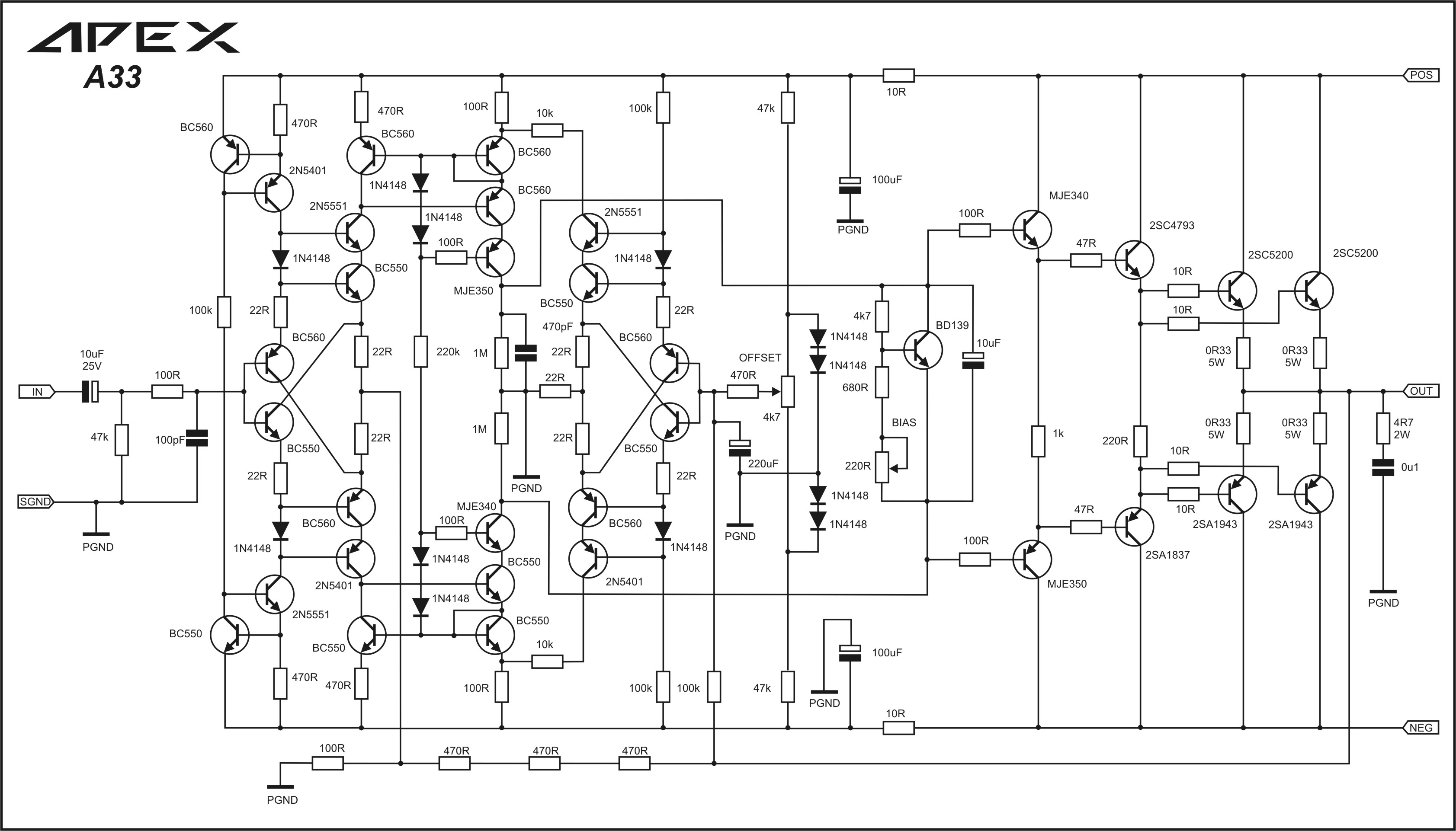

As what was posted from the very beginning, the OT stated 120W into 4 ohm load. I noticed the 2SC5200 swamping resistors are 0.33 ohm 5W, lets get into math.
Lets determine the output current with 120W output power and 4 ohm load.
P = (I^2)*(R) so,
I = sqrt(120/4) = 5.47A
Now lets get the resistor's dissipated power using same formula.
P = (I^2)*(R) = (5.47*5.47)*(0.33) = 9.9W
A staggering 9.9W!
I design amplifiers so they do not blow up whenever cases except user's stupidity so that is why I asked. Why was it rated for just 5W? I beg for answers. 🙂
Ken
The emitter resistor operates at a duty cycle of 100% for the continuous bias current.
At maximum power the duty cycle has reduced to 50%
Therefore the average dissipated power is 50% of the calculated value using the output current as the basis.
That resistor will heat up rapidly during maximum power testing and even more during SQ Wave testing.
During music reproduction where the average output is ~ 1% of the maximum output the resistor will not get warm.

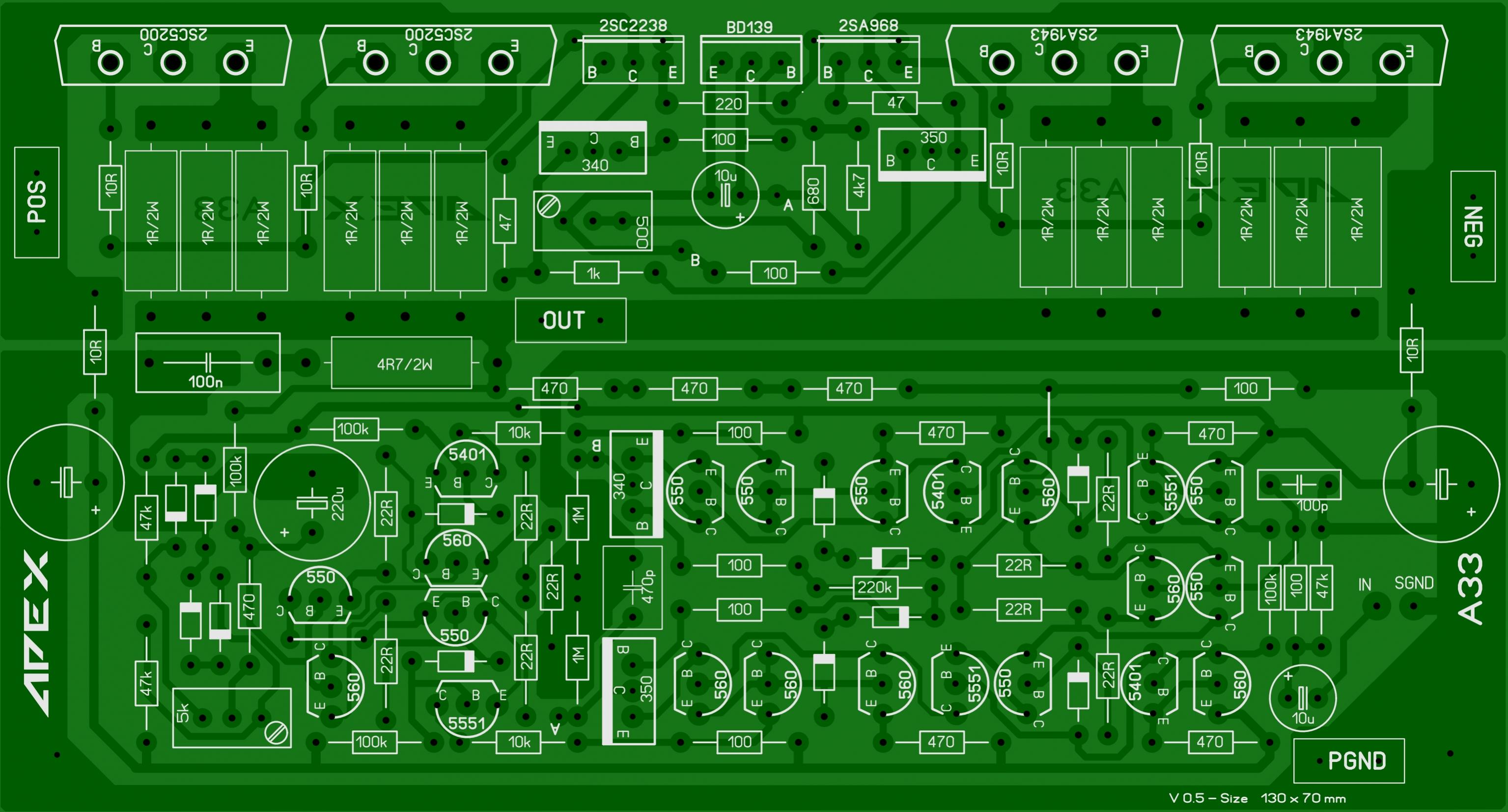

Just finished to layout PCB for A33 amplifier ,all OT in line ,not tested yet 🙂
Olaf ,nice to hear it's working ......😎 Please, tel me ,voltage range for A23 and A33 amplifier ,thanks .
Regards,Alex
Hi Alex, looks great as usual 🙂
Much success in the test. I look forward to your opinion on the sound. I have yet to hear a little.
Max. voltage - please ask Mile. I want to drive the amp with +-50VDC. Will check it next days.
regards Olaf
A33 Layout

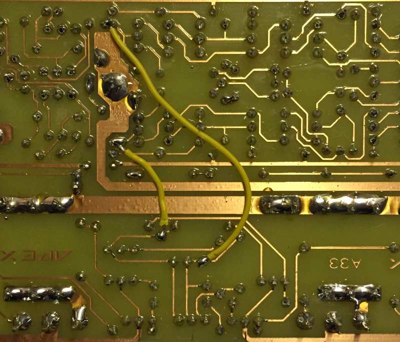

Hi, here are the layout-files for the A33.
Please do not forget the wires between the points marked as A-A, B-B.
Much success and have fun.
regards Olaf
