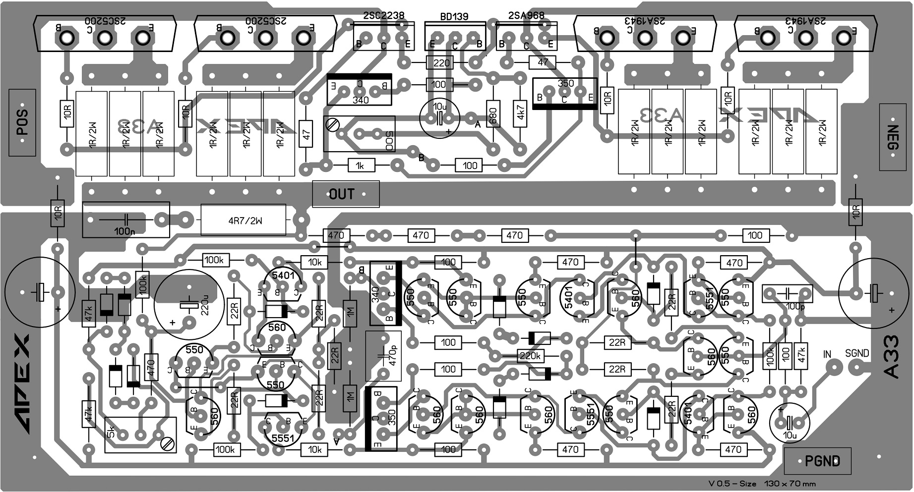

Here, the Sprint-Layout file.
There is much room for improvement.
regards Olaf
Thanks olafk
I think I can reshape this layout a little bit 🙂
can you mark where the jumper wires goes ?
from the top use S2 from Sprint Layout any
color is ok 😀
thank for sharing
Regards
Juan

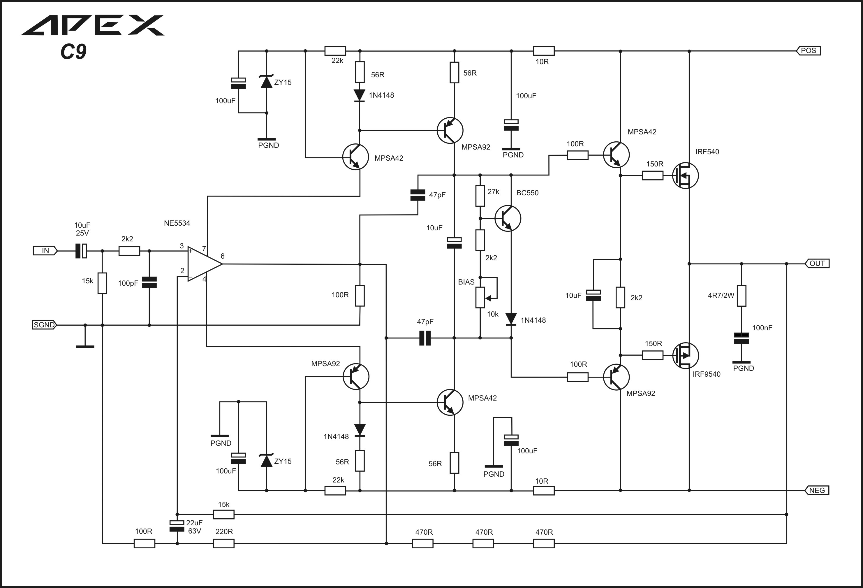

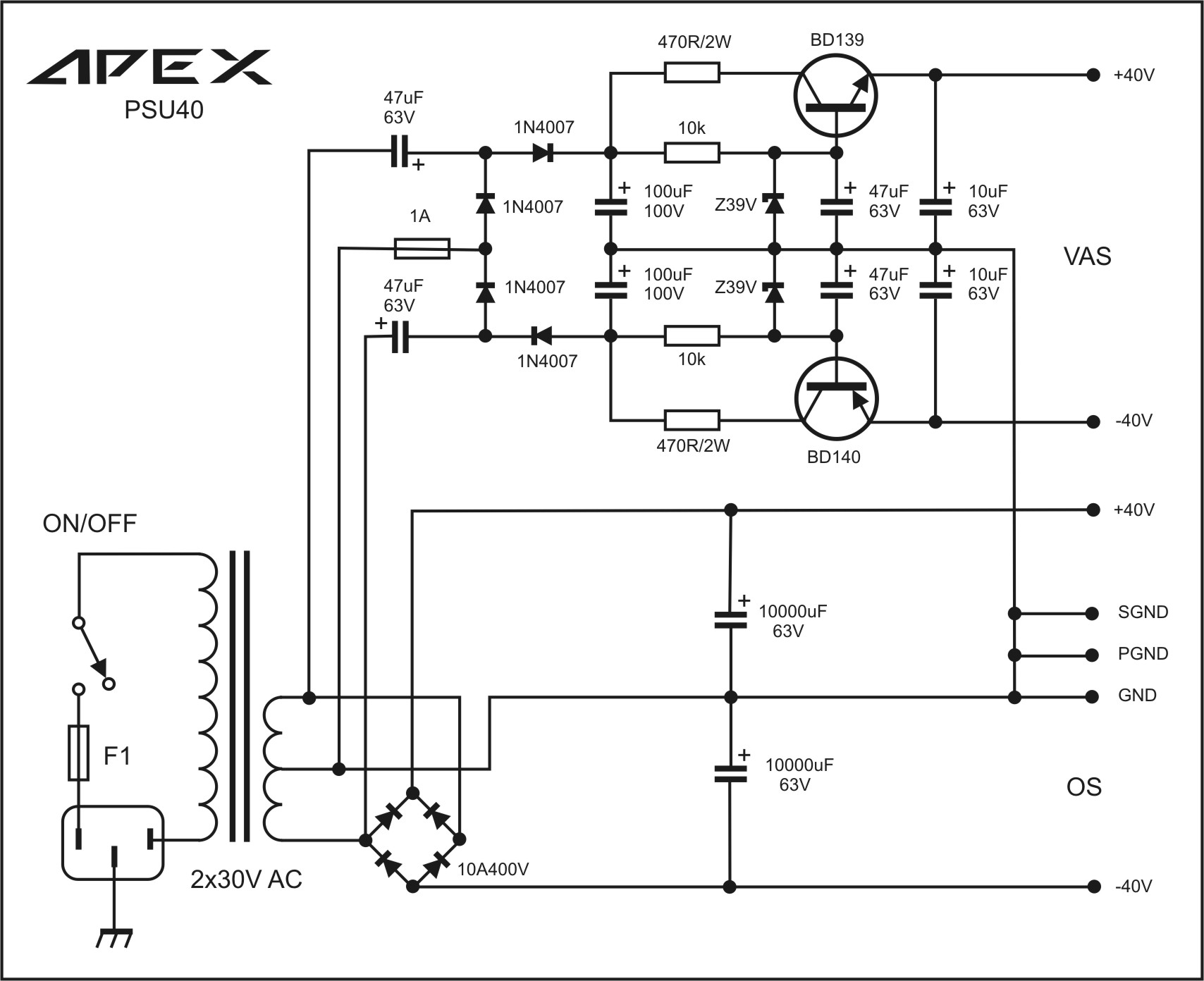

A9 is my favorite I made similar amps AX9 and C9 and PSU40 for them.
Yes, I agree.
Might be a good idea, to design a A9 along with PSU as a compact stereo layout. But it would be nice instead of the BC550 to take another transistor, which one could better fit to the heat sink. The layout should be changed - but should not be a problem. Can you prefer one (MJE340)?
regards Olaf

Hi, here are the layout-files for the A33.
Please do not forget the wires between the points marked as A-A, B-B.
Much success and have fun.
regards Olaf
i was rude enough to copy your work to our local forum (i also aded direct link to your post there),and i sincerely hope that someone near me will build your pcb of A33 so than we could compare A23 with A33.
thank you so much for effort you invested in drawing visually simple PCB,and for testing it. great job for all DIY comunity,greetings for Mile and you Olaf! great job...

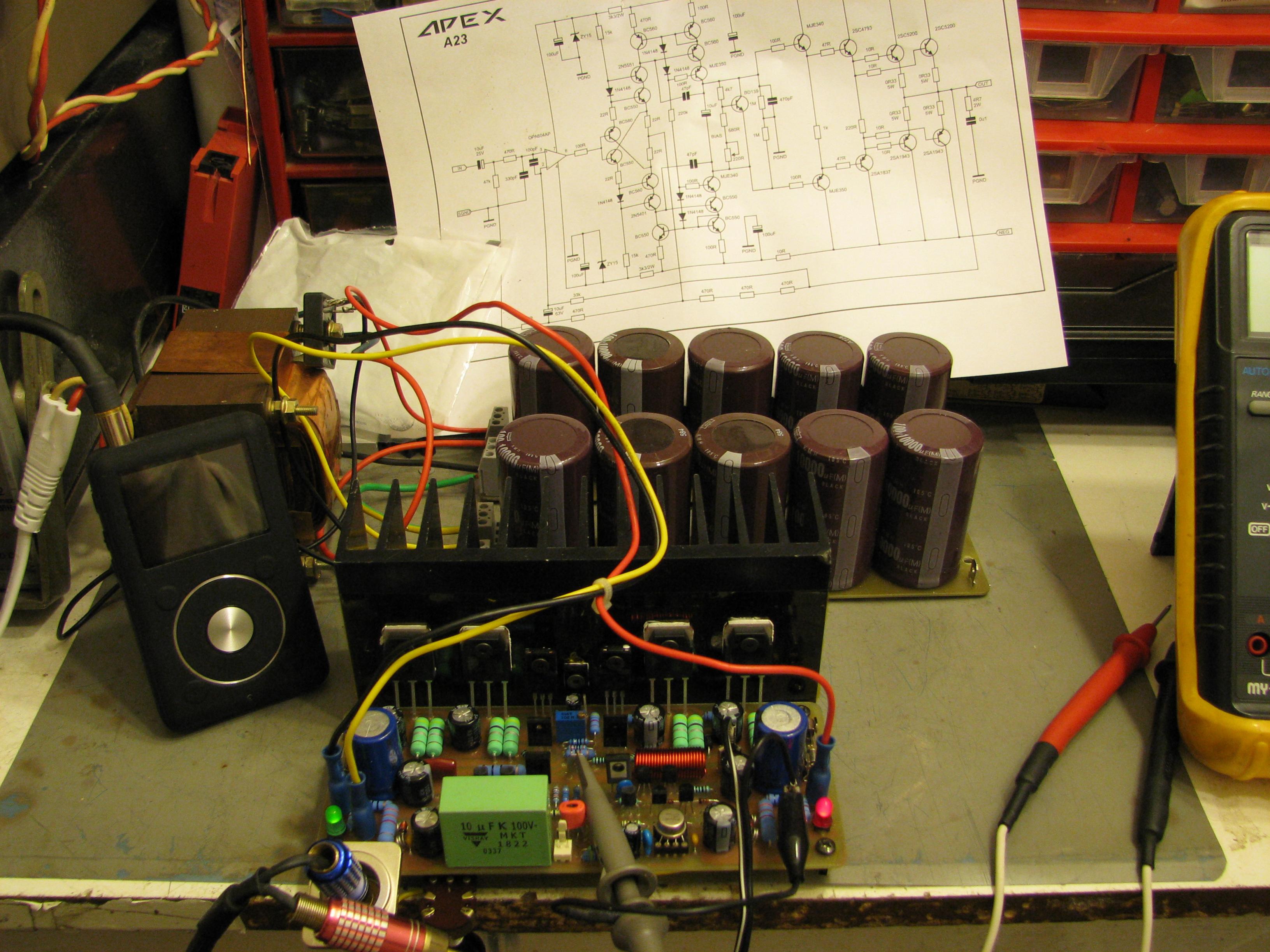

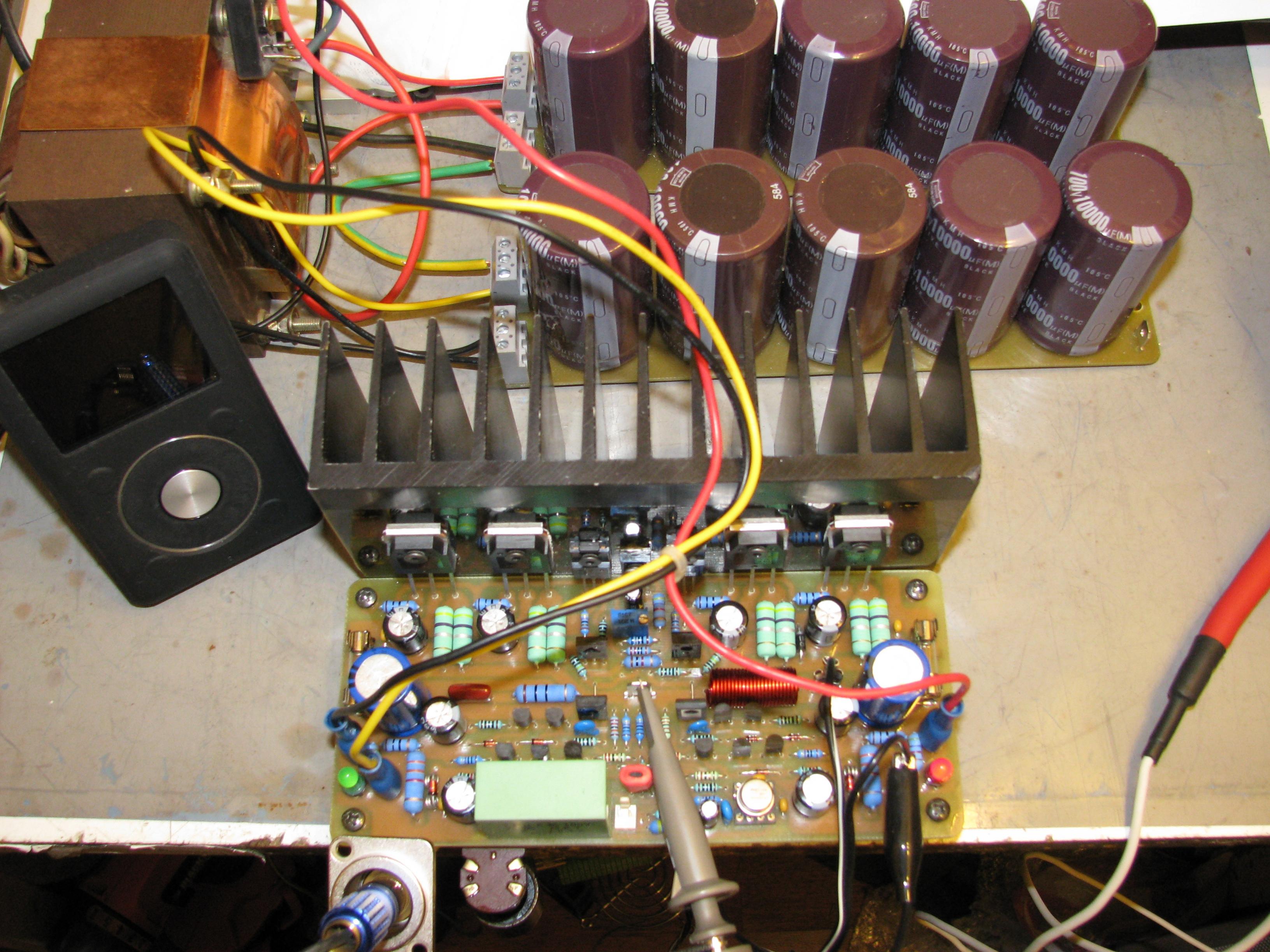

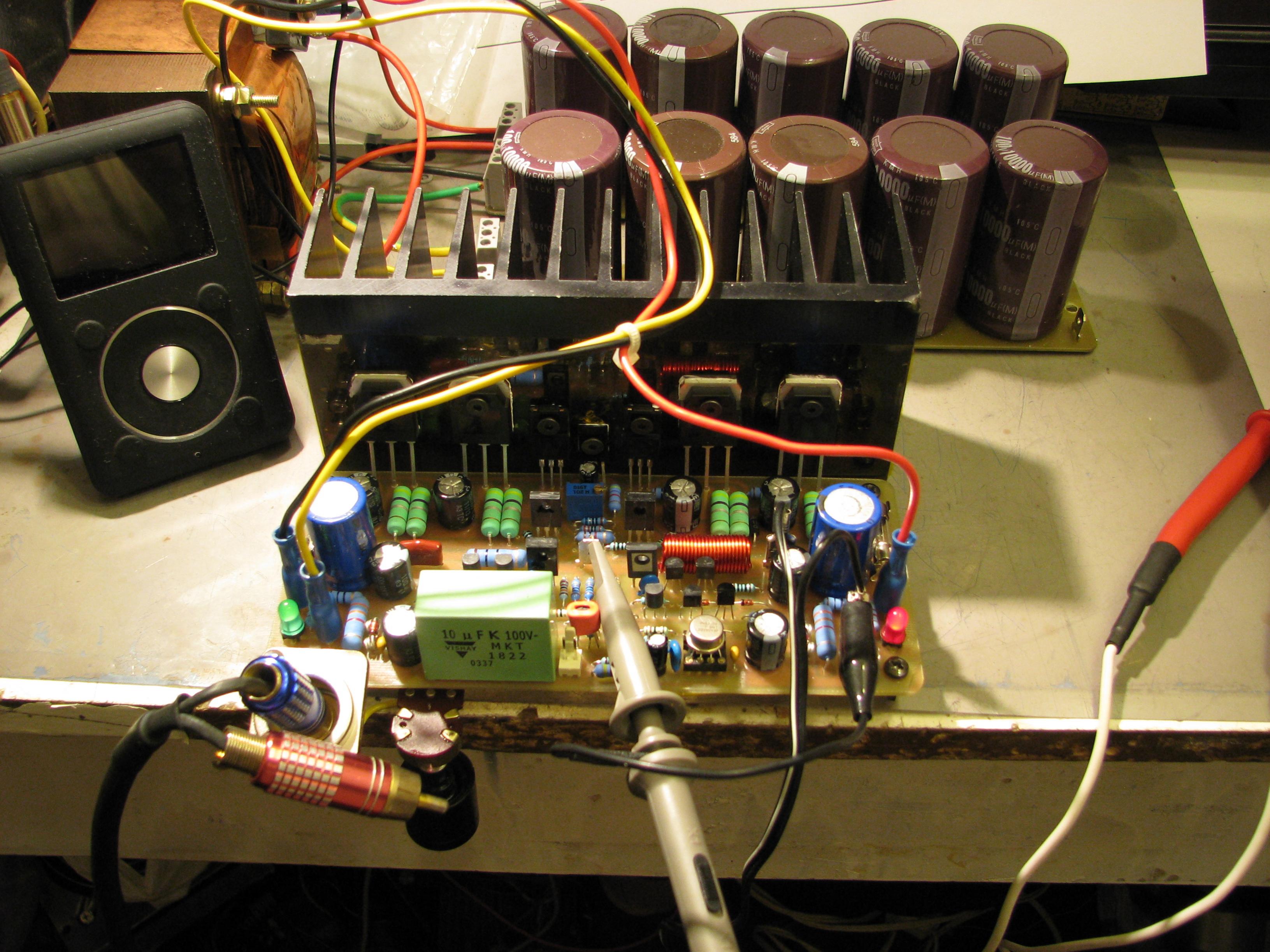

Good news,my A23 amplifier it's playing nice , but it's to late to give volume on input .....😎 Until tomorrow, some pictures . Rail voltage only +/-36V for testing . Offset voltage after 45 min, +27 mV
Regards ,Alex
