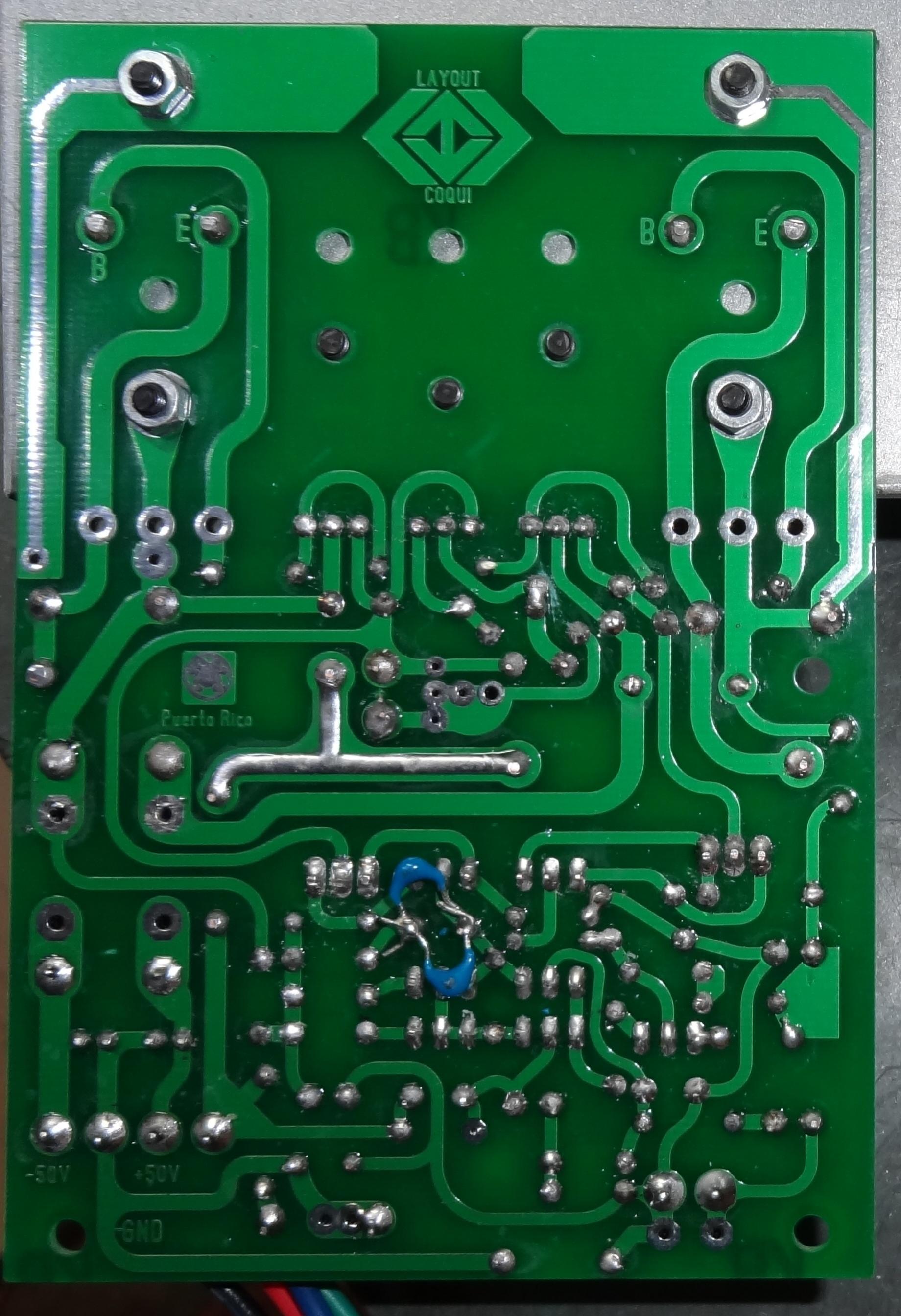

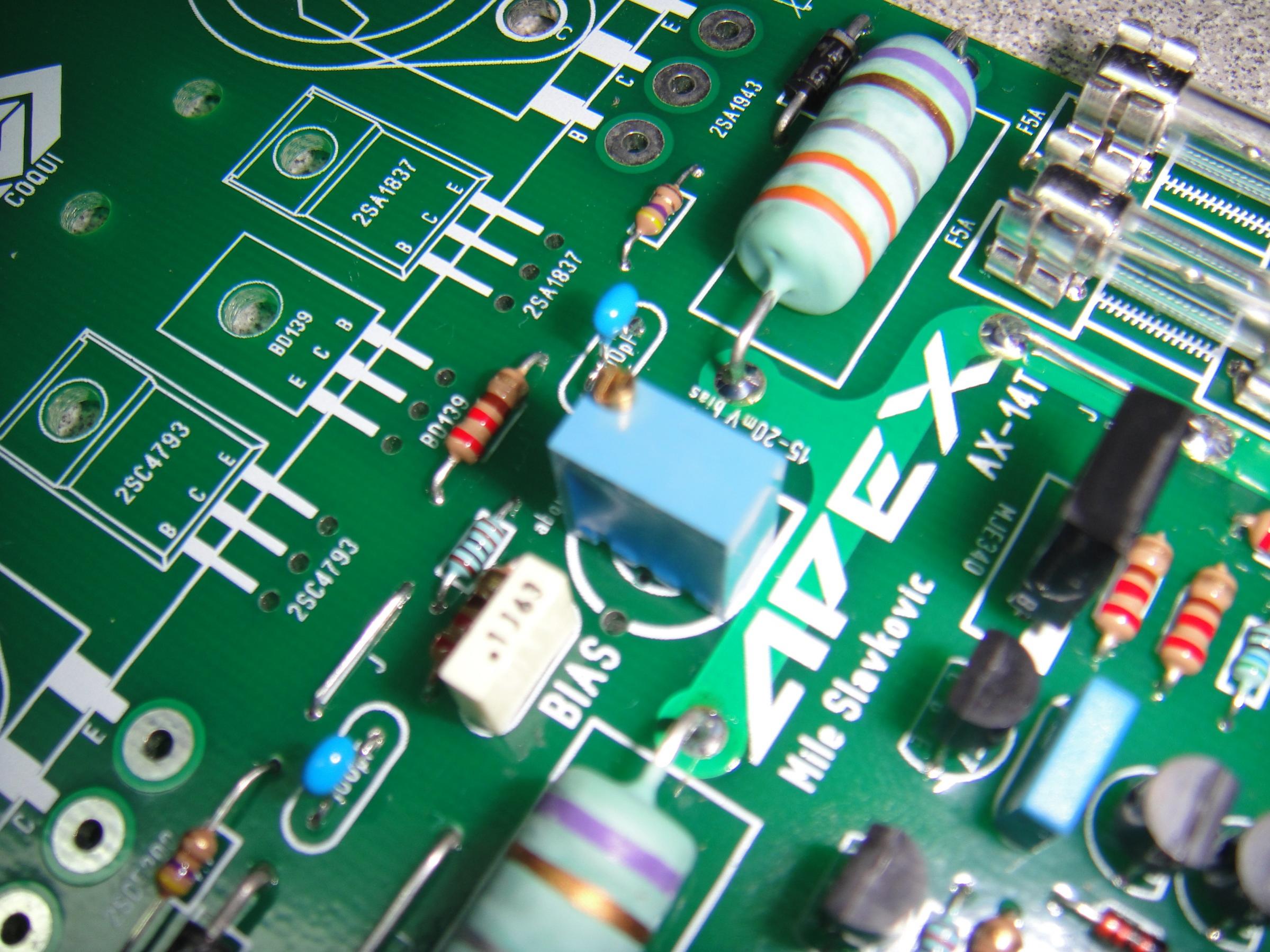

100W Ultimate Fidelity Amplifier

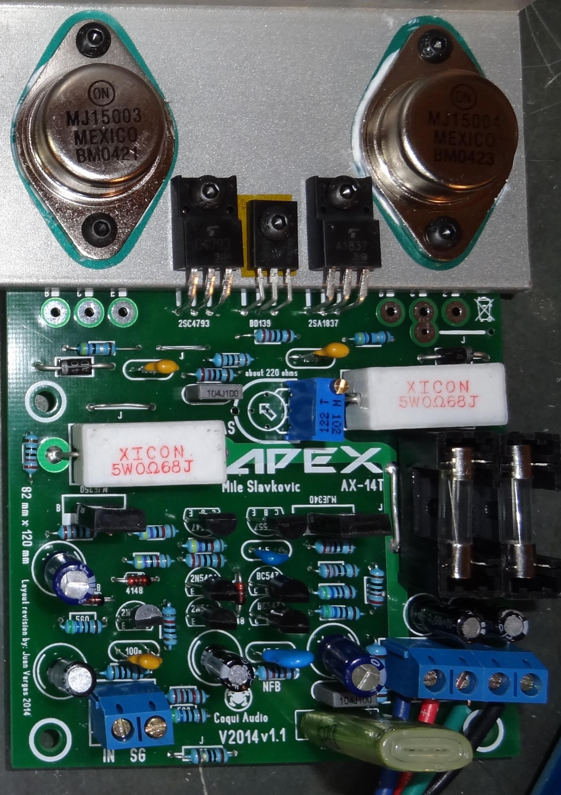

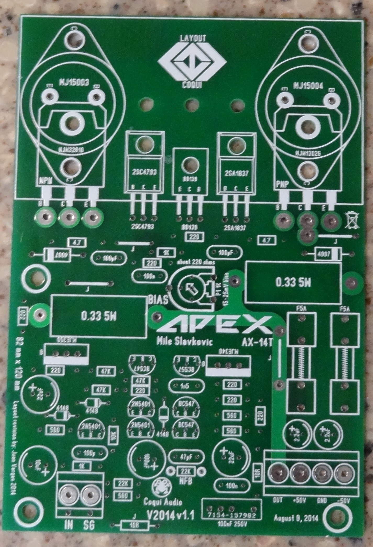

Is the first time I try AX-14 Terry and I'm really happy with the results, about the drivers I think I have seen guys using different drivers transistors, I myself decide to use the ones that are in the schematic and the good thing is that they are all plastic so one less worried about insulation just a bit of thermal paste and good to go, but I guess other driver can be use I think I have seen here is a post about driver transistors the "best ones" about cutting just try not to cut the BD139 traces :) take your time

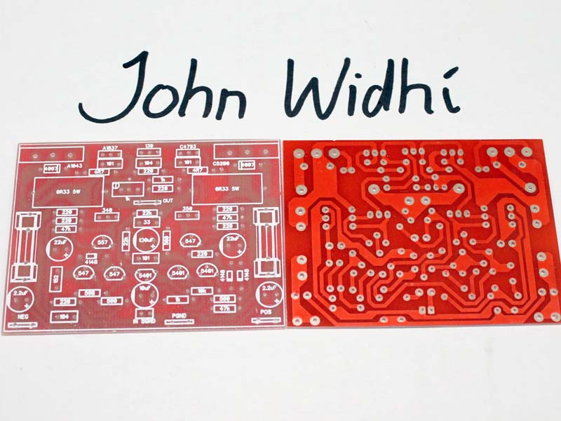

I Got my boards today from the board house. I'm trying to populate one from my parts drawers and I came across C3 at 1n5. I don't have anything close to that. I go from .22n too 450p. Can I substitute something there just so I can test it?
Thanks, Terry
do you have at least 1nF maybe you can put some in parallel under the board I mean that will give about 2nF, in my boards I have 1.5nF 100V,

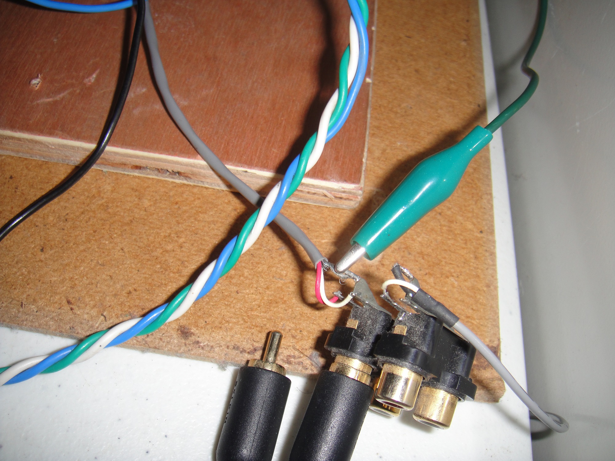

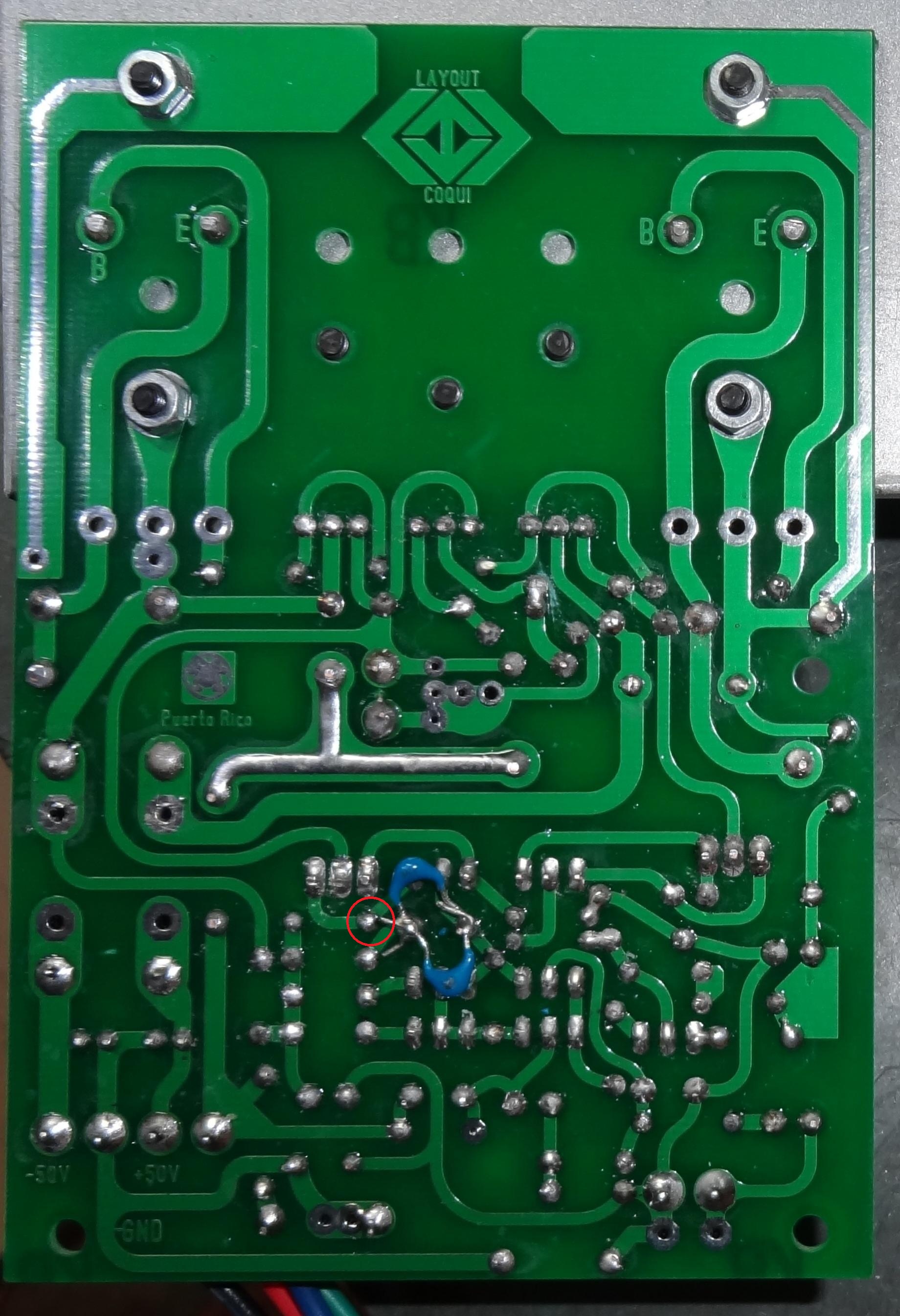

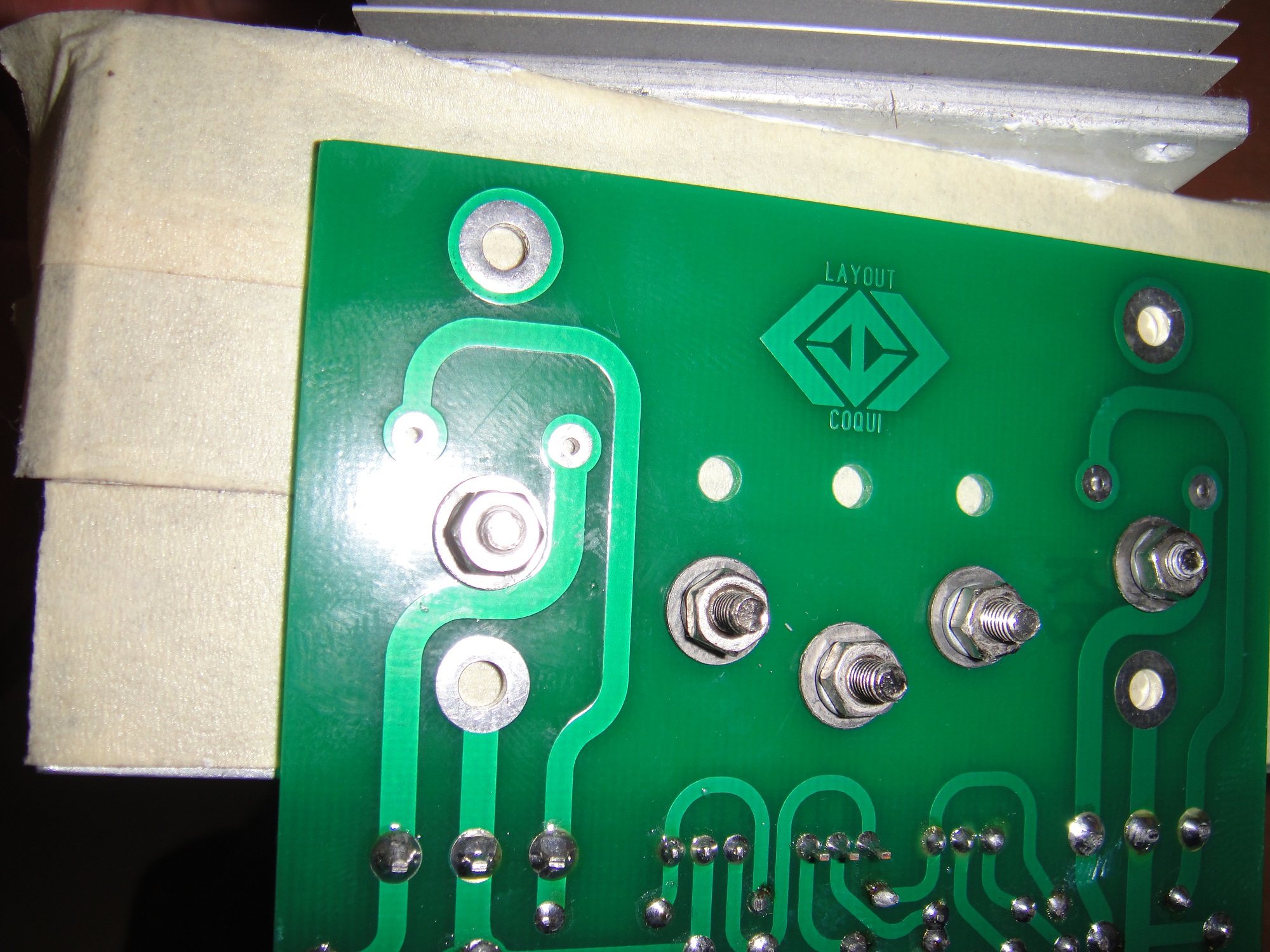

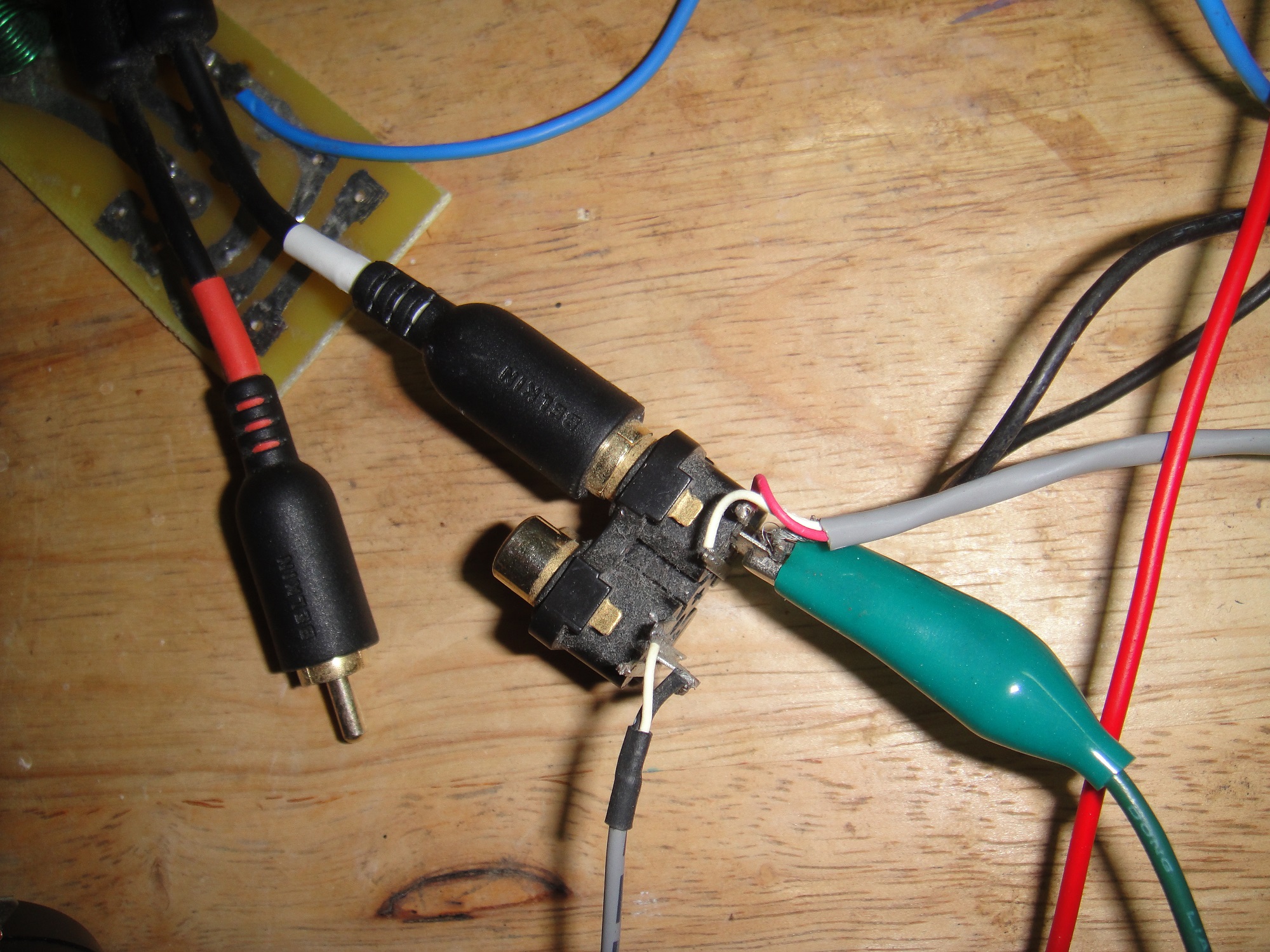

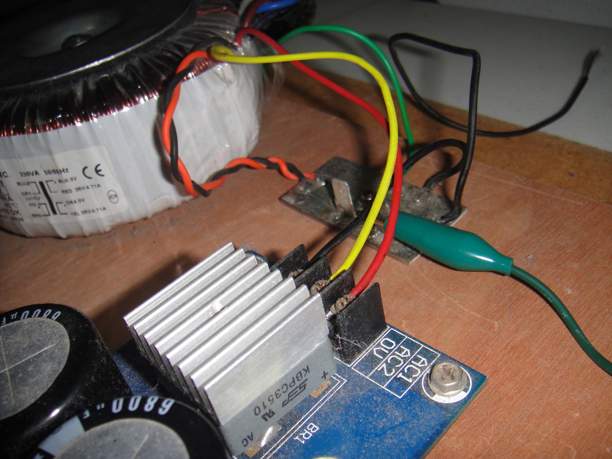

I forgot to tell you to initiate the board I read here that C7 that is in parallel with the NFB R11 22K need to be 330pF for test then after is stable and bias set then you can changed it to 47pF as I did the bias I decide to go to what is recommended so I adjusted to 15mV reading from R24 0.33 my power supply delivers 53V DC so is just right :) let me know how it goes also don't forget a GND wire from the power supply 0V to the RCA GND connection see images
the last image is to let you know to insulate the top of the PCB if you are going to use " L" adapter
Thanks, Terry
Hi Terry, any combination that will sum up close to 1500p, being put in parallel. Like 1n + 470p, 3 x 470p, etc. will be fine for testing.

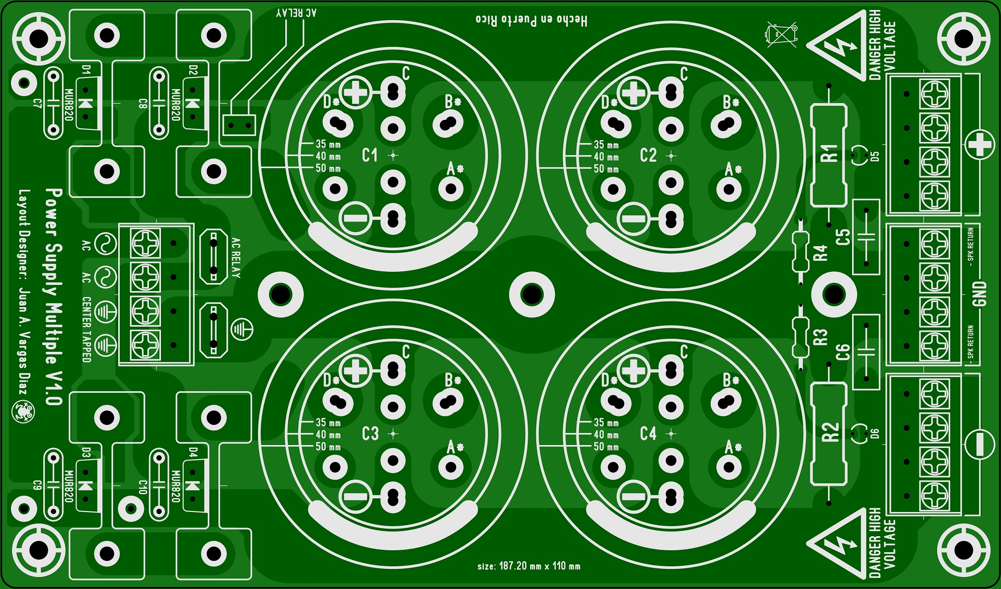

yeah man you should try out AX-14 it sound amazing good respond to tight bass and vocals are nice I love it :D I have a power supply board almost ready, up to 44000uF with many size option caps :) next project

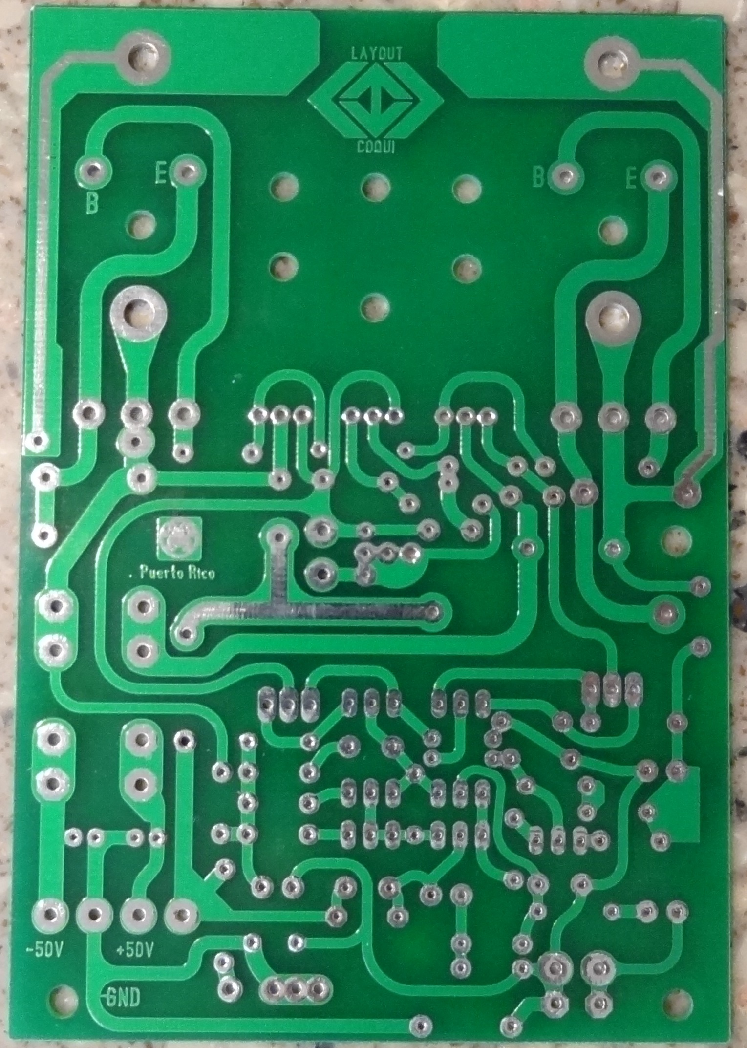

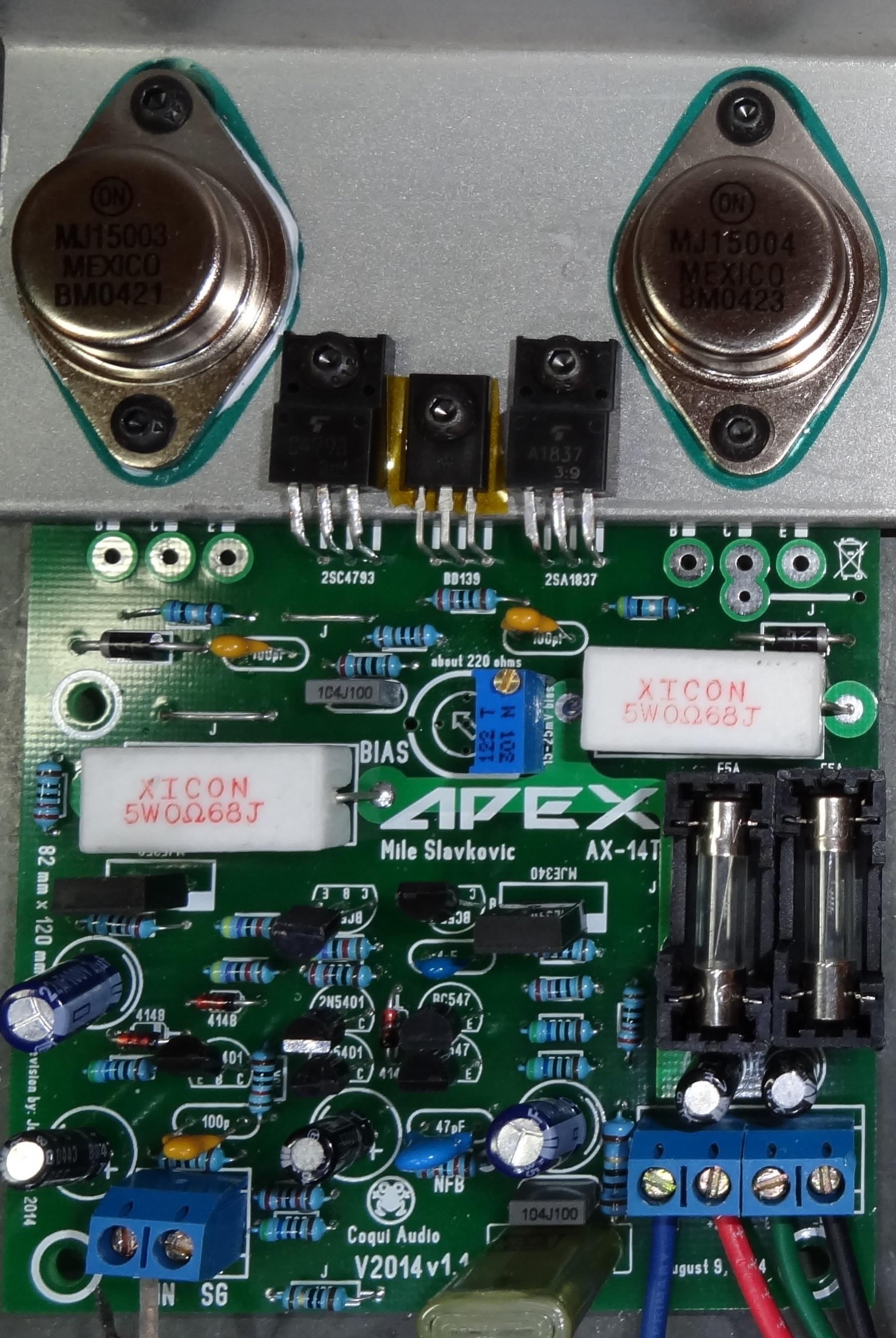

I had a few minutes before church so I took some pics. I'll show working channel on the left and troubled channel on the right. Maybe one of you eagle eyes can spot the trouble.
Thanks, Terry
EDIT; FIY I have about three volts shy of negative rails on the collector of Q9. Should be about -1.2v

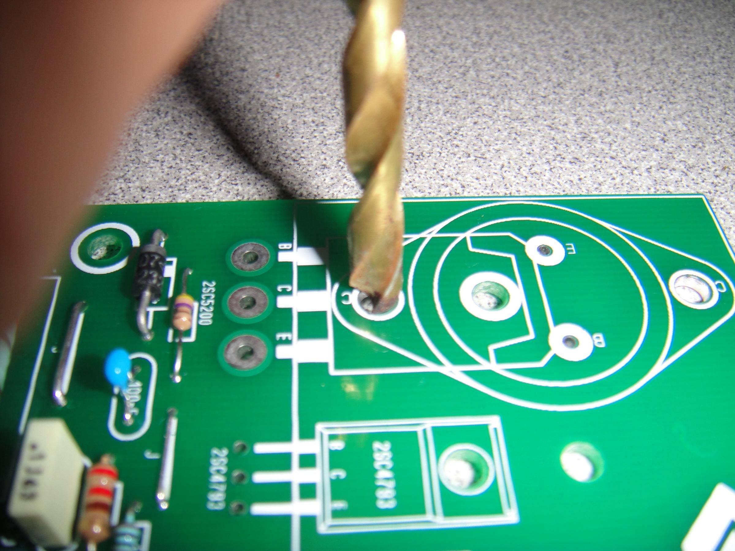

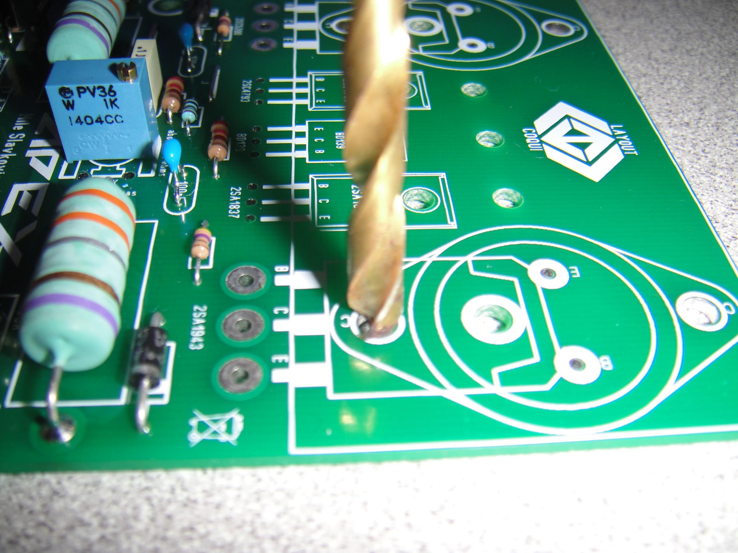

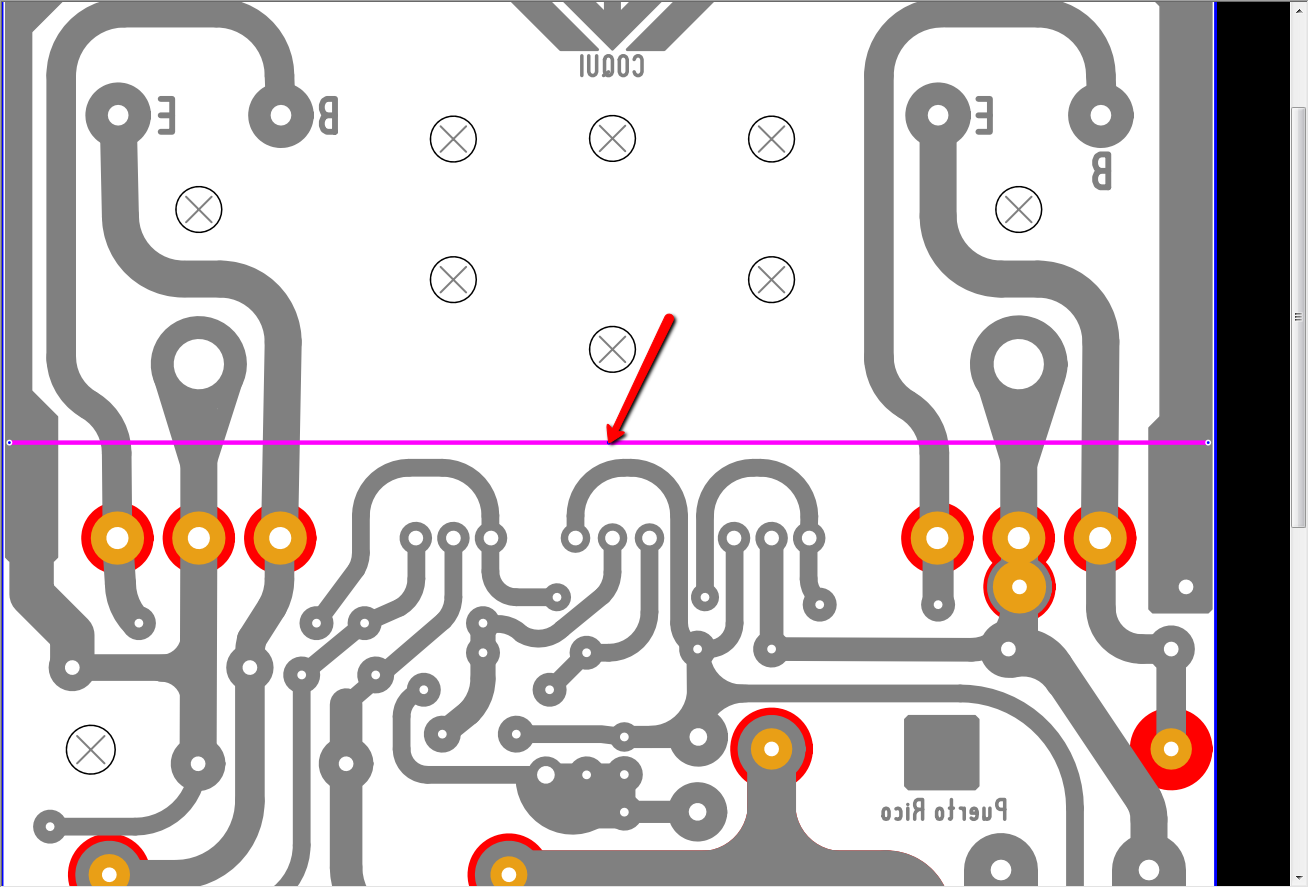

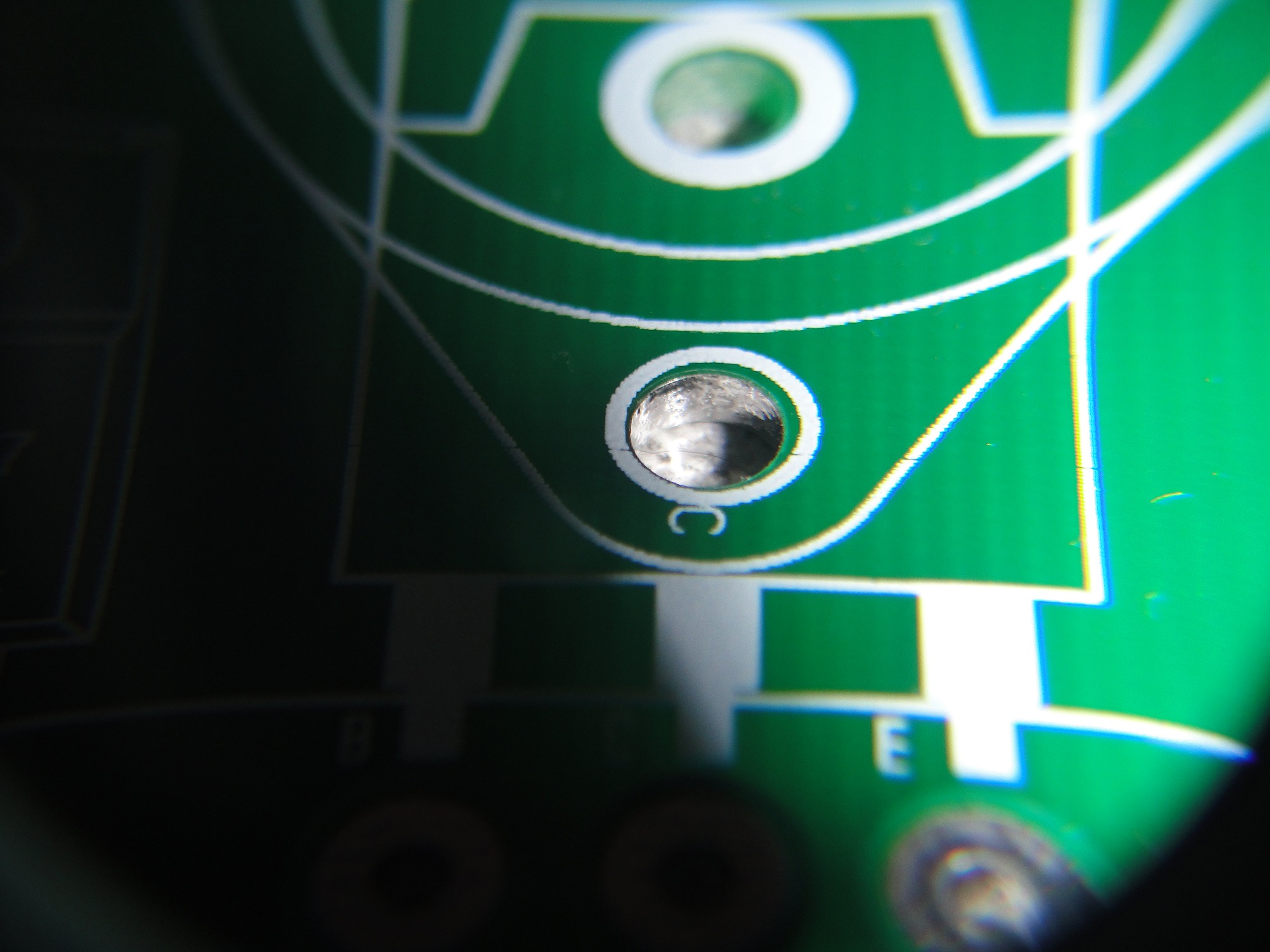

Terry look great :D hey I have problems the first time I put it together because some how the holes for the TO-3 has some solder residue and it was touching the heat sink, so what I did I insulated "temporary" the top of the PCB and problem went away, also you can use a large drill bit and scrape of some material to avoid that contact with the heat sink I did a quick "ghetto" fix with tape :p

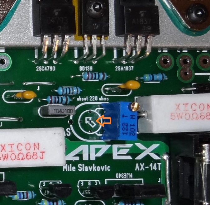

also move the pot to the middle like I have on my boards and also you cab place the jumper for the negative rail I just did to reinforce the connection for the TO-3
