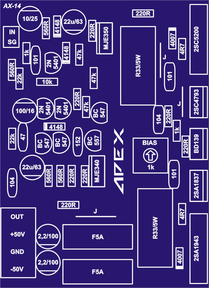

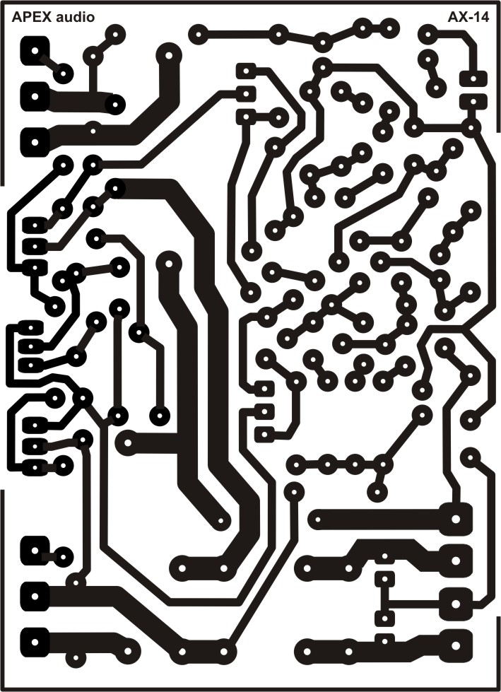

Nx14v2 pcb
This pcb for NX14V2 is fixed on heatsink, and you soldering outputs on coper side of pcb. Montage outputs is much easy this way.

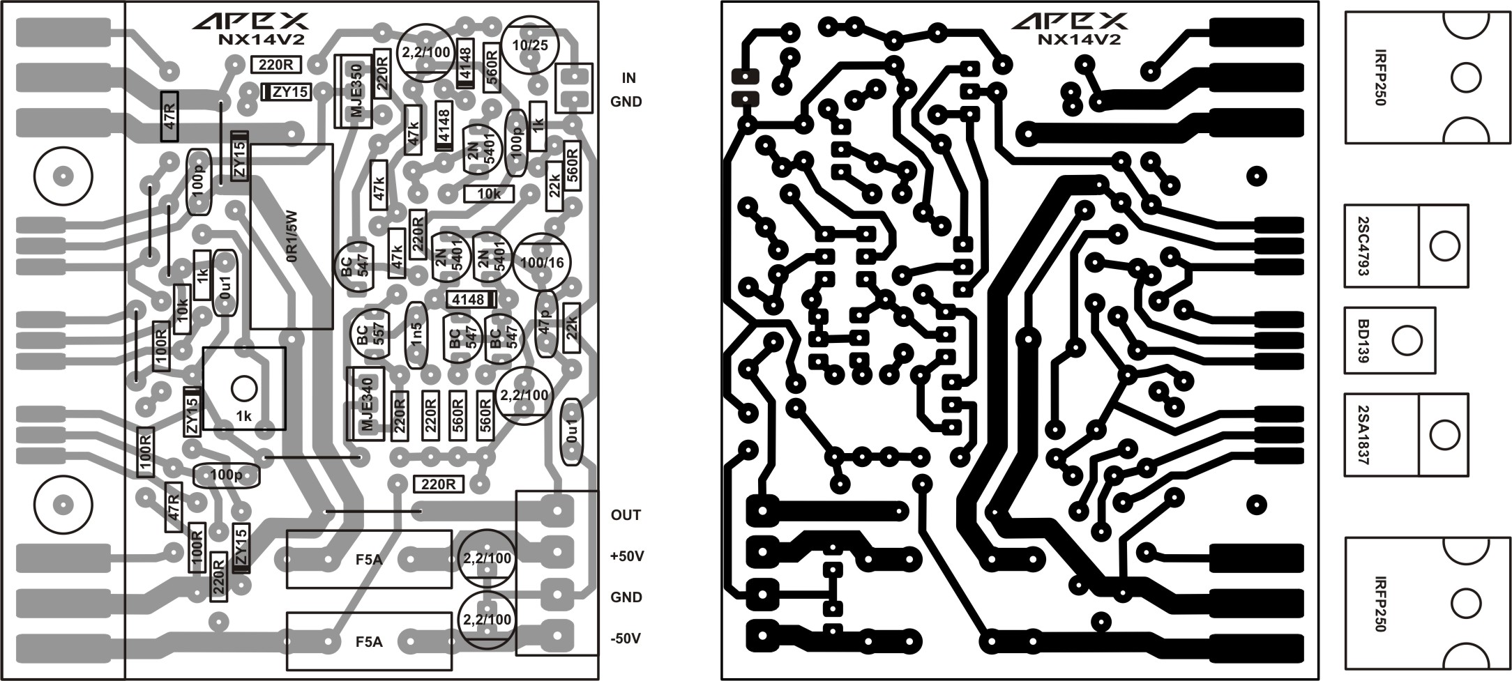

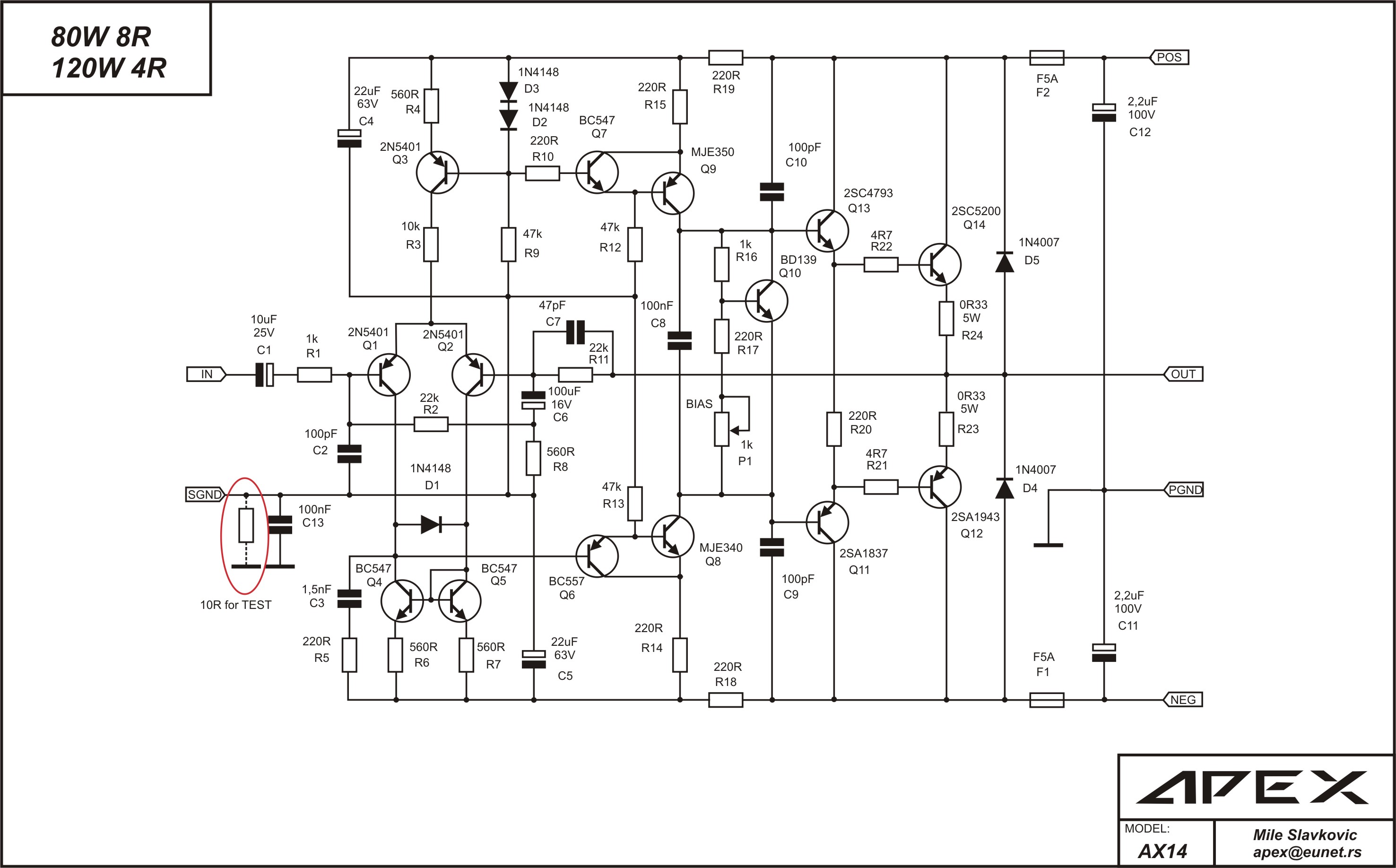

RE... NX-14 Completed
Hi Apex,
Still no luck with my NX14. Looks like I have to assemble the second channel.🙁🙁🙁 Anyway I see there is a difference between the two boards(NX14 V1 and NX14V2). I see two 100R resistors on the layout but not on the schematic. See attachment. The 22uF 63V cap on the schematic is replaced with a 2.2uF cap on board.....is this okey......
Macd😕😕😕

Hi Apex,
Macd😕😕😕
Two 100R resistor in series I use instead one 220R, 2,2uF is OK.
Do you measure voltages as I suggest?
