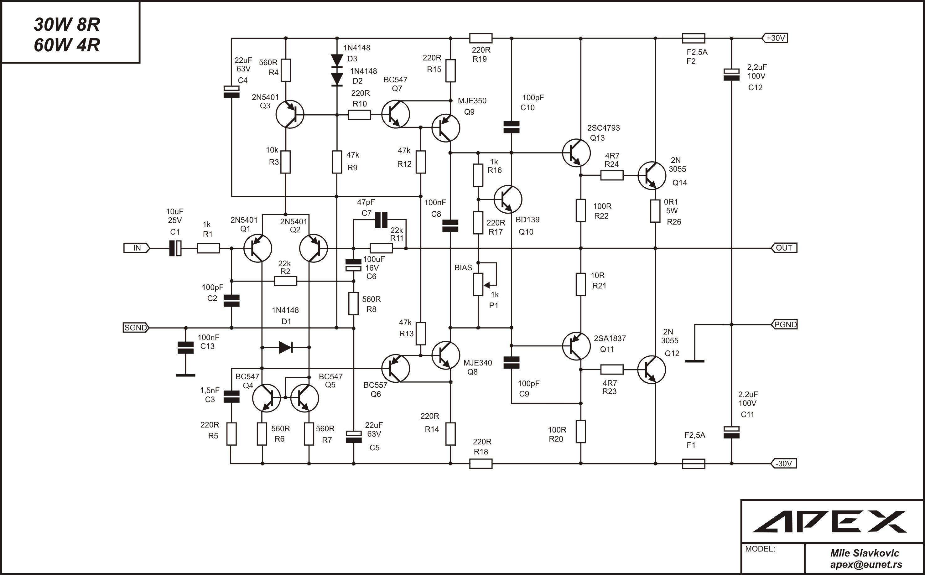

In post #1 I say this amp was made for testing speakers, sound is good, precision and natural, but there is another adventage sound not change much with all kind of speakers wires, x-overs, and box topology (bass reflex, TL...)

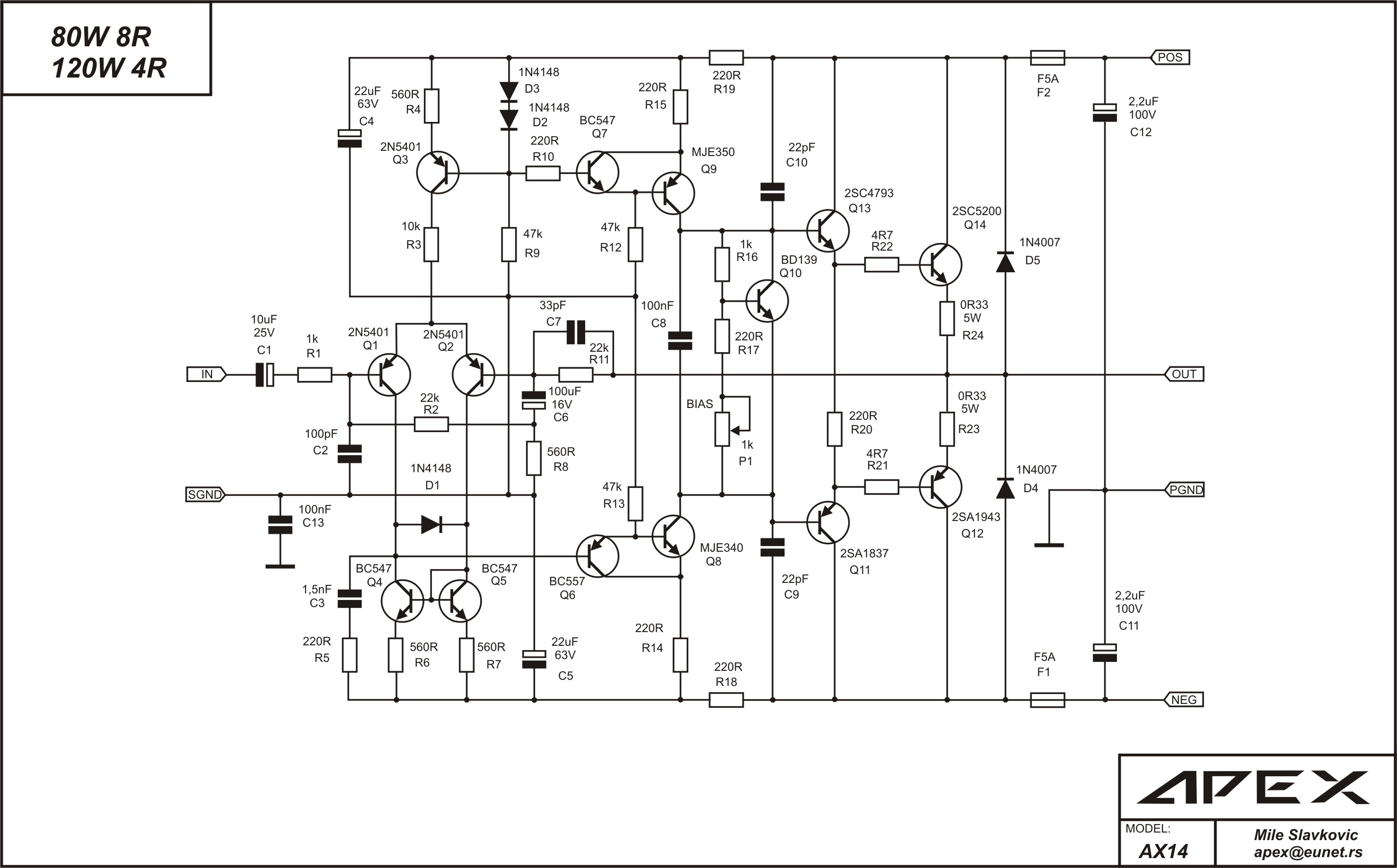

i have an old amp with 2n3055 and its matched pair 2pcs. each
i want to modify it to ultimate fidelity
how much power can this go using ultimate fidelity board
what ideal voltage and how much kva(trafo)
thanks
Do you have BDX18 as matched pair with 2N3055, or you want use another 2N3055 in quasi output? Modify NX14 useing this schematic (not tested).
Rail voltage +/-30V is maximum, power 60W/4R with 100VA transformer (200VA for stereo)
Regards
