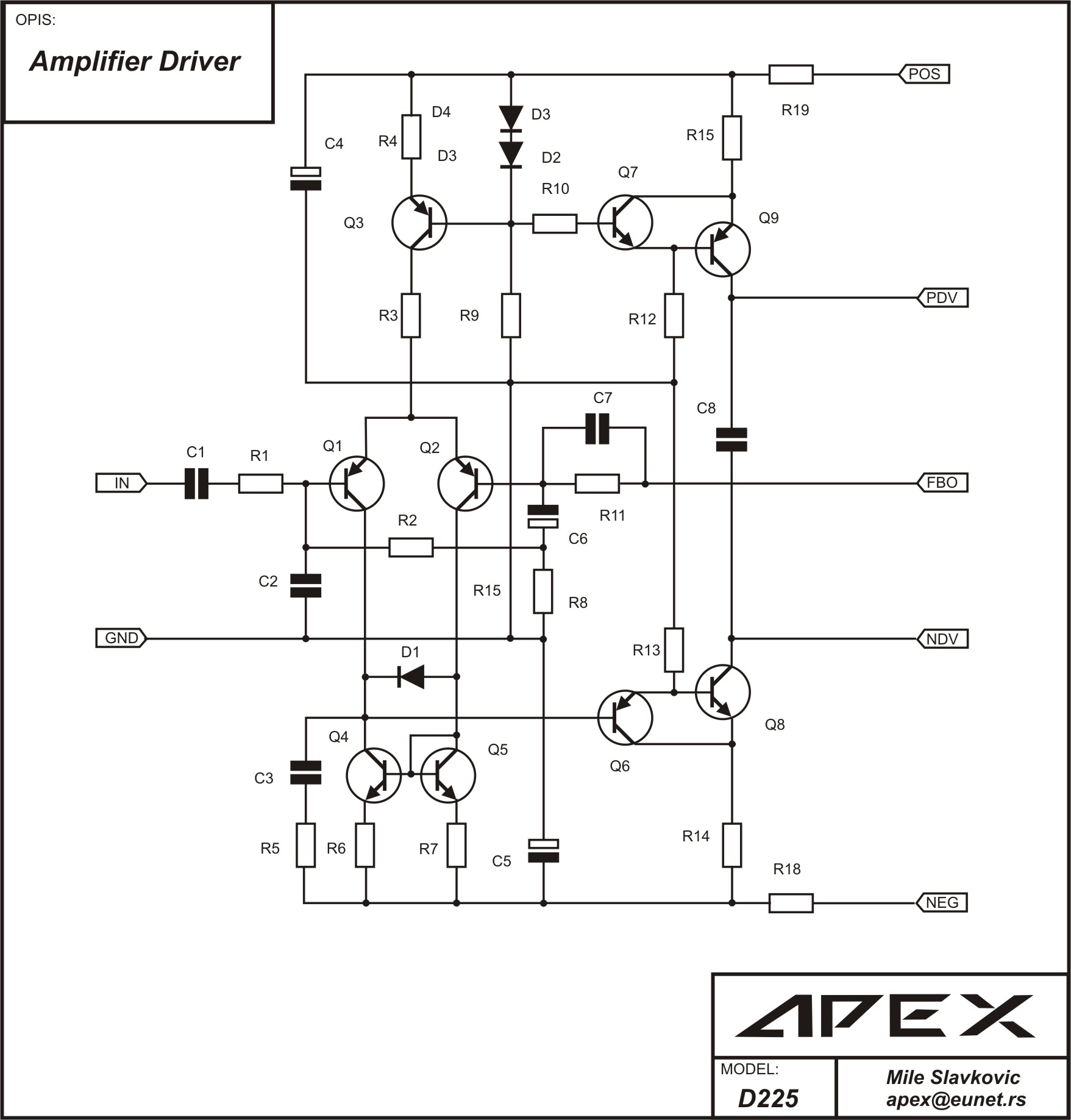

You want to build 500W Hi-Fi amp
I must draw schematic for this version, than I will share PCB
Regards
Powerfull version made for test have only 1mV DC offset.
Hello Apex,
any word on this version ....?
Hello Apex,
Triple darlington output stage with class H step driver and VI limiters, other is same as AX14
Regards
Ohhh , i thought it was for hi-fi listening, only hi-powered........
It's for hi-fi listening, but with large speakers
Regards
Any amp is based on OP amp (http://www.diyaudio.com/forums/solid-state/162494-amplifier-motherboard.html ) , for output power amp topology is not important.

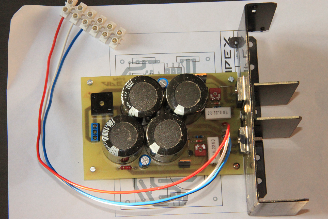

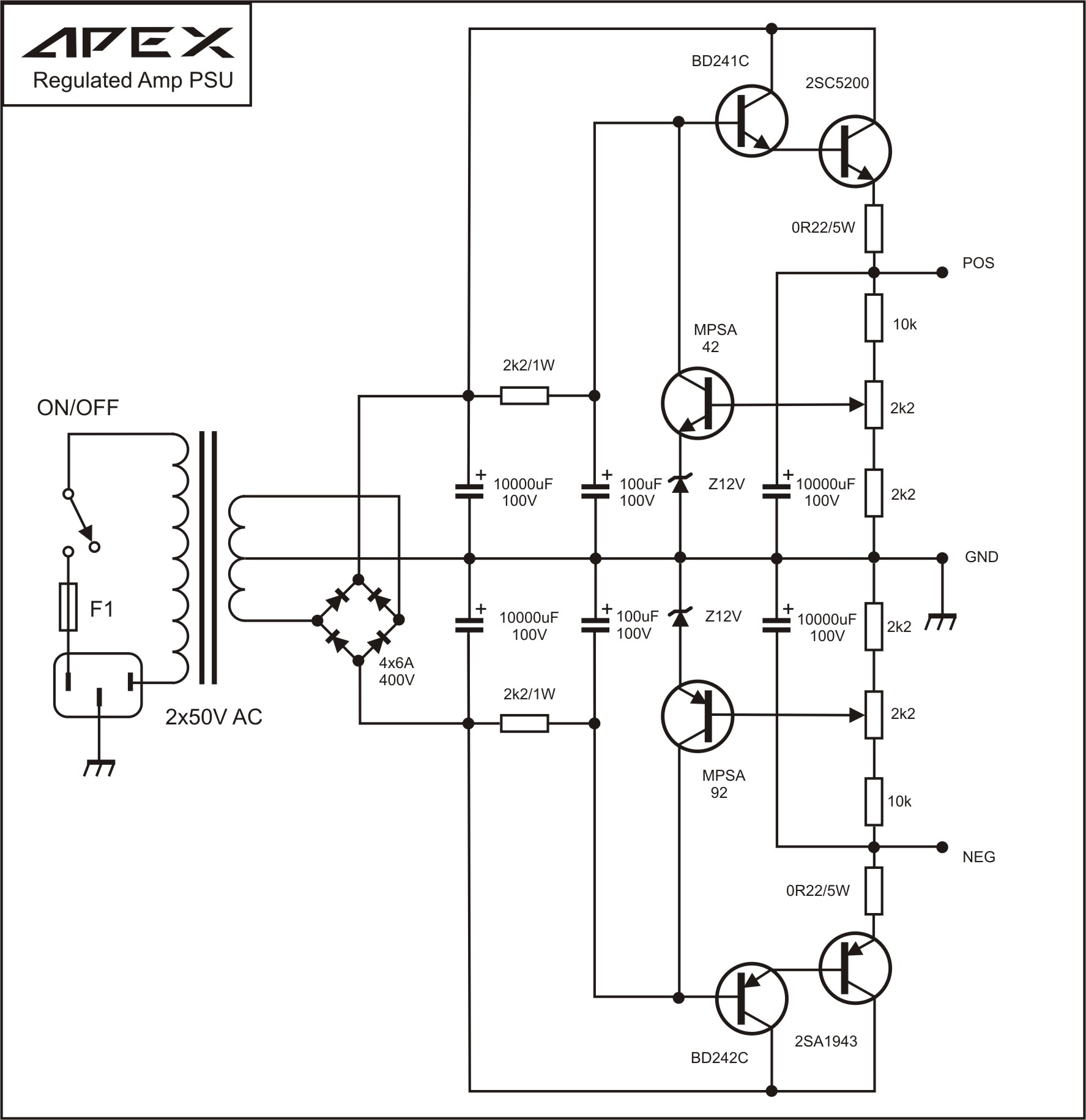

I want to try the regulated supply (just for the fun!), but i've 2X30V ac (not 2X50V), so 45v dc, is there values i must change on the shématic ? I want -+40v from the supply
Thanks.
Use 8,2V zeners instead 12V
Regards
Thanks for your answer, could you suggest a power rating for this zener ?
Use 400mW zeners.
apex can i use kse350 instead mje350?? with the same specs as mje350.
thanks
regards
Yes, there is many replacements for MJE340/350, U can use any of them.
Regards

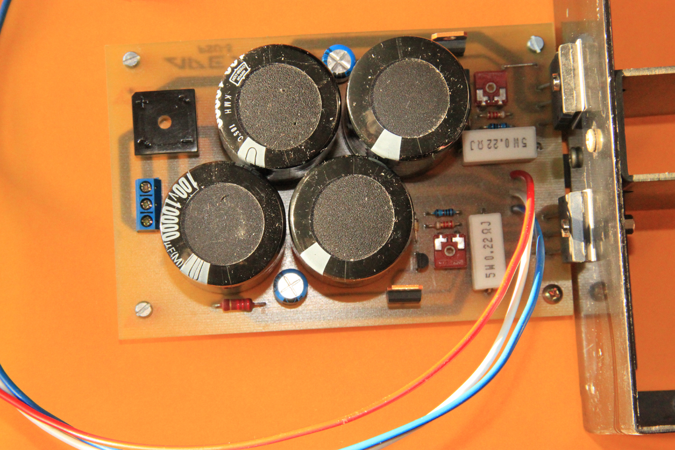

Regulated supply build ! Works fine, very usefull for trying amps because it is possible to change the output voltage. 2X30V AC tranfo, 45DC ; i've try output from 30DC to 42 DC. Only 2X10000uf on the psu board. Zener= 8,2V.
Thanks Apex.
Can you post pictures? You need 4x10000uF for regulated PSU...
Regards
Regards
There is 4x10000uF on schematic...
