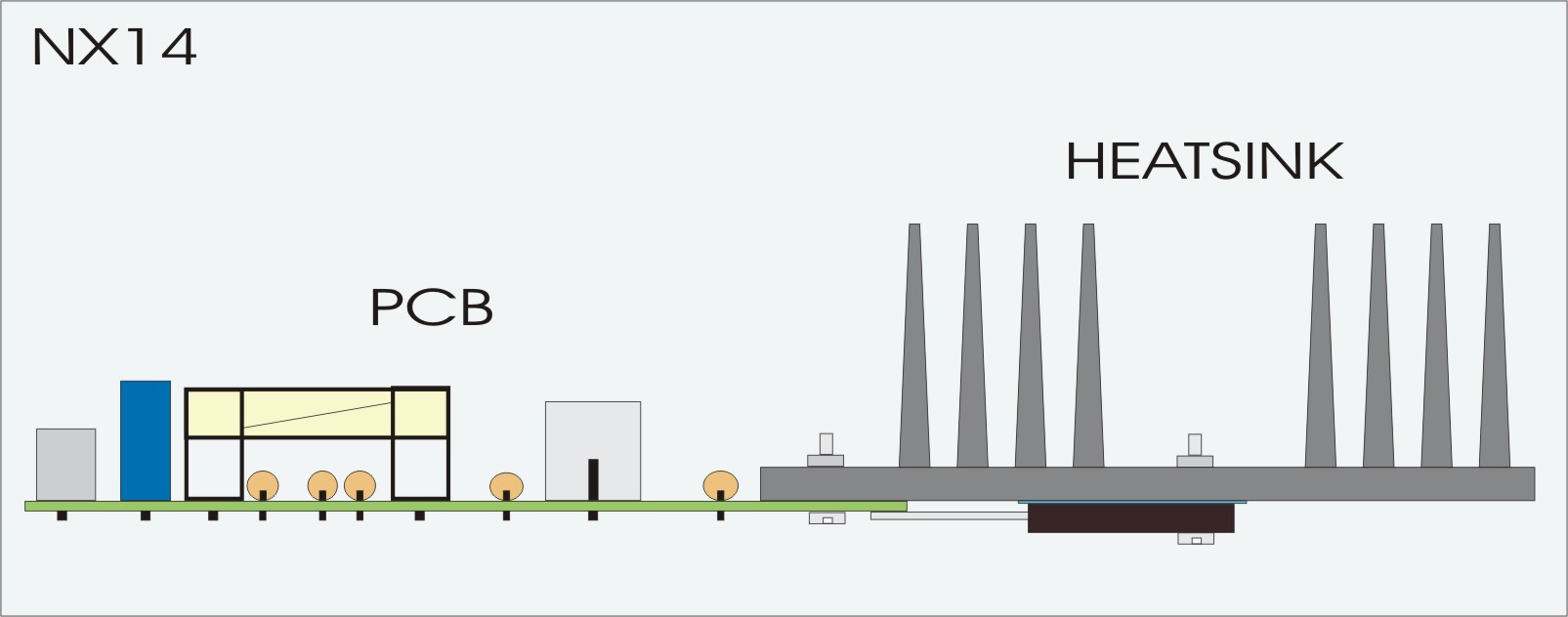

Thanks Mile. Using +/-56VDC for AX-14 can it still handle 4 ohms load?
Yes, but this is amplifier for HI-FI speakers, it's usualy 8 ohms for home listening.

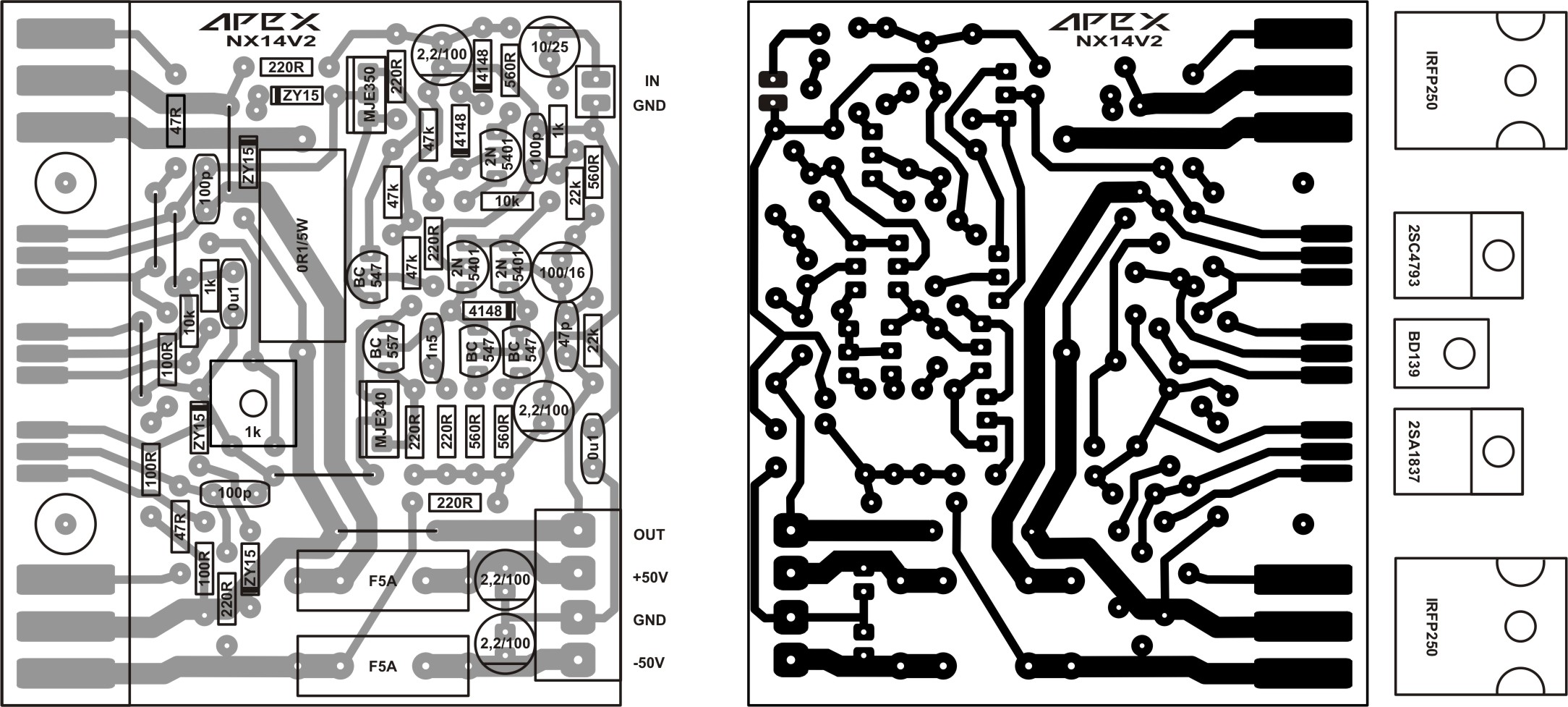

apex,
i have a bunch of irf 460
can i use this for nx14?
Yes, U can

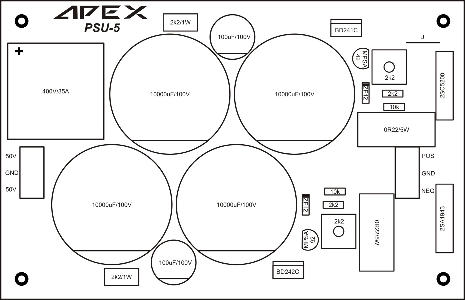

2sc4793/2sa1837 replacement
mje15030/mje15031 is this fine
how about tip's can i use TIP
and the psu(kva?)

Use 300VA transformer with 2X35V AC, and U can use MJEs or TIPs in this case.
No 500W with MOSFETs in my projects.
Regards

i already have 2x40ac can i use it?
and does adding output pair help stability?

Yes but only with MJEs as drivers, TIPs Vce is to low. No need add output pair.
Regards
