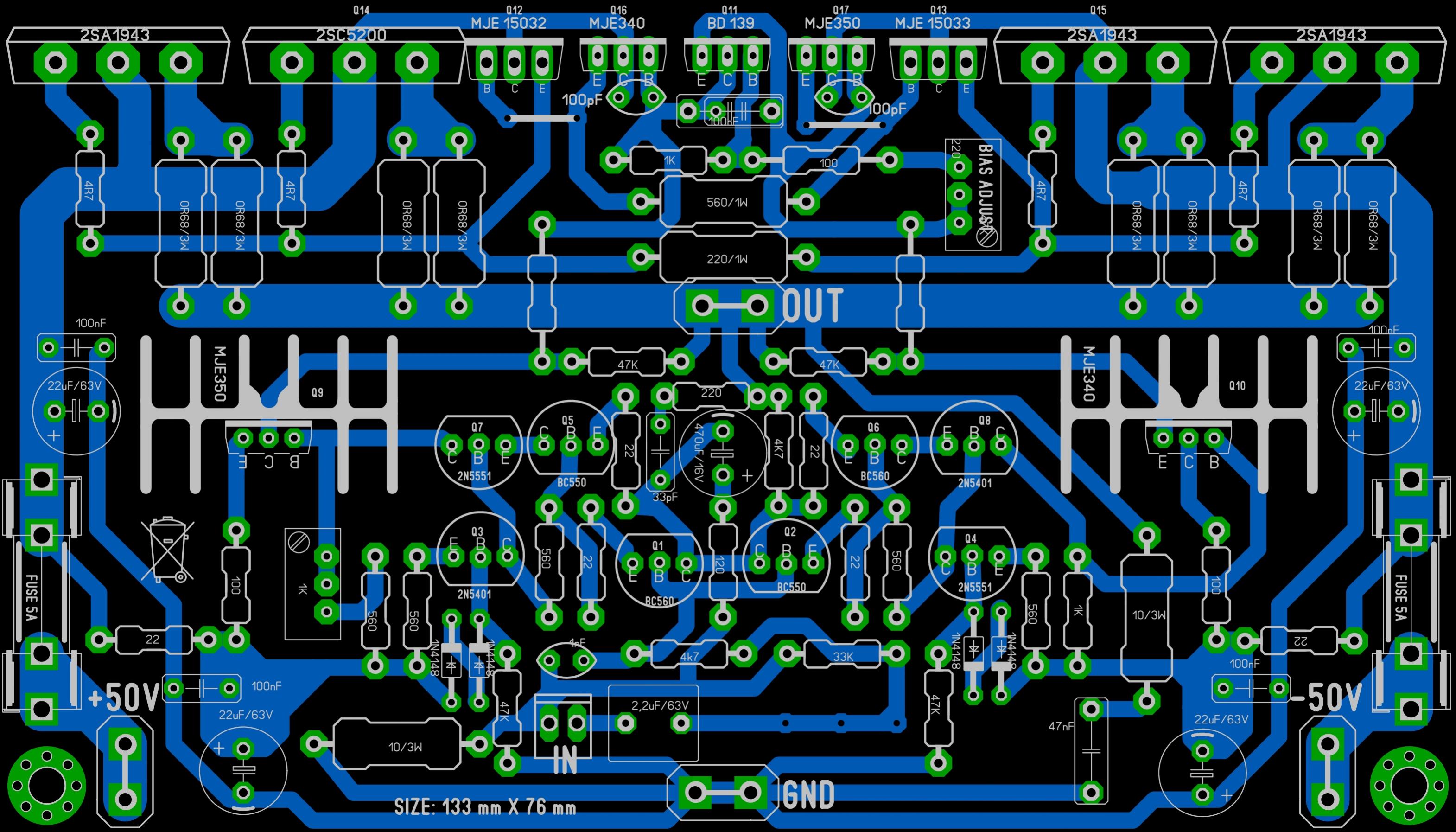

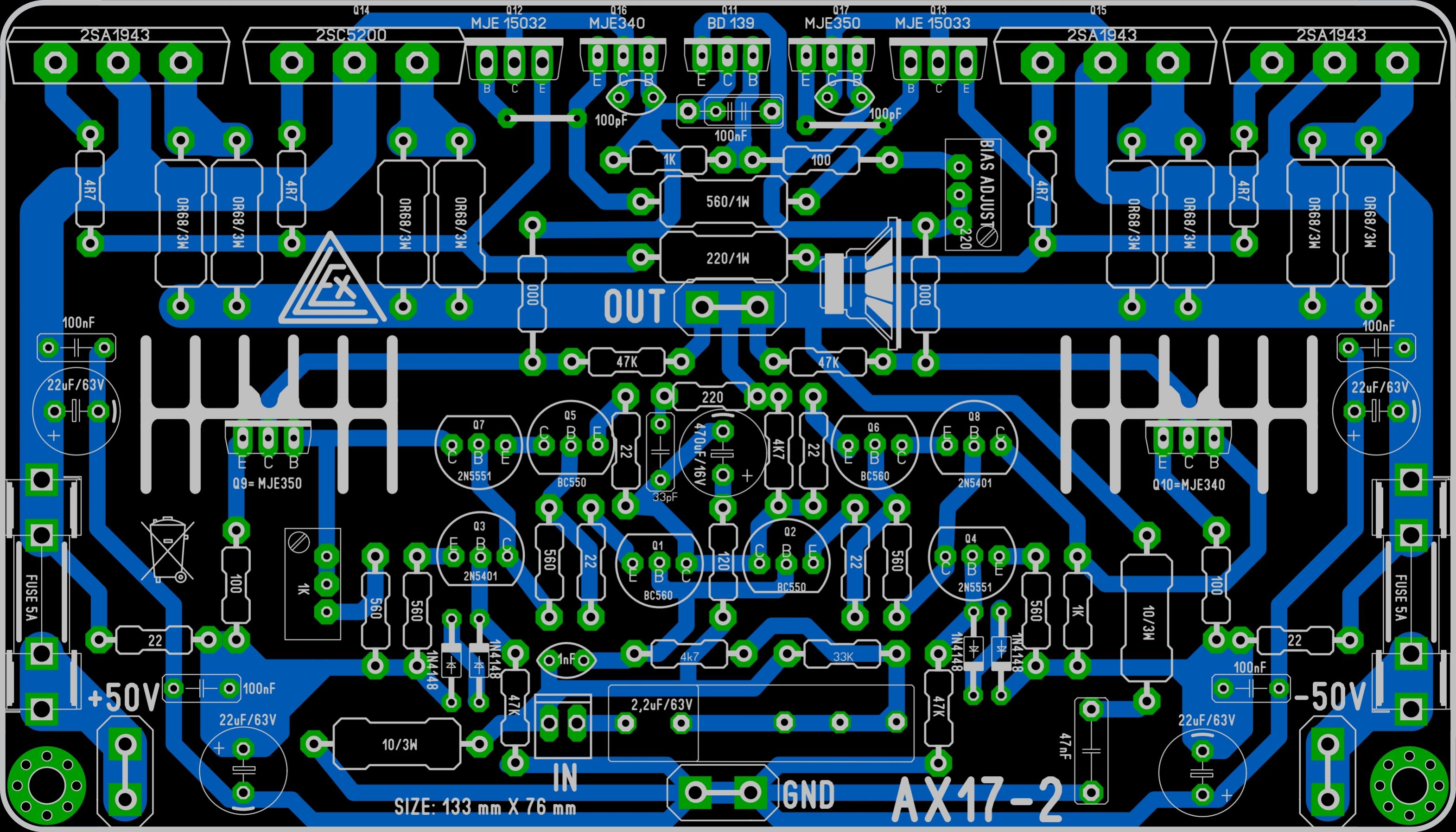

100W Ultimate Fidelity Amplifier
redesign AX11 stereo
Nice work, what is the post number with AX11 stereo pcb design?
Regards
Mr. Mile, I be able to model ax11 PCB one channel (mono).
MR wiljj78 not post PCB stereo.
Explanation, because I like to see a stereo amplifier and PSU One. s
Ax11, I became Stereo redesign.

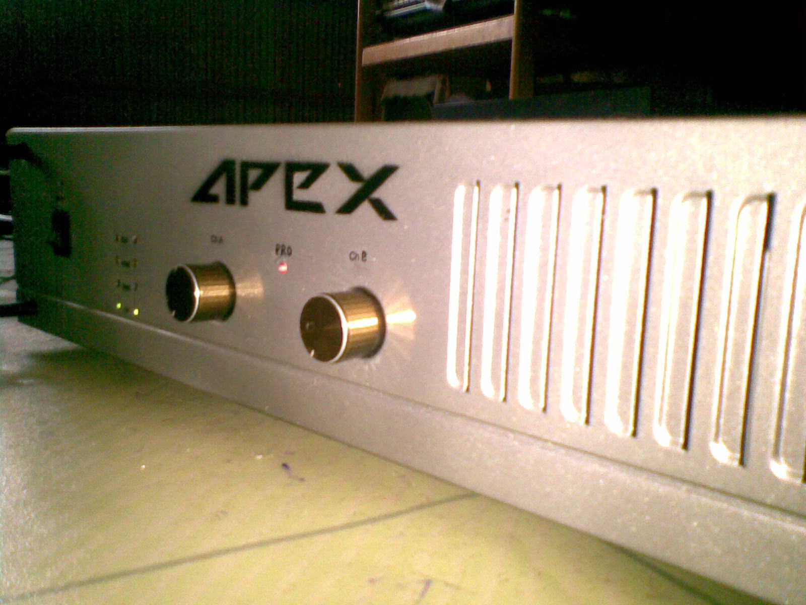

AX14
My AX14...with Apex logo and led display.

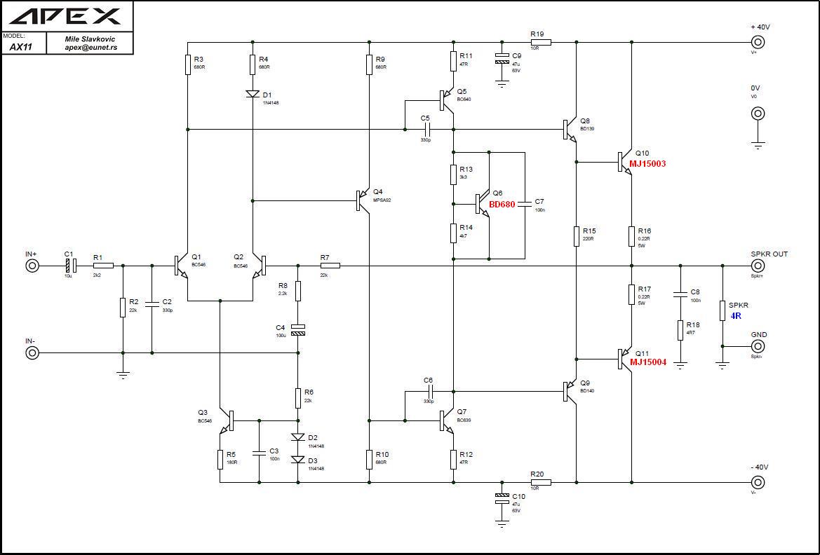

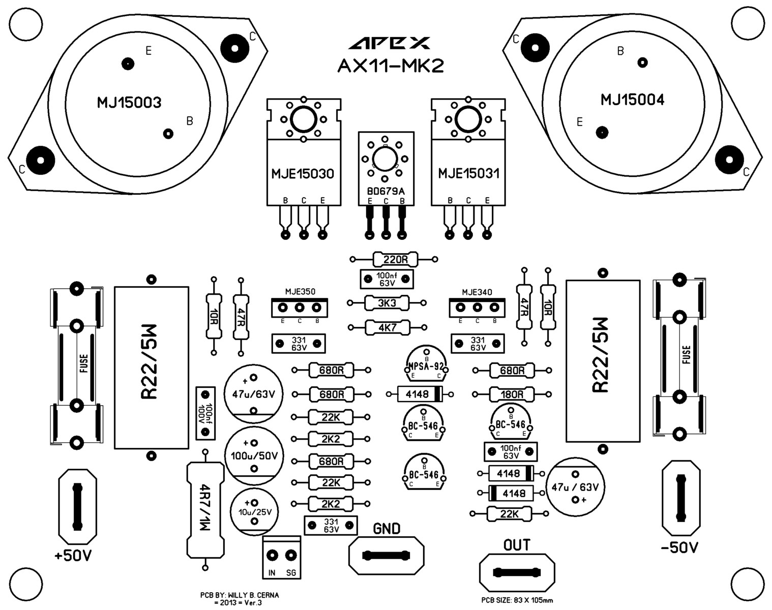

MPSA13 replacement with BD680?
Hi Mr Mile!
What changes are needed in the schematic (AX-11) if you replace Q6=MPSA13 with BD680 and Q10=BD249C with MJ15003, Q11=BD250C with MJ15004 and SPKR=4R?
thank you!

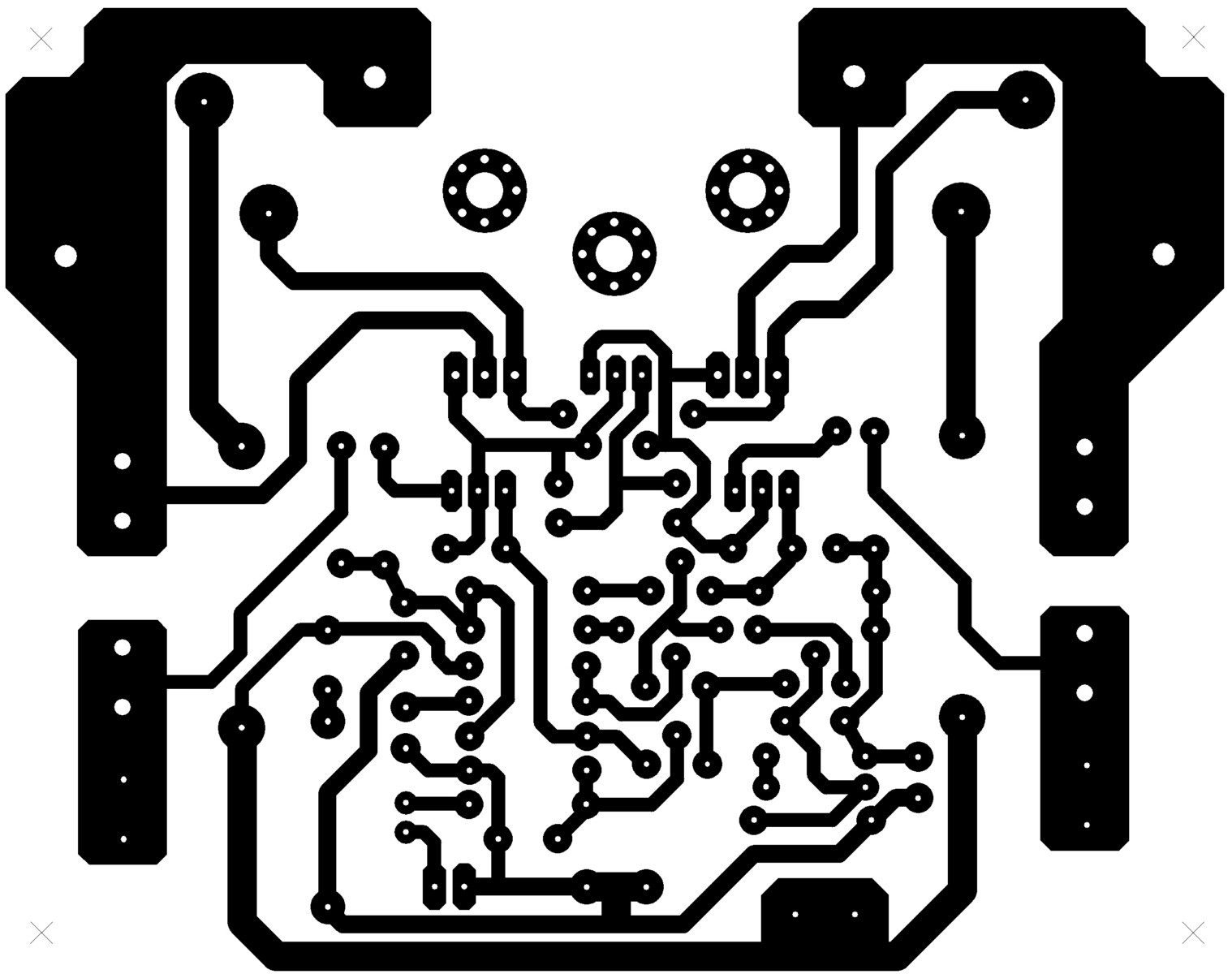

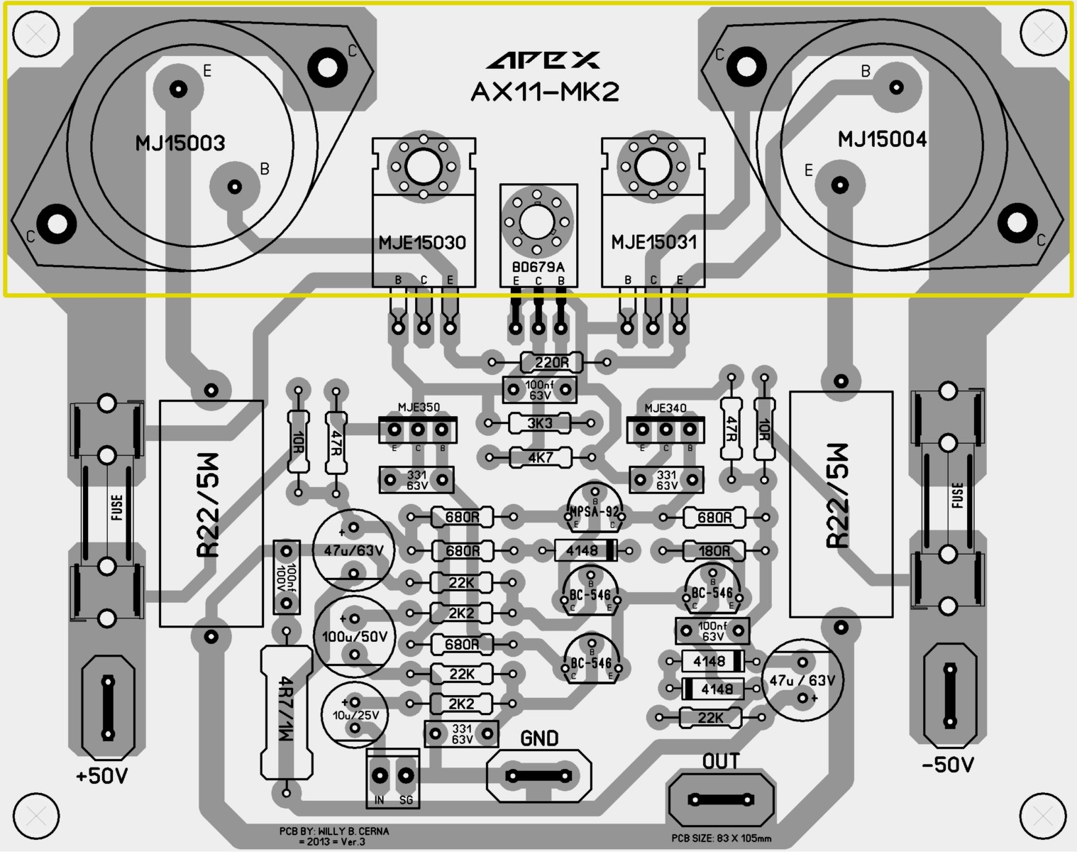

Use this PCB for MJ15003/15004, with BD679 not BD680.
It works just fine with no changes.
  • APEX AX11-MK2 PCB.pdf
Today I made a test between ax14 and ax17. No doubt , winner is ax17. Far better sound:bass lower than my ears can hear :)and treble crisp and clear! STEREO MODE! Anyway ax14 sound is very good , I've noticed that it has some improovements than classic schematics! Sorry about my "english" ! I'll try ax11 next week maybe:)
