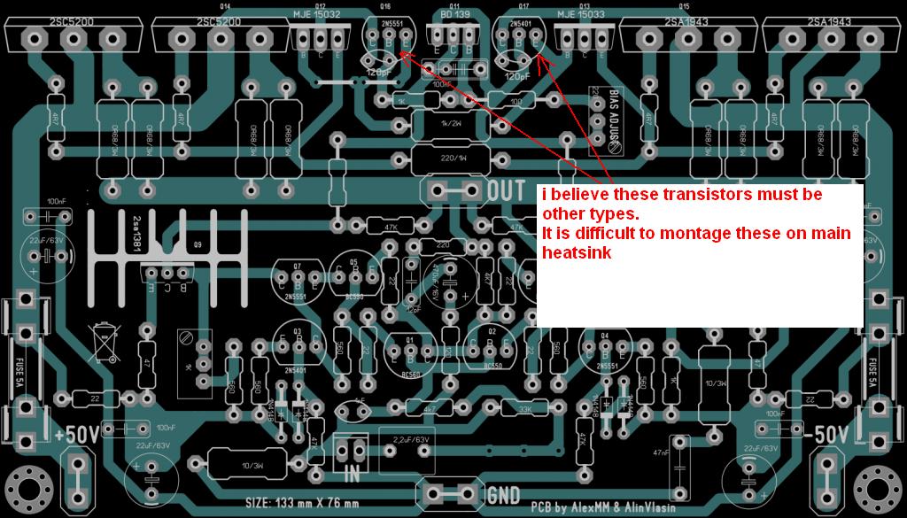

Here is the PCB for this AX17 schematic with two pairs of output transistors.
It is an extended version of the one firstly designed by AlexMM.

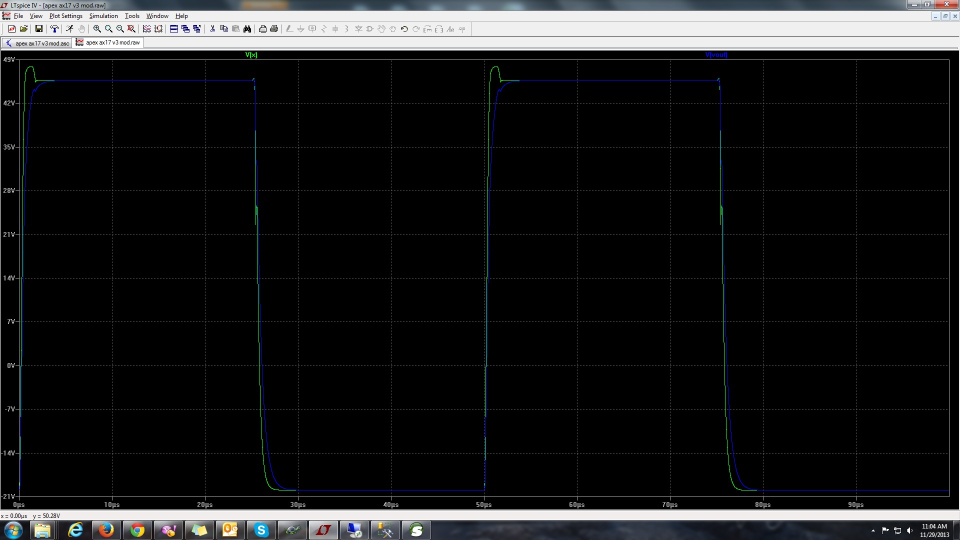

A double check across the schematic should be performed. Note that the components' numbers on my LTSpice schematic do not match the original numbering, please check considering their values only.
I will provide bottom copper layer pdf file in Private Message for those interested in building it.
Any suggestions for improving the PCB and/or schematic are welcome.
Regards

nice work
I have a suggestion.

I have made 2 PCBs of AX11 but MPSA13,BC639 and BC640 is not available here. Any substitute for these transistors?😕😕😕
Just my 2 cents:
How about using the BD139/140 in place of the BC639/640?
A BD139 instead of the MPSA13 would work fine as a thermal sensor, the TO-126 case is so much easier to put on the heatsink than the TO-92.
The pcb has to be changed accordingly, but that's not so difficult.
As long as the rails aren't raised too high, then the BD139/140 do fine there and those may be easier to find. They are already usable as drivers.
