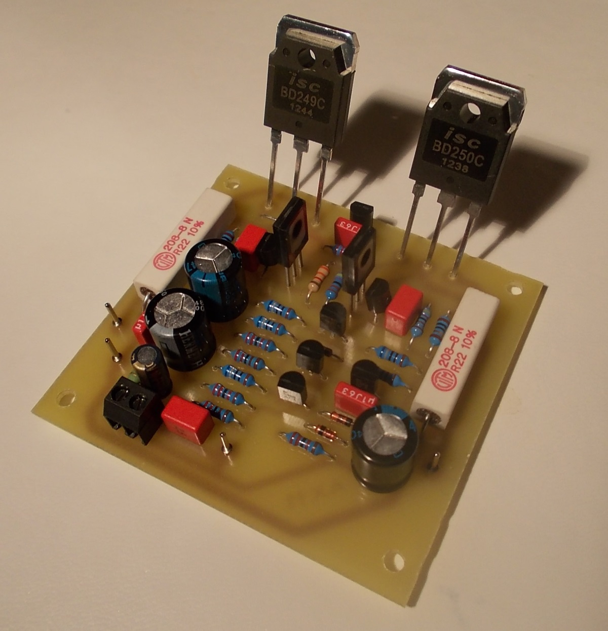

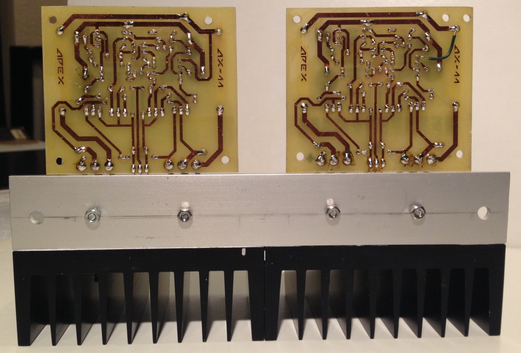

try AX-11 and is pretty detailed in sound 😀 don't mind about my ugly set up I care for good sound 🙂 and also there is a lot of options to chose from mister Willie has many layouts styles to chose from too. sorry the question was directed to mister Miles 😛
best regards
Juan
Long time from first post #1990 to a stereo module (only fotos AX-11) 😉
I wish I had more time.
regards Olaf

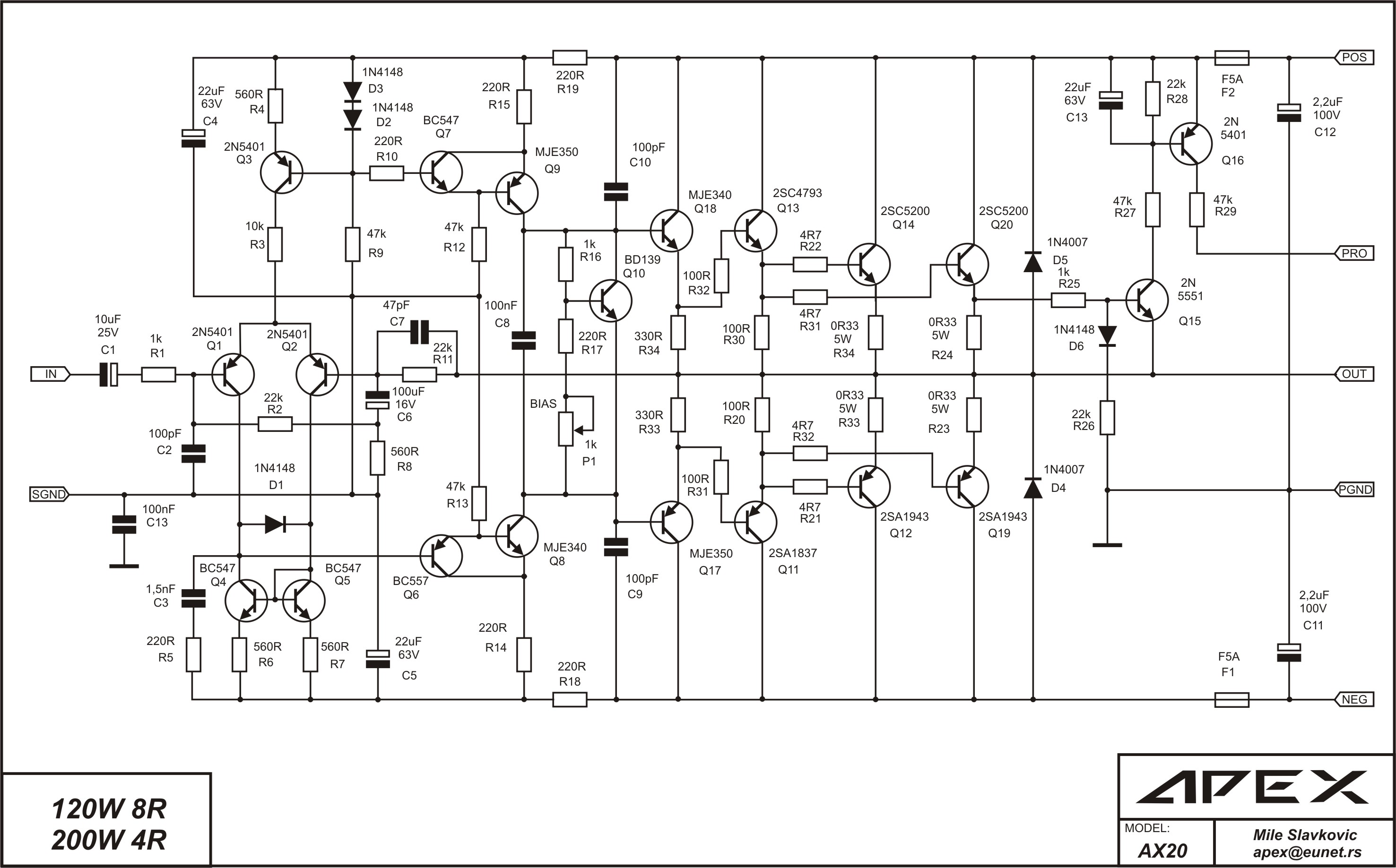

AX20

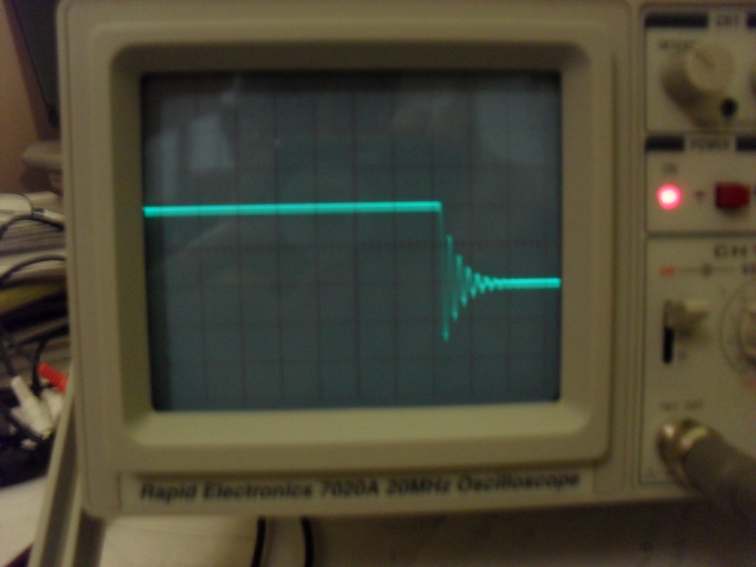

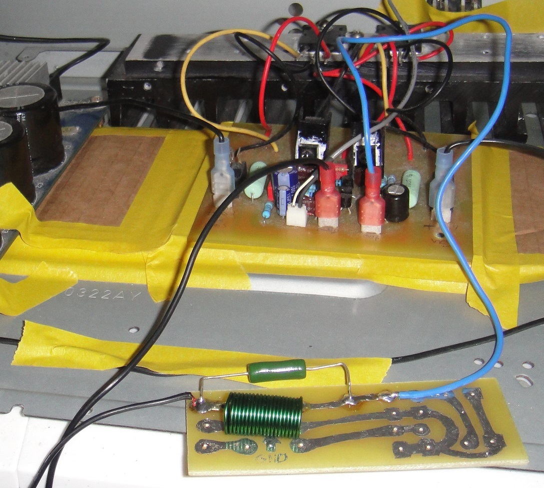

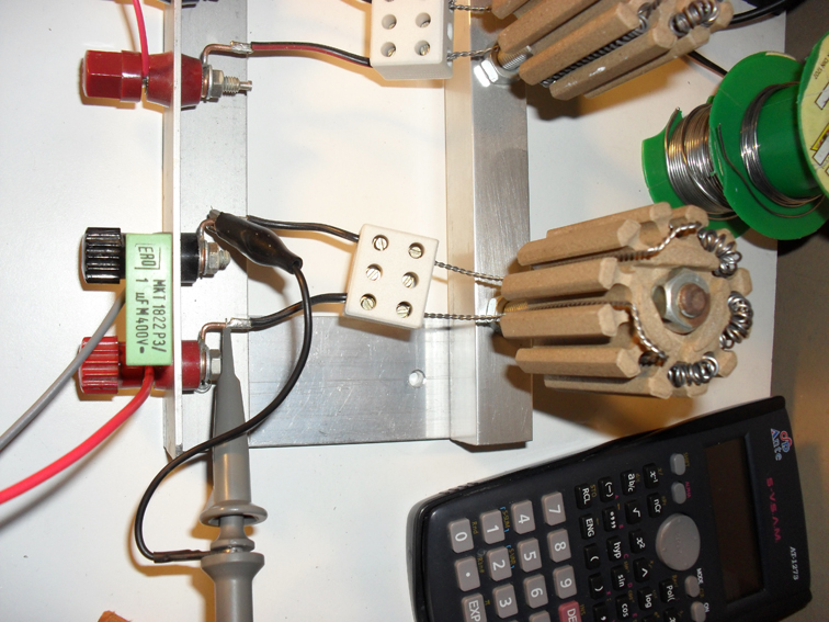

Hi mr Mile ! I took so long but here I am like a snail walking 🙂... with my first AX20 channel and NE555 protection, clip led, signal led and power led, in same pcb. Everything is working perfect, power supply +55VDC – 55VDC, DC ofset – 2,5mv. I changed C9 and C10 to 33pF to avoid visible oscilations, I replaced R16 to 1K5 to get enougf bias, 15mv across R33/5W. Is it normal to get 3,54V across colector/emiter of BD139? This amplifier sounds veeeeeeery good, sine wave is perfect, but when I use dummy 8R square wave, you can see the diference betwen with 1uF in paralel or without, is this normal ? In scope, you see 1KHz and 5V per div. I dont have over shooting obssesion anyway 🙂... Output sine Wave 1KHz without clip: 8R 32VAC, 128W, 4R 30VAC, 225W. About supply for NE555 (12VAC) protection, what should I do ? Should I put a smal transformer for it, or get 12VAC from a special winding to the main transformer that I have to order. Thanks a lot Mile !!!!!!!!

Nice work... 12VAC supply for NE555 you can get from special winding to the main transformer.
