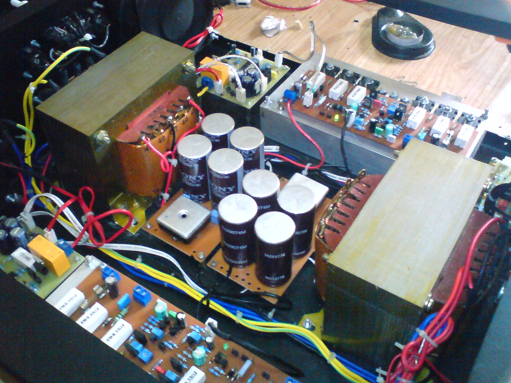

hi mr. apex, i got an nsl32sr3 from my junk and i want to incorporate it on my ax20 mono. my rails are 56-0-56Vdc. any values to change?
thanks and happy holidays
Your circuit is ok,
thanks and happy holidays to you.

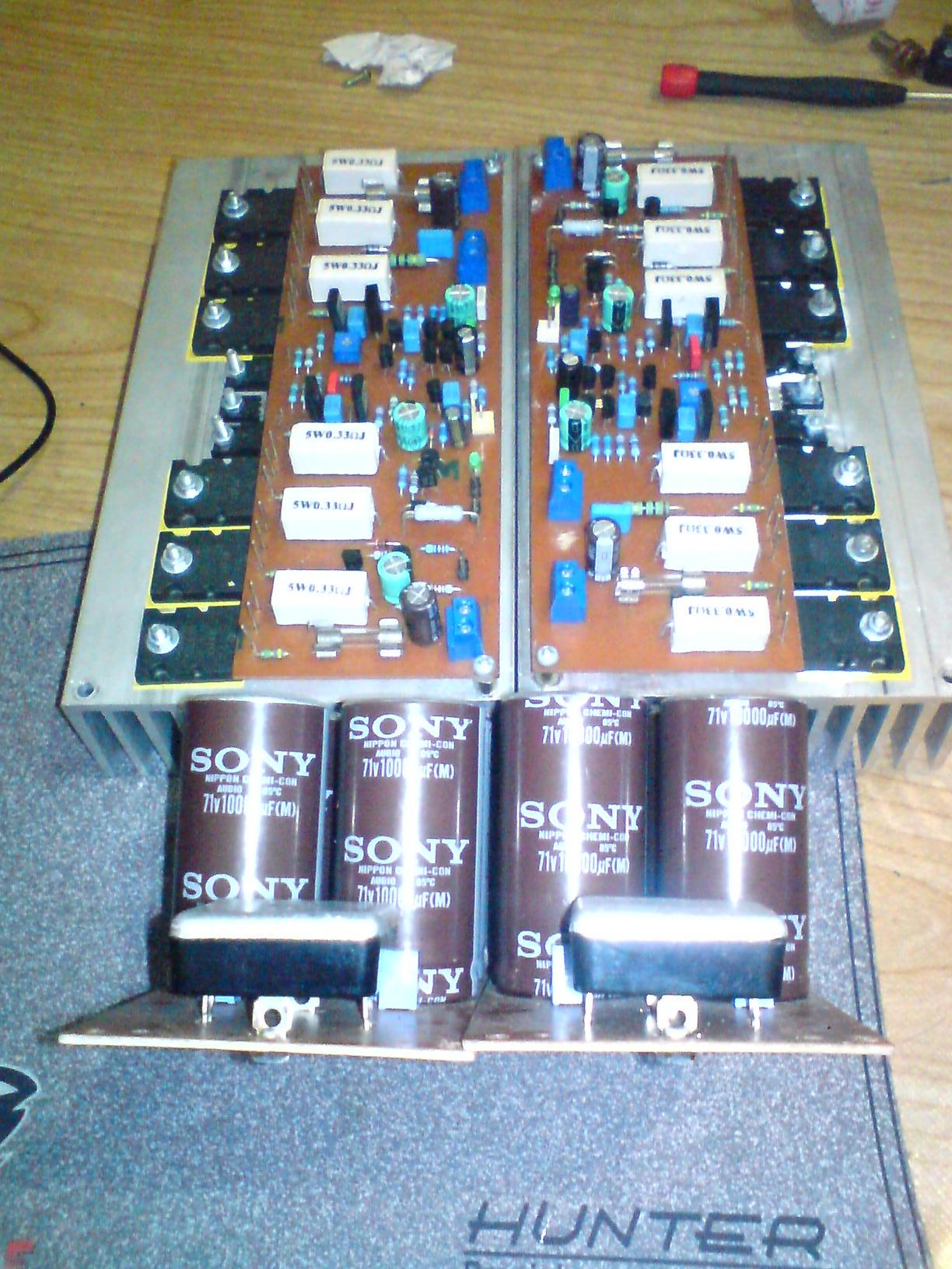

Oh the sound is great clear sound and no hum at all but i had to use preamp with tone control due to my diy two way speaker because they came a little bit crispy in high !! I think that is a good amp to build and listent any kind of music.Thanks Mr Apex for sharing !!🙂🙂

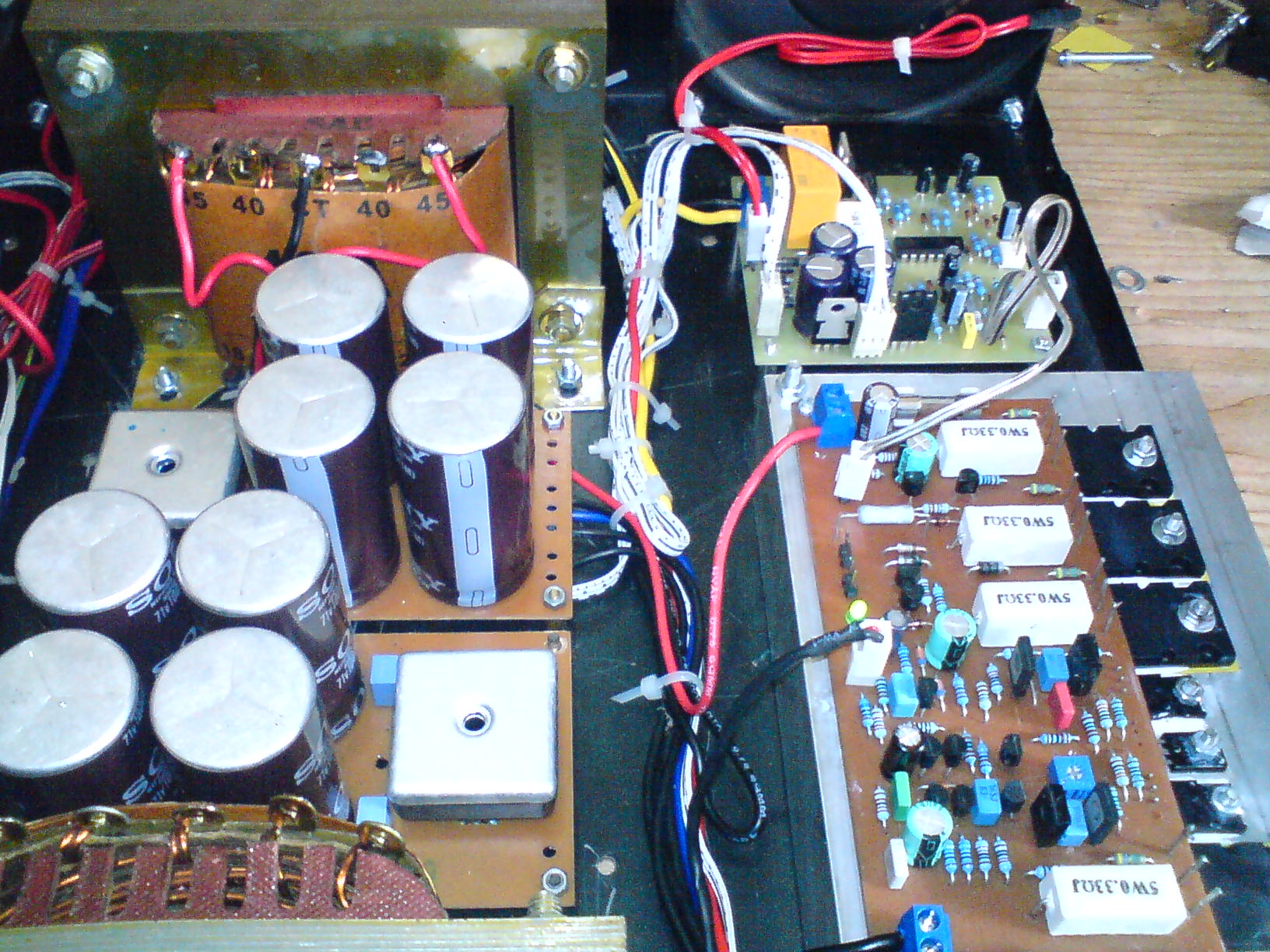

Hi guys...

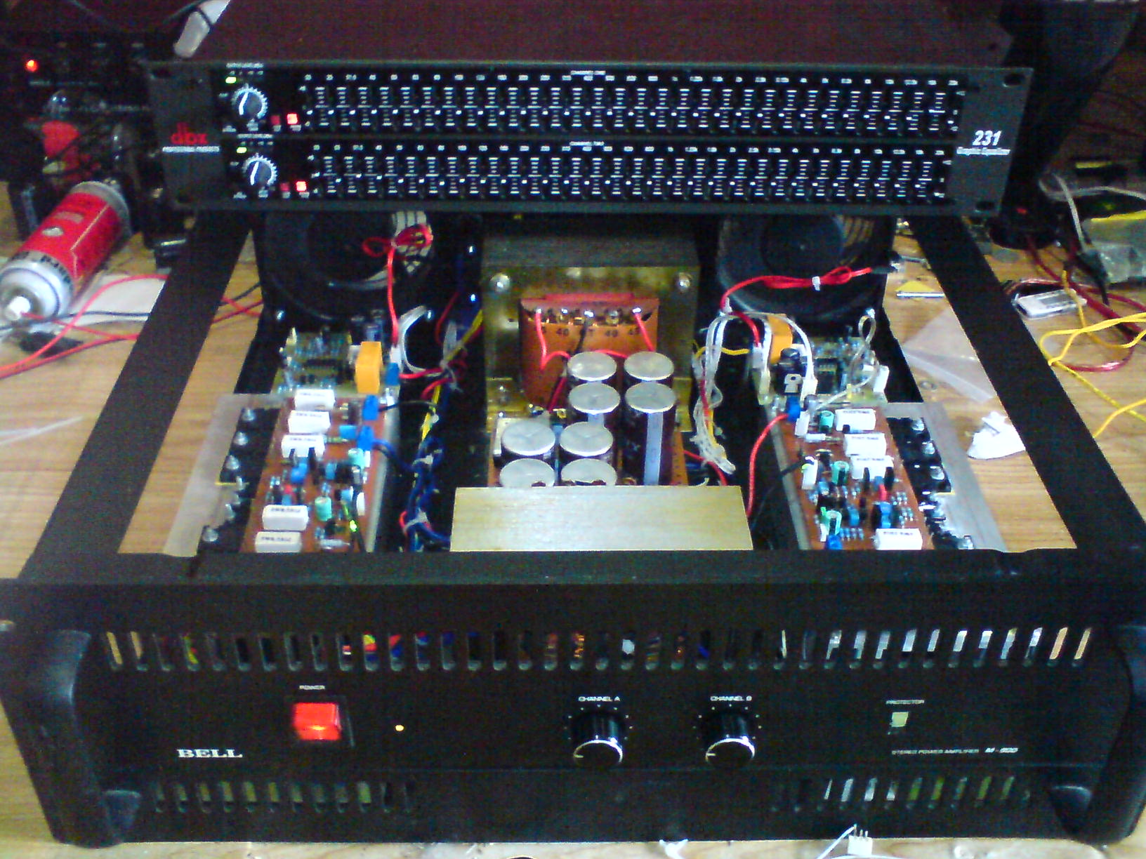

This is my Christmas's Tree edition![]()

Thanks, what is this amp on the picture?
Regards

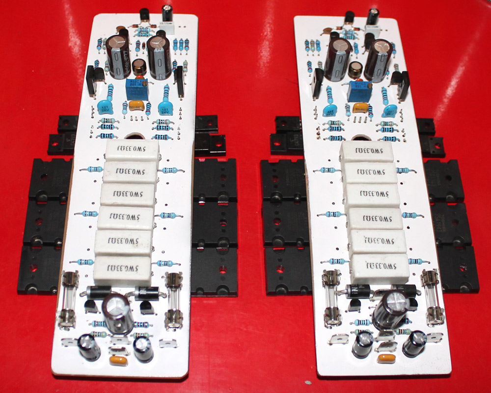

AX20 "S" with 3 pairs output
Regards
This is AX-20 with 3 pairs output & symmetric pcb layout but not tested yet 🙂Thanks, what is this amp on the picture?

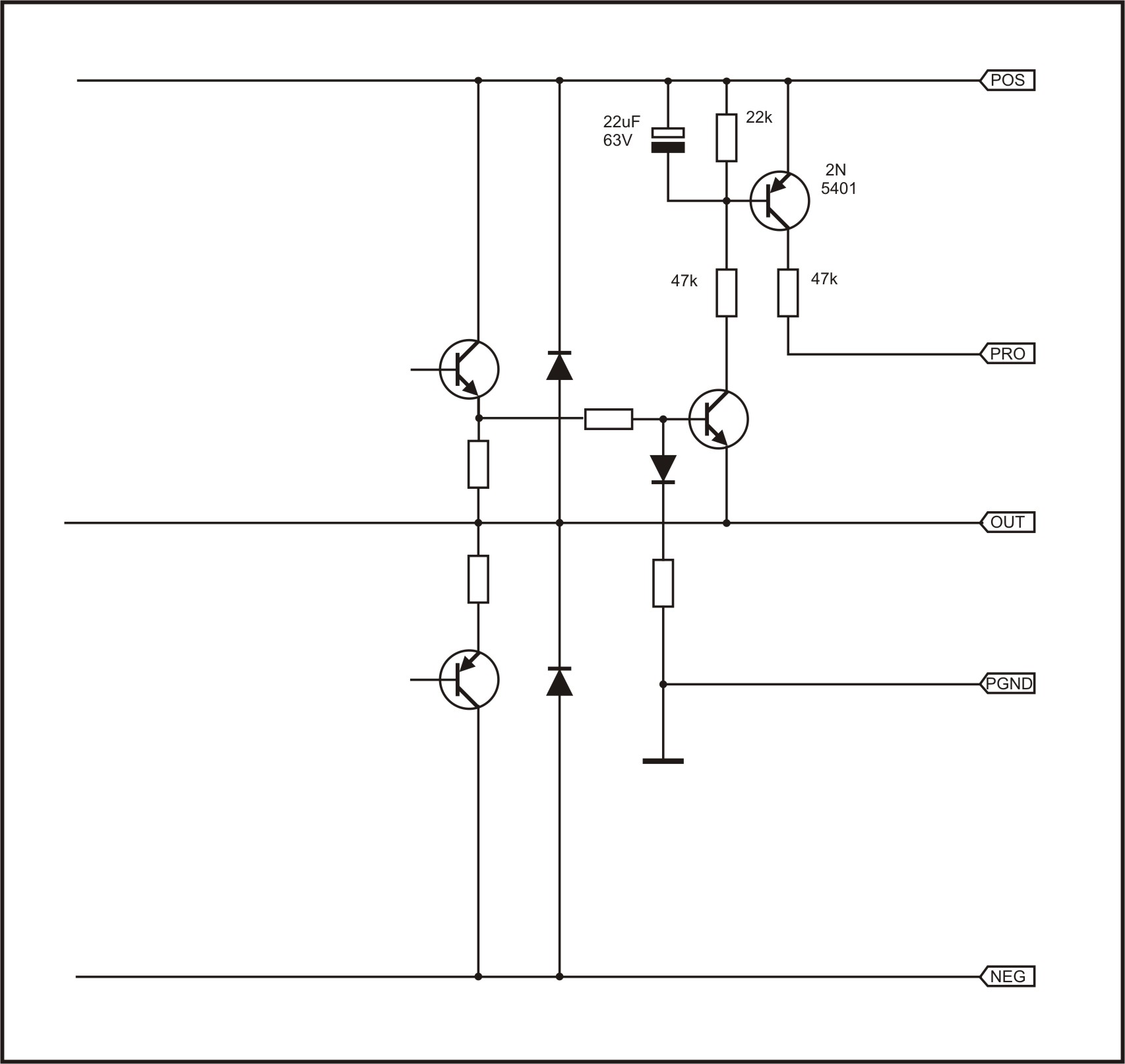

OC detect
Hi everybody,
Let me wish you all a very happy new year!
I built the OC detect and I want to protect my NX-14. Should I need to change any of these components if I want to work my NX-14 with 2 ohms speakers.
I would like to know how it works, so I can change the components and post my experiments.
Power supply 40-0-40 DCV
Emitter Resistor 0.22R/5W
PS. DC protect with NE555 works fine! Thanks dear Mile for the circuit!

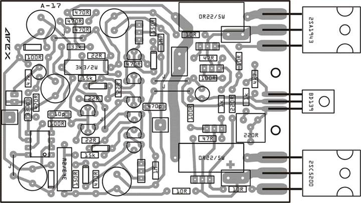

Apex ,is this your new pcb for AX17 amplifier?
No, this is pcb for new amp A17 but not for share.

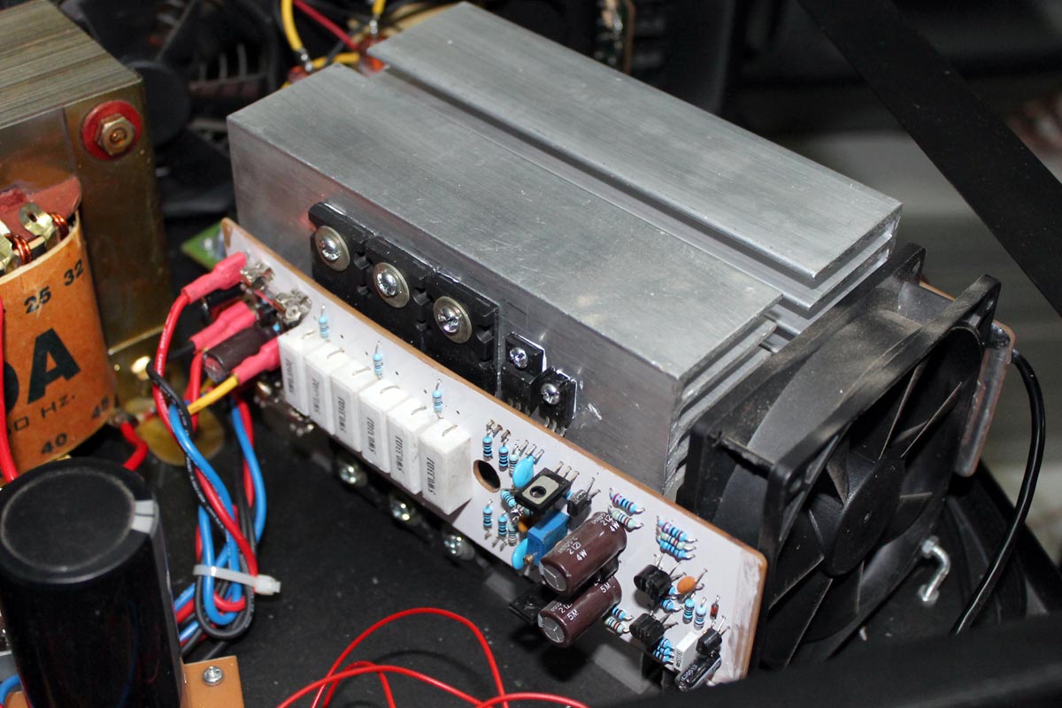

This one will be used at my old school
And BC550 & BC560 should be OK, right?

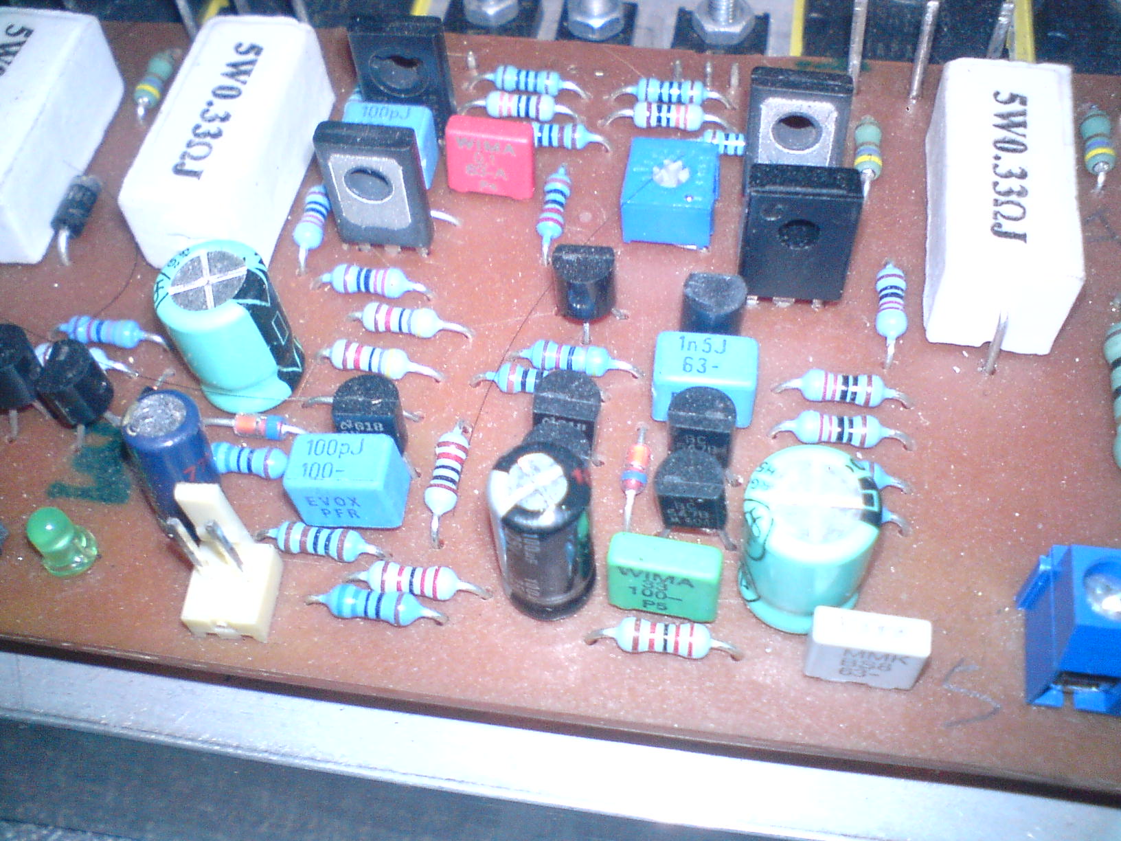

I use BC550-560 on this AX20 😎
Sound is great, it has been sing for a while now.
I had a distorted sound at high volume, but I realize that I don't adjust bias yet 😀
So I adjust the bias, the 1k resistor must be increased.
Now it sound very good, very clear & powerful sound.
This amp will be used in the school that I was there long time ago.
I build it for my teacher there in the school & He and all the students there must be like the sound 🙂
