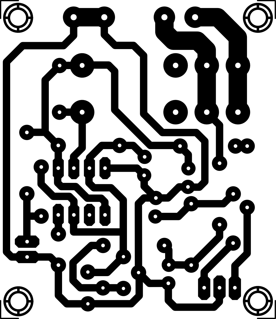

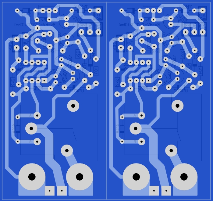

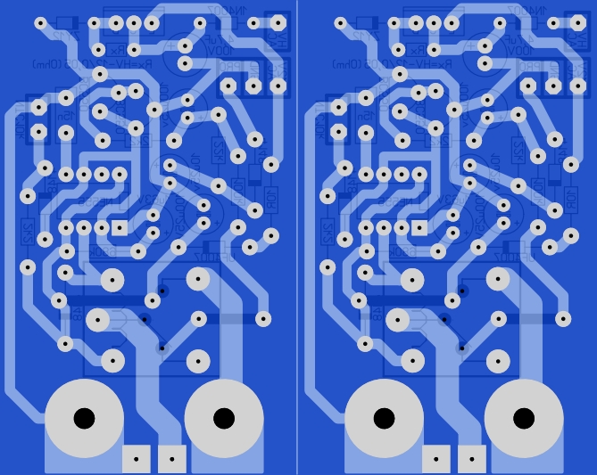

Do you have bottom side?

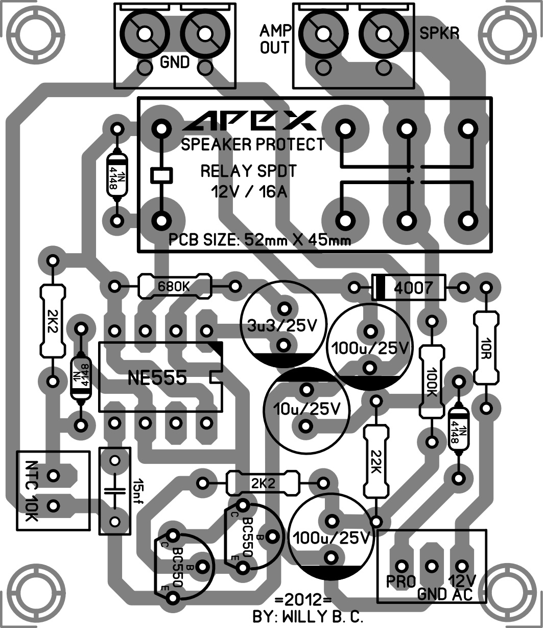

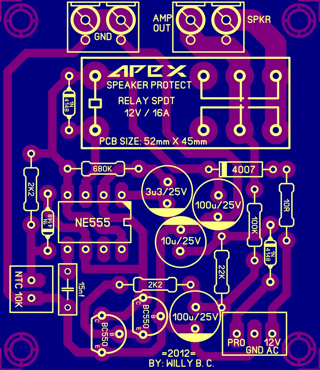

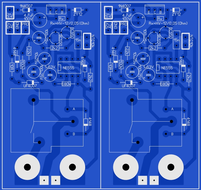

Oh thanks but this isn't helpful for printing.Don't use that PCB, use this one.
That has error, NTC won't work.

bottom side please too

Don't have bottom side.
You can correct first PCB with marker, error is small.
Or use Willy PCB design.

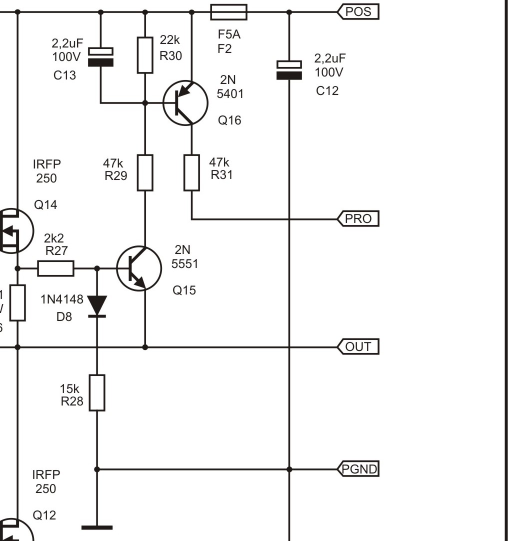

is this protection work for DC and short circut protection ?
thanks for every thing you do my friends
I suggest protect from post #2012 and #2024, protect with NE555 need short circuit detect on amp circuit.
Mr. Mile, short circuit detect scheme your mean from post#2330?
http://www.diyaudio.com/forums/solid-state/164093-100w-ultimate-fidelity-amplifier-233.html
Yes, that is overcurrent detect circuit.
Regards
Regards

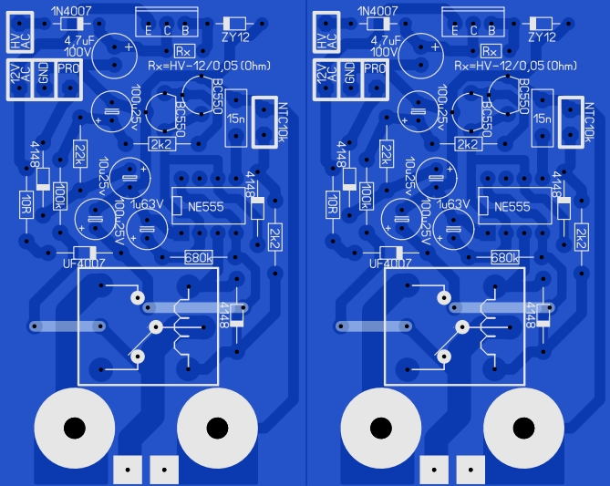

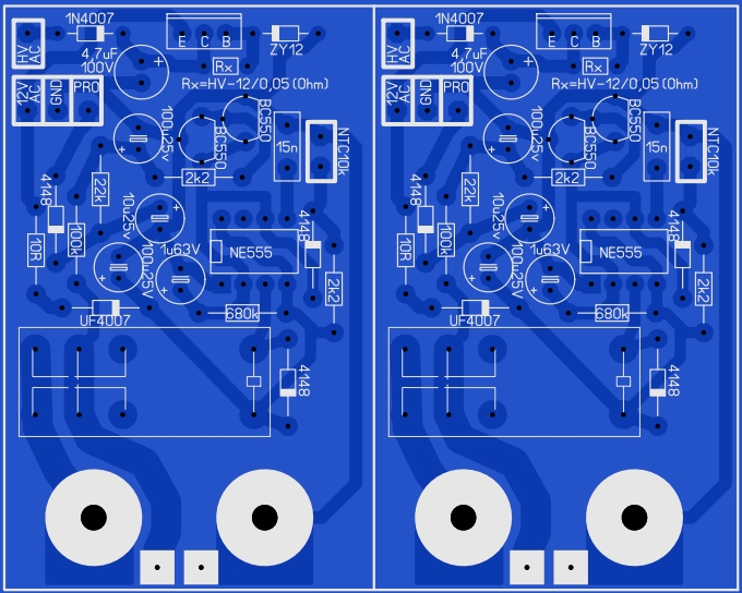

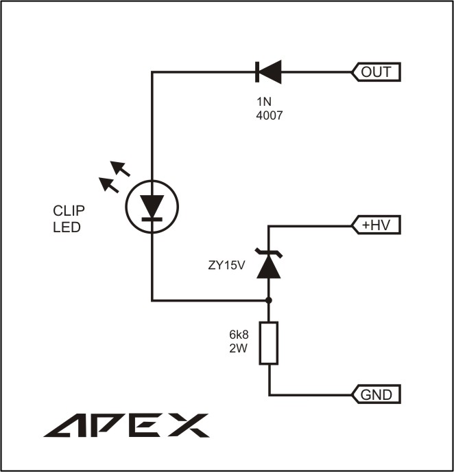

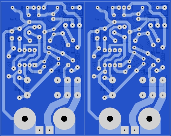

or this one...
