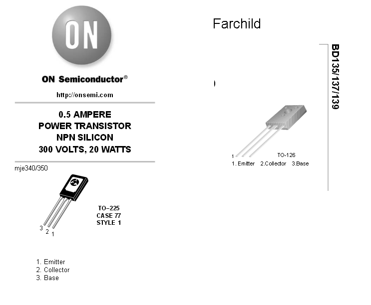

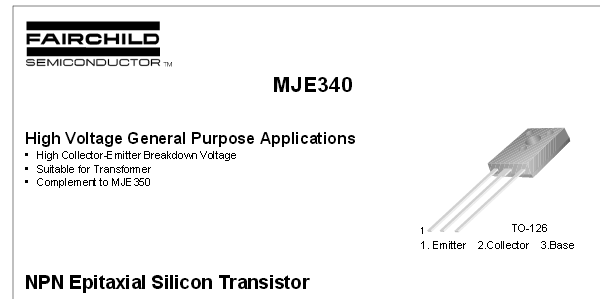

Hello Apex,
Can I use +/-50V rail voltage on AX-11 TO3 version with below output trans?
I will use MJ15015/ME15016 (Vceo=120V, Icmax=15A) as output trans, BD139/140 as drivers.
Bare in mind that bd139/140 pair is only 80V so you will have to change them for eg with mje340/350
The mje340/350 is a very different pair of transistors from the bd139/140.
They are not a direct swap !!!!!
There are two types od mje340/350 (pinouts), I have on-semi ones and they are direct swap transistors to bd139/140, I have used them in FET-hex amplifier.
Very important is to check on which side the base is located, often in datasheet pinout is different to the phisical pinout!!
Regards
Ok, I will use MJE15032/MJE15033 pair then.
That tells me you have bought fakes..........ften in datasheet pinout is different to the phisical pinout!!......
It should tell you the same message !
Yes I know thet there are fakes on the market but I have bought them from very very good source and they perform very well (so far). In the datasheet (style1) please take a look at the pinout for onsemi mje340/350 is the same as pinout for bd139/140.

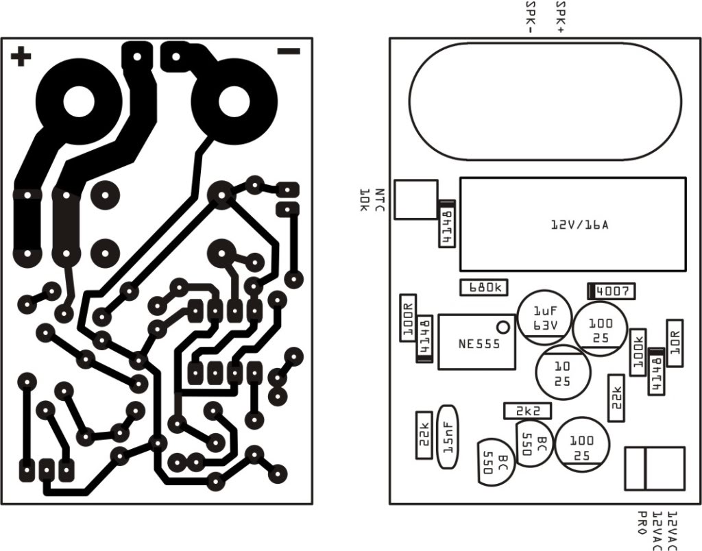

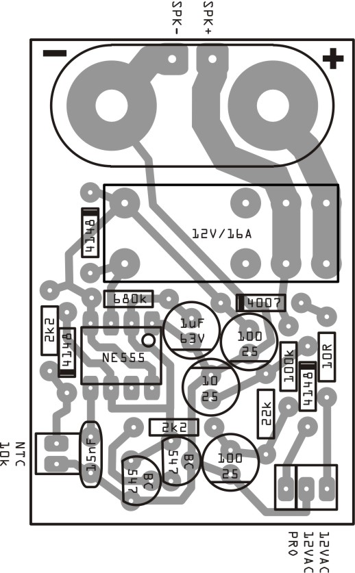

555 protection
do you mean this?
hi
any one have ne555 apex protection circute and pcb?
thanks
do you mean this?
Don't use that PCB, use this one.do you mean this?
That has error, NTC won't work.
