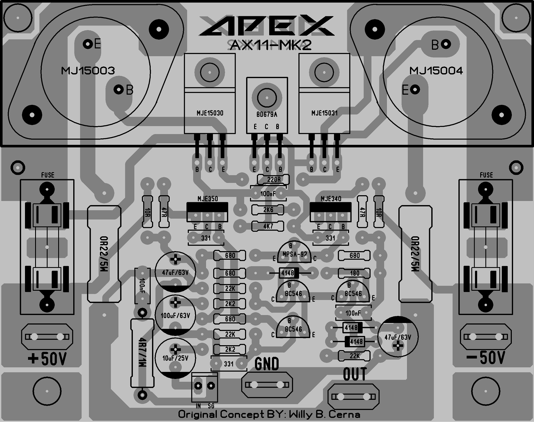

Hi mister cjkpkg what resistor you have to do a combination of parallel to get 2k7? is it this one illustrated in this two images?
Regards
Juan

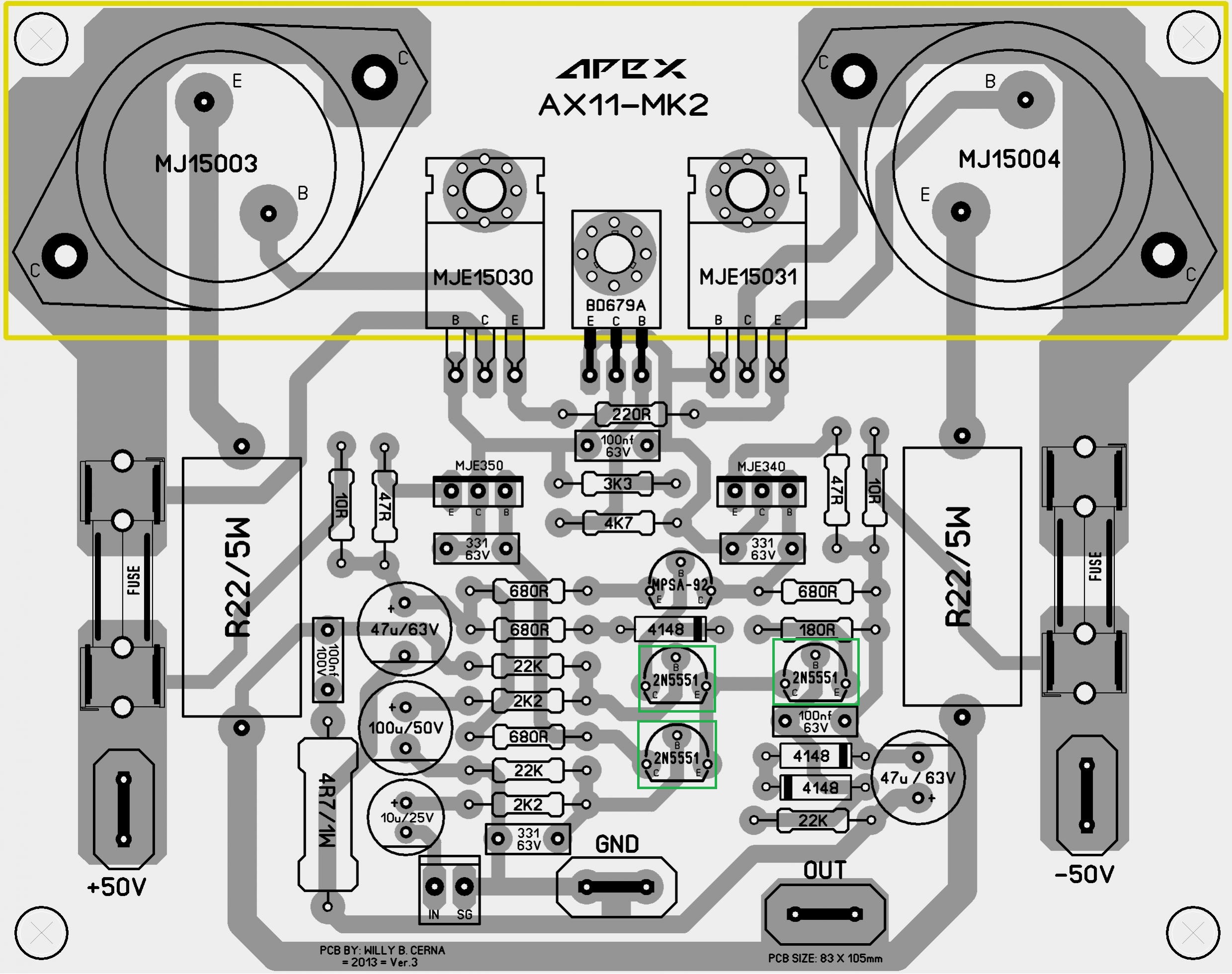

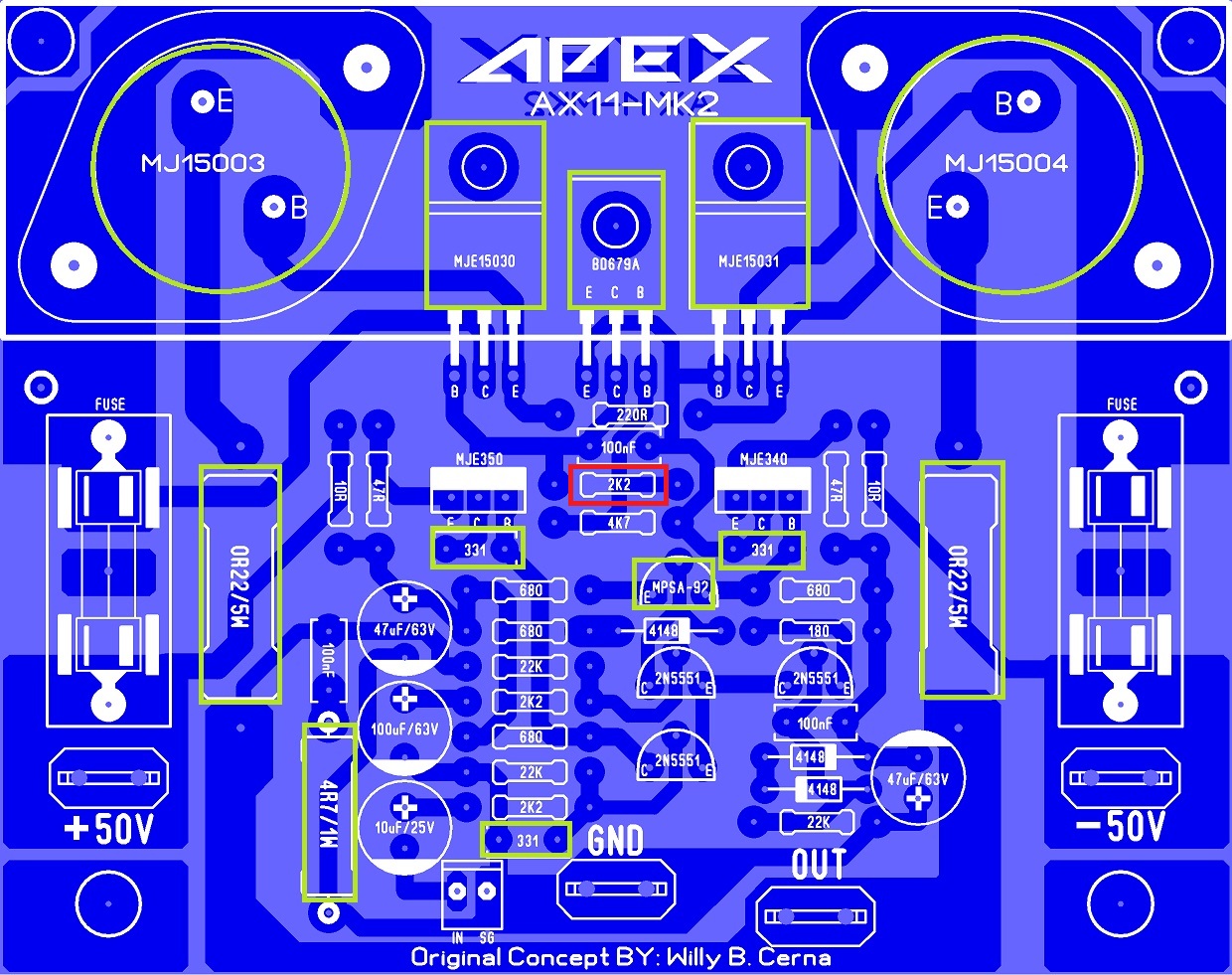

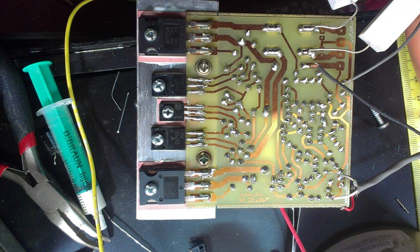

Yes I paralleled a 15k resistor on the 3k2 getting about 2640. 2k2 wasn't enough to turn them on and 3k2 was way too much....measured to almost 1A and shut it down.
After all day today measured 35mV across the 0.22 ohm so it is very stable.
***Edit...I used 3k2 in the board...not the 2k2 you updated your silkscreen to and paralleled that to reduce from 3k2.

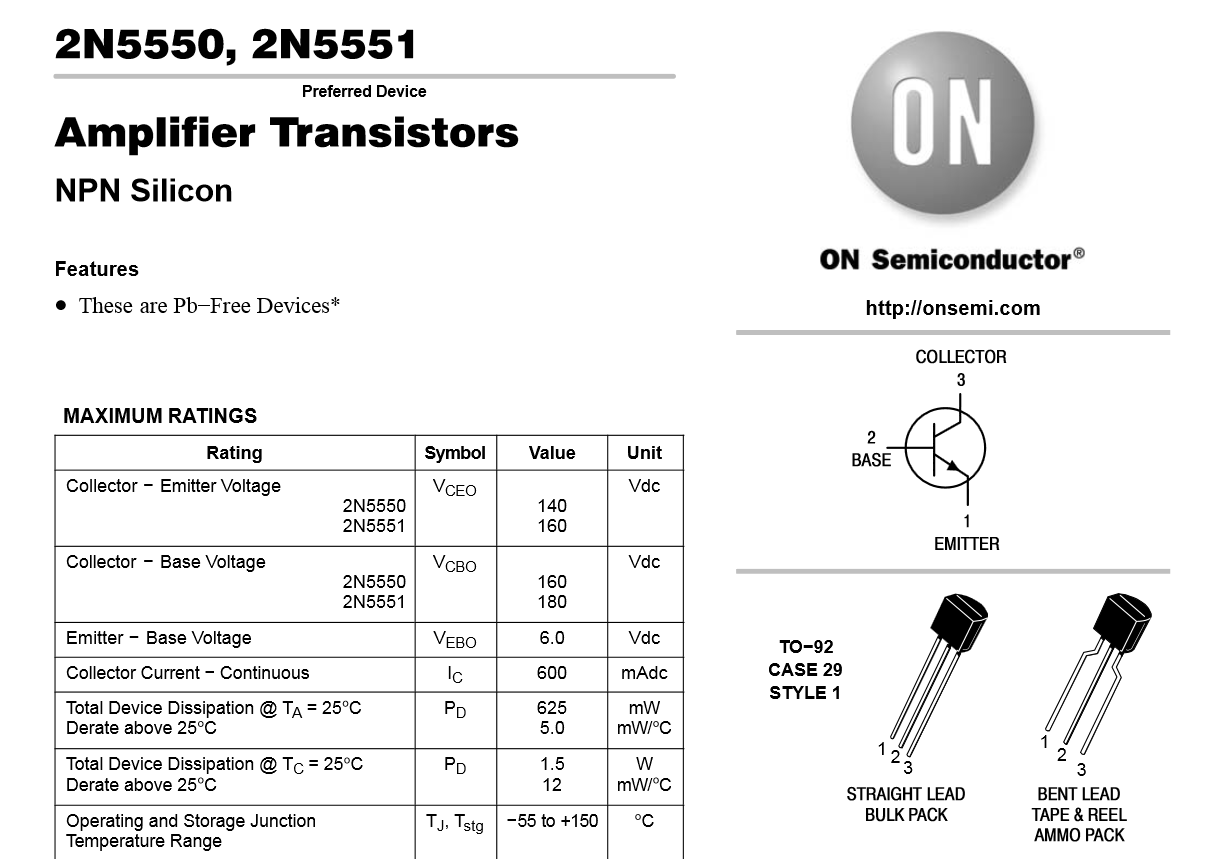

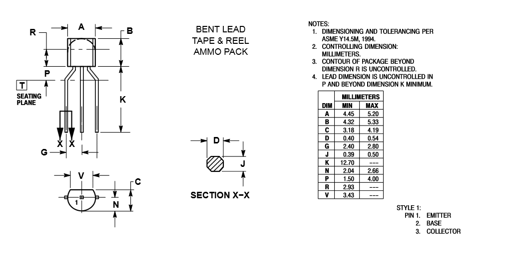

And if you use 2n5551 make sure you have your pin out correct....mine were reverse from your silkscreen.
I was checking and I found out that the 2N5551 the pin orientation I copied wrongly from mister Willy's original one, I don't thing is a big problem the only thing I have to do is to rotate 180 degrees or use BC546 because it has the correct orientation, I guess mister Willy has to check it too no big deal we can fix it, thank you for let us know I appreciated sir.

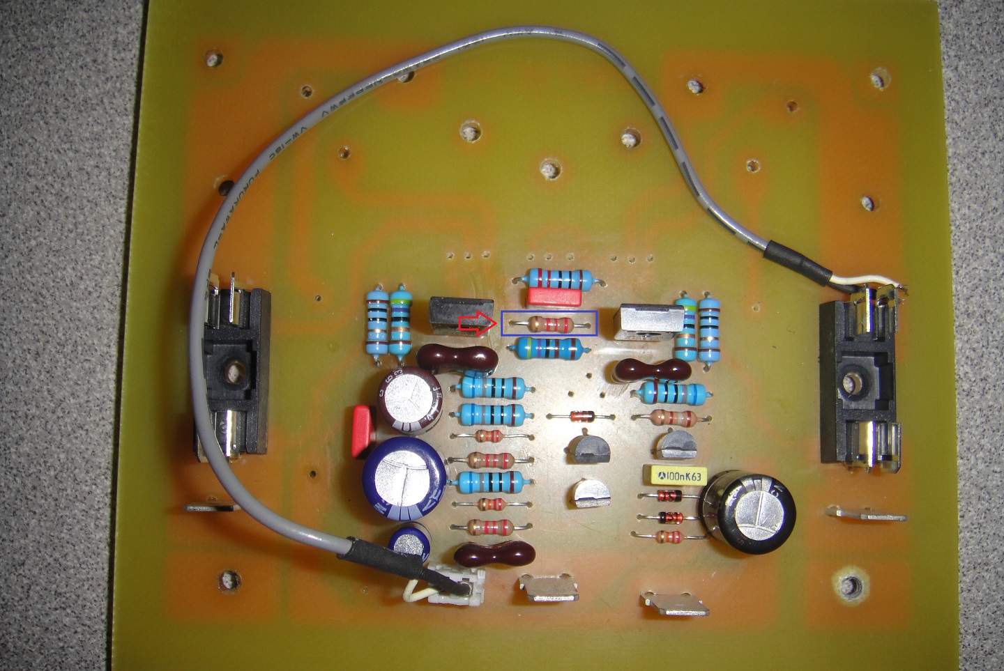

post #2366 left diagramme
post #2383 left photo multiturn 10k trimmer ,bias adjustment
hope this help.

Were you able to get it stable? I thought I remember reading that you were having trouble keeping it stable with the trimmer. I like the idea of using a trimmer.
ax11
Take a look here.http://www.youtube.com/watch?v=q0q5eUH0gZE
It's absolutely stable on rail+/-35V.Were you able to get it stable? I thought I remember reading that you were having trouble keeping it stable with the trimmer. I like the idea of using a trimmer.
Excellent...I have giant heatsinks and would like to easily play with different bias points. Will pick up some 5k mulitturns next time I need something from mouser.
Pay attention not to turn trimmer at lower resistant point or put a standard resistant in series with this.Excellent...I have giant heatsinks and would like to easily play with different bias points. Will pick up some 5k mulitturns next time I need something from mouser.
