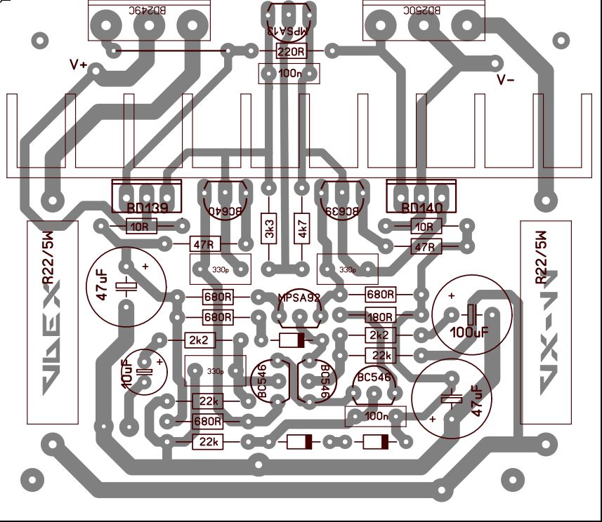

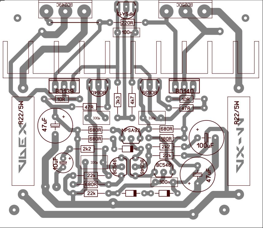

100W Ultimate Fidelity Amplifier
Just another version...
with common heatsink for the driver (not tested).
regards Olaf

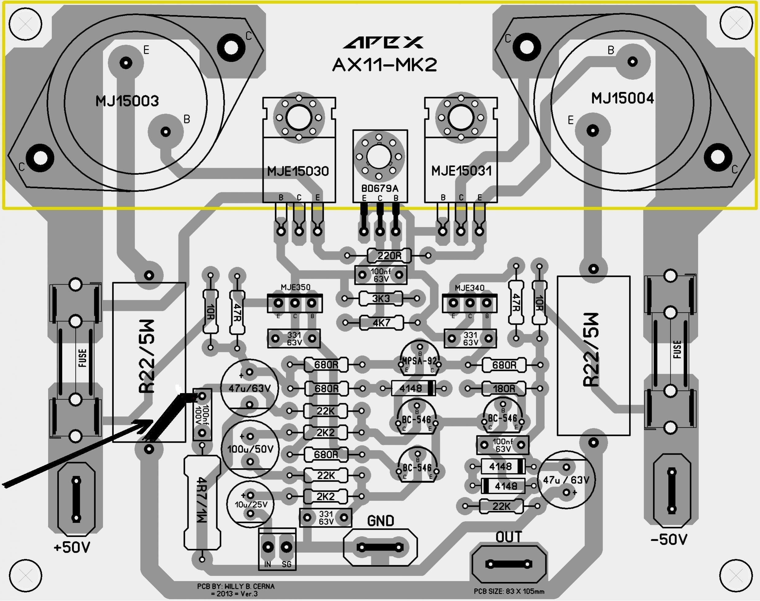

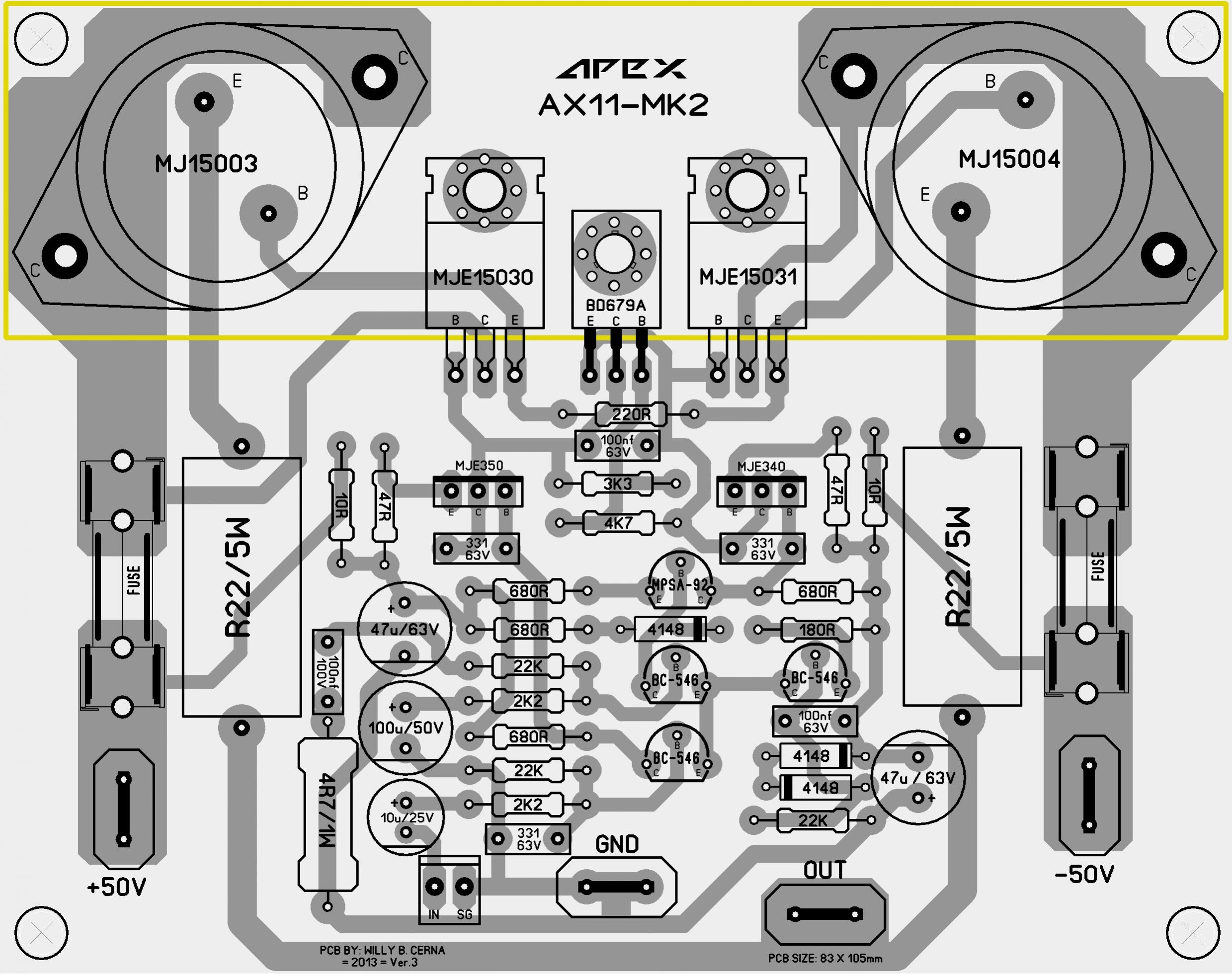

My TO3 version of AX11 for more power.
Used BD679A instead of MPSA13
MJE15030/15031 instead of BD139/140
MJE340/350 instead of BC639/640
MJ15003/15004 instead of BD249/250
Also you need 2N5551 or 2sc2240 instead of BC546, if you use higher voltage.
Check this and let me know if you found mistake.
It's late now in my place....
